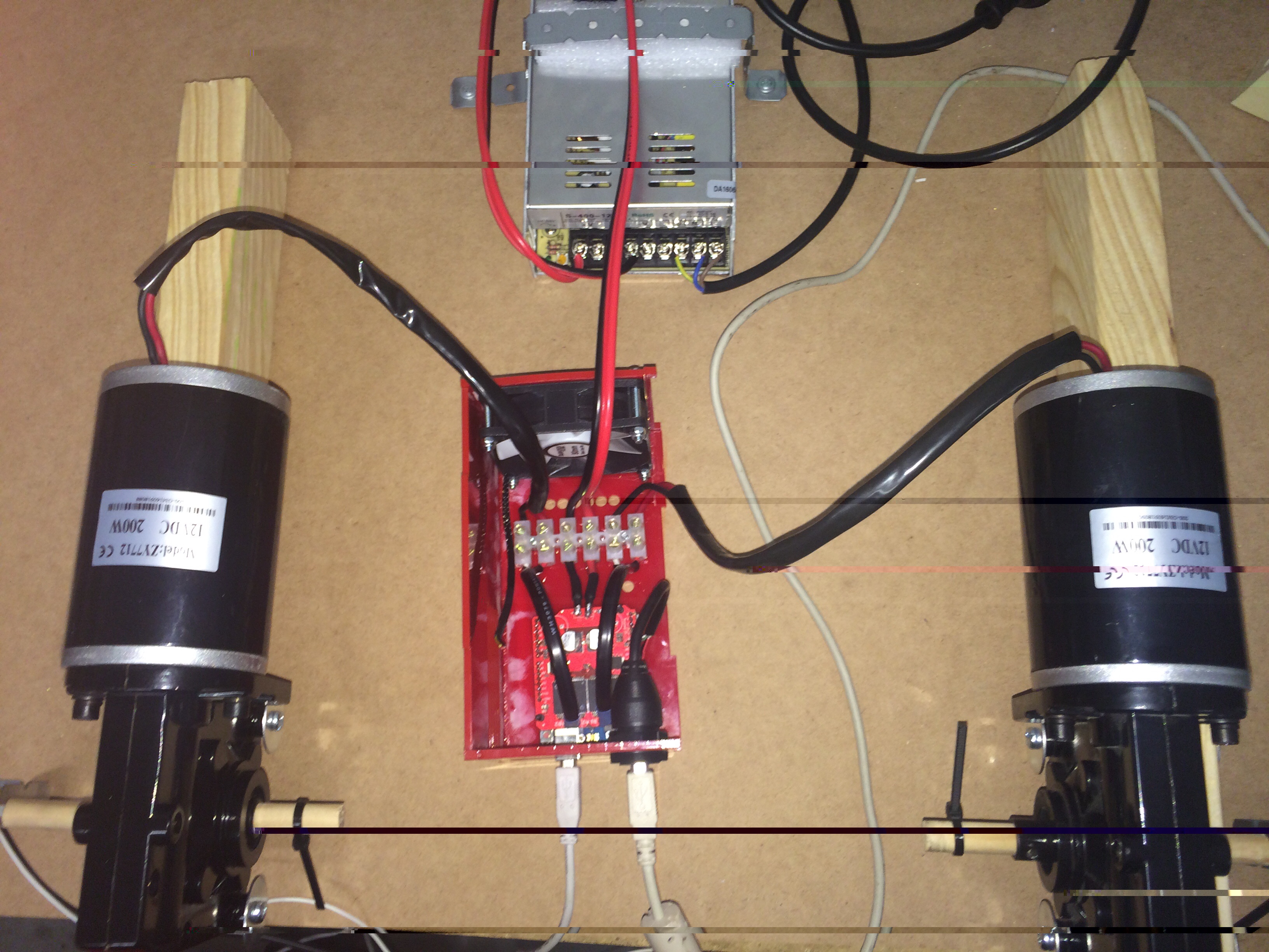

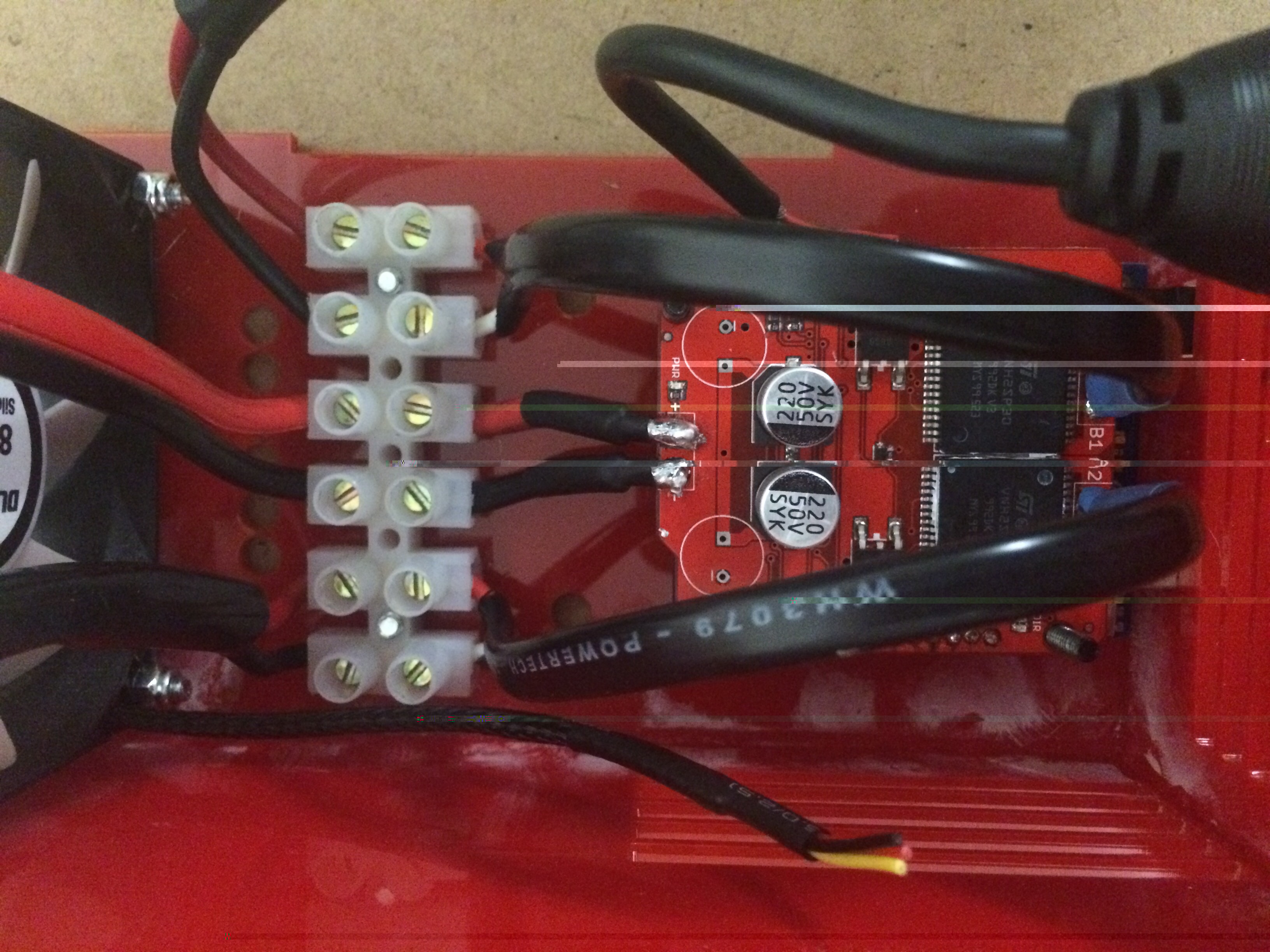

Postby LinkRacer » Mon 31. Oct 2016, 12:08
You can see left right motors and wiring
Power supply wiring in the centre
I don't see how the wiring is wrong

Postby Hardsteel » Sun 13. Nov 2016, 23:17
I have 2 of those motors too...but is 1 moto monster enough? And dont you need at least 2 powersupplies 12V50A so one for each motor?

Postby LinkRacer » Sun 13. Nov 2016, 23:42
The place I bought the motors from in Melbourne say 16A max current draw.
I have a 33A power supply off eBay and it works fine.
Since my last post I tuned the xpid settings and it works great, just need to finish my steel motion platform to test it properly.

Postby LinkRacer » Wed 16. Nov 2016, 07:54
If the max current draw is 24A, 30A per motor should be fine as long as it's a decent power supply (ie: not something like a PC power supply)
Good luck!
