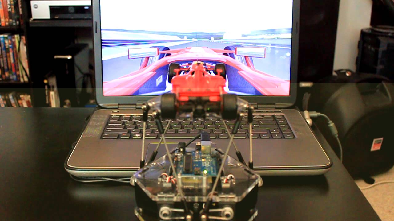

I come through this post declaring my intentions to build a simladora miniature 6DOF using the Arduino together with 6 servo motors, one for each axis, I'm currently a student in one of the best schools in Brazil and I think to present this project as part of the my conclusion project mandatory course.
I've been researching about similar project and found some that have developed similar systems, now I hope to build a dual-platform like this ->
Image of my system
I'm still developing the necessary mechanisms the whole system and if anyone is interested please contact by private message
