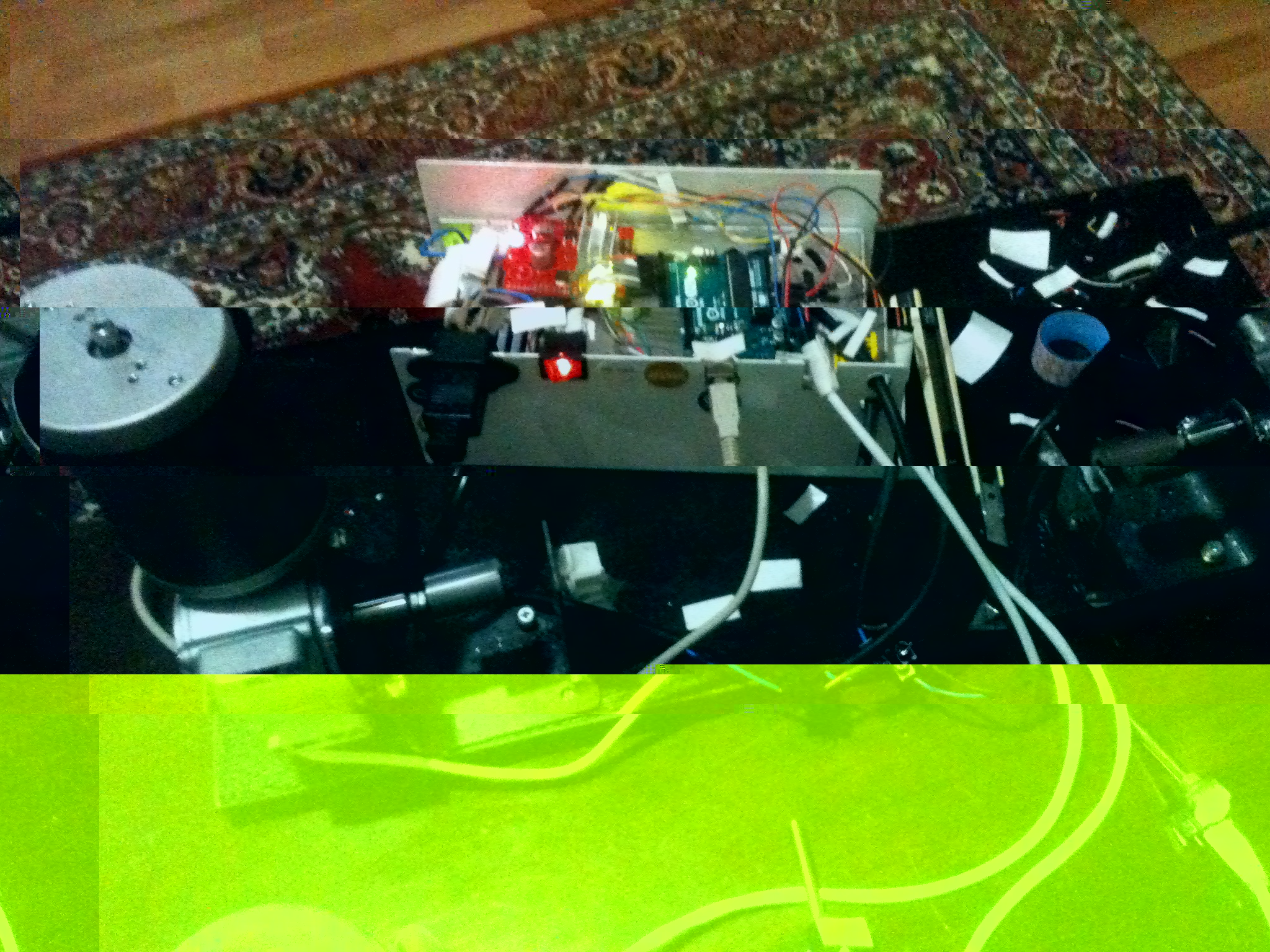

Postby yasin » Wed 7. Jan 2015, 05:10
hi i need help !!!
my sim 2 DOF 230 rpm for 12V DC motor.
arduino uno r3 monster moto cards all right
I open the game had to move .
but do not know how to do the pot and interface setup .
pot is making continuous chills when I connect the motor shaft.
I looked , but I did not understand xs forum .
Please help !
I need to take a step by step with detailed pictures .
least because my English
