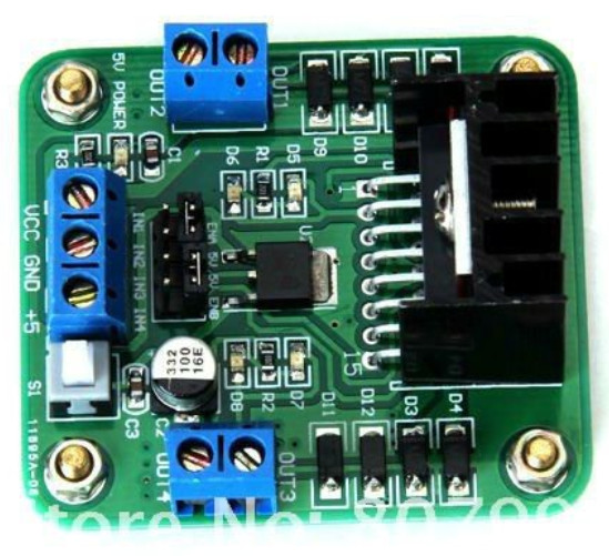

Hello, the connections are as follows, is well
arduino / HL298
pin 2 / IN1
pin 3 / IN2
pin 4 / IN3
pin 5 / IN4
pin 9 / ENA
pin 10 / ENB
VCC / 5V
VCC / VCC
GND / GND
Attached is a picture of the bridge H

Postby wallytattoo » Fri 1. Aug 2014, 04:59
started moving, it was because I was testing problem with usb power directly. Now I added an external source and I began to move, but just vibrate a lot. so I'm changing the values ​​of pid.
Thanks for the help given so far, I'll comment them progress. regards

Postby sirnoname » Fri 1. Aug 2014, 07:47
A L298 has no power. 2A is the power for a free running wiper motor of a car without any load. And this 2A is the absolute maximum for the bridge. You cannot use this bridge for a real simulator. Are you building a toy simulator?
Postby wallytattoo » Fri 1. Aug 2014, 10:55
If thumbnail is now until it works and while I get the Monster Moto Shield DEV-10182.
