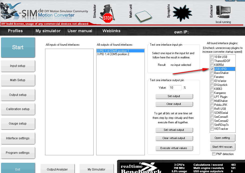

Postby wallytattoo » Tue 29. Jul 2014, 00:29
Thanks for the help, I had the use puerto.en also set the image as I have now is.
Now is not because of the settings of the interface when I double click on the drive as the second image. The following have no value. Why? Is this normal? or I need to configure.
I hope I can continue to help. a hug

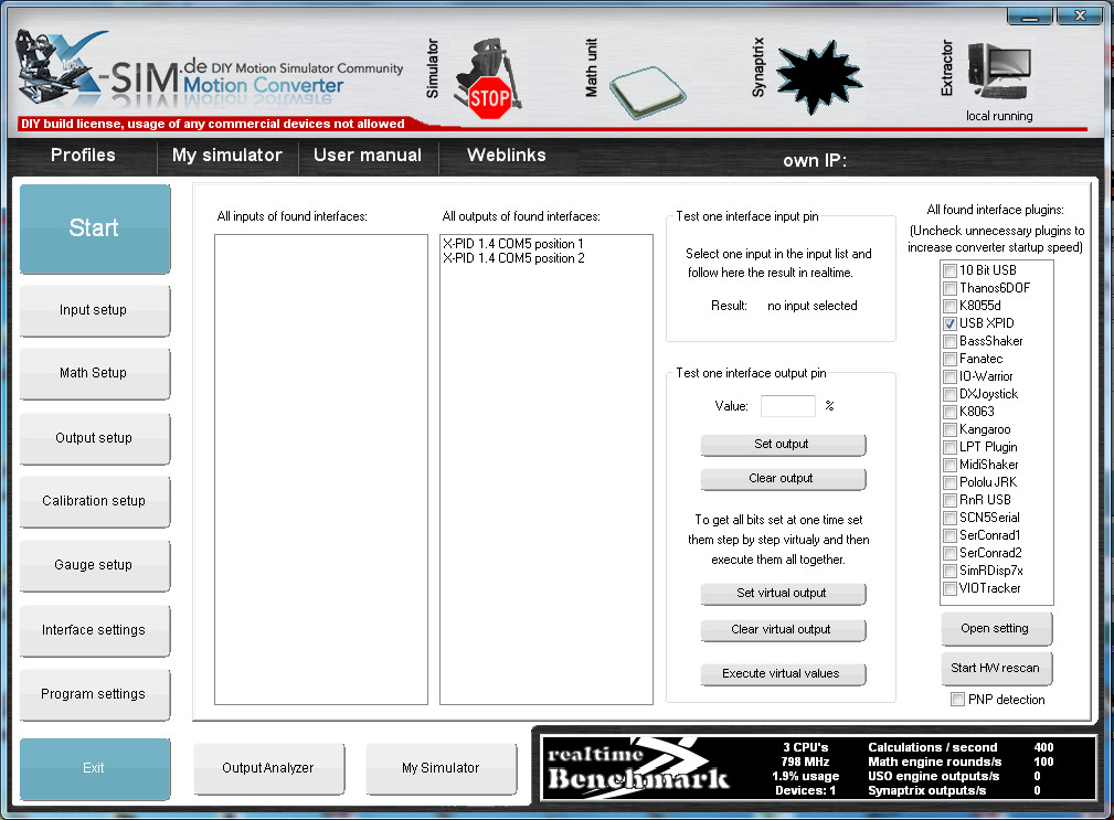

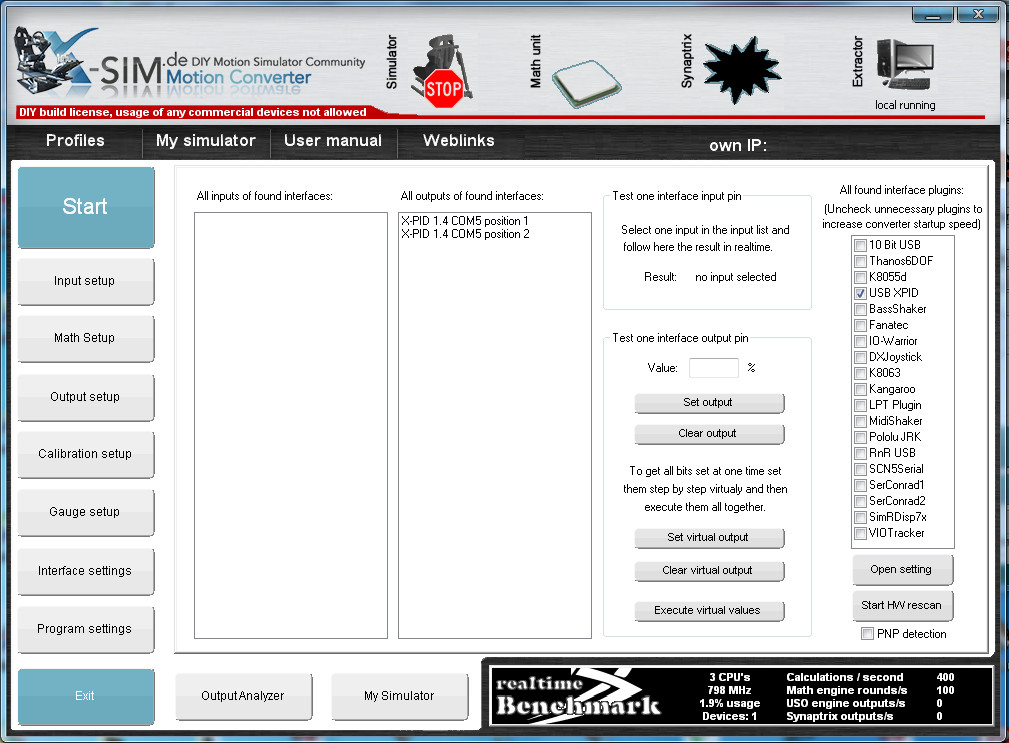

Postby wallytattoo » Tue 29. Jul 2014, 01:14
sorry I'm a little upset, I now appeared so far in the window settings of interface, rebooted the x-sim and when I booted again appeared.
Now my question is this, with everything set up and connected the hardware, when I press play game extractor start the game and all, but no motor does not move, it should move?

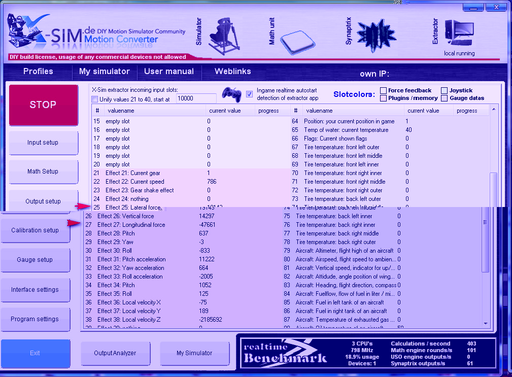

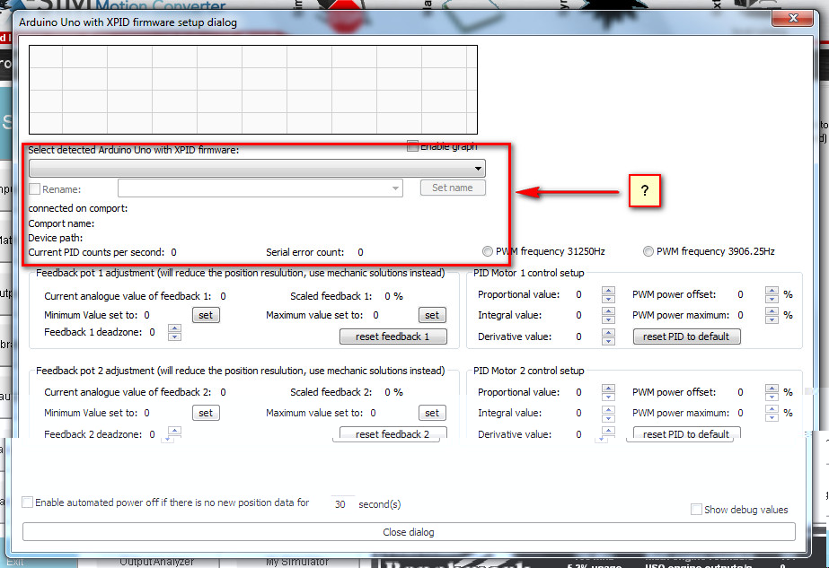

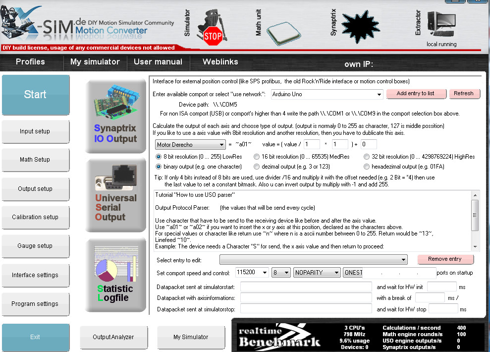

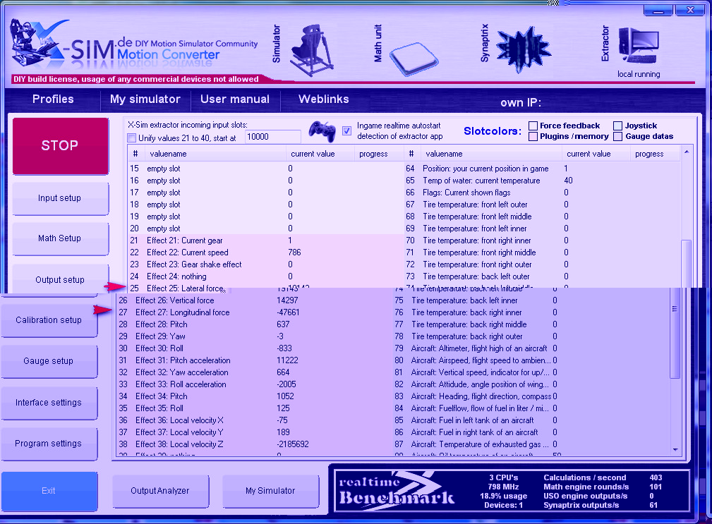

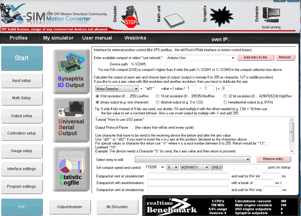

Postby sirnoname » Tue 29. Jul 2014, 10:00
The third picture and the second picture are impossible to each other. The third picture must have a entry. It seems they are not taken at the same time.

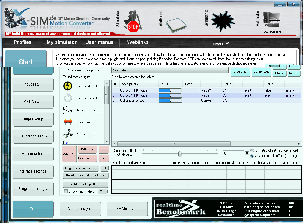

For the moving part: You must do all steps of the training video tutorial to teach the system the movement size and direction.
http://www.x-sim.de/software.php?lang=e ... n_training
If you press the play button you have also to press the start button in the converter (or you enable the autotrigger in the converter).
http://www.x-sim.de/manual/settings.html
And you must fill the math setup like in the tutorial ;)

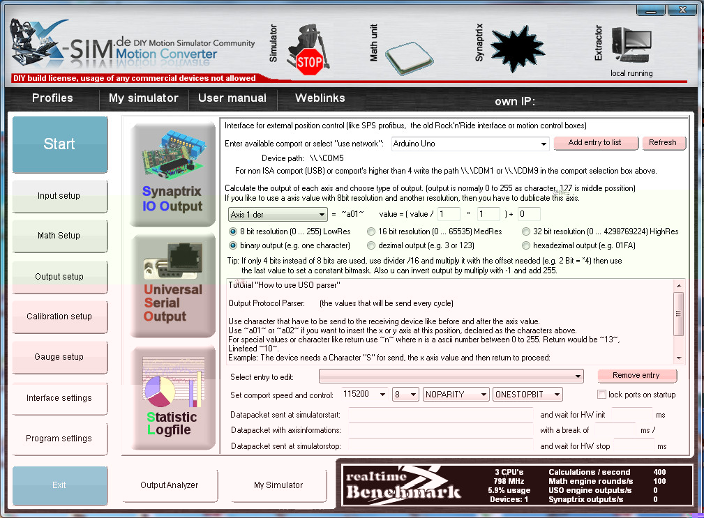

Postby wallytattoo » Tue 29. Jul 2014, 16:21
Another query, in part with output settings synaptrix have to configure anything or not? or freezes in the picture costs.
And the USO configuration, the output is binary.

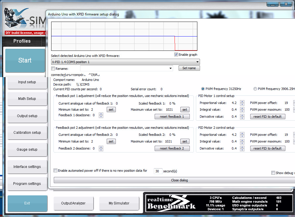

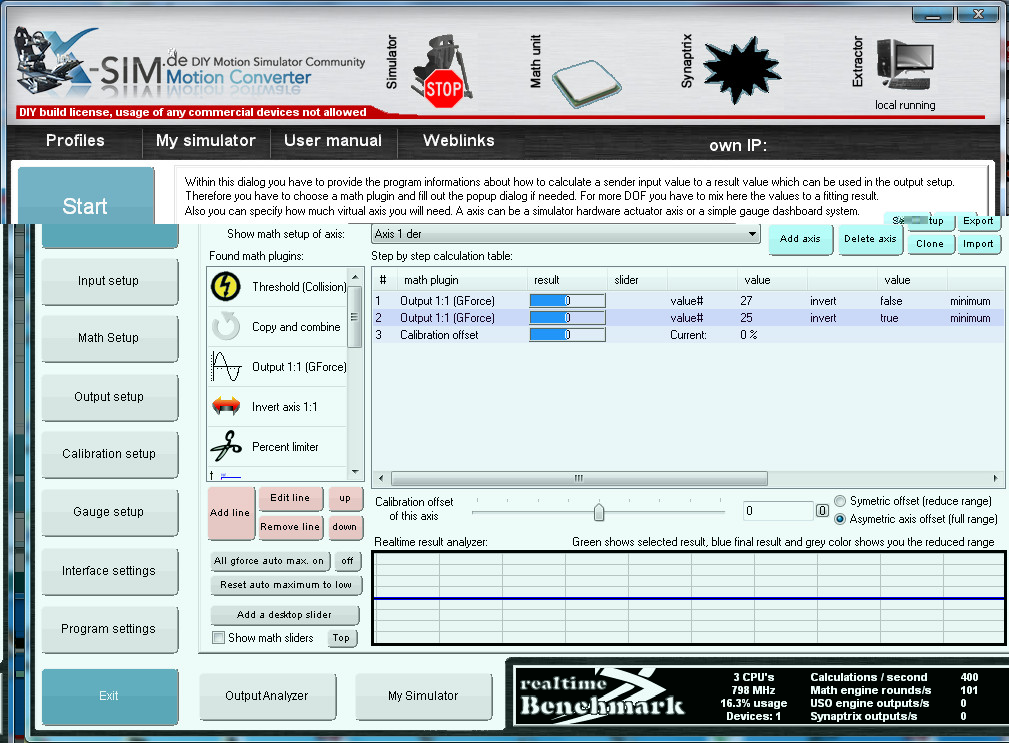

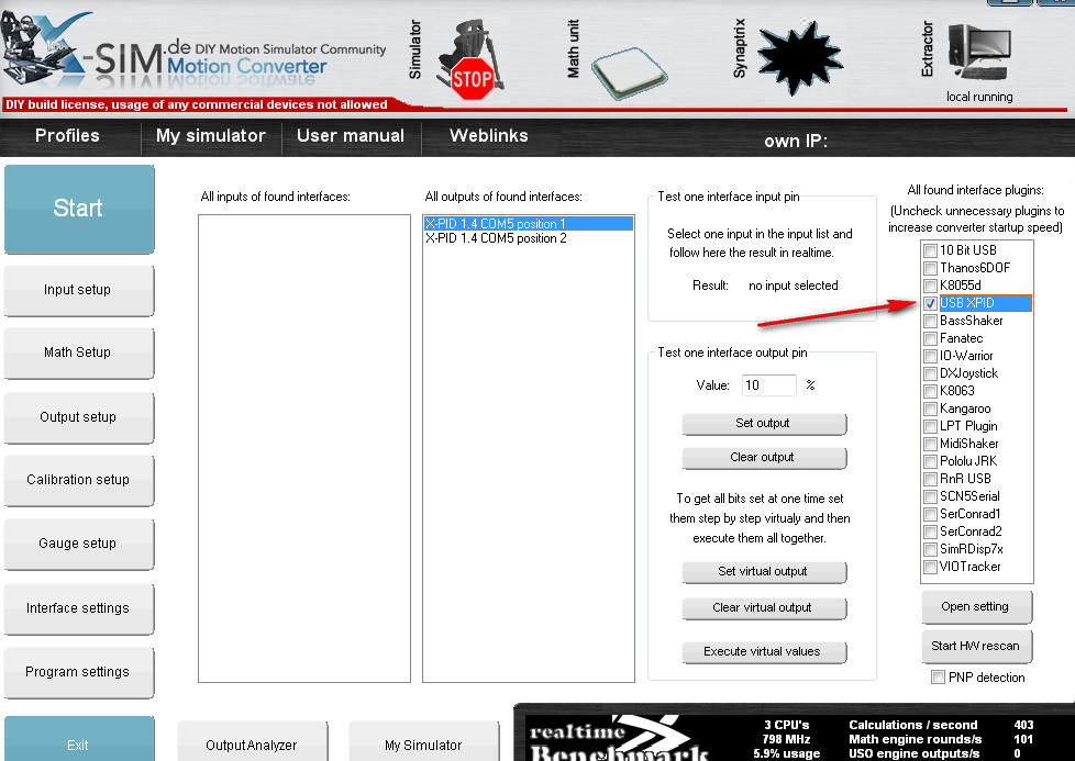

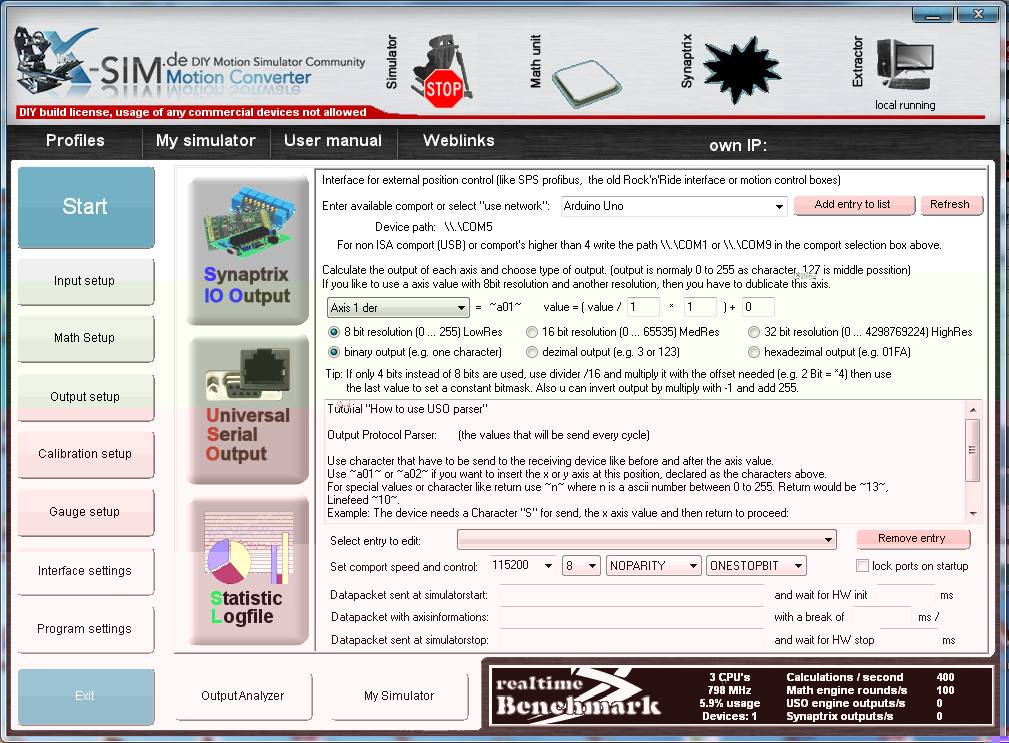

Postby wallytattoo » Thu 31. Jul 2014, 03:44
Hello, I followed the tutorial step sirnoname http://www.x-sim.de/software.php?lang=eng&page=simulation_training
I loaded the arduino code.
But when I start the game give yourself the x-sim extractor motors never move? I'm missing?
when I open the window I see that the input setup parameters in my case, 25 and 27 have values​​, as if going to the arduino.
attached some pictures of the settings to see if I can help
the code in the arduino is this:

Postby sirnoname » Thu 31. Jul 2014, 10:29
First you check your motor with the interface setup. Select your motor. Insure the motor moves to 10%, 50% and 90%.
Goto math setup, press setup, select fitting output. (Normally asked if you add a axis)
Same setup if you follow the instruction of direct port output ind synaptrix setup, both setups are the same.
