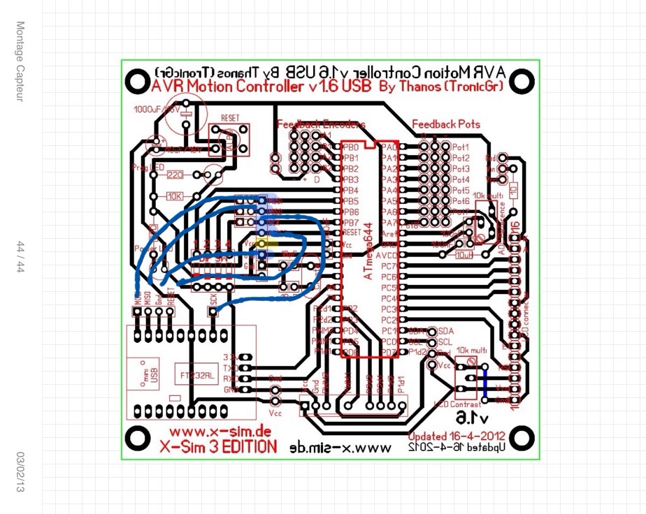

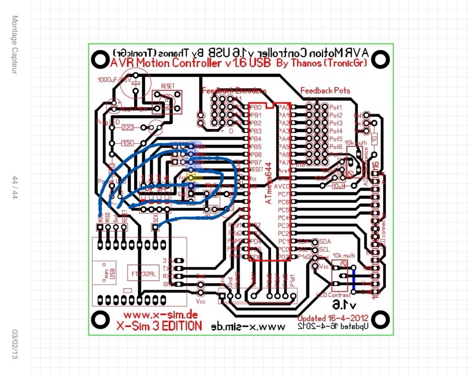

Hey guys i have build the AVR motion controller, but when i go to program it i get the following error.
Read Signature Bytes=> FF FF FF => ERROR
Is this means i have killed my ATmega CPU?
Thanks

Postby vicpopo » Sun 3. Feb 2013, 19:13
Did you put all the switchs to OFF ( the all 4 switchs from the dip switch)? When programming they must be to OFF .

Postby vicpopo » Sun 3. Feb 2013, 20:07
Ok ,
Did you used cables to program it?
Look at the picture below. All switchs always to OFF.

Postby vicpopo » Sun 3. Feb 2013, 21:44
Hi ,
As it's difficult to watch on the photo , I attached below a picture for the shematic.
Shematic
Please check also your baud rate in fdti driver , 9600 .
