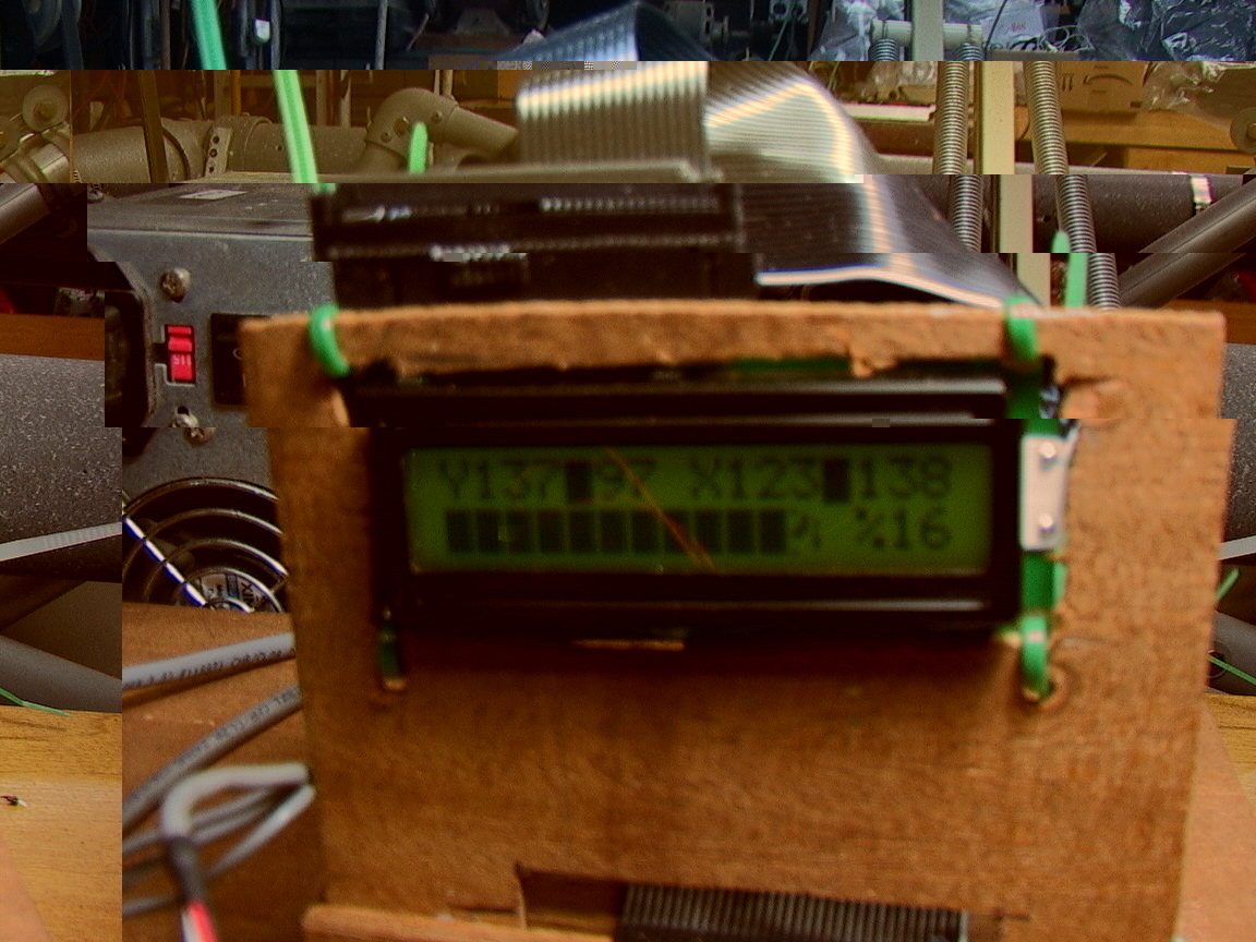

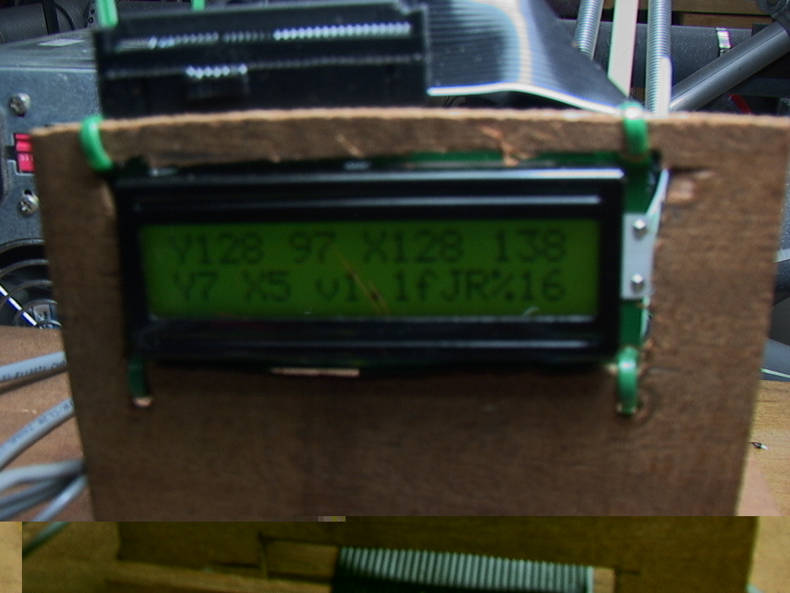

I downloaded the FTISP for AMC1.6 1.1f both crystals.zip! I ran both crystal speeds and changed out the associated capacitors. Both programs gave me fits and convulsions. I could not calibrate either axis at the start-up no matter what I did. Then, I experimented with the third potentiometer on the LCD it indicated 95% and progressed down to 5% between the numerous automatic restarts. The screen on the LCD displayed squares and lot s of $ signs etc. before finally coming to rest.
My AMC 1.5 did not react in such a way. Please advise!
