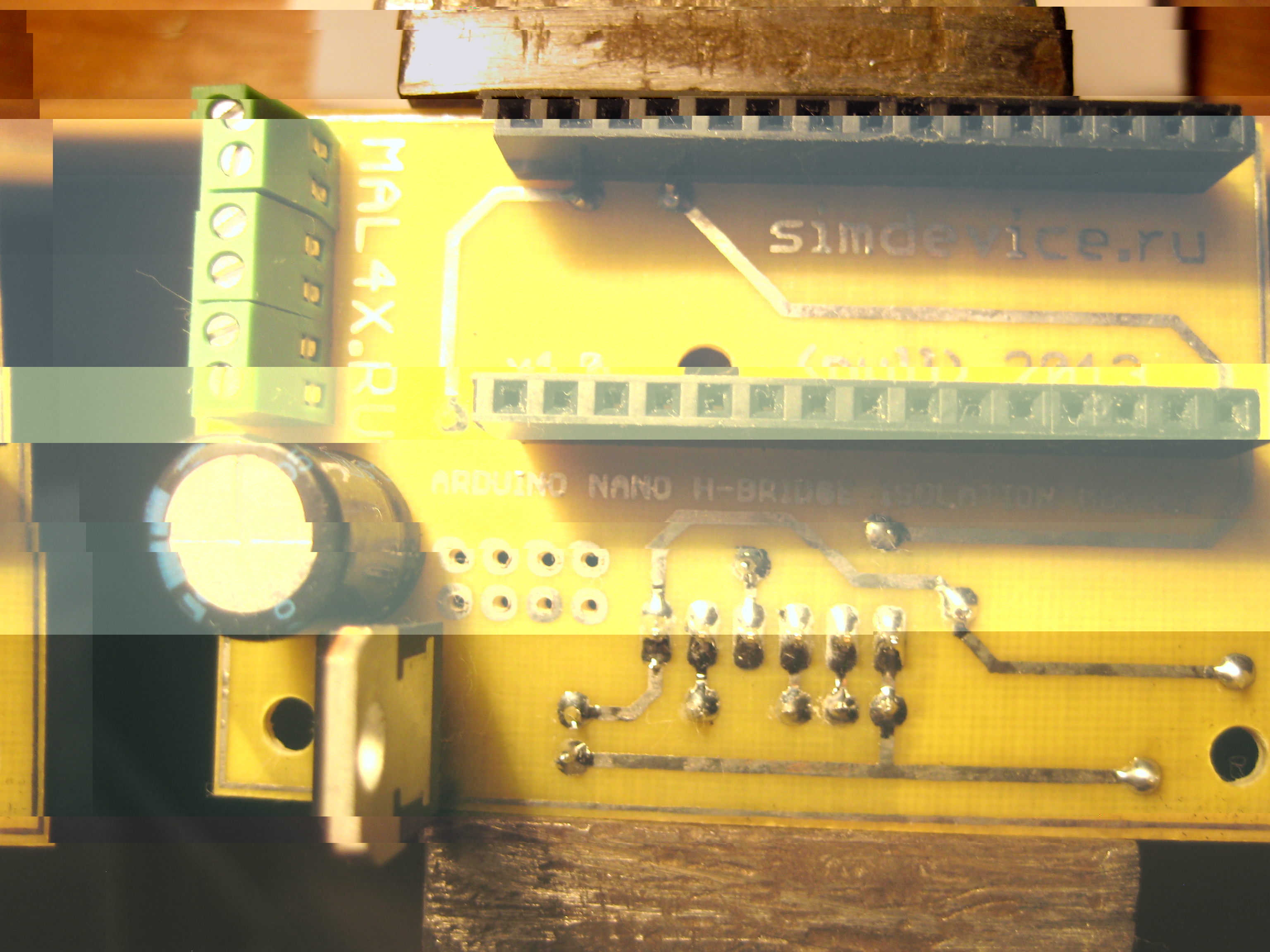

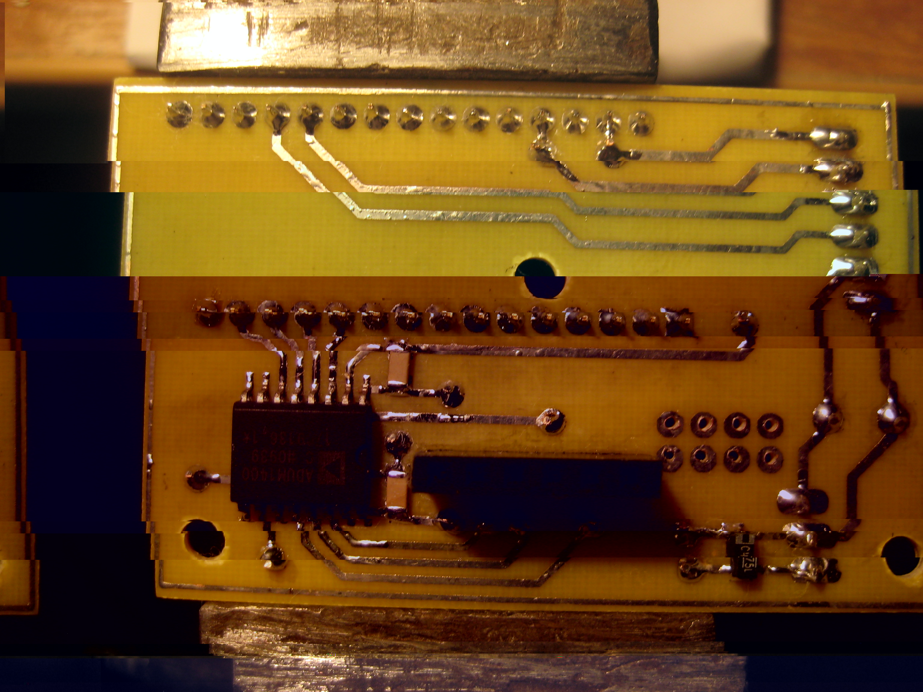

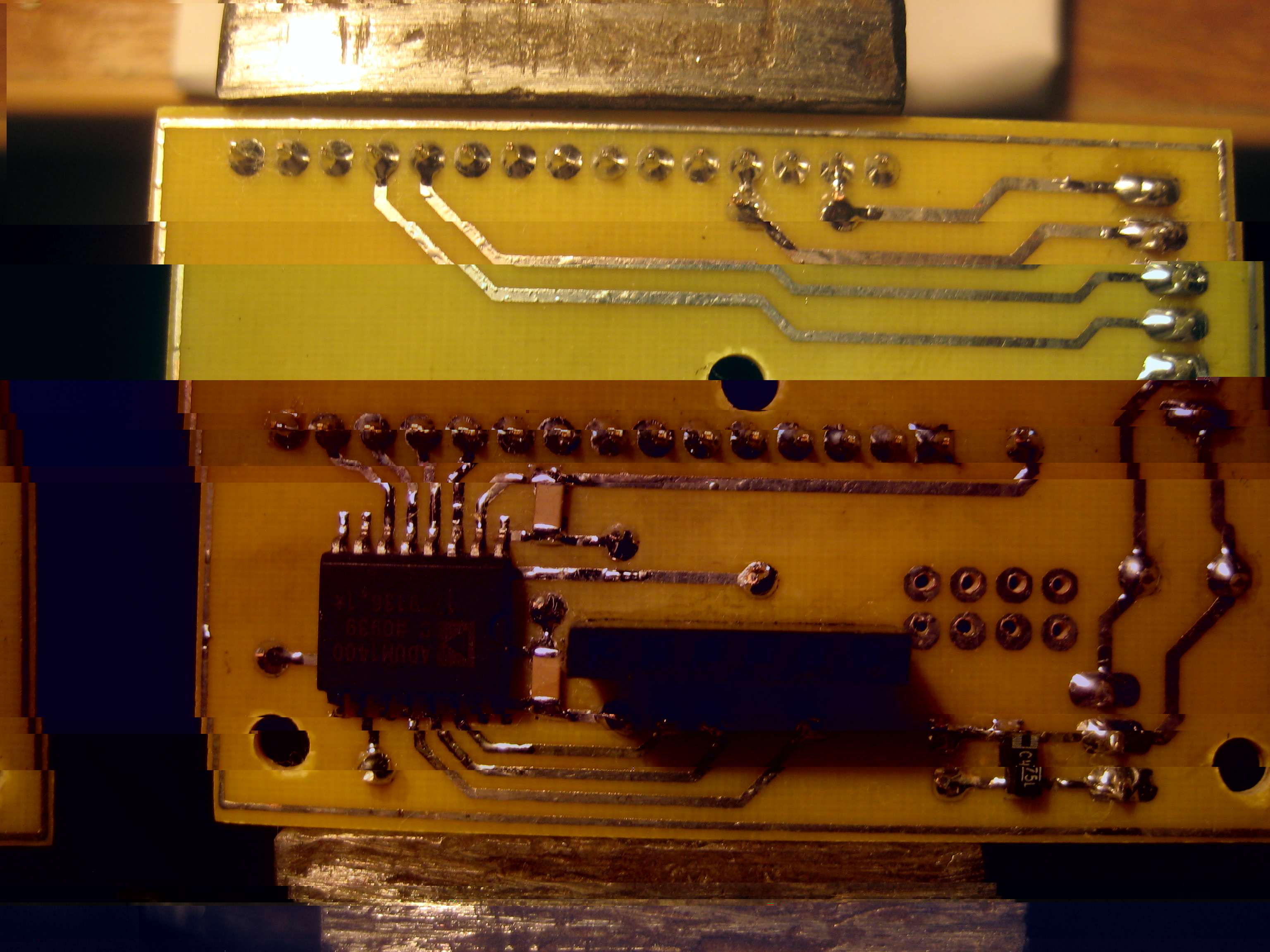

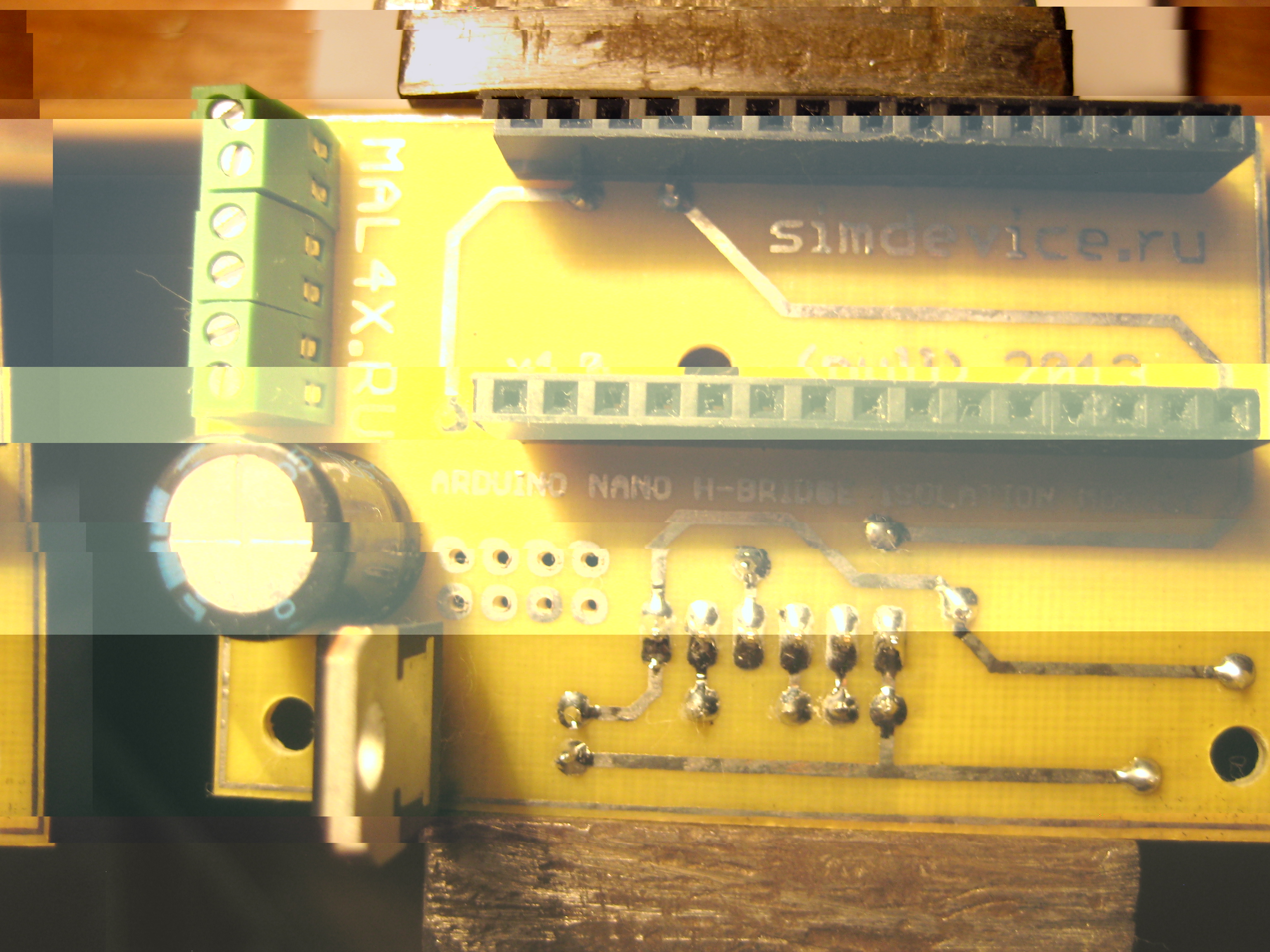

Hi all!
Today I have tested the firmware by prilad Isolated with chips ADuM1400. Everything worked perfectly. Here's a little video.
Photos of my isolation board. I designed it for use with the Arduino Nano.

Re: Arduino UNO 2dof firmware
Postby prilad » Mon 14. Jan 2013, 20:29
Hi BobBuilt!
I want to inform you (and all community) what we both (me and nullrnd) tested firmware and isolators ( based on 6N137 (for me) and ADuM1400 (for nullrnd)) on Arduino Duemilanowe. Not on Arduino Nano.
When nullrnd was try to test with Nano there were errors and failures in the FT232R. Maybe he has a bad sample of Arduino Nano?
best regards,
Ale
