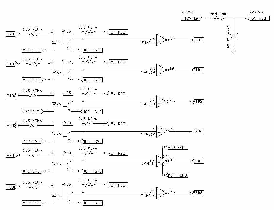

The Optolink board isolates completely the AMC1.6 board from the motor drivers, even the grounds. The only thing that is passed is the waveform which I captured here for you to see:

And then the waveform is restored to its PWM shape by 74HC14:

And here is a quick schematic for the Optolink1.0 board, without the 74HC08 part.
Did I told you yet that the isolated part is powered from the motor's battery? ;)

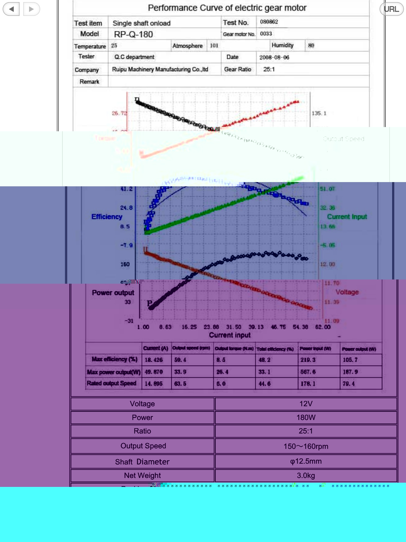

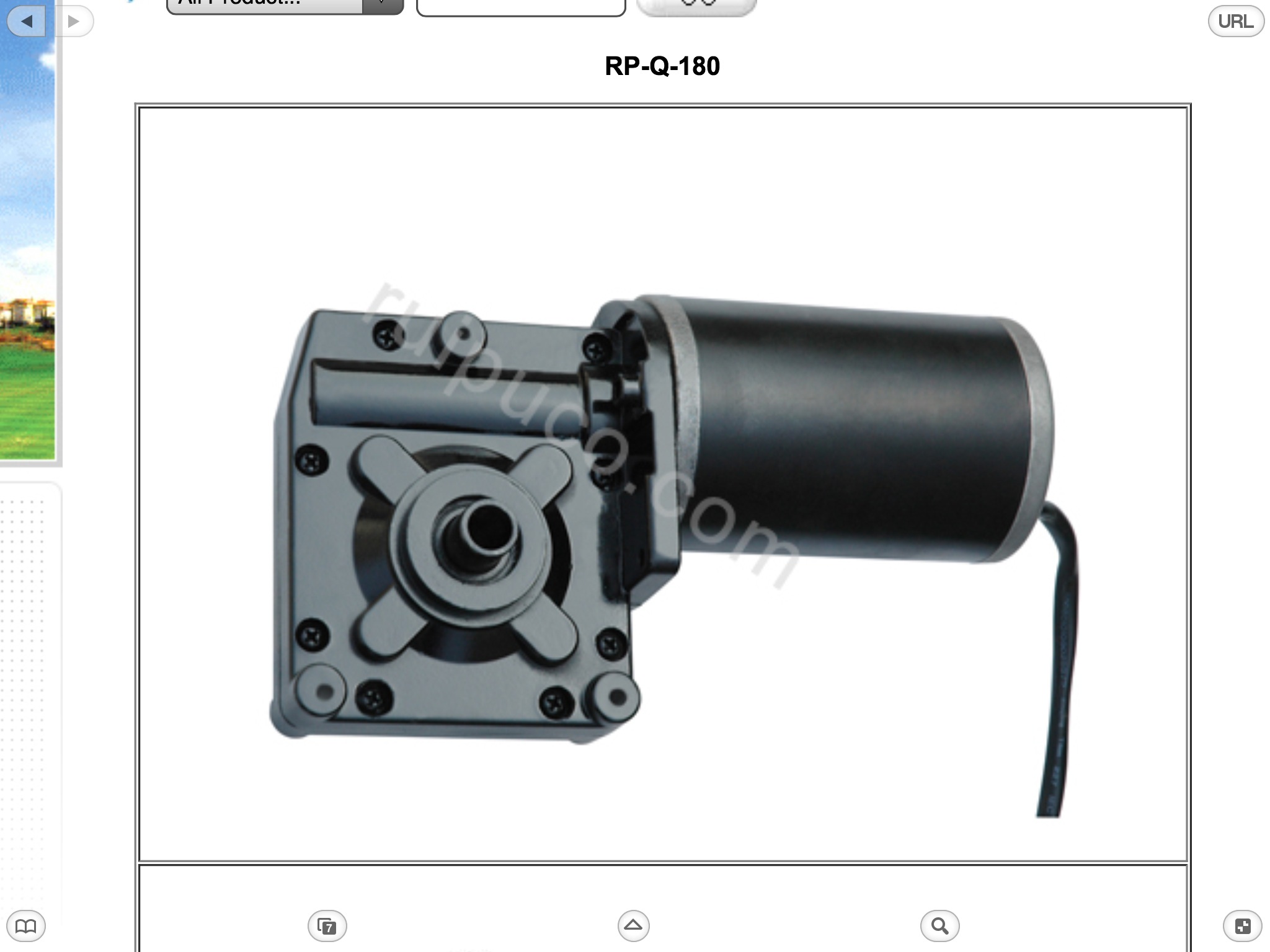

tronicgr wrote:
Can you please measure the resistance of the power cables of the motor with a multimeter? Just measure how much Ohm's is the motors coil! If the resistance is too low, that's may be the reason you get overheated and burned mosfets.
Hi Thanos,
I can't measure no resistance ! That means that the insulation is good.I tested a 10 kOhm multi turn pot and my multimeter measured around 10kOhm.I tried all scales and I measured anything between power cables and the housing.
The motors are for golf trolley applications , rpm 3600 rpm gear ratio 25 , 180 Watt.Reference is RP-Q-180
Regards
Gilles
Specifications for the motor and photo
Spec motor

vicpopo wrote:I can't measure no resistance ! That means that the insulation is good.I tested a 10 kOhm multi turn pot and my multimeter measured around 10kOhm.I tried all scales and I measured anything between power cables and the housing.
No, I don't mean between the housing and the cables, but measure the resistance between the two cables!!! The motor's coil must have a resistance right? For example the resistance for my wiper motor is 3 Ohm.
Ok, doing some calculations on the specifications of your motor I got figured out that most likely your motor's resistance is 0.8 Ohm (or 15A at 12V), that is quite low and almost the same as the IRF3205 RON resistance! But with VGS at 5V you will get only 12A power at room temperature (25 degrees Celsius). Then because of the low resistance the temperature of the mosfets junction rises up to 175 degrees Celsius to cope with the 15A demand.
One work-around would be to use the IRLZ44 in your case. Their RON resistance is about 0.028 Ohm
Personally I never had problems like that with my h-bridges, I was always using IRFZ44 and IRF3205 with no too much overheating, and never burn any mosfets! Maybe your h-bridge bottom needs to be cleaned for solder residue and then cover it with plastic coating. That's what I always do on all my boards.
