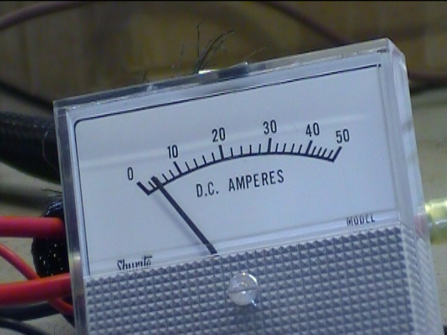

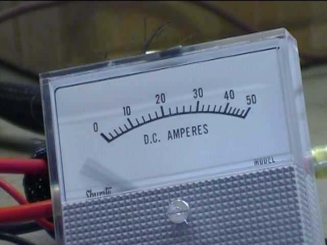

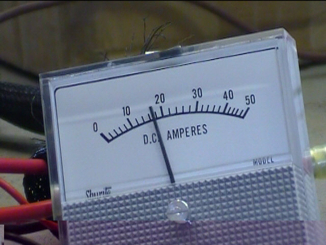

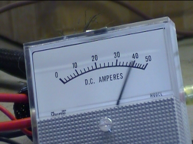

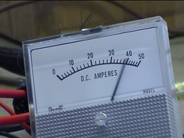

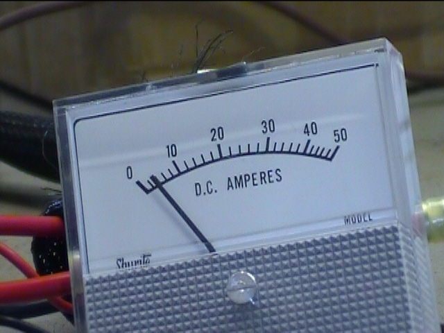

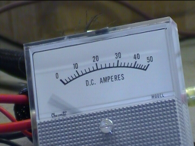

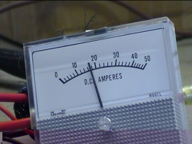

I went down to my local electronic store yesterday and purchased 0-50 amps panel meter. And, I got quite the awakening! (See pics) The current draw on startup jumped to 0 to 40 amps in a fraction of a second, then immediately dove to below the scale, then went to 18 amps, then below 0 and finally it settled on 3 amps. Everything cycled in a fraction of a second! FRYSVILLE .....would you like FRIES with that BOARD?.... :oops:
What would you suggest?
jsmith2307
The 40 amp spike
Then it dives off the scale
up to 18 amps before diving down to zero
and it settles in @ 3 amps
jsmith2307

Without the true values under load I can only continue to theorize as to what the root cause can be.
These values so far are still suspicious of other possible causes to the burn out problem.

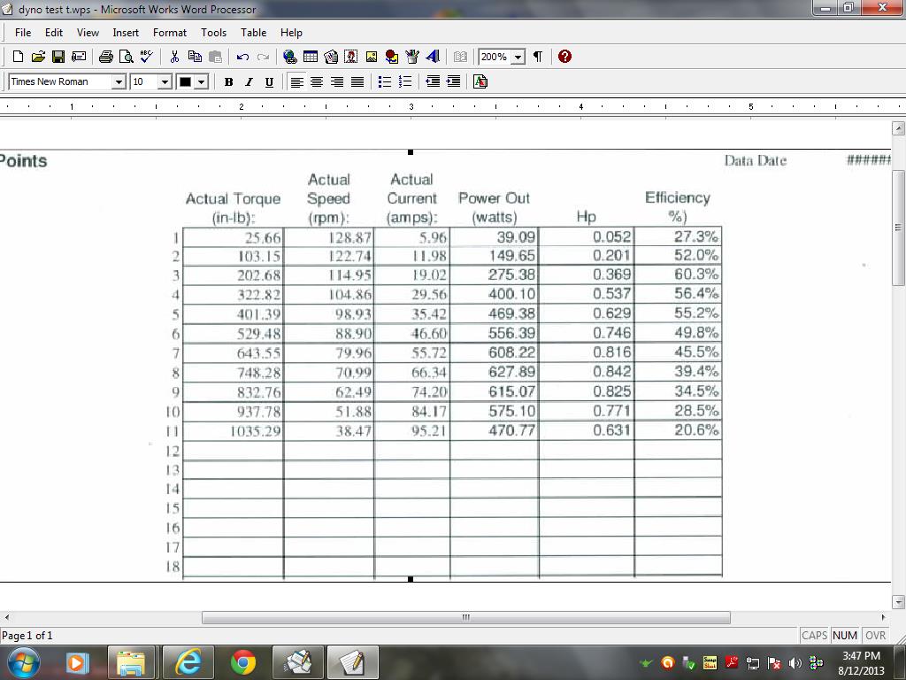

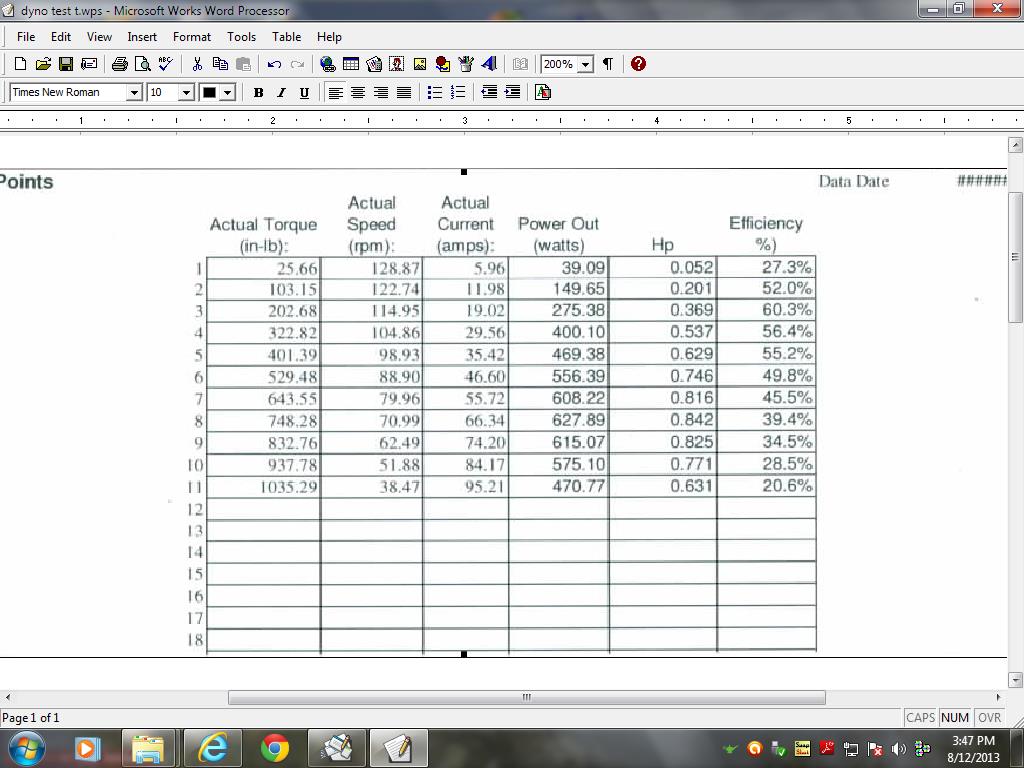

Thru my endeavors, I finally found what I was looking for! This is a dyno test of test of the motor I'm using!
jsmith2307
test of NPC-B82HT wheelchair motor
jsmith2307

Postby crs2012 » Wed 14. Aug 2013, 22:45
Wow, those are powerful motors.
I think this chart shows the potential of how your boards can get fried not only on inrush current, but during operation as well.
You mentioned earlier that 40A registered on inrush current with no load, that's 13.3333 x the no load normal operation of about 3A.
You see with just 25in/lb torque (load) that doubles to 6A. The threshold is around 103 in/lb torque (load) @ 12A because changing directions would double that up with 206 in/lb torque (load) nearly 20A. Which is just under the recommended 23A safe zone for the boards with no heat sinks or cooling fans.
IF the 200A is the threshold for inrush current limitation for a fraction of a second during start of motor,
we are guessing that 13 is the ratio of inrush current spike based on your zero load readings.
6A (25in/lb torque)x 13 = 78A <---- Much safer
12A (103in/lb torque) x 13 = 156A <--- dangerously high
20A (202in/lb torque) x 13 = 266A <--- fry board
So the last riddle to solve is how much torque is added to the motors when attached to your simulator to effectively spike your inrush current high enough to fry your boards. This theory shows just over 105in/lb torque could potentially do it.
It's a safe bet that you are probably 50in/lb - 75in/lb (torque) under normal operation, since you mentioned using a 15A fuse when you were able to operate the system. Changing directions would put you in the 100in/lb-150in/lb (torque) range which is brushing up against the 15A fuse limit. Which is also showing you could theoretically be crossing the threshold for 200A+ on inrush current.
In ANY case, these motors will not stall before your boards fry. They are VERY powerful, and can pull nearly 100A with up to 1,000 in/lb torque.
You MUST have some sort of limiter in your circuit if you choose to continue using these motors and those boards.
One last note... The fuse you are using may not be sufficient as a safety device either... If the fuse blew and the board still fried, that could be an indication that the current is arcing through the fuse and frying the board as well... Since I don't know the schematic to how you have your battery and boards wired, I can't really comment on this topic too much. But certainly another issue that needs some attention as well.
