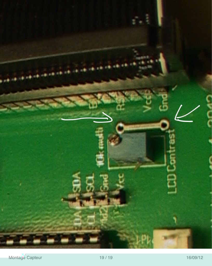

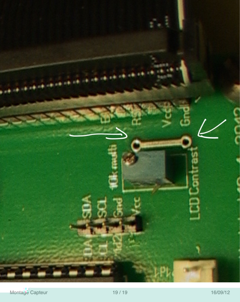

That seems to be the lcd connection.On the first page from this topic under the tittle dataloging ,Thanos show how the data come from the amc1.6 with the terminal application.
You can download this application on first page terminal2113 zip connect your board and test if the communication is good.
parameters 115200 , 8bit ,no parity ,no check (i don't remember exactly).
If the communication is OK that should be the lcd,connection.
There is a jumper near the pot for yhe lcd contrast did you sold it ?
And what a profesional PCB !!
Very good !
Regards
Look at th picture.If the holes are not metalized I think you have to sold a thread between the 2 face of the pcb.
Postby jsmith2307 » Sun 16. Sep 2012, 18:16
Greetings,
Thanks for the info on terminal app. No soldering required for the jumper next to the LCD pot, it was put in by the folks at Sunstone PCB, and I checked with a multimeter before populating the board...good continuity.

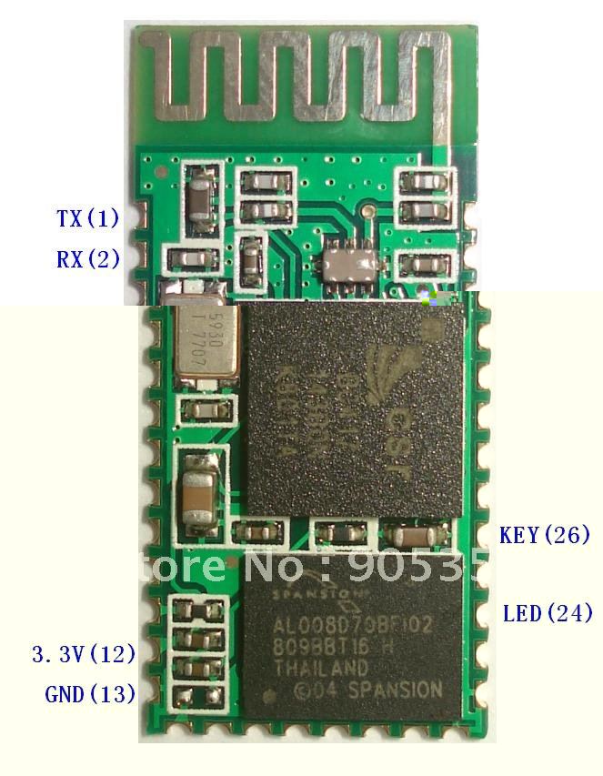

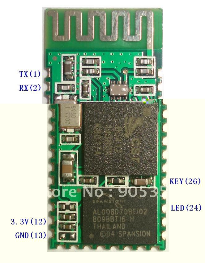

Postby speedy » Thu 27. Sep 2012, 23:57
Hi Thanos :
since I have a communication problem with my hand made FTDI module ... not a programing one ... just a Rx/Tx problem ...So waiting for my ordered ATMEGA644 and the 22.1184 crystals .
And for future improvements ...I have a little question ... can we use a Bluetooth serial link module like this one on the AMC1.6 side . virtually connected to a laptop built in Bluetooth serial com port or we use a Bluetooth adapter ... that x-sim can direct it's communication to it .
http://www.aliexpress.com/item/HC-06-Bluetooth-to-UART-converter-adapter-Bluetooth-UART-RS232-COM-serial-converter-Transceiver-Module-free/446998584.html
What do you think ?
regards
speedy ;)
speedy
Posts: 148
Images: 4
Location: Alexandria, Egypt
Has thanked: 14 times
Postby tronicgr » Fri 28. Sep 2012, 17:03
I see that supports speeds up to 115200bps, but I'm not sure if it can handle fast transitions of 1ms... maybe...
