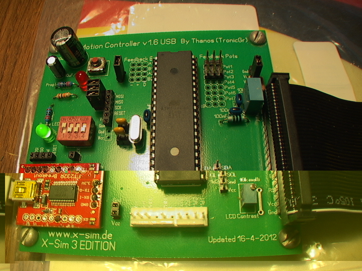

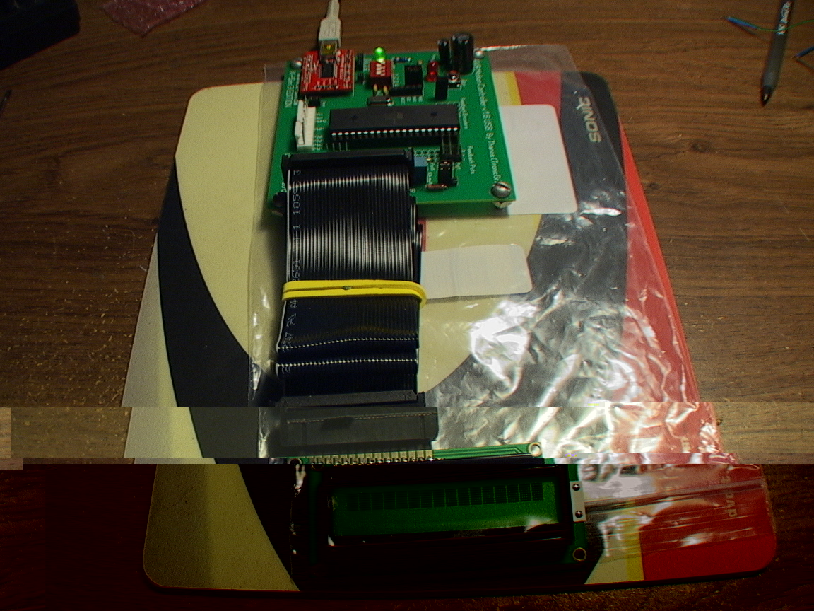

Postby jsmith2307 » Sun 16. Sep 2012, 04:37
Greetings, :D
Well I just got finished with my new AMC 1.6 and I loaded up FTISP for AMC1.61.1f, and it loaded up fast. The LCD screen indicted all the usual things, however after powering down, and reapplying power I got nothing but the squares that were on it before I first loaded the program. I again loaded the program up, and still nothing but squares. I purchased two atmega644’s so I tried the other chip and it loaded up just fine. Once again all the usual things were there, after reapplying power I have nothing. Any ideas what is going on? Did I miss something? I'm at work and this is not the computer that has X-Sim3 on it...could that be the problem? When I power up the old AMC1.5, I get a full read out no matter if the device is connected to the computer or not!

Postby vicpopo » Sun 16. Sep 2012, 08:12
Try to adjudt the lcd contrast with the multi turn potentiometer at the bottom right on the board.
Sometimes it's the solution!

Postby jsmith2307 » Sun 16. Sep 2012, 17:36
Greetings,
Thank you for your input. I tried the LCD pot, turning it down to where I couldn't see the squares, and I turned the opposite direction, in addition I tried putting the 3 jumpers next to the mosi,miso, and sck on/off and still no luck! See pictures.
