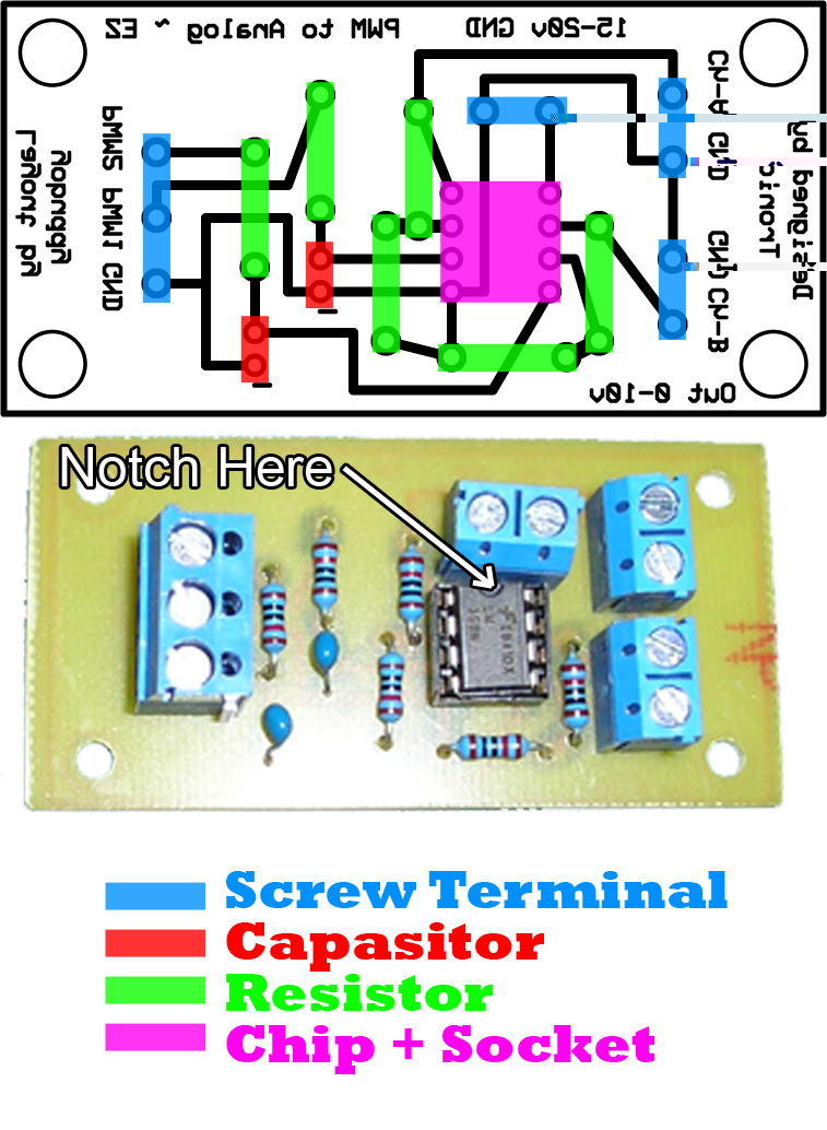

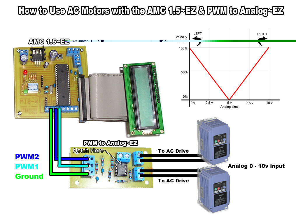

Thanks for the schematics vicpopo, I have been a bit occupied and I can't be able to post. Now I have some time and I want to test this voltage adapters.
I also have one layout from a friend of other forum called yobuddy. When I receive components I'll do the necesari adaptations in my hardware to know what is the best solution for the inverters I have. This is the wiring diagram for the AC inverters:
The image is based on a AMC 1.5 EZ series that yobuddy did, take care of use PWM1, PWM2 and GND pins in your boards
There is also the layout in PDF format and component list ready for digikey order.

Postby tronicgr » Tue 11. Sep 2012, 15:32
fooons wrote:Hi,
PWM to Analog~EZ_Layout.pdf
PWM to Analog~EZ - BOM.csv
Actually that schematic is wrong. Its intended for use with Uni-directional drive modes, that the PWM signal drives both speed and direction with center being at 2.5v. Using Bi-directional control method is more safer as the motor will be 0% speed if for some reason the AC drive is disconnected from the AMC1.6.
