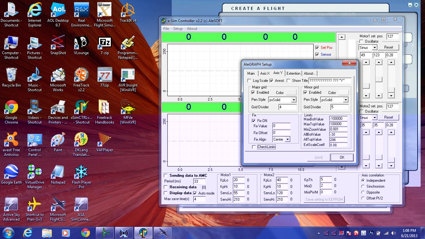

I have using AMC16_mega644_18mHz_byALE_fix3 with xSimCTRLv2.2eng about three weeks now and I can’t the Y axis motor to go from CW to CCW, it remains in CW no matter what I do. The only way you can get it to go into CCW is manually exchange the leads on the motor driver. It worked with Tronic’s program. The X axis motor works fine. I’ve exchanged motor drivers and motors with the X axis and they check out fine . I’ve checked all the wiring from the AVR 1.6 to the motor drivers with a multimeter and all checked out fine . Motors have been exchanged. Is there something I missed? Also what about “AleGRAPH setup” (see attachment) any thing to worry about there?

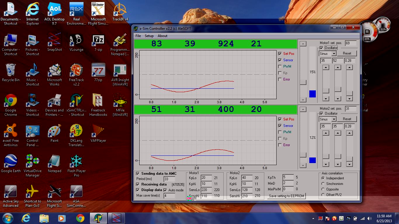

jsmith2307 wrote:I have using AMC16_mega644_18mHz_byALE_fix3 with xSimCTRLv2.2eng about three weeks now and I can’t the Y axis motor to go from CW to CCW, it remains in CW no matter what I do. The only way you can get it to go into CCW is manually exchange the leads on the motor driver. It worked with Tronic’s program. The X axis motor works fine.
Hi, jsmith2307.
I have only one idea - do you connect BOTH feedback potentiometers to X and Y axis? If Y potentiometer do not connected correctly, Y motor will rotate only to one direction...
Can you make screenshots with working xSimCTRLv2 (when sending and receiving data is ON)?
jsmith2307 wrote:Also what about “AleGRAPH setup” (see attachment) any thing to worry about there?
"AleGRAPH setup" dialog do not help you in this case. It may be used only for setting graphics parameters - limits, colors, ets..

Postby jsmith2307 » Sun 23. Jun 2013, 21:59
Greetings,
Is this what you asked for? Video and attachment.

Re: Alt. firmware and GUI for Thanos's AMC1.5 & AMC1.6
Postby prilad » Sun 23. Jun 2013, 22:26
jsmith2307 wrote:Greetings,
[YouTube] http://youtu.be/icKVisbbIM4 [/YouTube]
jsmith2307
Hi, jsmith2307!

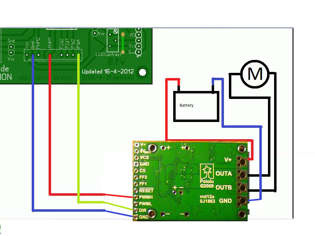

The trouble looks like missing direction contact. When "PWM Value" at the screen changed sign, direction pins must change levels. Can you check it? And what H-Bridge do you use? Connection diagram?
Redards,
Ale

Postby jsmith2307 » Mon 24. Jun 2013, 16:40
Greetings, :D
I'm using a pair of Pololu High Power motor drivers 24v23.
:?: Please explain how to do this! :?:
Postby prilad » Mon 24. Jun 2013, 18:48
jsmith2307 wrote:Please explain how to do this!
Hm... Connecting diagram is ok... I don't know, but you can check with multimeter (voltmeter) potential on pin DIR (p1d1). It must change level from +5V to 0V and back when PWM is changed sign.
And one more thing - you can try to change connection to DIR pin from p1d1 to another control pin from pair..
Rergards,
Ale
