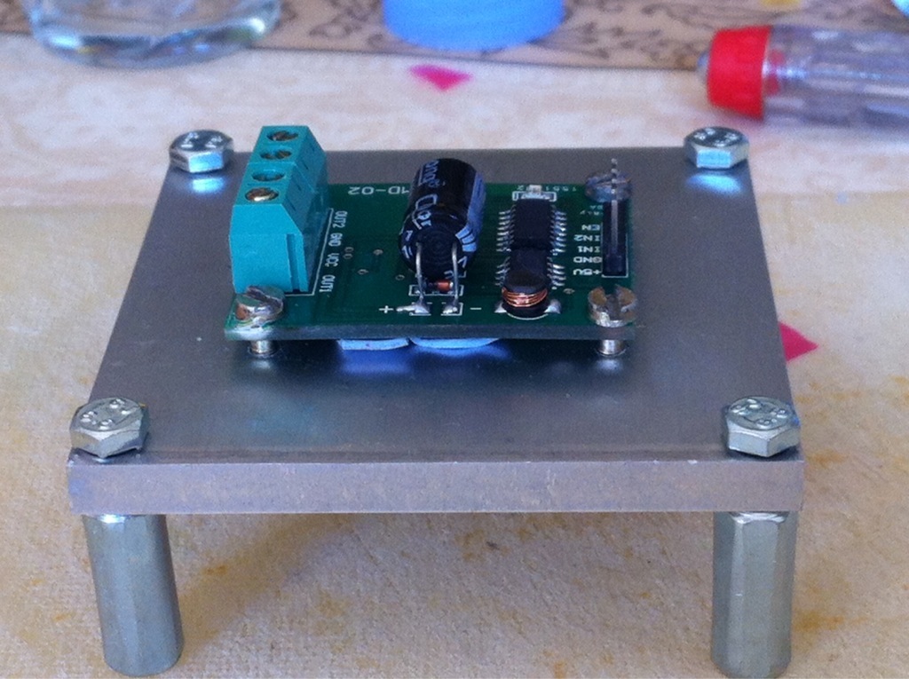

vicpopo wrote:
tronicgr wrote:Hi again,
Since I had my equipment ready I took another video of the HMD-02 motor driver.
Hi Thanos,
I burned my 2 hmd-02 with my big worm motor!! :oops:
I will confirm to all x-simer that this simple h-bridge is not suitable for bigworm motors!!
I get no problem with wiper motors although you didn't validate it.
Happy that you've got the PCB. :D
Best Regards
Did you put a fan on the hmd-02 before testing? It may have heated up very quickly, hence burning up.
I had the same issue with a JRK at the beginning even with a wiper, it took less than 30 seconds to overload the chip without any cooling whatsoever.

motiondave wrote:
Hi Thanos,
Best Regards
Hi Motiondave
Instead a fan I puted the h-bridge on a big aluminium chunk (thickness 6mm).Look at the picture below.
Hmd-02
I tested with a wiper motor and it had worked great.
Look a the post above.
http://www.x-sim.de/forum/viewtopic.php?f=39&t=132&start=120#p1789
As Thanos adviced to me I puted a 0.1microF capacitor between motor phases and I used a big battery paralel to the PSU.
As you said before this motor suck a lot of current!
Best Regards
Postby motiondave » Sun 2. Sep 2012, 09:19
Big aluminium chunk looks good, although a fan would still help disperse heat, especially where the chip mounts onto the heatsink.
