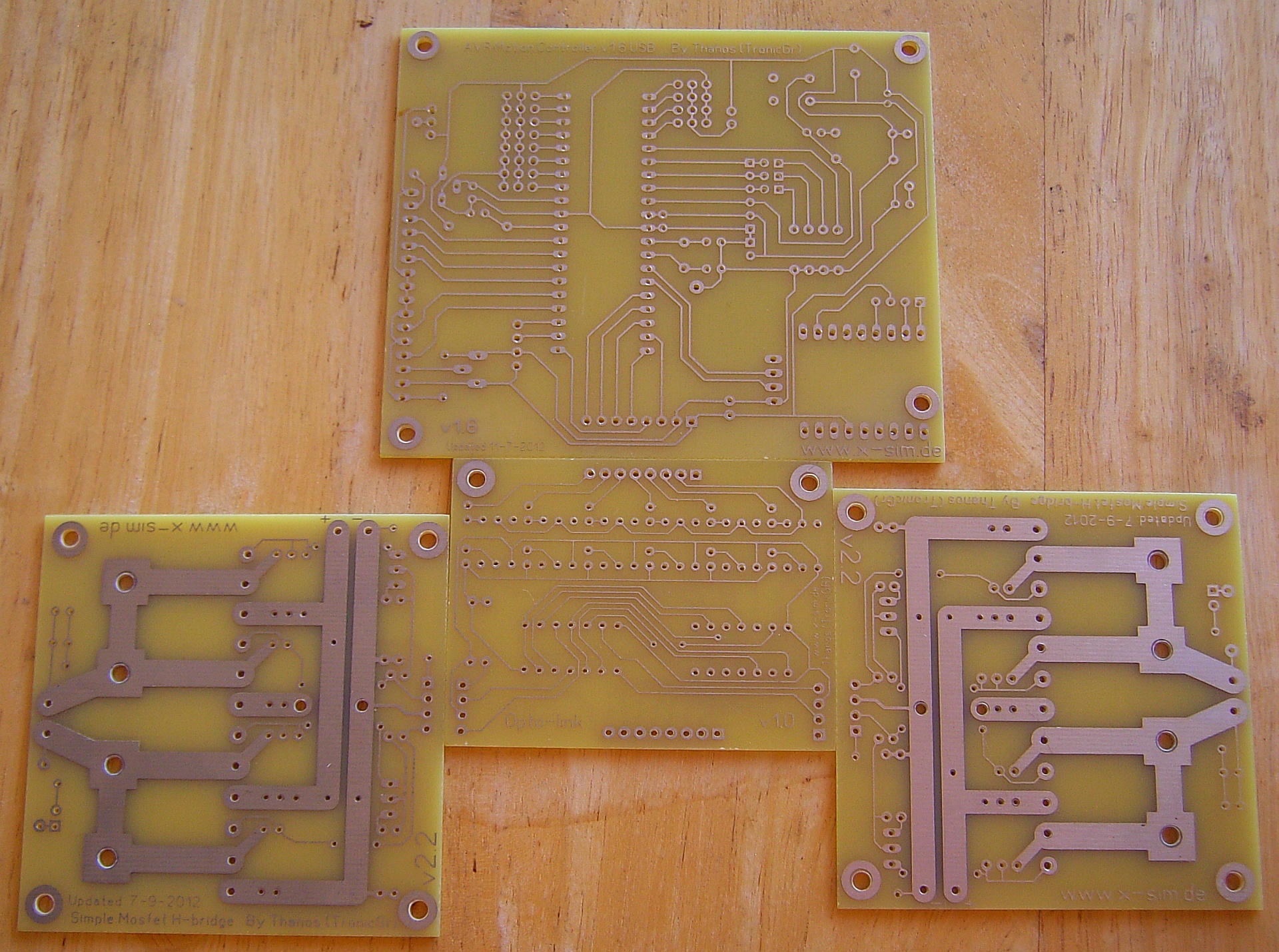

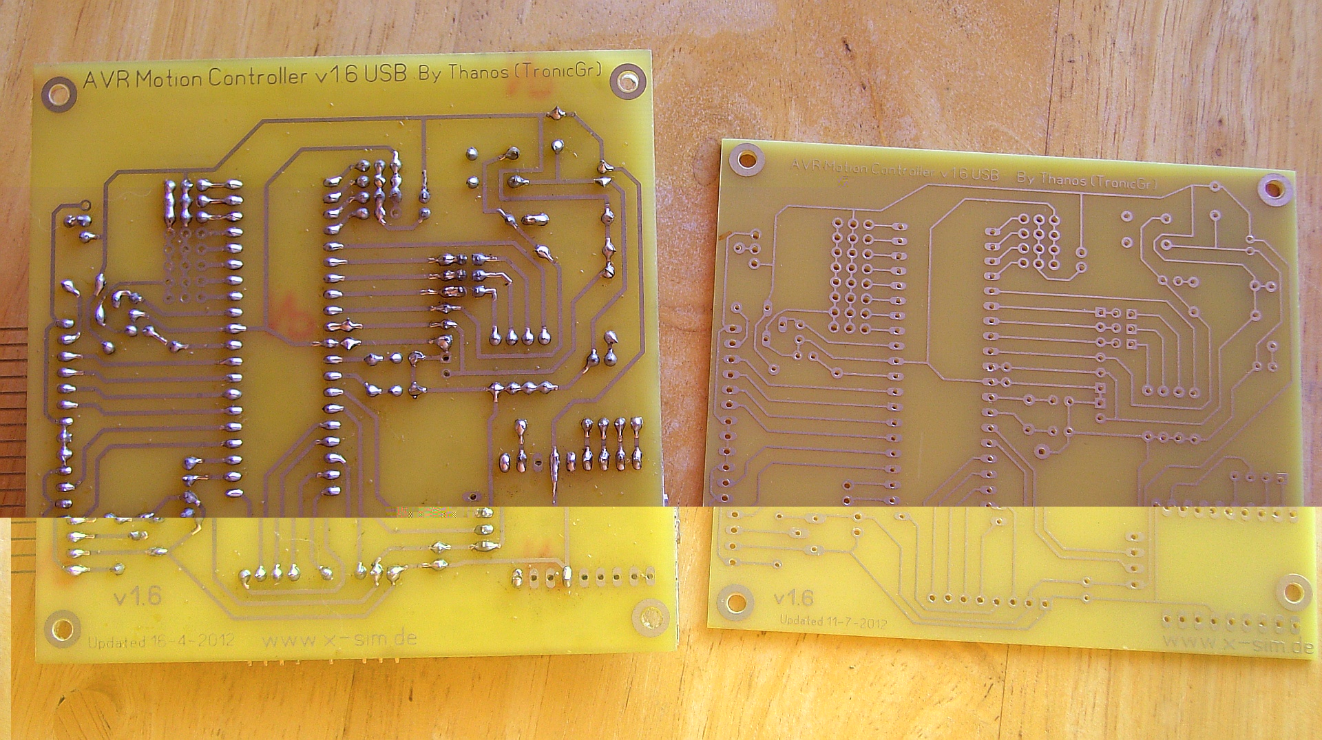

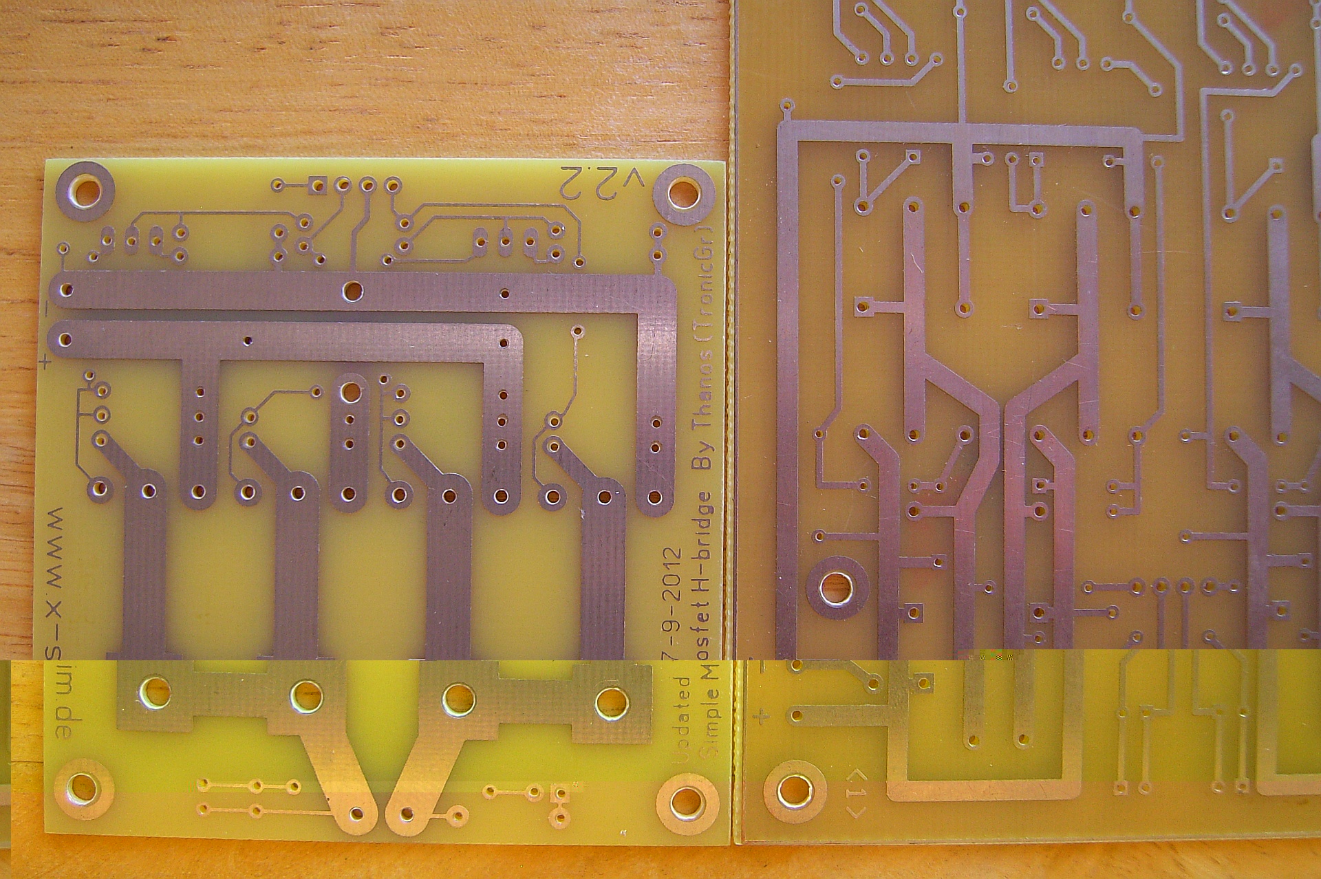

Today I received from Gilles (France) the two-layer boards of AMC1.6, Optolink and SMh-bridge2.2 I mentioned in older posts. I'll try to have them ready soon to test them all and try to make a little assembly guide for them as I do it. I hope I have enough parts left for all this.
The new AMC1.6 board is a little smaller, more compact connector for the PWM and directions, less wasted space.
I made the power tracks as large as I could for the SMhb2.2. See it next to the old DSMhb1.2. These thick tracks are rated 14A and even more if they get reinforced with extra solder.

Postby motiondave » Sun 2. Sep 2012, 01:04
Well done on the pcb :D
Thats some groovy tracks there!
