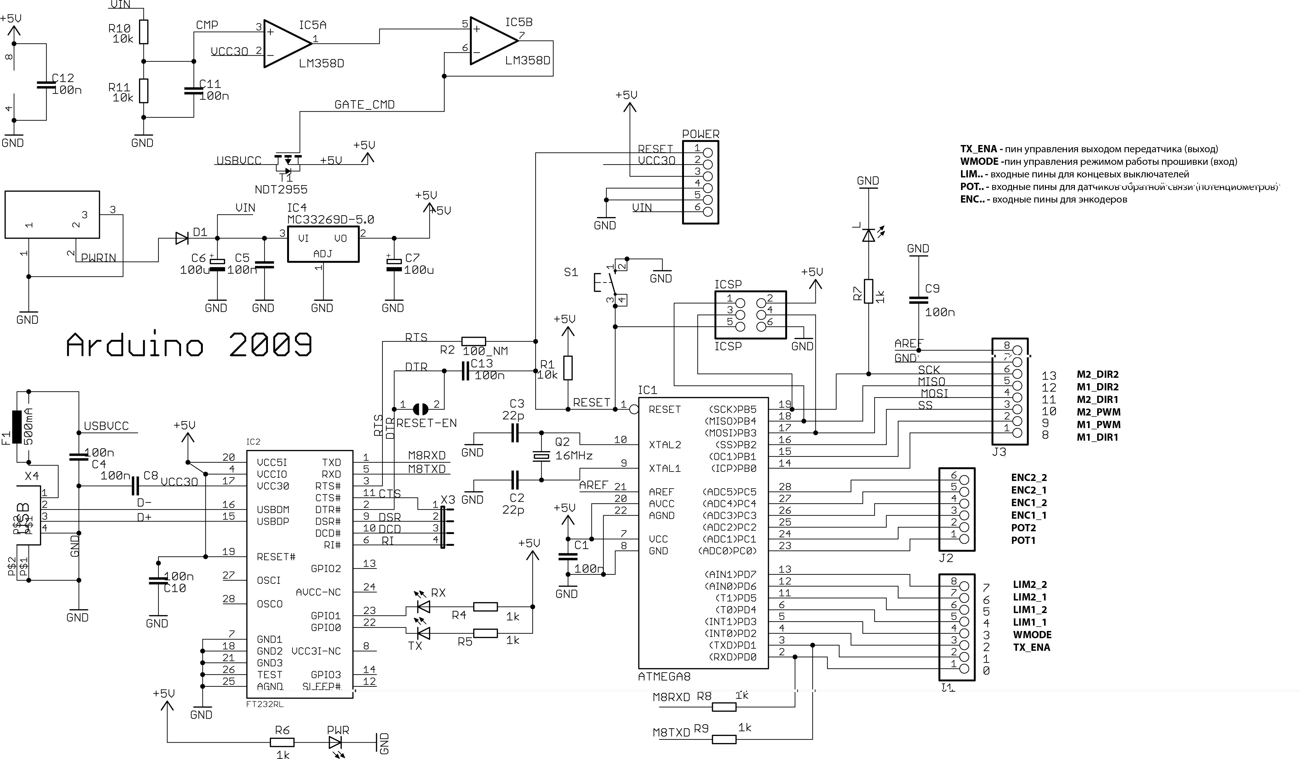

Hi, Guys.
I'm created the port of my firmware for Arduino Duemilanove platform (with atmega328p).
x-sim_arduino_by_Ale.zip
x-sim firmware for Arduino (COM-port speed = 57600)
(7.29 KiB) Downloaded 1149 times
Here is the video with work demonstration:
Schematics with pin definitions
prilad

sirnoname wrote:What is the difference between Arduino Duemilanove and UNO?
There is one difference - USB to RS converter chip. But it is doesn't matter.
There is you can found soft for uploading HEX files to Arduino:
http://xloader.russemotto.com/
prilad

I think this is a great project and you should open a new thread in this subforum with a title like "Arduino PID firmware". This post are shown in the project gallery in the interface subsection and are interresting for the newcomers. You should also talk there about the the UNO because it is more known.
Do you have a PID count/second for me?
