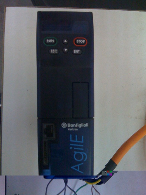

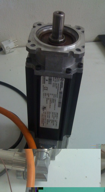

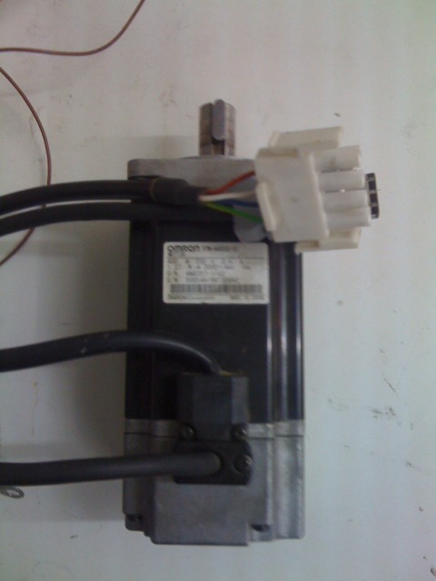

Postby fooons » Sun 26. Aug 2012, 13:01
Hi Thanos,
A friend has borrow me that hardware to make some tests. Now I have a question for you. It is possible use this with AMC 1.6?
