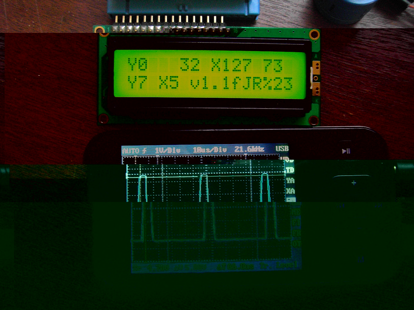

Postby tronicgr » Fri 17. Aug 2012, 15:38
Actually it was an MP3 player before they altered its internal electronics a little bit to convert it to a single channel portable oscilloscope.
The model is DSO Nano DSO201:
DSO Nano DSO201 Pocket-Sized Digital Oscilloscope Review
I used a custom firmware on it developed by BenF: DSO BenF Firmware v3.64

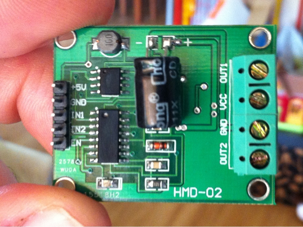

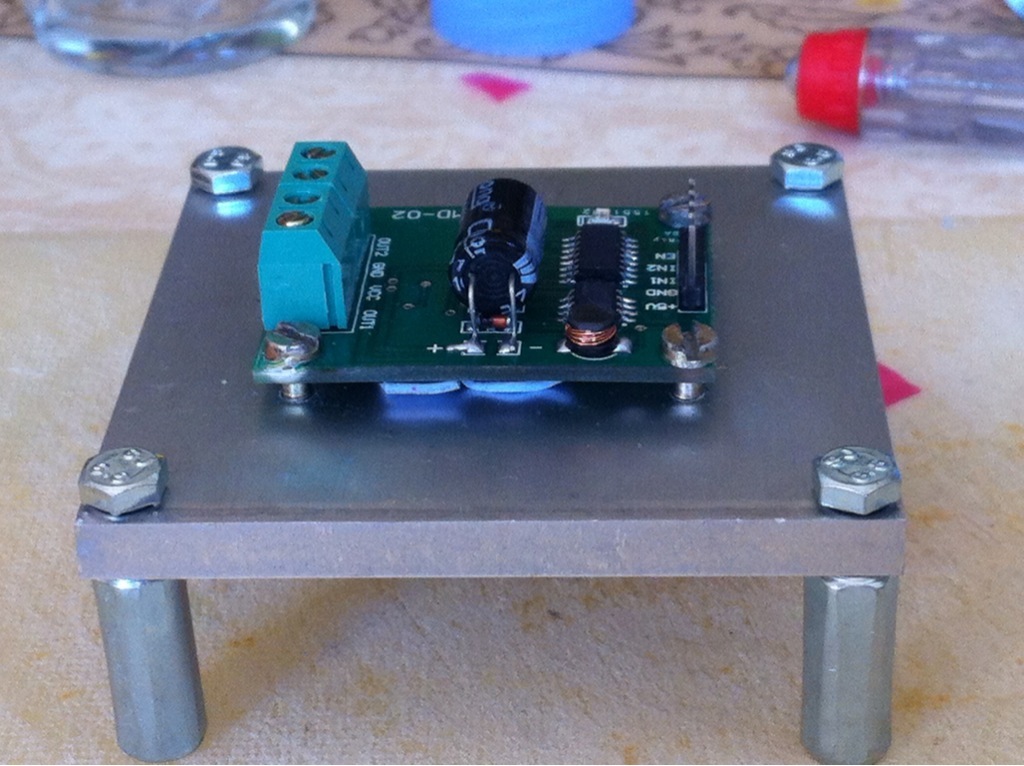

Postby vicpopo » Fri 24. Aug 2012, 00:00
Hi Thanos,
I made the test amc1.6 and the new simple h-bridge you found on e-bay ,link below:
http://cgi.ebay.fr/ws/eBayISAPI.dll?ViewItem&item=220984305430&ssPageName=STRK:MEWNX:IT&_trksid=p3984.m1497.l2649
It works very great , a very good response , a very good positioning without motor shaking, it looks very fast and dynamics.I can't make very special tests but you will match this perfectly and I'm sure that you will find very good results.I don't know what could happen full loaded but without that seems to be interesting.
One another point the motor isn't from far noisy.If this simple h-bridge is as the dual you mentioned in a post there is something to isolate in the h-bridge both circuit ( power and driving)
The next step is the test with the big worm motor (180 Watt)
I forgot I used always the firmware amc1.6 v1.1e my favorite! :D
A little video from the test as usual:
And pictures from the simple h-bridge:
Simple h-bridge
Simple h-bridge
Postby tronicgr » Fri 24. Aug 2012, 17:08
Hi Gilles,
Thanks for the nice words and the wonderful demonstrations.
I also noticed some noise on my servo motor on the highest speed where the PWM pulses are close to 98% and higher. As it says in the ebay page it accepts pulses up to 98% so I guess that is true. To fix that I adjusted my code to jump to 100% (constant 5v signal) after 98%. I haven't tested it yet but you can try it to see if there is difference. Also in this version 1.1f I added adjustable end-point limits with a potentiometer attached on POT3, and its value is displayed on the LCD as percent. So now you can set the end-limits from 5% to 95% for each side of the motion. Try it to get the 90 degree angle rotation you needed.
