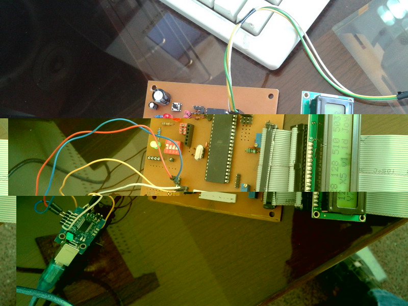

Postby hooshang » Wed 15. Aug 2012, 08:50
motiondave wrote:Hi hoosang, do you by chance have a diagram drawn up for the setup of 1.6 on breadboard?
thank you and No my freind

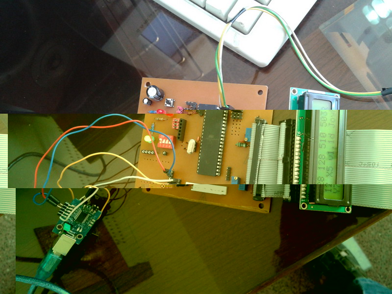

anyway as you can see i could programmed the atmega 644
but still another problem
when i was adjusting the KP,as Tanos explained in the video.
start force sender and then force profiler (x-sim 2089)
and push the green start botton.LCD start to show every thing ...x-sim3 logo..kp number..
values..blub blub blub.....nonstop :?: :!: until i push the stop botton again and every thing goes back relax.
so what is my problem or mistake freinds
thank you & regards
Hooshang

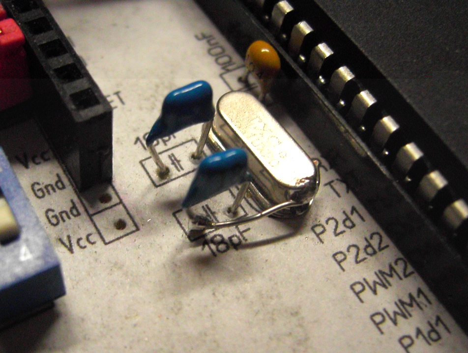

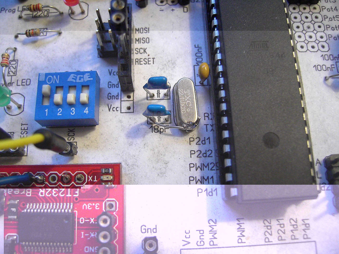

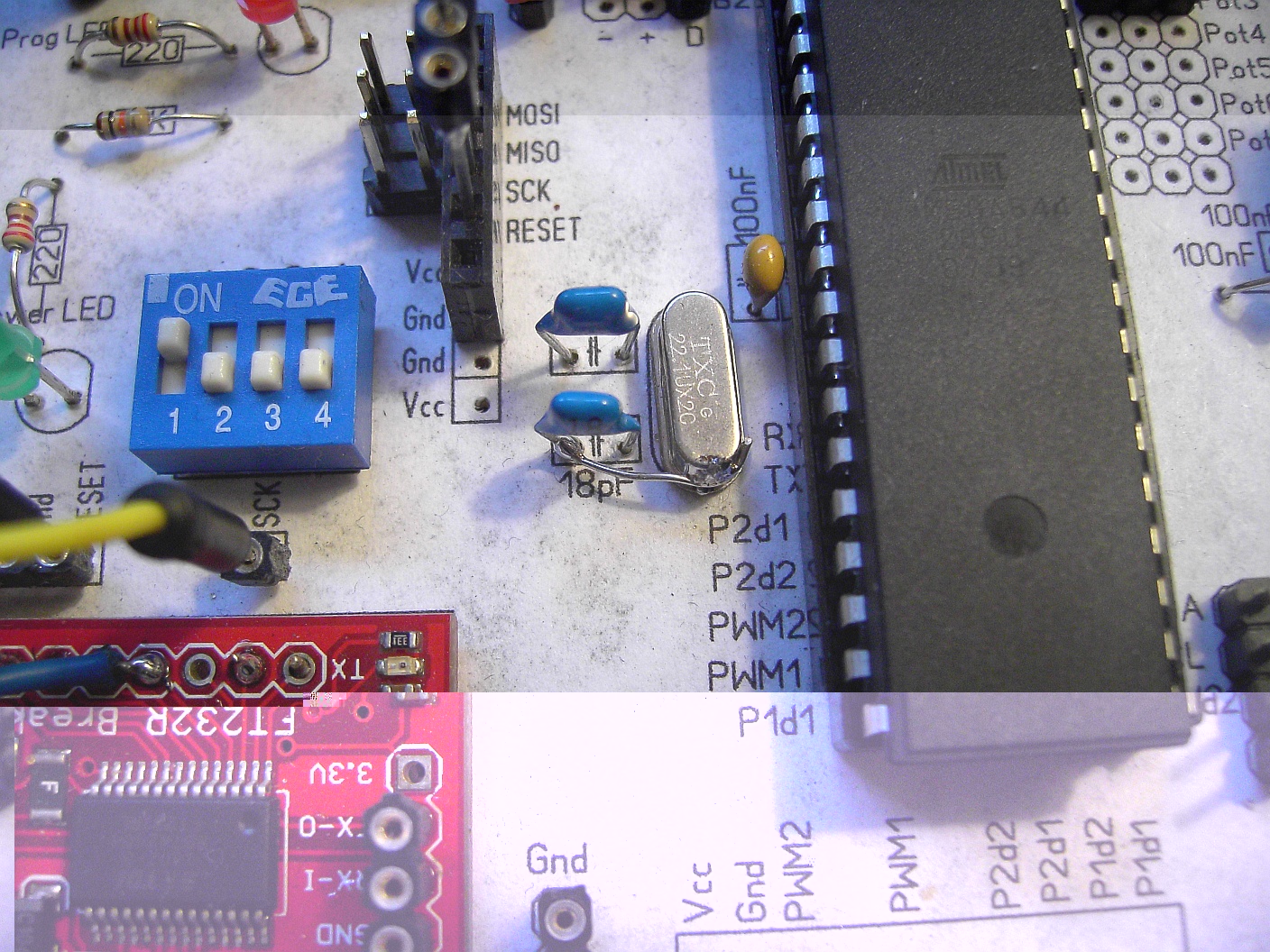

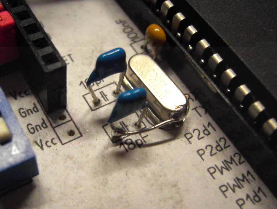

Other than that you may try grounding the Crystal case in case your crystal has electric ringing due to PWM or Serial interference.

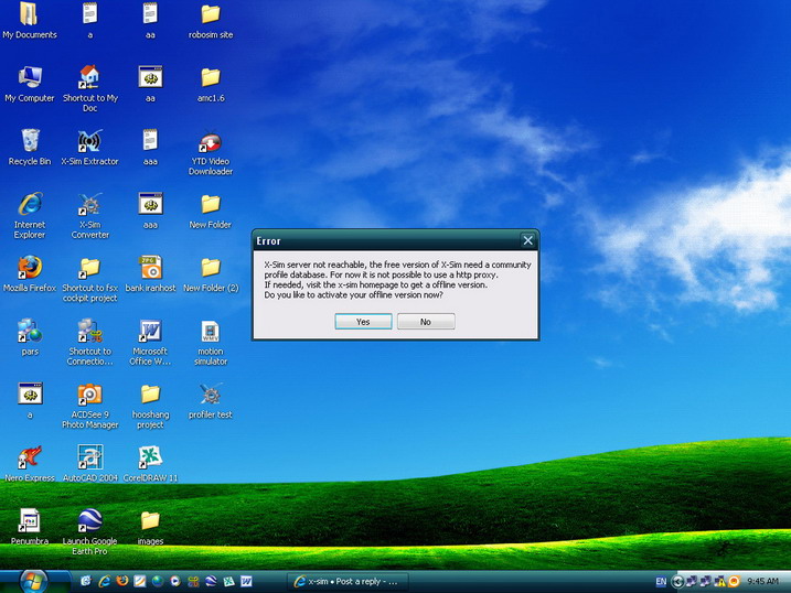

Postby hooshang » Thu 16. Aug 2012, 07:56
hello & thank you freinds

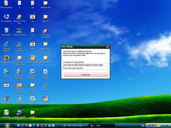

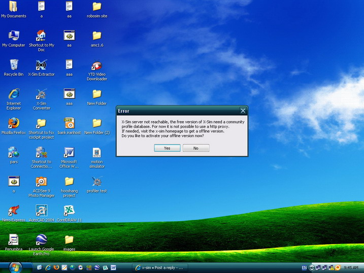

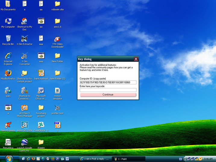

grounding crystal didn't work but about x-sim version 3006,i've downloaded.
but i couldn't run it because of not finding feature key,i read somwhere
sirnoname wrote "press on top software then (terms of private usage)"
but all i have ,first is this:
then this:
what is the procedure?
regards
Hooshang

Postby tronicgr » Thu 16. Aug 2012, 14:39
Although it doesn't have to do anything about the AMC1.6 I'll answer your question:
You need to have the computer running the extractor connected to the internet... simple as that.
About the reset thing, you may need to clean the bottom of your board with solution to remove flux residues and then spay it with plastic protective layer to prevent rust. This is usual procedure for homemade PCBs.
Also try using bigger delay on the USO string, try with 5ms delay or 10ms. Depending on the materials you choose for the capacitors you may have a slight deflection on the crystal clock rate that is messing with the very precise uart timming.
