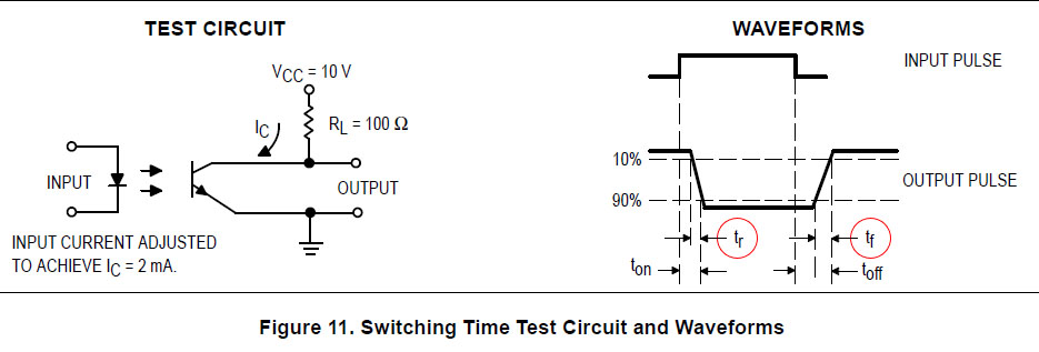

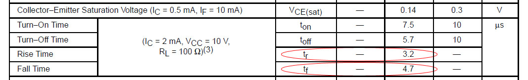

Or you think, that 1 MHz is very "slow" for this mission? But you use in your "optolink" (http://www.x-sim.de/forum/viewtopic.php?f=39&t=132&start=20#p978) optocouplers 4n35, which EIGHT times more SLOWLY than ADUM1400ARW.
In 4n35 Datasheet we can see, that rise time (Tr) for output pulse is 3.2 us and fall time (Tf) is 4.7 us.
It mean, what full pulse width can not be smaller then 3.2+4.7 = 7.9 us and max pulse "frequency" is only 127 kHz instead 1MHz for ADUM1400ARW
4N35 Rise and Fall times description
4N35 Rise and Fall times values

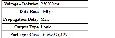

And 4n35 has propagation delay more then 5.7 us (Time-off delay) instead 100 ns (0.1 us) for ADUM1400ARW or 65 ns for ADUM1410 .
