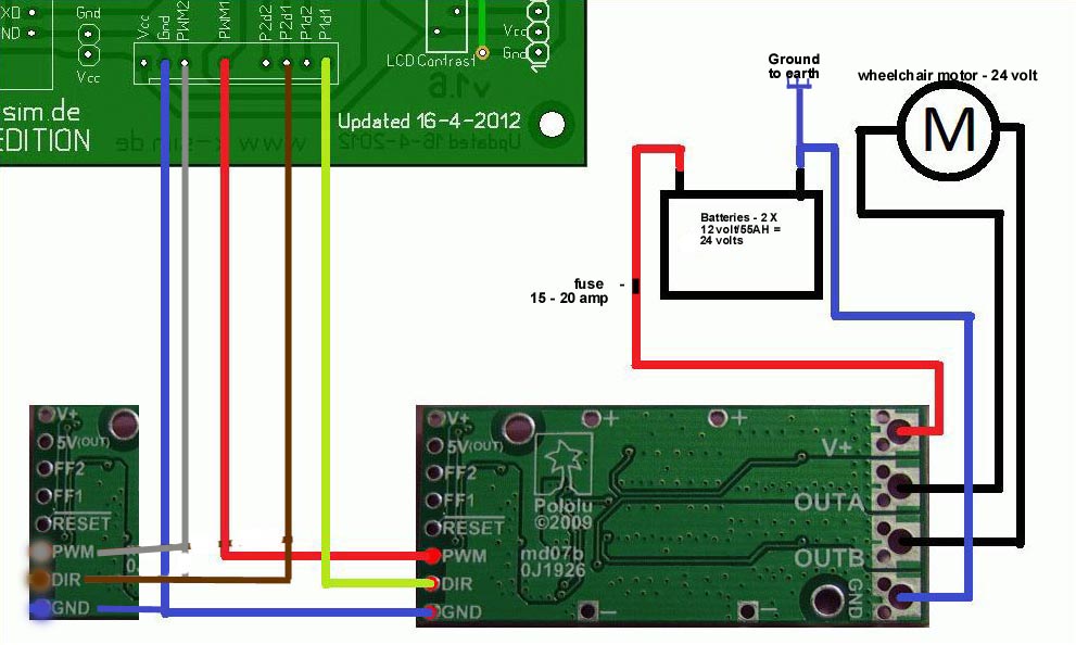

jsmith2307 wrote:I just burned up another Pololu high powered 24volt 23amps motor driver.....AGAIN!!!!!
It's very strange. Please show me the wiring(connection) diagram between AMC and motor driver.

Postby jsmith2307 » Tue 6. Aug 2013, 21:42
Greetings Ale & crs2012,
I'd like to thank you for all of the good info!
Ale, the second attachment is for you! The ground to earth was added after the latest blow up!

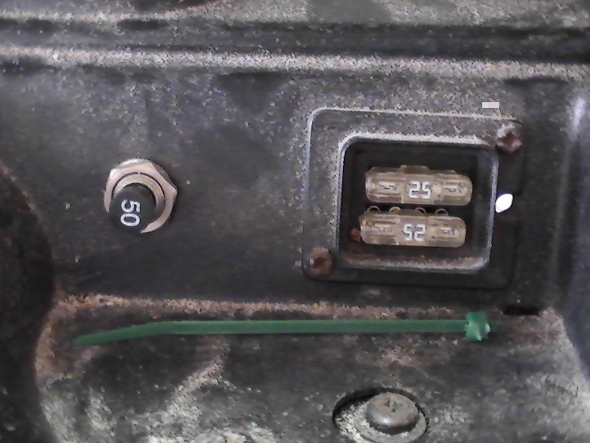

I don't know the amperage rating but the wheelchair had two fuses rated @ 25 amps and a circuit breaker rated at 50 amps. I don’t know if fuses are split between the right and left sides. Or, maybe one goes to the onboard charger. See attachment

fuses on wheelchair

No, crs2012, you're wrong... As I see jsmith2307 used Pololu 24v23 driver (without USB connector). Not Simple Motor Controller. And he physically can't to use Pololu Simple Motor Control Center
@jsmith2307
Connecting diagram is right. But I can't see where is "power switch". You wrote
If I flip the switch to the simulator first, then I hear a pop,
Can you build diagram with all power supplies and switches? How you power your AMC board?

This will hold the line PWM at a low ("zero") level until the end of the microcontroller initialization.
And I want to ask jsmith2307 - how many PWM inputs has your Pololu? Two (PWML and PWMH) or one (PWM)?
prilad
Posts: 174
Been thanked: 37 times
Re: Questions Regarding Alt. FW & GUI setup
Postby jsmith2307 » Wed 7. Aug 2013, 16:00
Greetings, :D
Ale, I've got both PMWH and PWML. I only use PMWH.
I think this problem may be solved by placing two pull-down resistors ( from 1K to 10K, one for every PWM lines) between PWM line and GND.
On the heat bridge side or the avr 1.6 or both?
