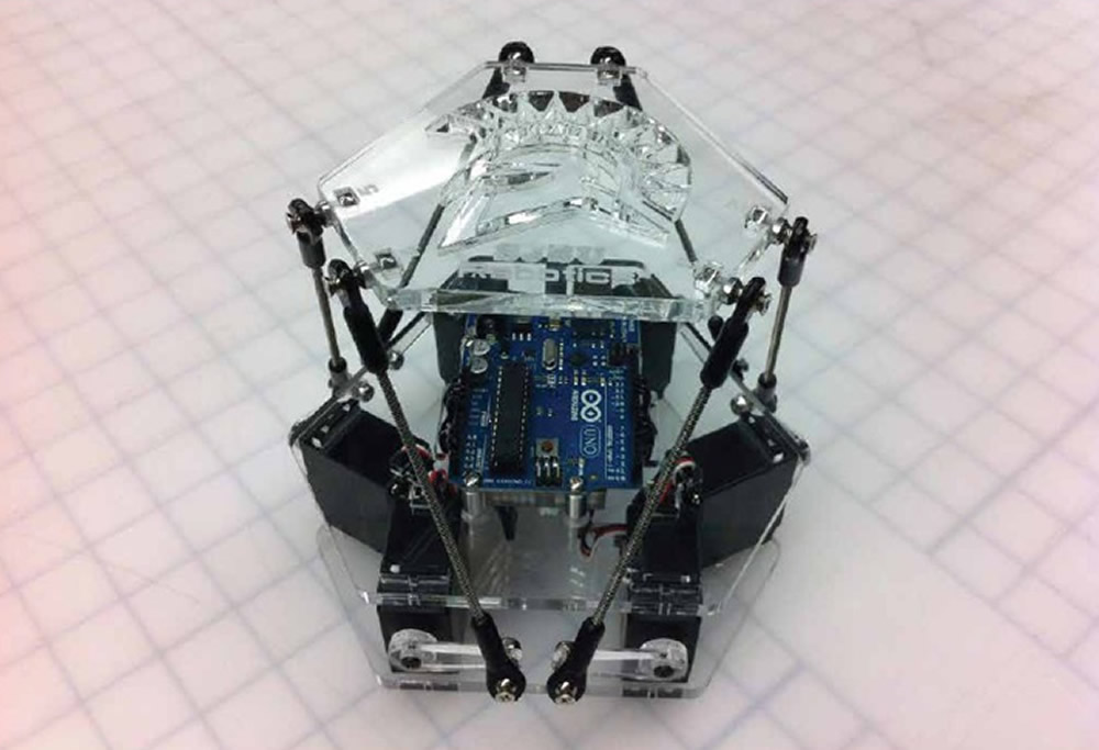

How to build an Arduino-powered 6DOF motion platform
Here are the instructions and parts lists for,
This instructable will show you how to create your own six degree of freedom motion plat-
form using an Arduino microcontroller and some standard servo motors for ~$100. The
math/programming is somewhat complicated and will be covered in another instructable.
Here's a video of some basic movements just by moving a few arms (no math involved yet):
http://youtu.be/cfnBnx8Cvcg
Here is a list of the items (and potential sources) needed to complete this project:
1 Arduino Uno microcontroller (Amazon)
6 standard servos (Parallax)
12 4-40 rod ends (ServoCity)
12 conical spacers (New Era Models)
2 ft 4-40 threaded rod (McMaster-Carr)
16 4-40 11/16" at head machine screws (McMaster-Carr)
12 4-40 nylok nuts (McMaster-Carr)
4 4-40 3/16" pan head machine screws (McMaster-Carr)
4 4-40 threaded aluminum spacers (McMaster-Carr)
1 mini breadboard (Amazon)
2 sq. ft. 1/4" thick acrylic (TAP plastics)
The only hand tools you will need are a small phillips-head screwdriver, a 1/4" wrench, and a
1/8" drill bit/drill, but you will need access to a laser cutter to cut the acrylic. I used a laser
cutter at TechShop in Menlo Park. TechShop is a DIY workshop, if you are interested check
out their website, http://www.techshop.ws.

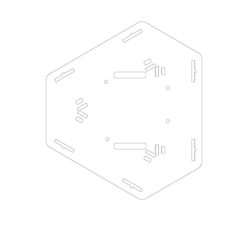

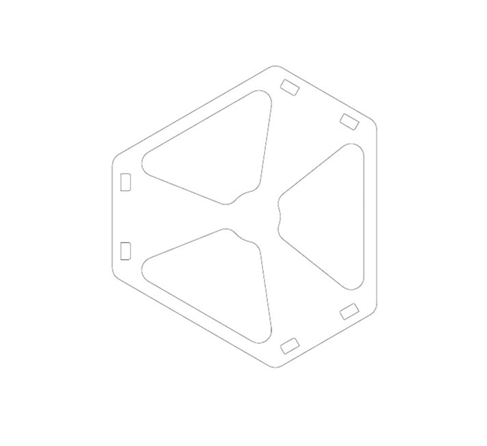

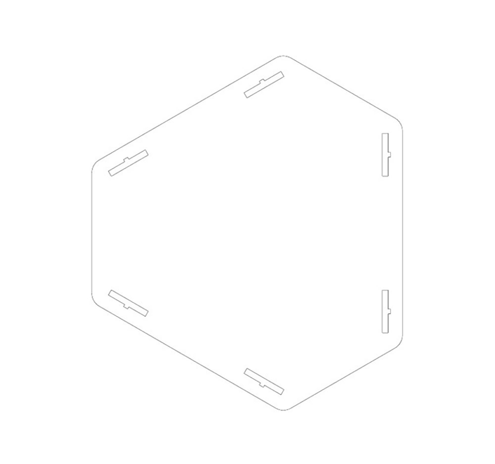

Cut the acrylic
The rst step is to cut the acrylic. I have attached the les I used, which you can also modify
if you want. Make sure to check tment on the holes for the servo mounting, etc. to make
sure the tment will be right before cutting everything out only to nd the holes are too
loose.
I created these les using Autodesk's AutoCAD Mechanical 2012, which is also available at
TechShop if you don't have a copy of your own.
There are 3 les to be cut out of 1/4" acrylic: base_bottom.eps, base_top,eps, and plat-
form.eps
And 1 le to be cut out of 1/8" acrylic: servo_arms.eps
Assemble the connecting links
The next step is to cut the rods to length. I used 2x 1 ft. sections, which I cut into 6x 4"
pieces. Make sure that the ends are cleaned up nicely because they will be threading into
plastic which can be easily damaged by the metal if there is a burr.
Once the rods are cut to length, simply thread a rod end onto each end of each rod, making
sure that all 6 rods are exaclty the same length from end to end when you are done.

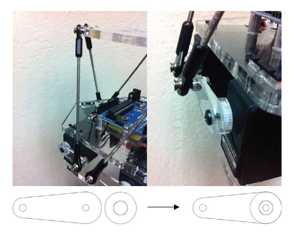

Glue and install the servo arms
The next step is to glue and install the servo arms onto the servos. I used a liquid acrylic
solvent from TAP plastics, but you can use any glue you like. With the liquid solvent
approach, I found it helps to lightly sand the surfaces being glued to ensure they stay
together.
Glue the circular piece to the arm as shown in the picture, making sure that the splined piece
still ts onto the servo arm (the laser creates a slightly tapered cut, so the splined pattern will
t on the servo shaft in one orientation better than the other)

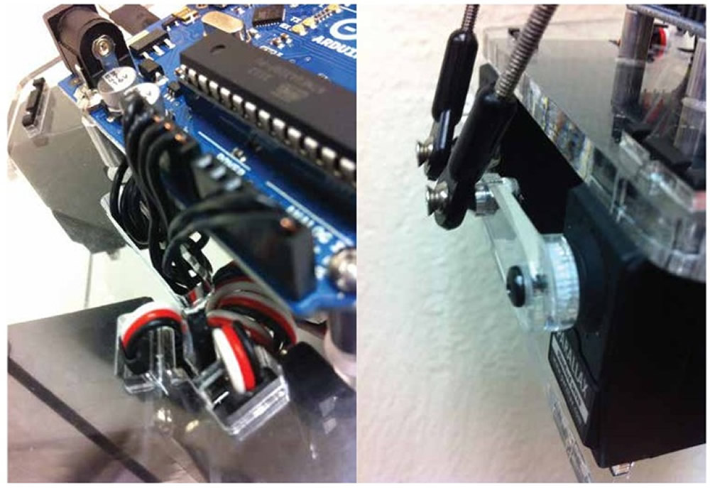

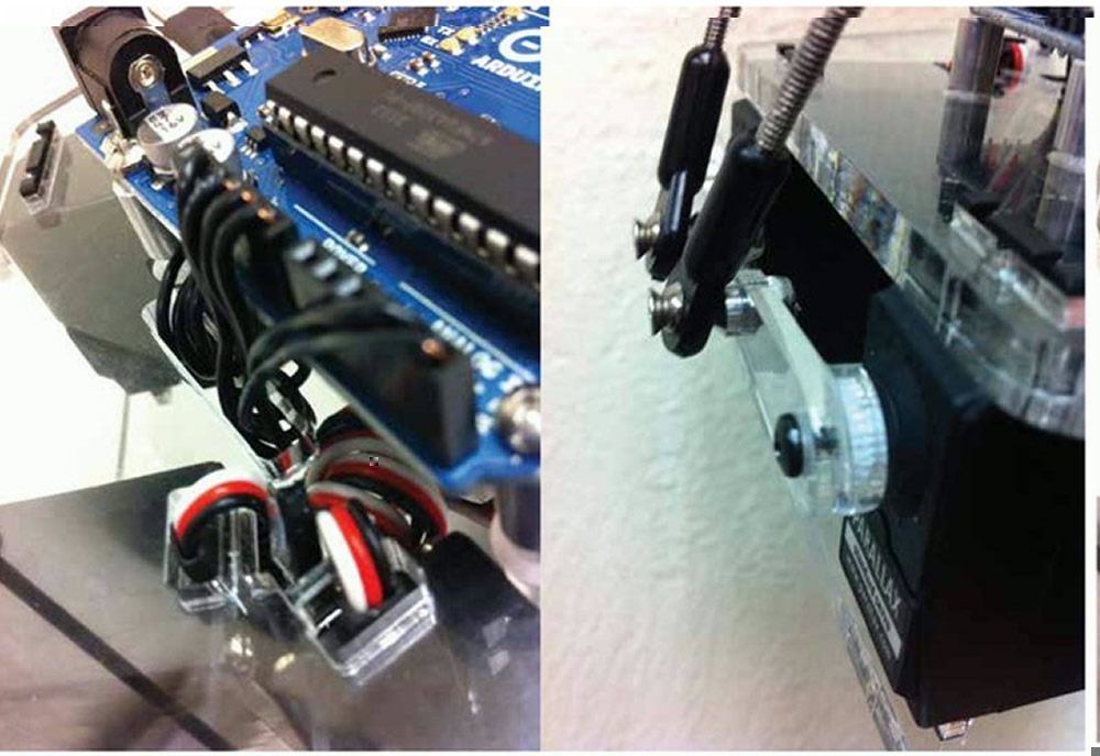

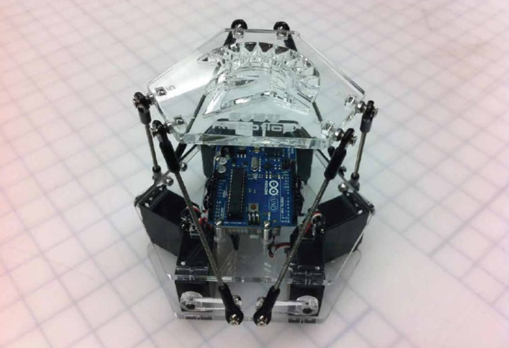

Assemble the platform
Start by threading the servo connectors through the base_top piece from the bottom up,
then push the servo into place and thread the connector back down through the other hole.
Do this for all 6 servos.
Now you can mount the Arduino using the threaded aluminum spacers, 3/16" pan head
screws, and 11/16" at head screws. To make it look nice you can countersink the bottom
side of the holes in the acrylic so the at heads sit ush, but it's entirely necessary. You may
also need to shave o a bit of the aluminum spacers so that the t at against the Arduino
(you'll see what I mean when you try to assemble them).
Once the Arduino is mounted, you can stick the breadboard right underneath it, in between
all the servos. With the breadboard in place, you can wire everything up. The servos all need
+5V on the red wire, ground on the black wire, and signal from the Arduino on the white
wire. Make sure you use the PWM capable pins on the Arduino (I used pins.3, 5, 6, 9, 10, 11).
Route the wires as shown in the picture.
Once everything is wired up, you can install the base_bottom piece. As you can see there is
no mounting hardware for the servos, it's just a "press" t. This is for ease of assembly/disas-
sembly/debugging, so don't worry if you didn't get something wired up correctly.
Now it's time to add the connecting links. Start by attaching the links to the servo arms. Use
a at head screw through the rod end, then a conical spacer, then the arm, and into a nylok
nut on the back. Before attaching the top, you'll need to drill 1/8" holes in the sides of the
platform where the holes for the nuts are. Once you've drilled the holes, the connecting
links attach the same way they did on the bottom: a at head screw through the rod end,
then a conical spacer, then the acrylic and into a nylok nut embedded in the platform. Be
careful not to overtighten these as the plastic can easily crack.
You're done! You can play around with the programming yourself, or you can check out my
other instructable on how to program the platform.

delay(1000);
void loop()
static oat pe[6] = {0,0,0,radians(0),radians(0),radians(0)}, theta_a[6], servo_pos[6],
q[3][6], r[3][6], dl[3][6], dl2[6];
pe = location and orientation of end e ector frame relative to the base frame [sway, surge,
heave, pitch, roll, yaw)
theta_a = angle of the servo arm
servo_pos = value written to each servo
q = position of lower mounting point of connecting link [x,y,x][1-6]
r = position of upper mounting point of connecting link
dl = di erence between x,y,z coordinates of q and r
dl2 = distance between q and r
for(int i = 0; i < 6; i++)
q[0][i] = L1*cos(-theta_a[i])*cos(theta_s[i]) + p[0][i];
q[1][i] = L1*cos(-theta_a[i])*sin(theta_s[i]) + p[1][i];
q[2][i] = -L1*sin(-theta_a[i]);
r[0][i] = re[0][i]*cos(pe[4])*cos(pe[5]) + re[1][i]*(sin(pe[3])*sin(pe[4])*cos(pe[5]) -
cos(pe[3])*sin(pe[5])) + pe[0];
r[1][i] = re[0][i]*cos(pe[4])*sin(pe[5]) + re[1][i]*(cos(pe[3])*cos(pe[5]) +
sin(pe[3])*sin(pe[4])*sin(pe[5])) + pe[1];
r[2][i] = -re[0][i]*sin(pe[4]) + re[1][i]*sin(pe[3])*cos(pe[4]) + z_home + pe[2];
dl[0][i] = q[0][i] - r[0][i];
dl[1][i] = q[1][i] - r[1][i];
dl[2][i] = q[2][i] - r[2][i];
dl2[i] = sqrt(dl[0][i]*dl[0][i] + dl[1][i]*dl[1][i] + dl[2][i]*dl[2][i]) - L2;
theta_a[i] += dl2[i];
theta_a[i] = constrain(theta_a[i], servo_min, servo_max);
if(i%2 == 1) servo_pos[i] = servo_zero[i] + theta_a[i]*servo_mult;
else servo_pos[i] = servo_zero[i] - theta_a[i]*servo_mult;
servo[i].writeMicroseconds(servo_pos[i]);
Platform.eps
Platform.eps
Platform Laser Cutting File
Platform.rar
(21.34 KiB) Downloaded 2839 times
Base Bottom.eps
Base Bottom.eps
Base Bottom Laser Cutting File
Base_bottom.rar
(18 KiB) Downloaded 2789 times
Base Top.eps
Base Top.eps
Base Top Laser Cutting File
Base_top.rar
(24.02 KiB) Downloaded 2781 times

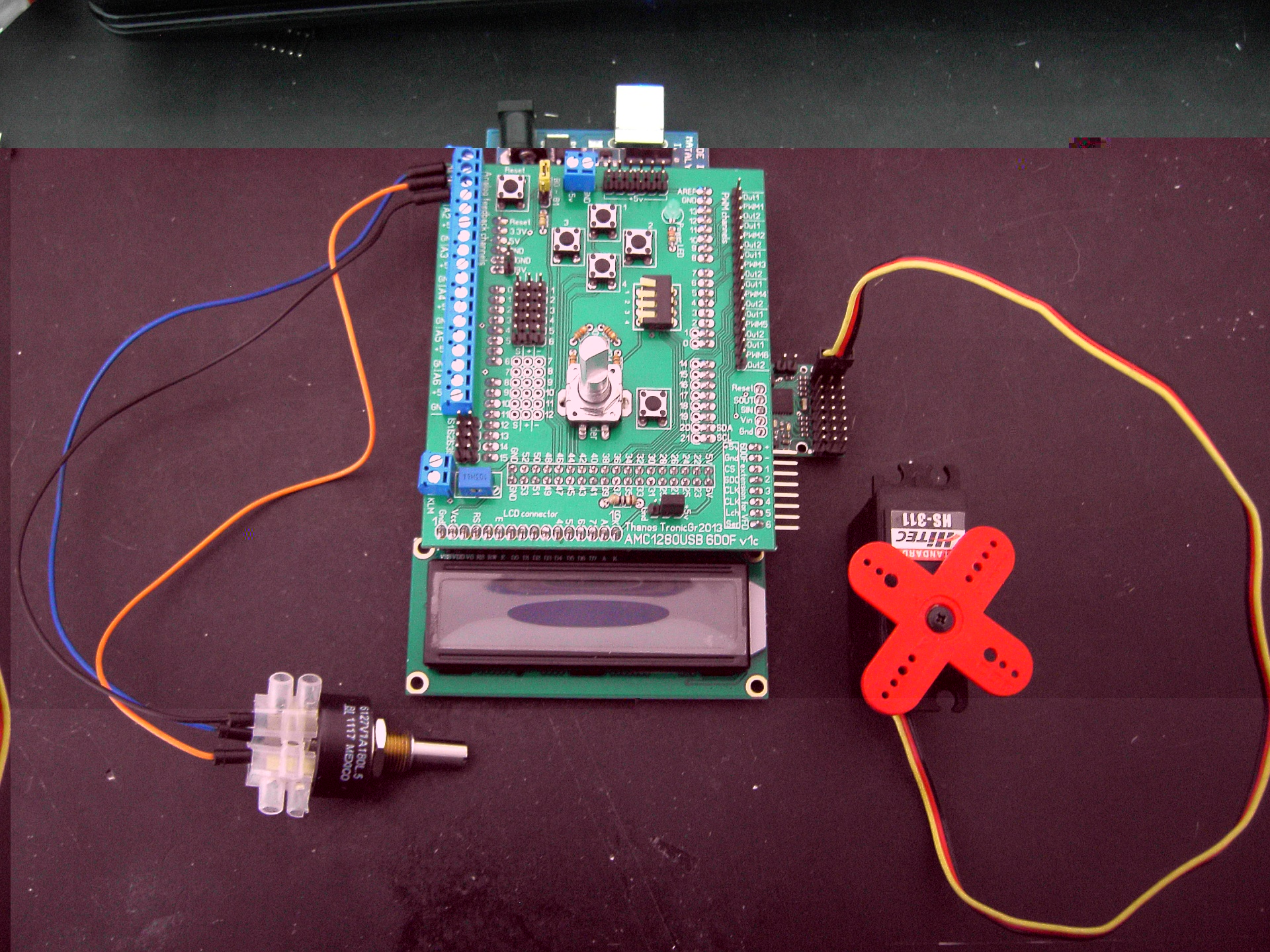

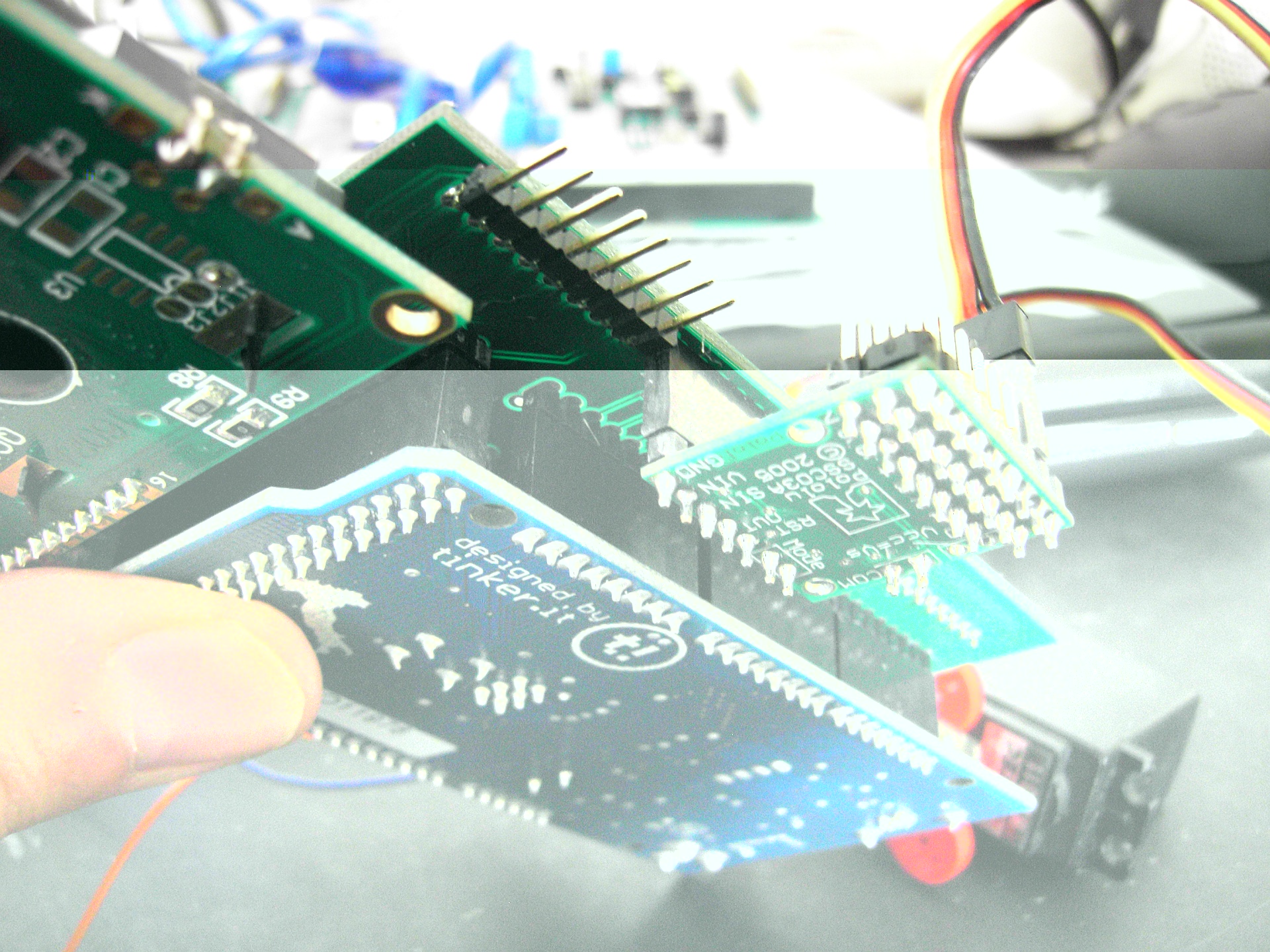

Postby tronicgr » Fri 28. Jun 2013, 23:05
I'm making a 6DOF mini model. It will be using the same algorithms for PID and sensors like the real platform. The mini servo motors will only provide speed and direction and the actual positioning will be determined by position sensors. It will be fairly more complicated than the simple RC driven mini platforms and will allow to experiment with coding having it right next to me on my desk:
PS. Don't mind the appearance, I like using recycled material laying around :lol:
