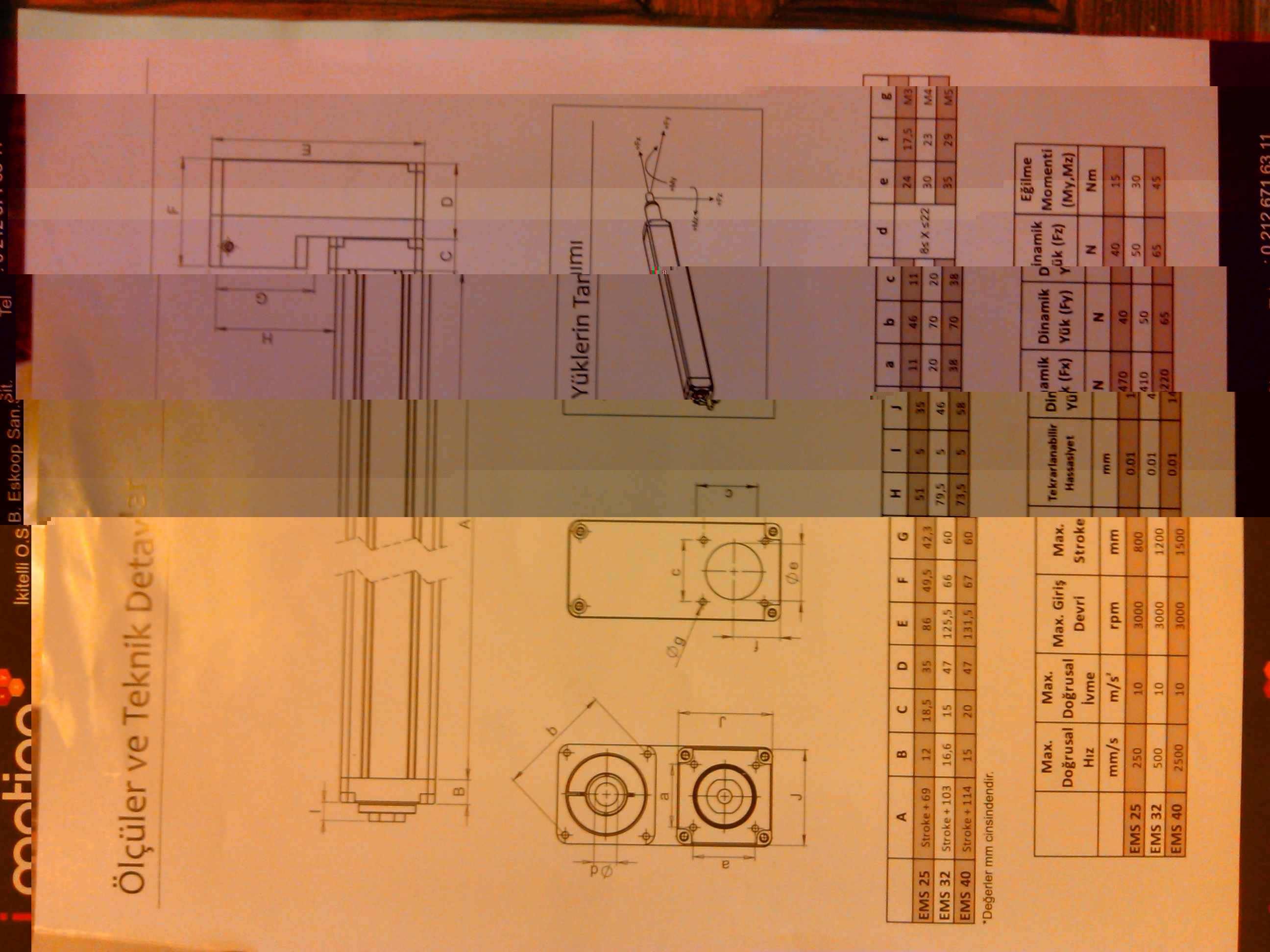

I spoke with a local manufacturer of actuator who are producing custom spec actuators on demand. The data sheet is attached, the EMS32 (500mm/s speed and 4410N force) seems a right choice with custom length and stroke.
