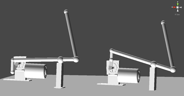

The way I see it,
Wiper motor without lever:

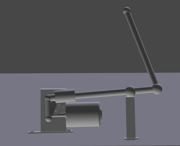

Wiper motor with lever:)
Similar concept has been used a lot with 2dof wiper simulators (seat balancing on a pivot point).
I plan to add 6 levers (seesaws), one for each motor, with 1 to 3 ratio so motors only have to lift one third of the platform weight.
This is what the levers and wipers might look like;
Would it be better for motors if the weight of the platform is balanced by a counterweight on the longer side of the seesaw?
How would the change of momentum affect motors?

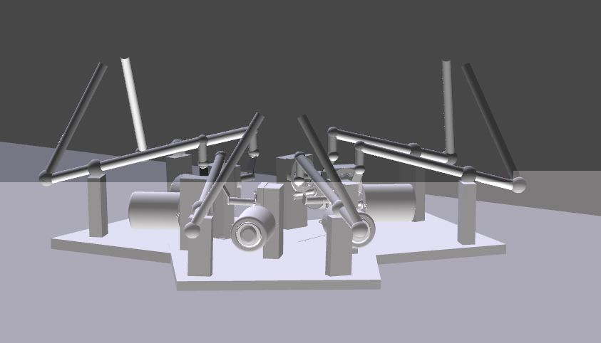

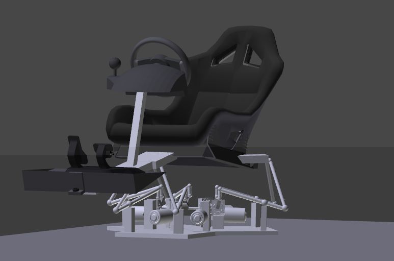

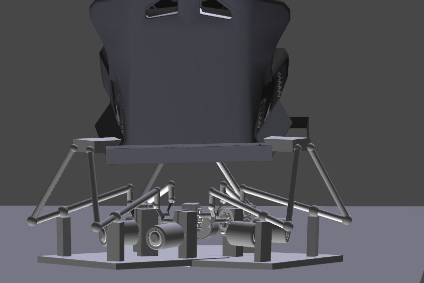

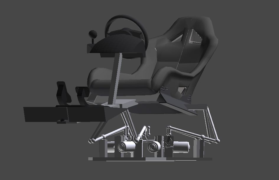

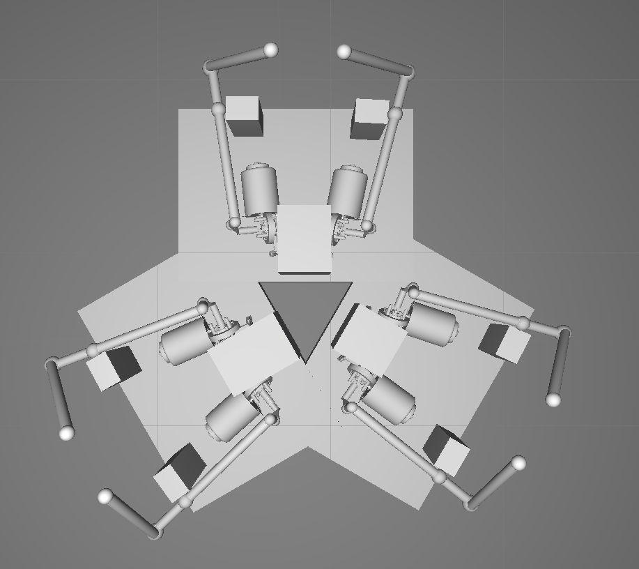

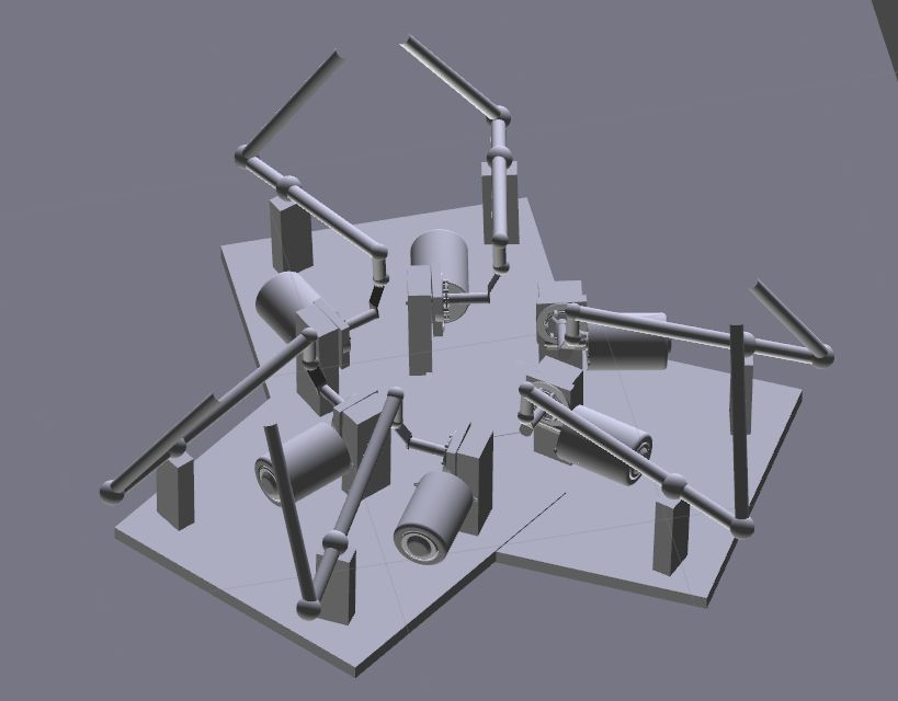

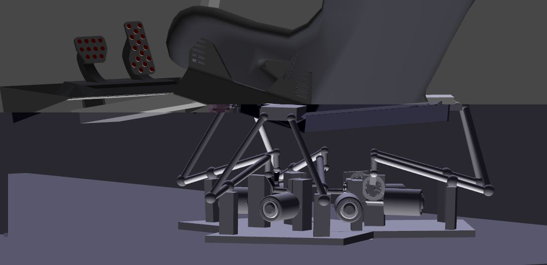

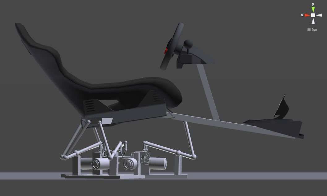

Here is a rough model of the entire simulator:
(Dimensions and scales are not accurate)

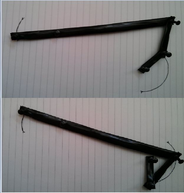

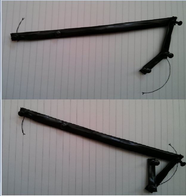

jhordies wrote:Though I'm not sure how the levers can follow the motion in 6 degrees of freedom, maybe the 4 rods per arm is already taking care of that but I have a hard time picturing how il will behave.
Levers just go op and down, like https://www.youtube.com/watch?v=_jQkc9kNem8
I've made a simple demo using some cardboard and duck tape, and pins (It's really fun thing to make :) you can see the movement of wiper motor (when it's not connected to the lever) drawn on the right side, as a larger half circle.
On the left is the side that would be connected to the seat (smaller half circle).
Unfortunately the pivot point is not really visible.
