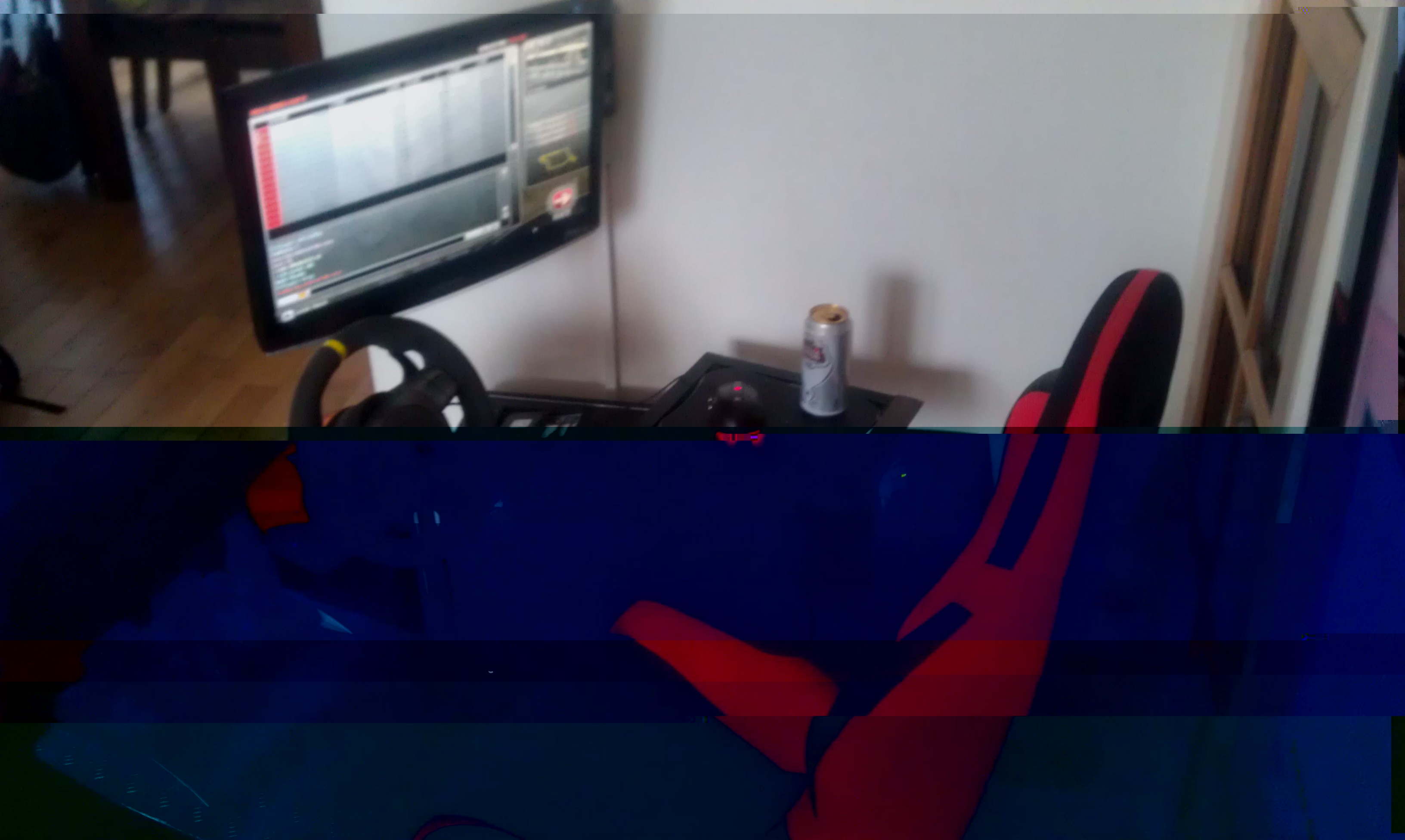

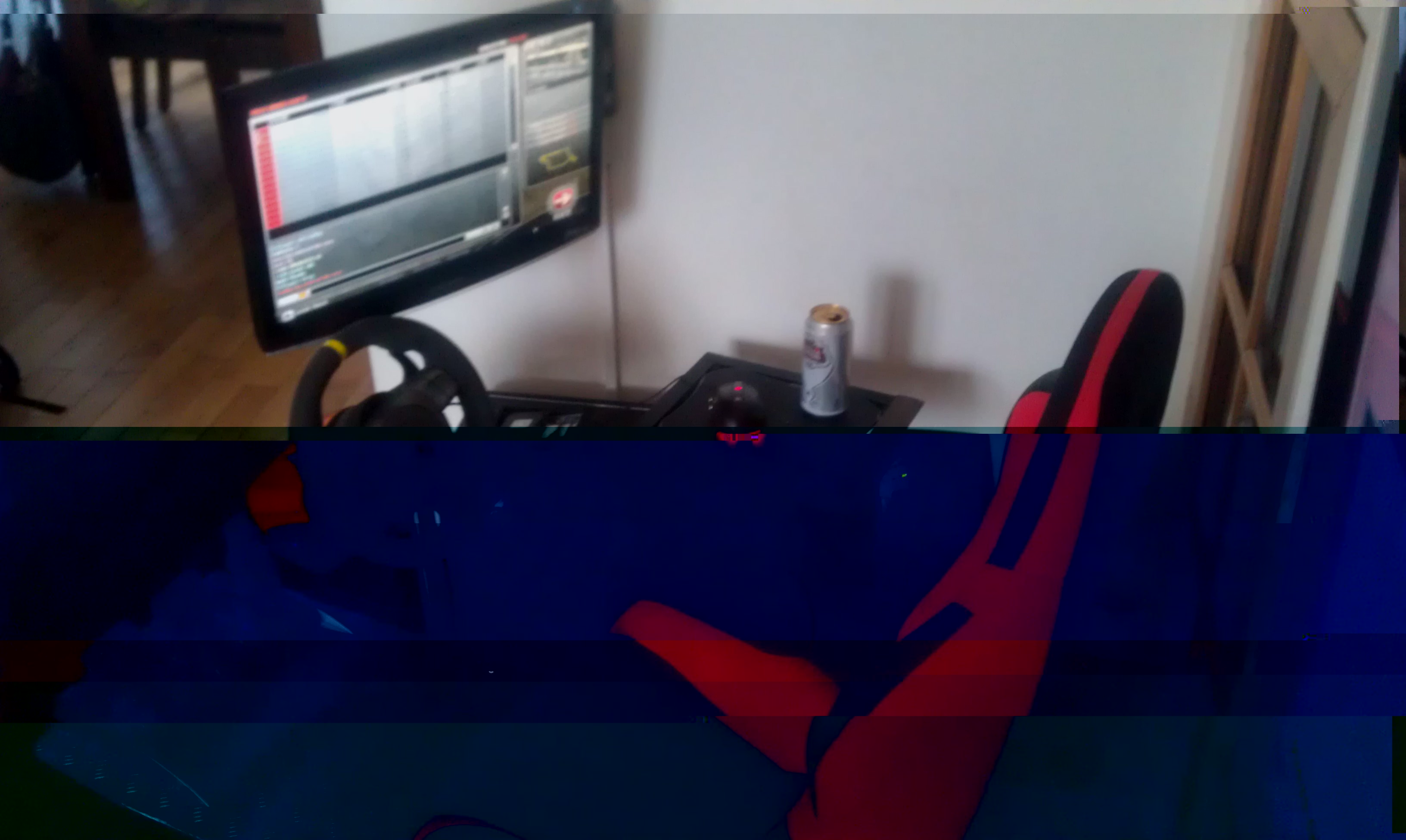

Postby Carl » Sat 26. Jan 2013, 21:49
album_id=51&image_id=1093&sk=t&sd=d&st=0[/album]
This is my preliminary top platform. I just needed to try out a few different driving position. The steering column is fully adjustable and with the seat being on rails its quite flexible. My 7 year old was able to jump in with the aid of a cushion. Quite happy with the layout but need to stiffen the underside rexroth frame I made.

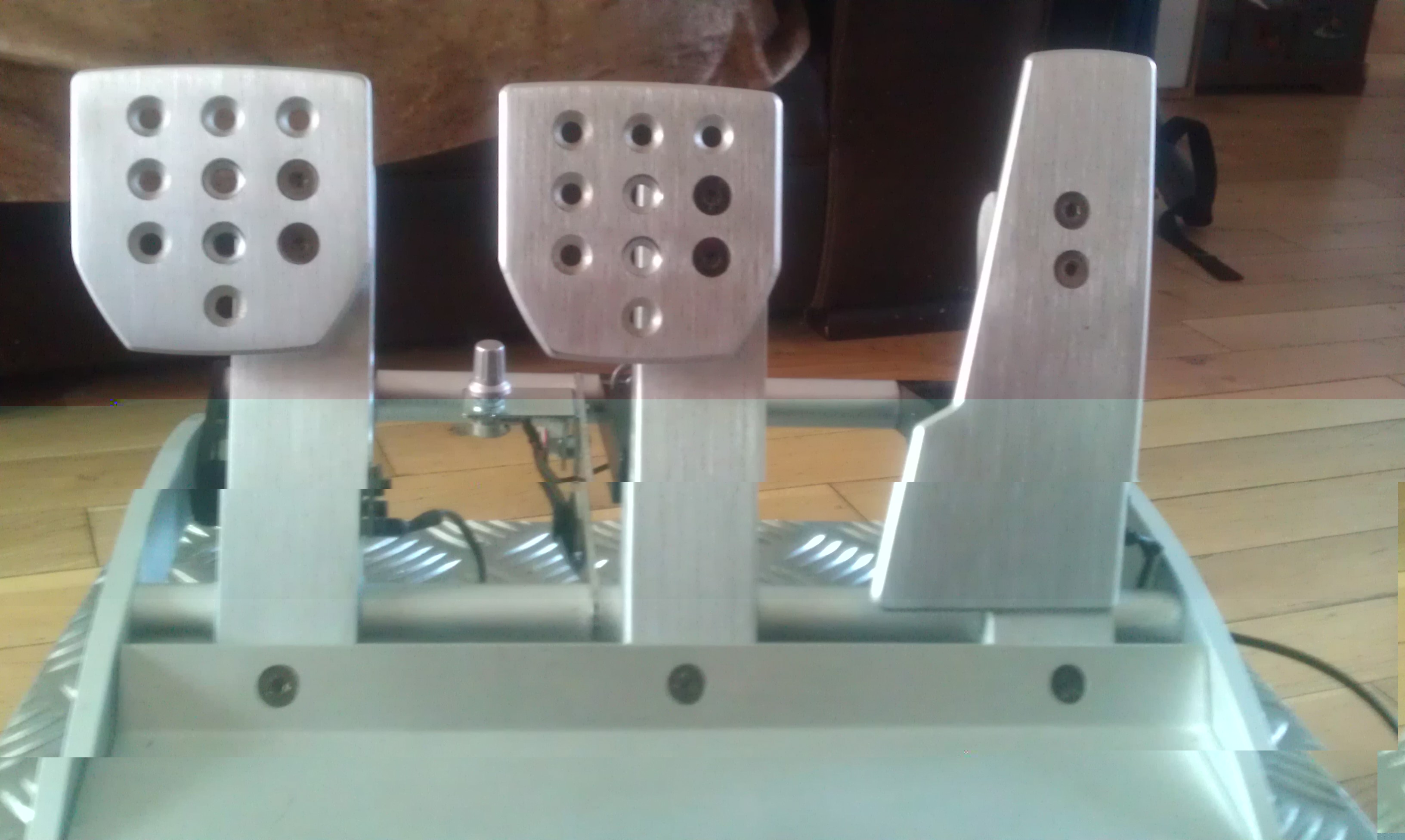

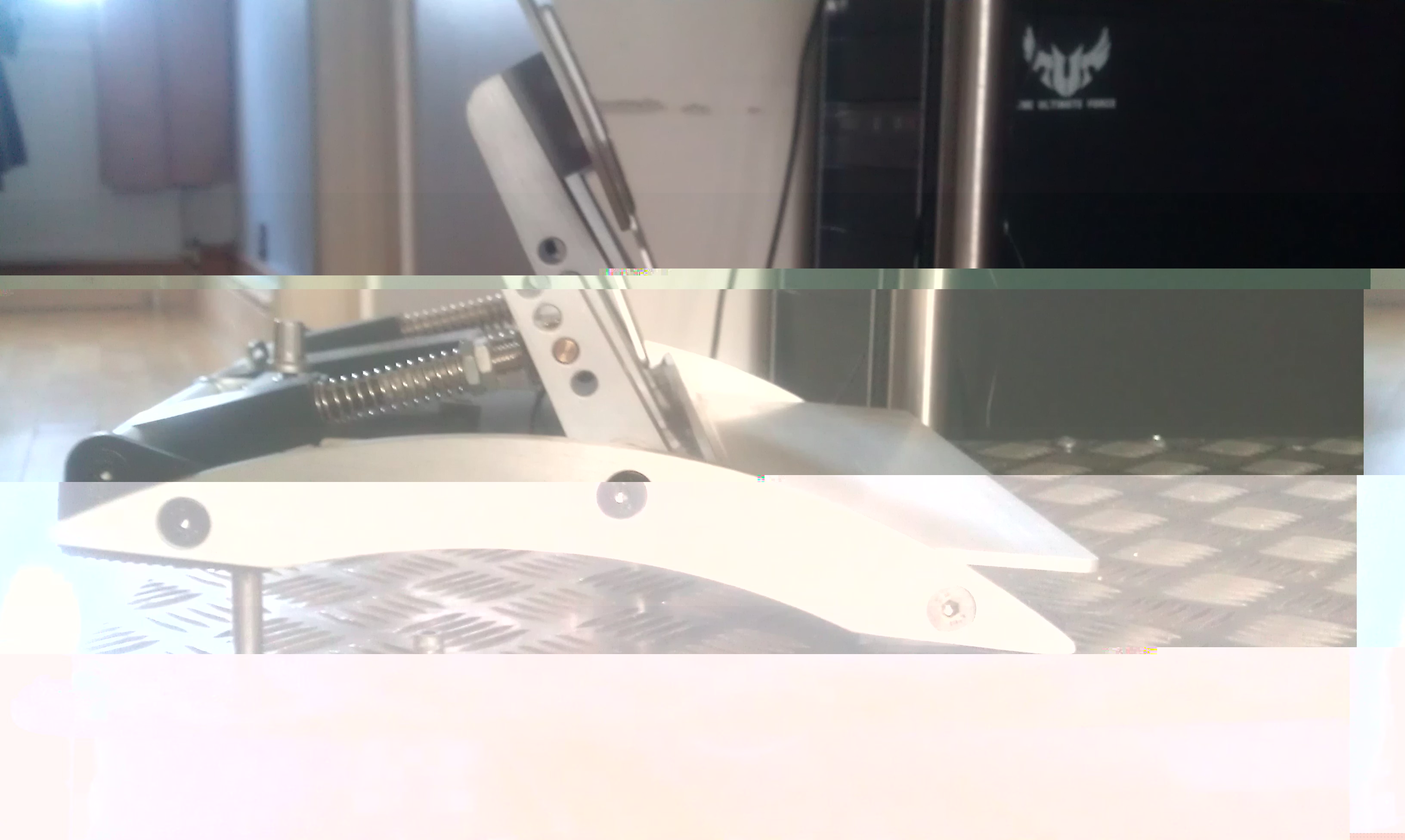

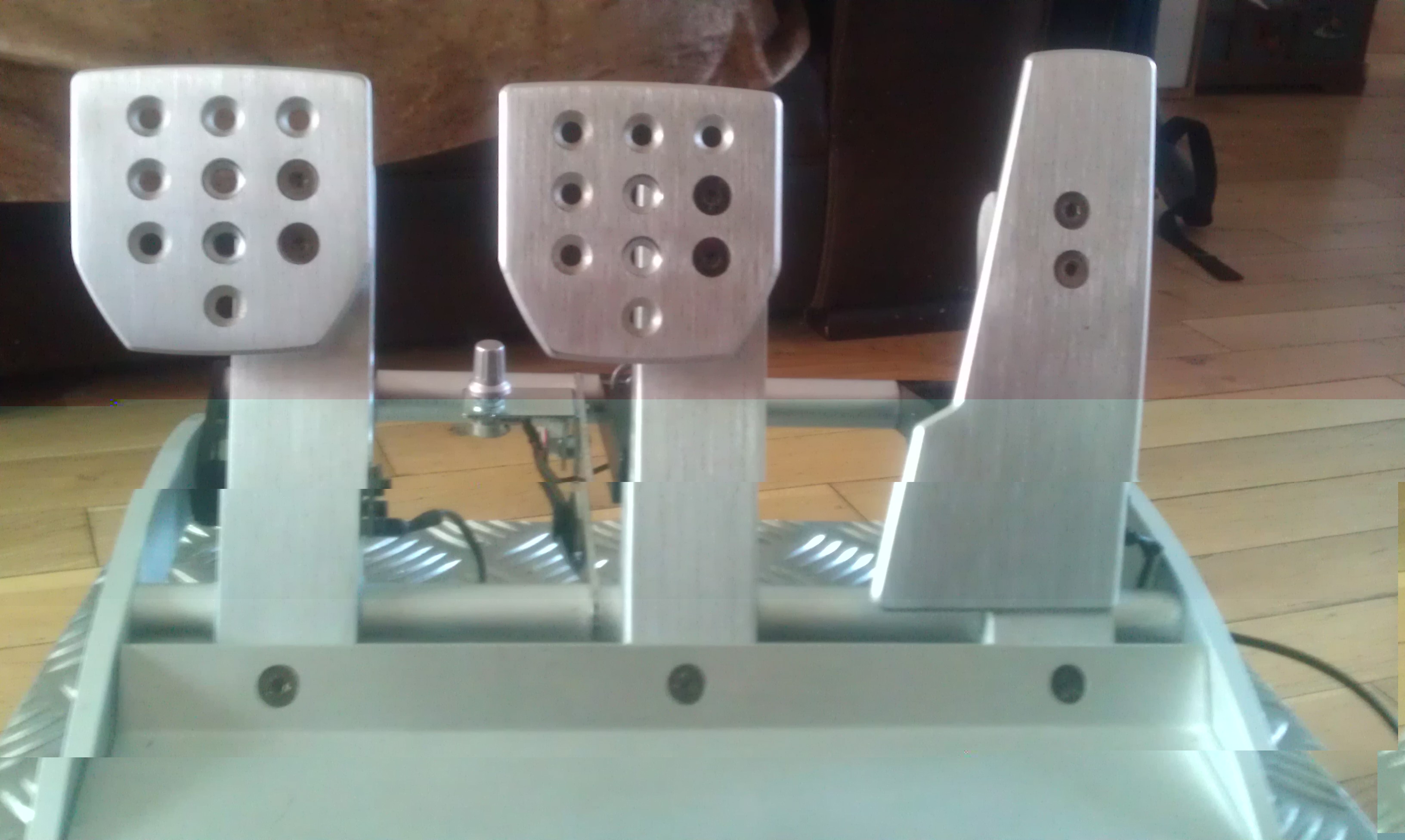

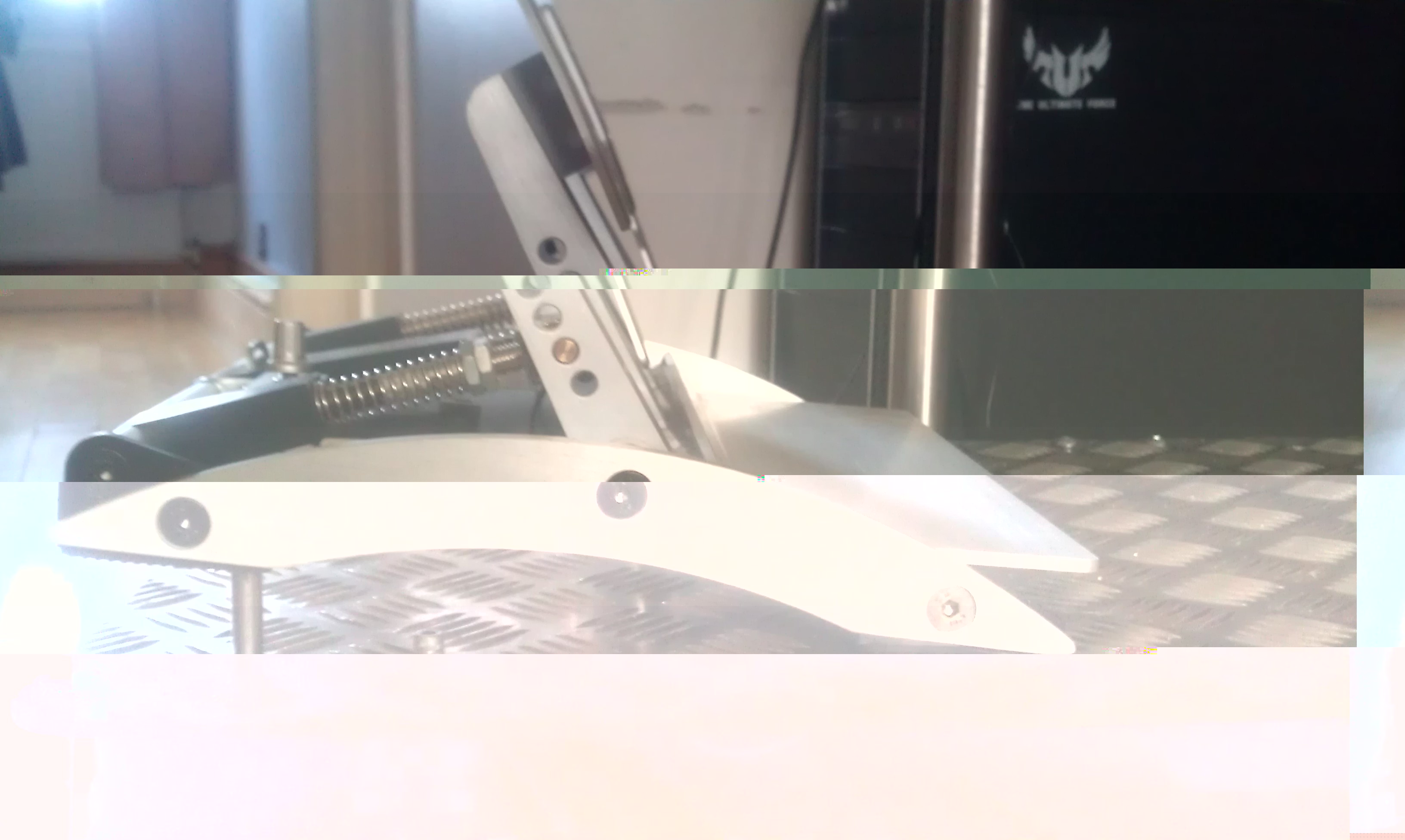

Postby Carl » Sat 26. Jan 2013, 21:55
As you can see I spaced the back support on the pedals to change the angle and make it steeper. I will eventually invert but this angle works for now whilst I sort everything else. I may invert the pedals later when I have some time.

Postby Carl » Sat 26. Jan 2013, 21:56
I spaced the pedals too as I'm a bit clumsy and kept hitting the clutch by accident.
