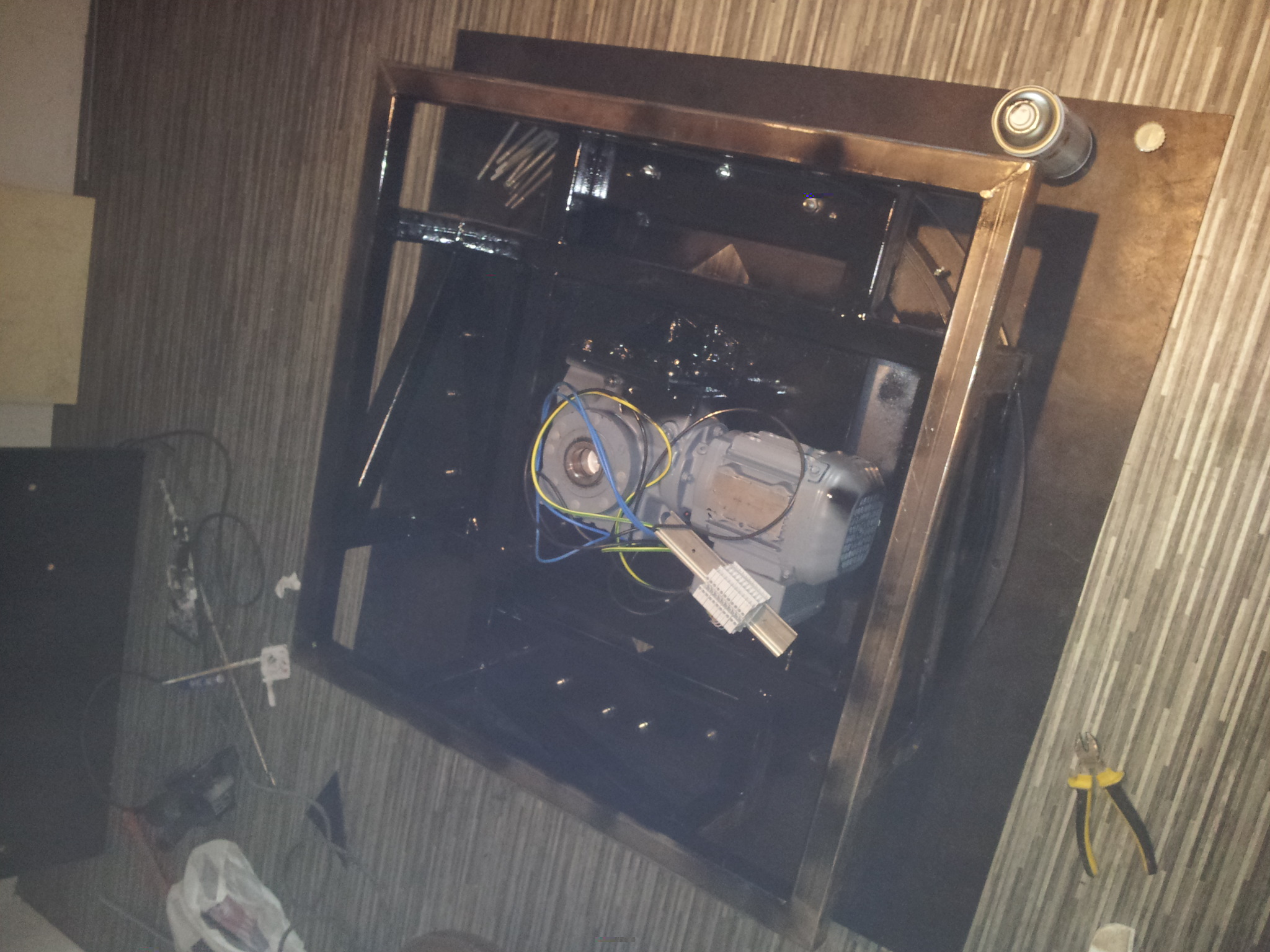

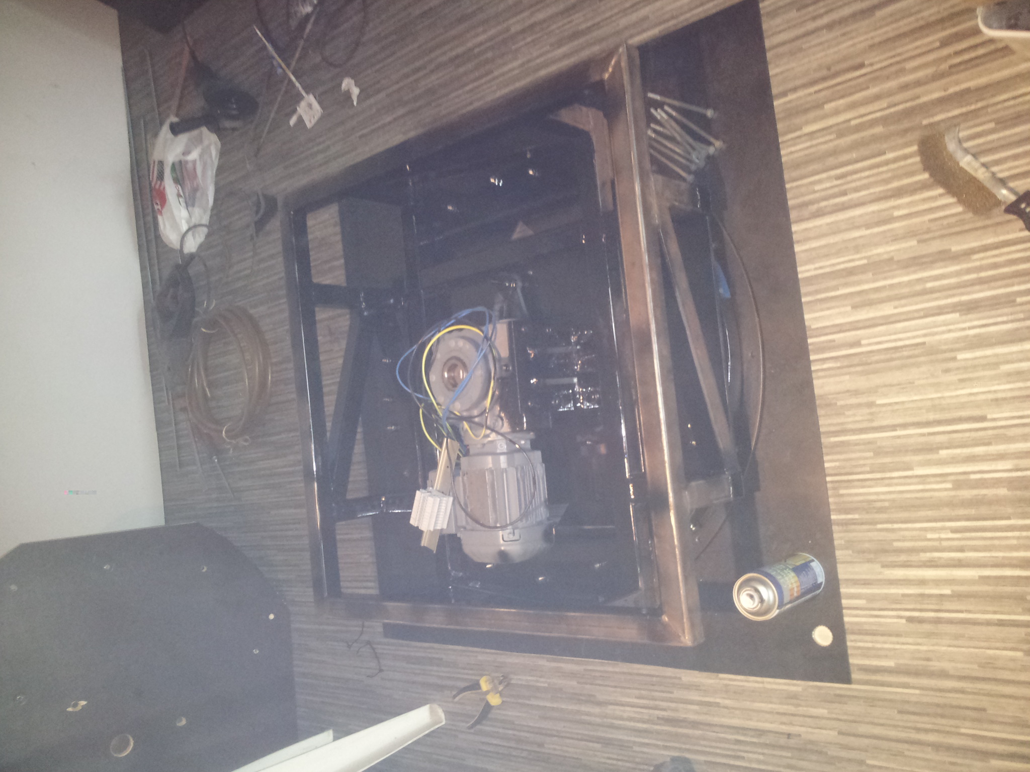

Hello everybody,
Last year I build 2DOF-simulator with my students. This simulator can be found here:
viewtopic.php?f=37&t=335
Now we are going to expand this simulator by placing it on top of a turningtable. You can find some pictures of the turningtable below and also the inventor-project. I'll keep it up to date and will also add information about the motor we aren using.

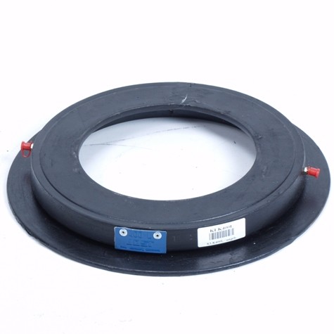

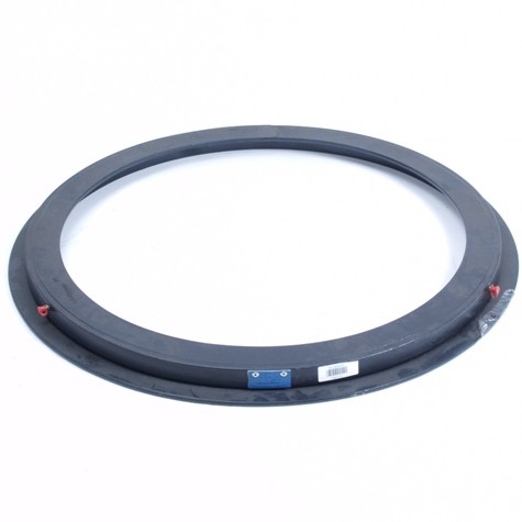

The construction is mounted on two turn tables, a Jost 850L (price 300 euros) and a Jost 400L (price 140 euros), see pictures below. These turntables will be fixed in the floor.

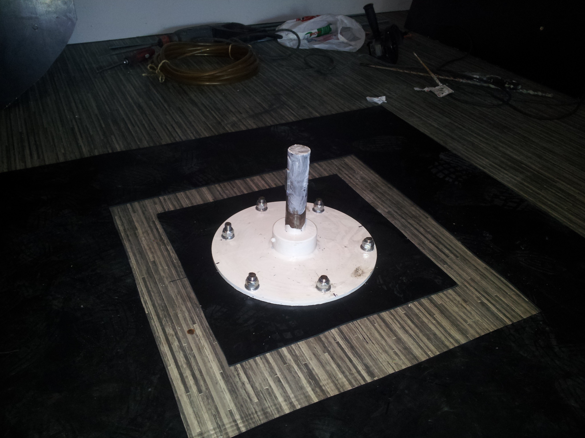

The 400L is connected with the motor. The axis of the motor itself will stand still and the rest of the motor will turn. This way the platform can turn indefinitely. Power is supplied by turning contact-points (see http://www.sleepringen.nl/compacte_slee ... 45___.html for more information)
The 850L is added for extra stability.

It has been a while but I finally mounted the turningtable to the floor. Tomorrow we are going to test it with the platform on top of it. You can find pichtures below and a video will follow soon.
