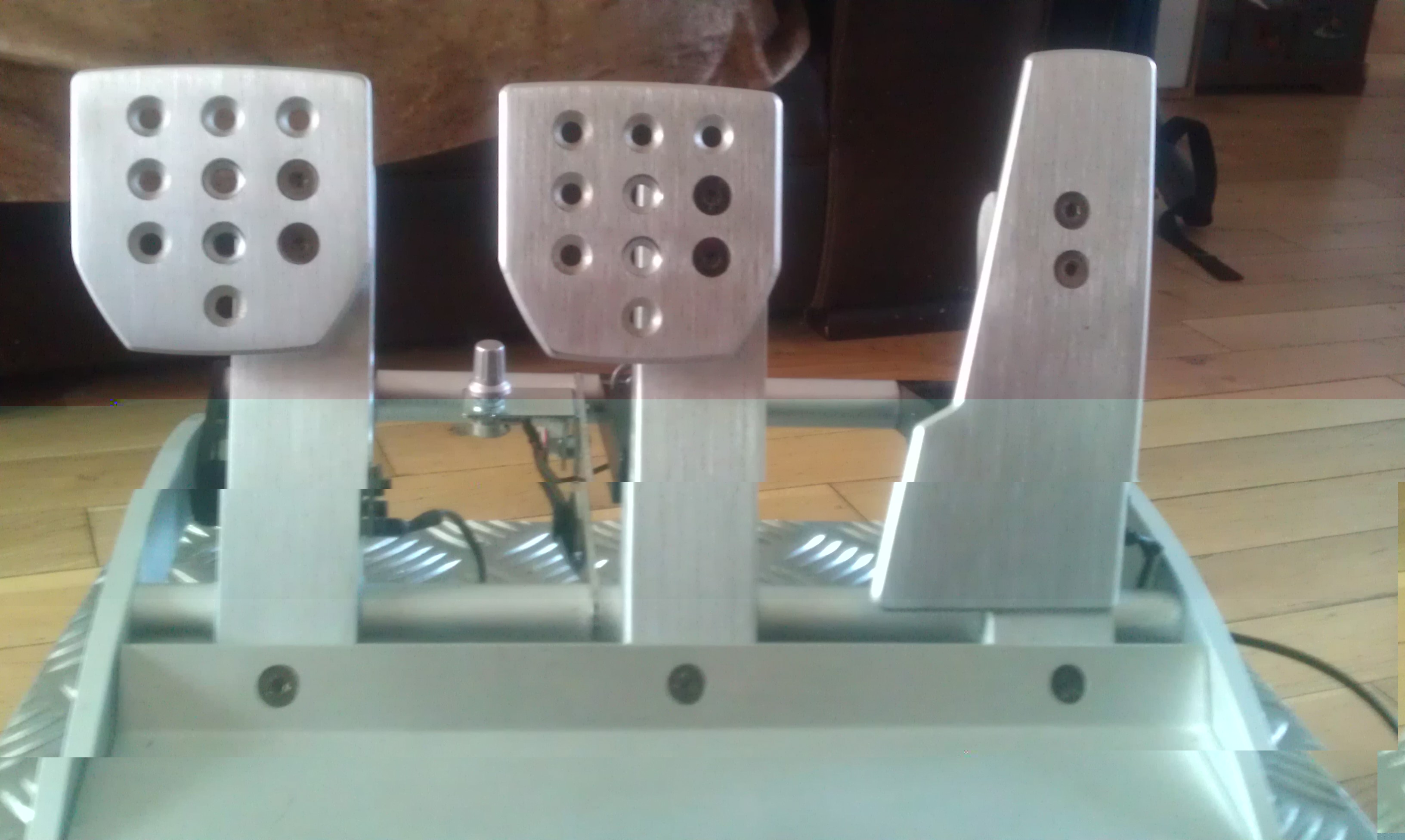

Postby Carl » Sat 26. Jan 2013, 21:56
I spaced the pedals too as I'm a bit clumsy and kept hitting the clutch by accident.

Looks good,
I used my now 9 year old son for simulator testing, when he was 7.

Same Problem with the pedals here.
But I think it is the small lower part of the gas pedal.

Postby Carl » Mon 4. Feb 2013, 20:33
Thanks for the kind comments everybody. MotionDave,I agree, the gas pedal design is very odd indeed. I might swap it out or modify it before inverting the pedals.
