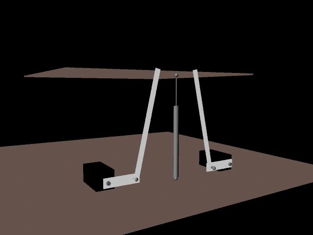

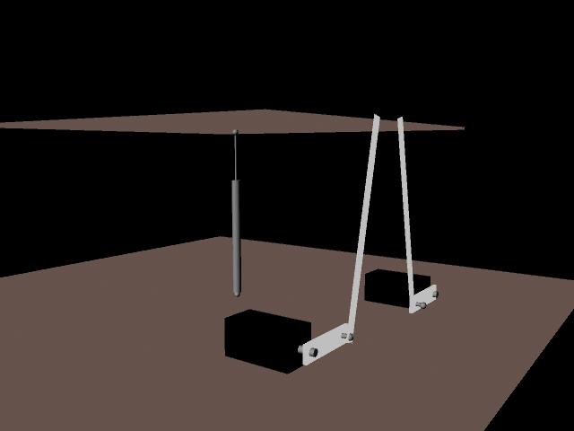

I came across a great post yesterday, which goes into all kinds of details on calculations for designing a 3DoF system. In this case a spring is used to take on some of the load.
http://x-sim.de/forum/viewtopic.php?f=3 ... tion#p8184
I was wondering if instead of using a lever or s sping you could use a gas shock;
Either one shock positioned in the middle of the platform;
One shock in middle of platform
Or three shocks which would be positioned in between two motors
3 shocks one per pair of motors
The shock could be adjusted based on the expected weight of the platform.
Would the shock dampen the system too much?
