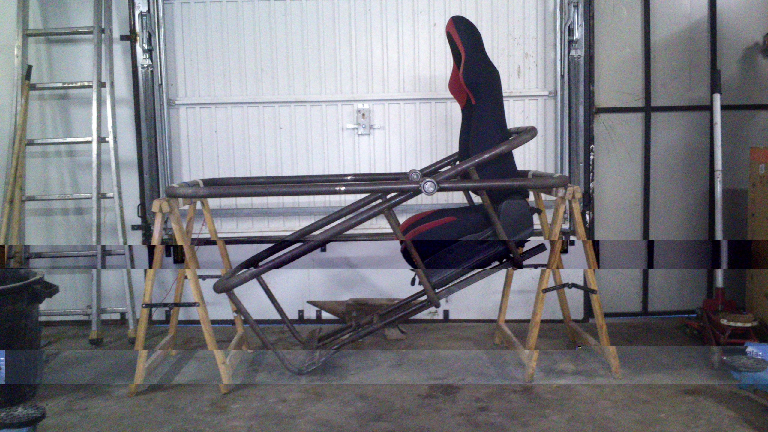

Bonjour,tout d abord merci pour l aceuille ,je motorise l ensemble avec deux meg dans un premier temps ,puis par la suite avec des moteurs de store electrique qui sorte du 20 nm a 16tr/minute .

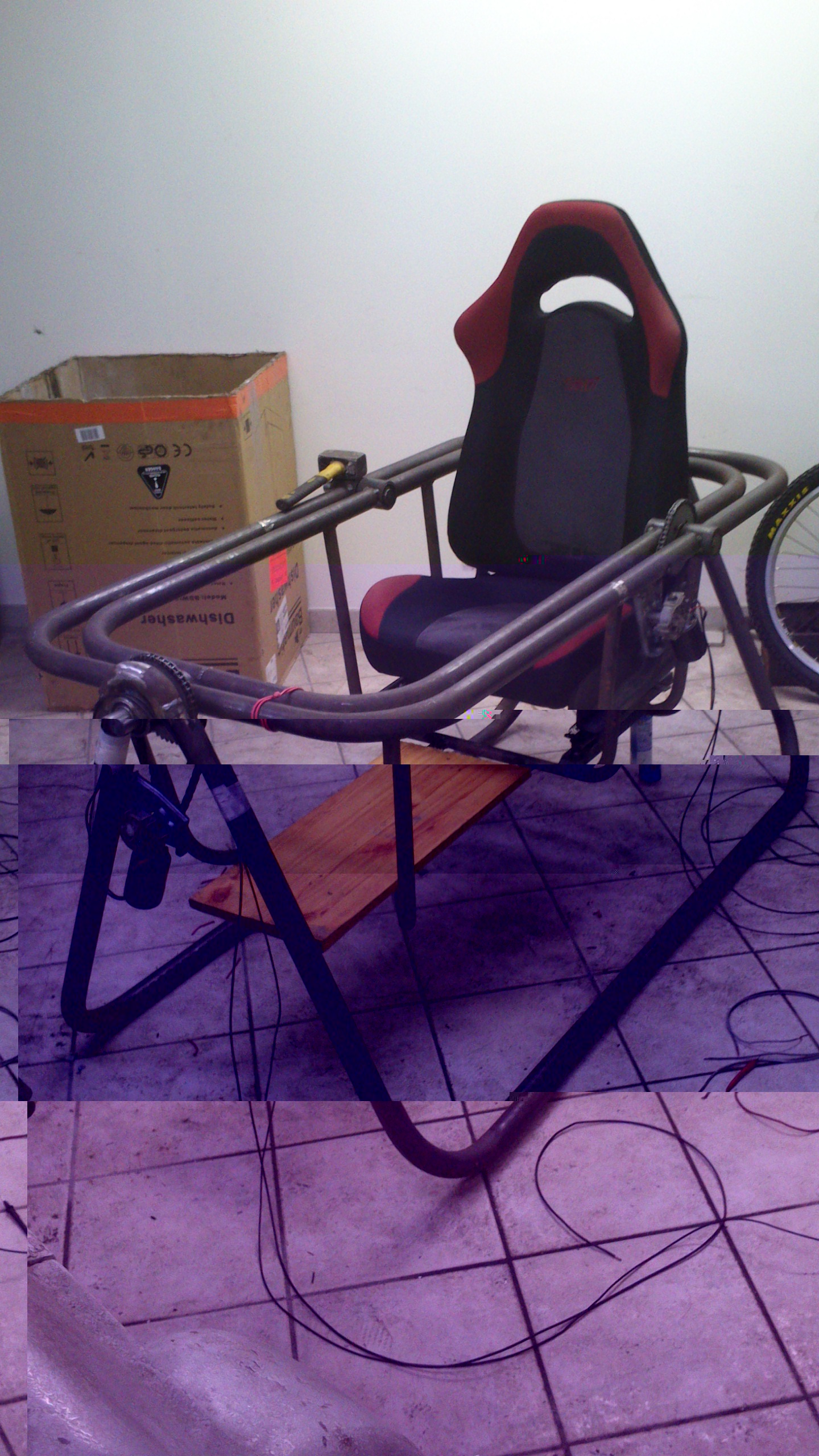

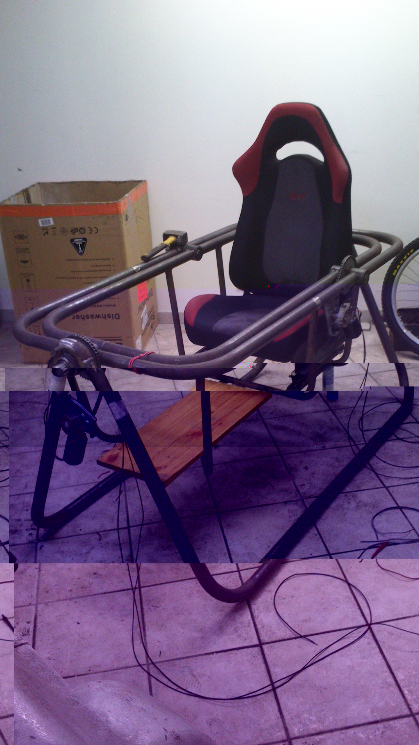

hello after having consulted the power curve of scn6 I realized that a 25 kgf operating speed was pleased that 50 mm / second, which is too slow for me, I have suddenly canceled my order.
I donnc mottorisé my simulation with doga 258.

Postby tronicgr » Thu 6. Jun 2013, 14:40
Have you considered using small AC motors? With a balanced cockpit like that you could have lots of speed available and power as well.
A small AC motor 0.25HP with 20:1 gear box could provide 100kgf power and more than 250mm/s speed with the right actuator arrangement...

hello here is the video of my attempts with doga 258
