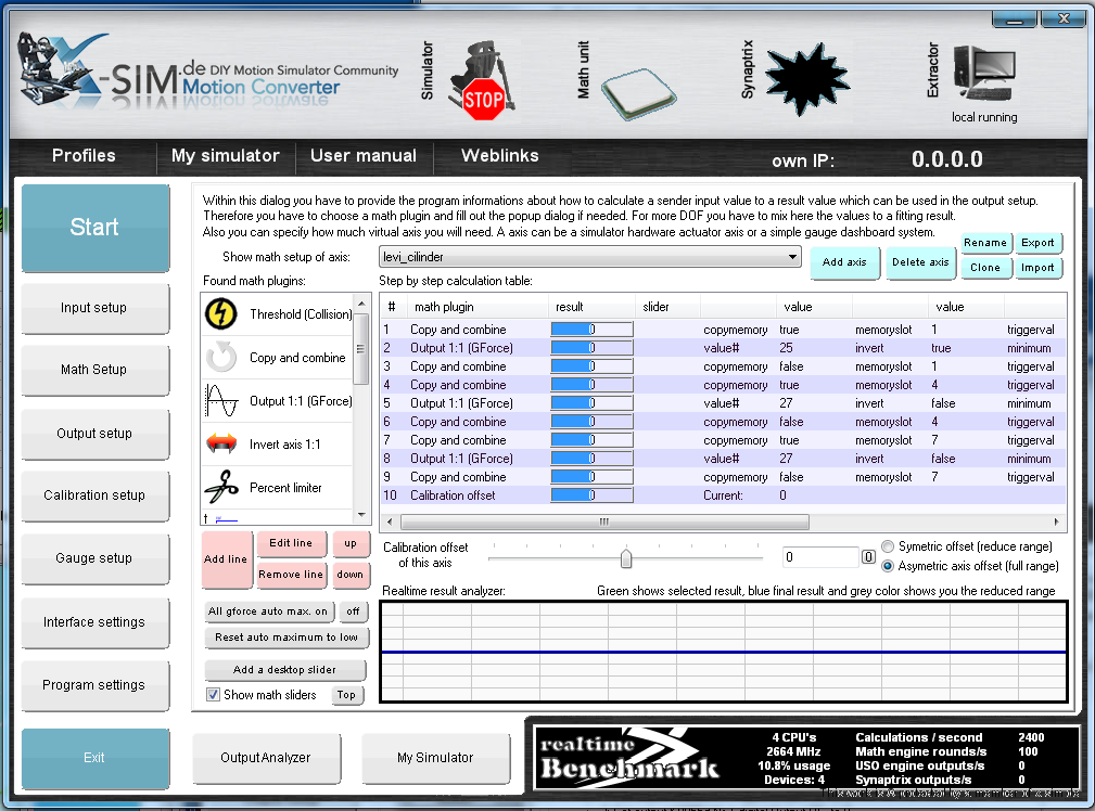

http://www.youtube.com/watch?v=0YKetkesai8 The big movements are caused by lateral and longitudinal forces, the movements that are only a few mm long are the ones that are "stopping" the actuator
This is however not so good for real driving because the movements are a little to slow because of the additional sequencesteps (you can see them in the screenshots or in the profile attached) so we found a "sweetspot" between a good motion behavour and stabilisation.
I think that math is not the problem (it does the same thing with any math setup) but maybe the output section is (maybe I have to adjust something special for penumatic cylinders?) or some k8055 setting.
In my observations
it seems that when the actuator is in a such position that it should stop moving, the pot tells it that it went a little bit too high (like a few % of the path too much) and then it wants to lower it to the correct position again and the signal our Velleman k8055n sends to our actuator tells it exactly that - to lower again. But that signal is too long so it lowers the actuator too much. Therefore the actuator has to rise again to get to the proper position and when it gets raised a little bit too much the problem occurs all over again.
Also here are some screenshots of the current profile settings if the profile won't load for some reason:
1178117711761175117411731172
NAMES OF OUR AXIS IN ENGLISH:
levi cilinder - left cylinder ; desni cilinder - right cylinder ; zadnji cilinder - rear cylinder
lfs_v27.rn2.zip
(3.12 KiB) Downloaded 1813 times
