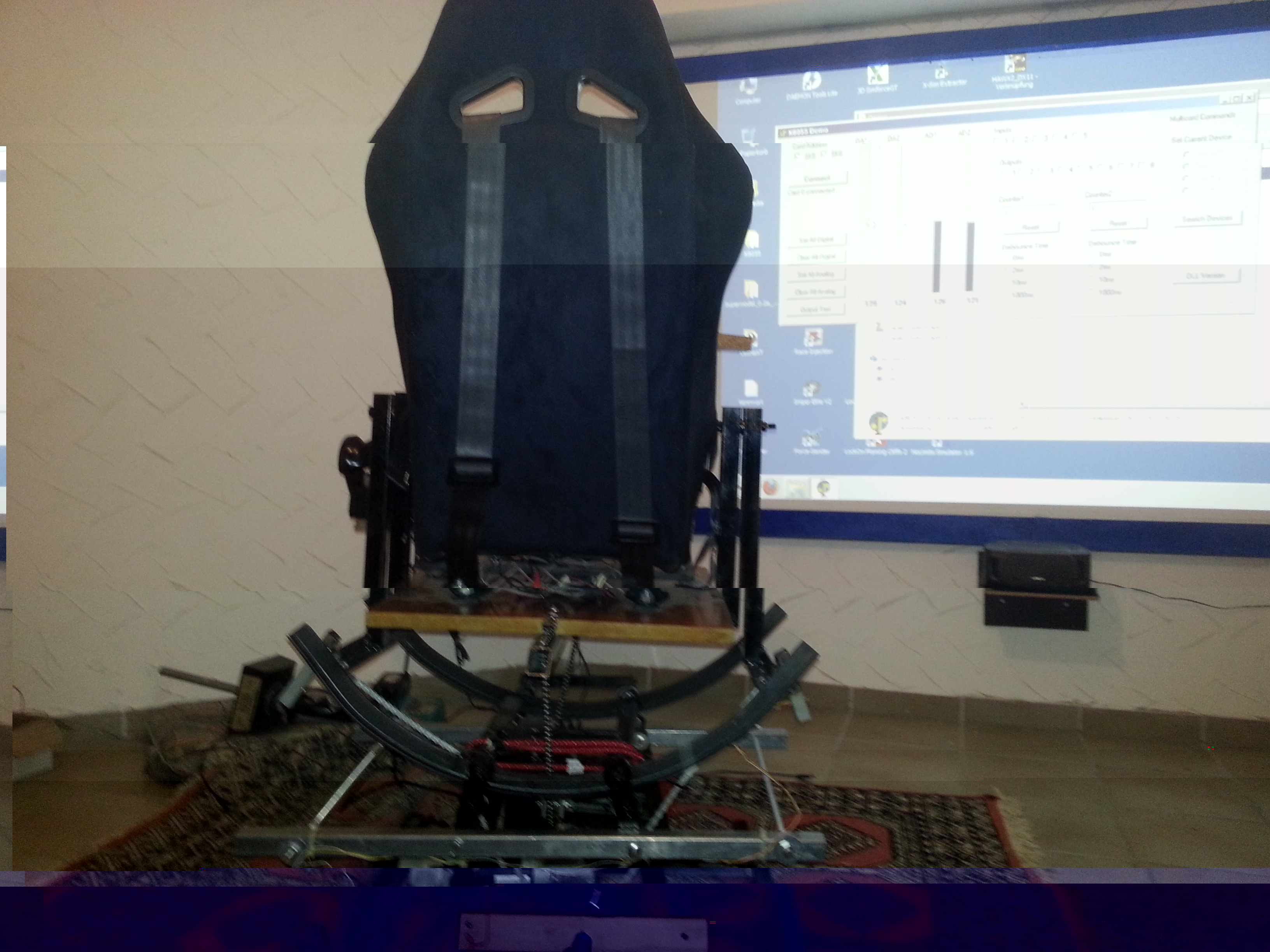

Hello Friends

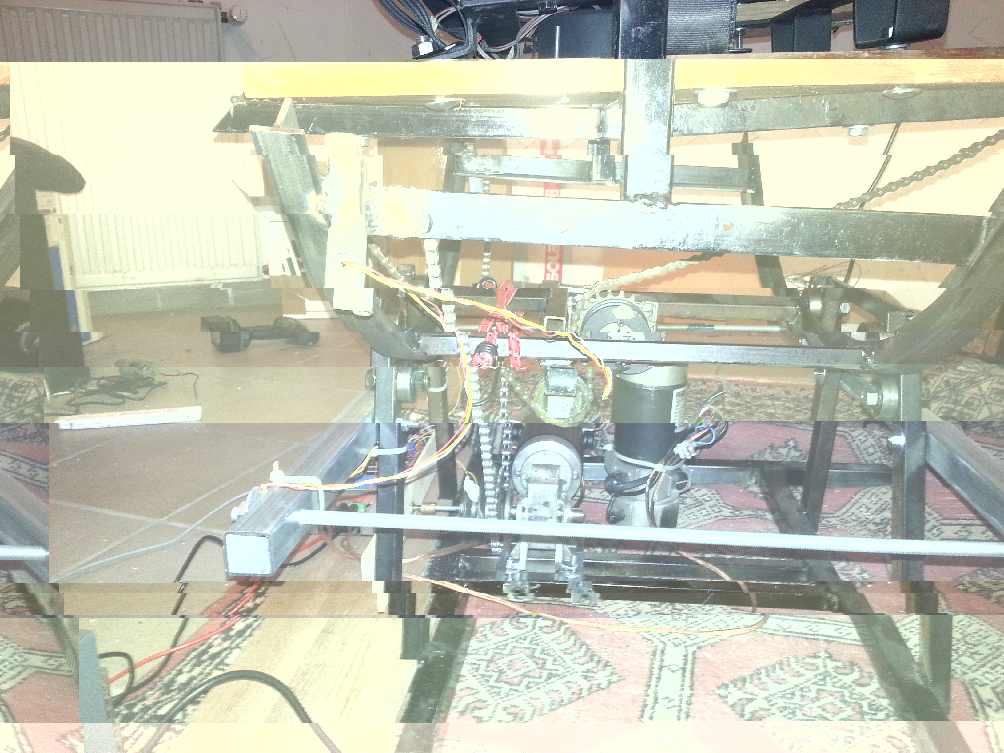

I want you to introduce my selfmade Simulator.
Using: (at the moment)
1x K8055
1x Sabertooth 2x25
2x Wheelchairmotr 180W, 8 A, 24V
Power SUpply 24v 40A,
Input: changeable from Microsoft Siedewinder FFB Wheel to Hotas Cougar Flightstick
Tests with Vellemann Demo succesfull.
Some Problems with X-Sim because Potis Vellemann etc.
I like Flightsims , Coasters and Car driving
This is for what i need this kind of sim.
So i decide to take Motors instead of actuators because my favorite is flightsims
i try to ad a little video für the motion
but you have to know that i am a totally noob in electric.
here the youtube link http://www.youtube.com/watch?v=-LntV7NA ... e=youtu.be
Here are som pics
menix

Re: My Simulator
Postby menix » Tue 12. Feb 2013, 16:14

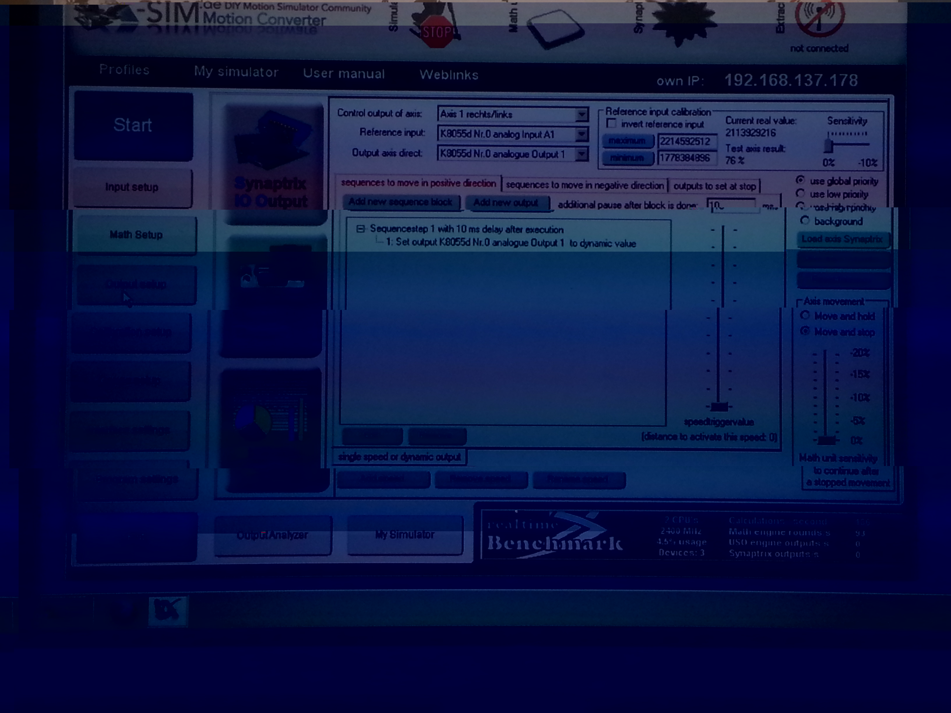

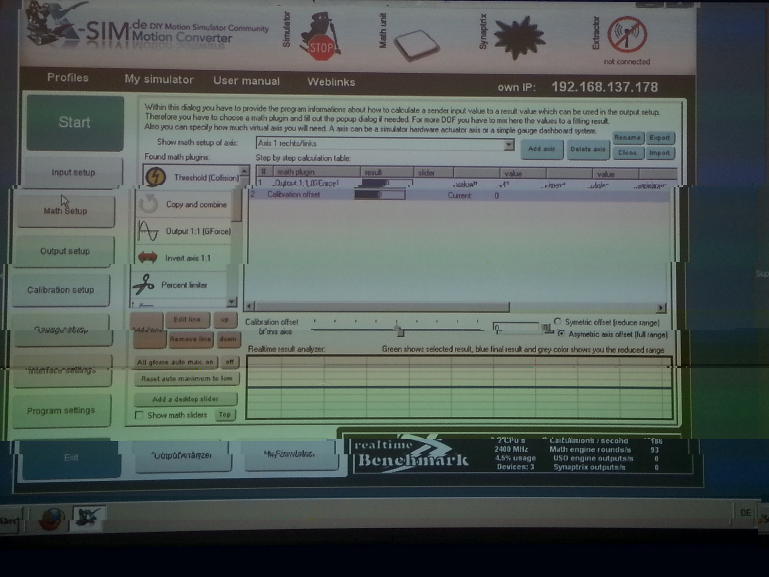

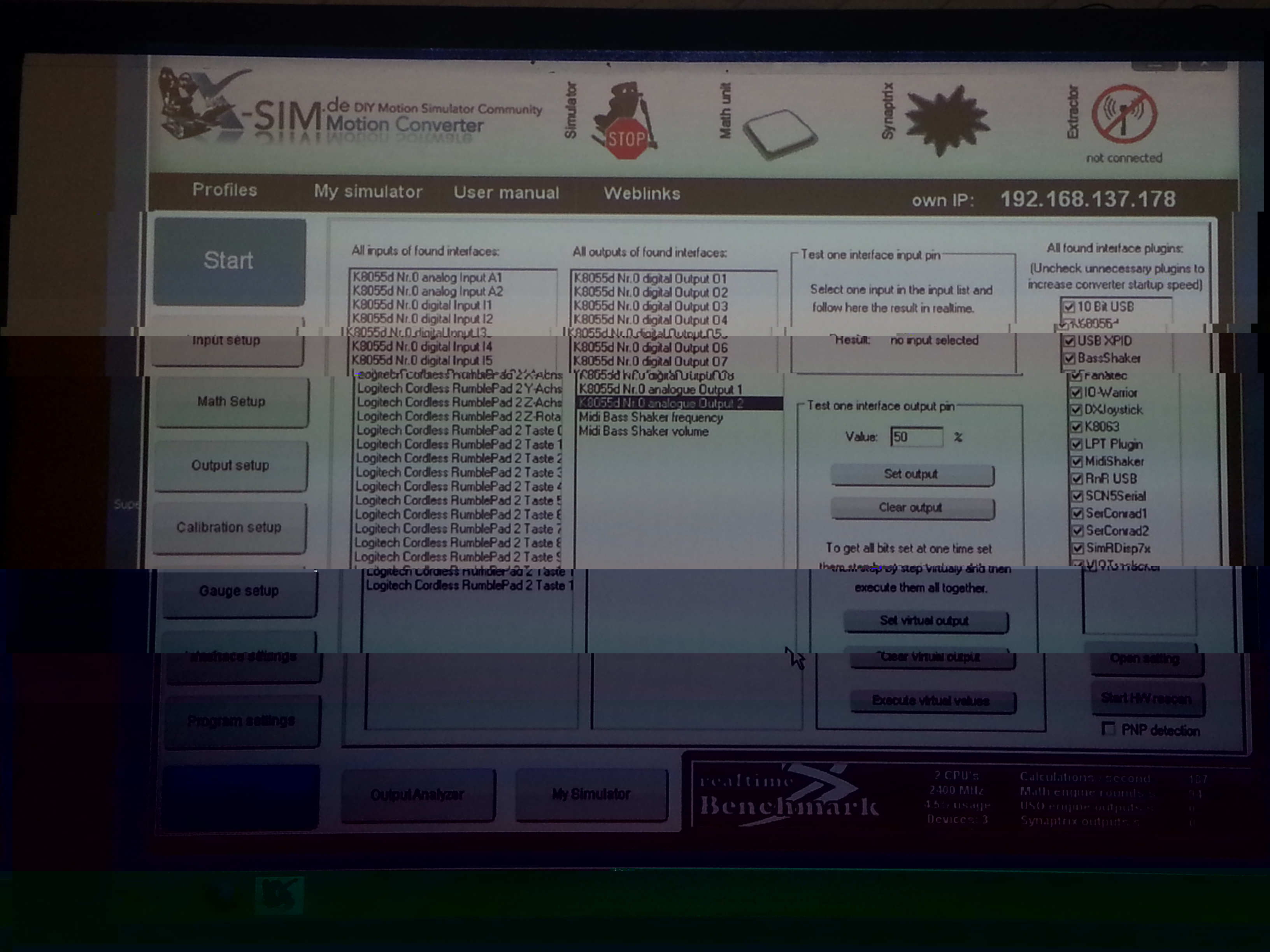

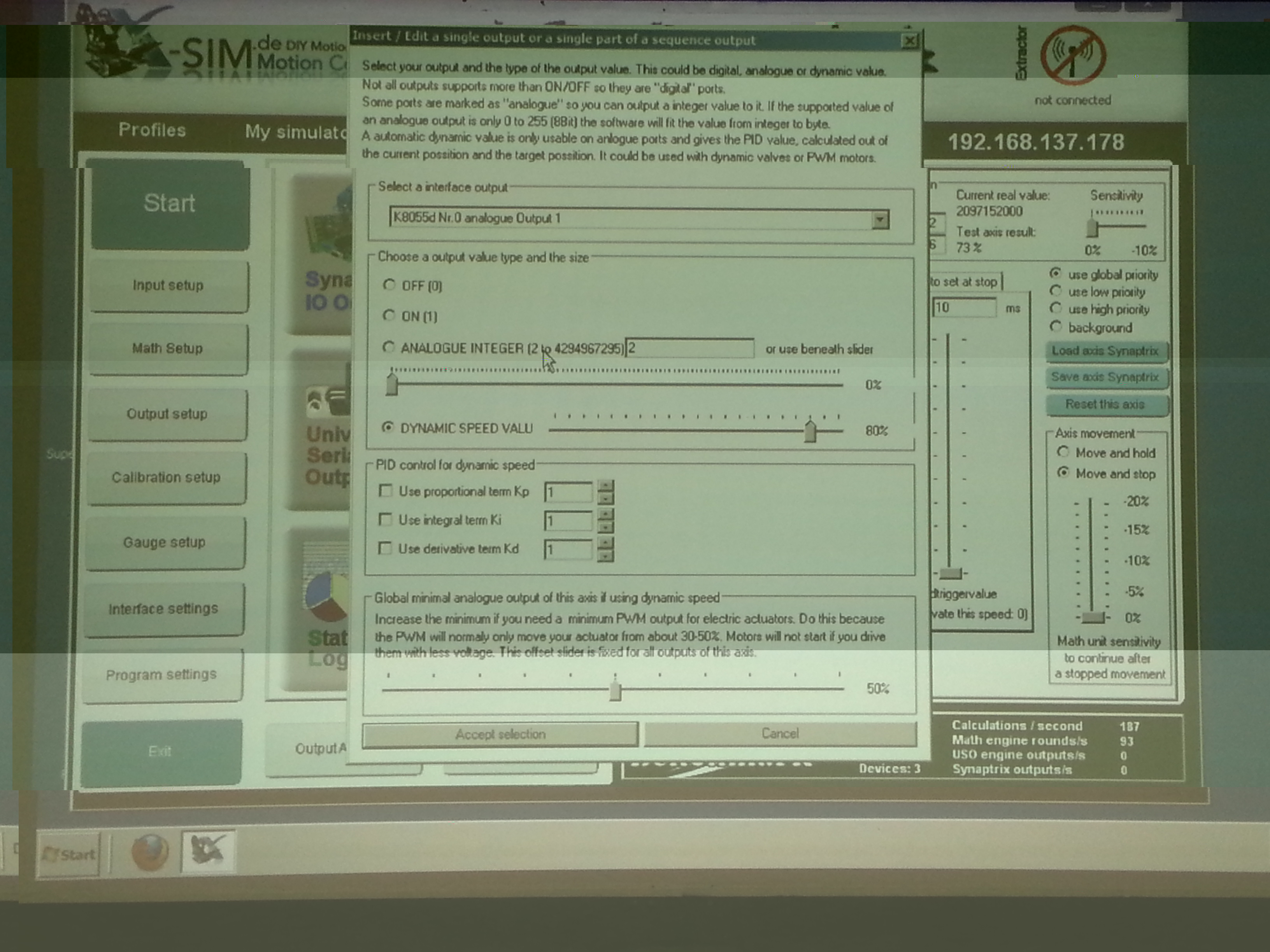

Waiting for my new Potis. I havent known that the Potis must have a full Rotation for good movement, mine are 10 gear potis without gears.
So i decide to buy 3 gear Poti with a 2:1 gearbox to have exactly the movement i want.
Some pics of my X-Sim Setup, i dont know if its right or not
Comments are welcome

Postby menix » Tue 12. Feb 2013, 20:29
i took my settings from kevin.
but i have still the problem with my 10 gear poti. So i have to wait for the new one.

Re: My Simulator
Postby menix » Thu 21. Feb 2013, 07:19
here a small update with my new Pots
menix

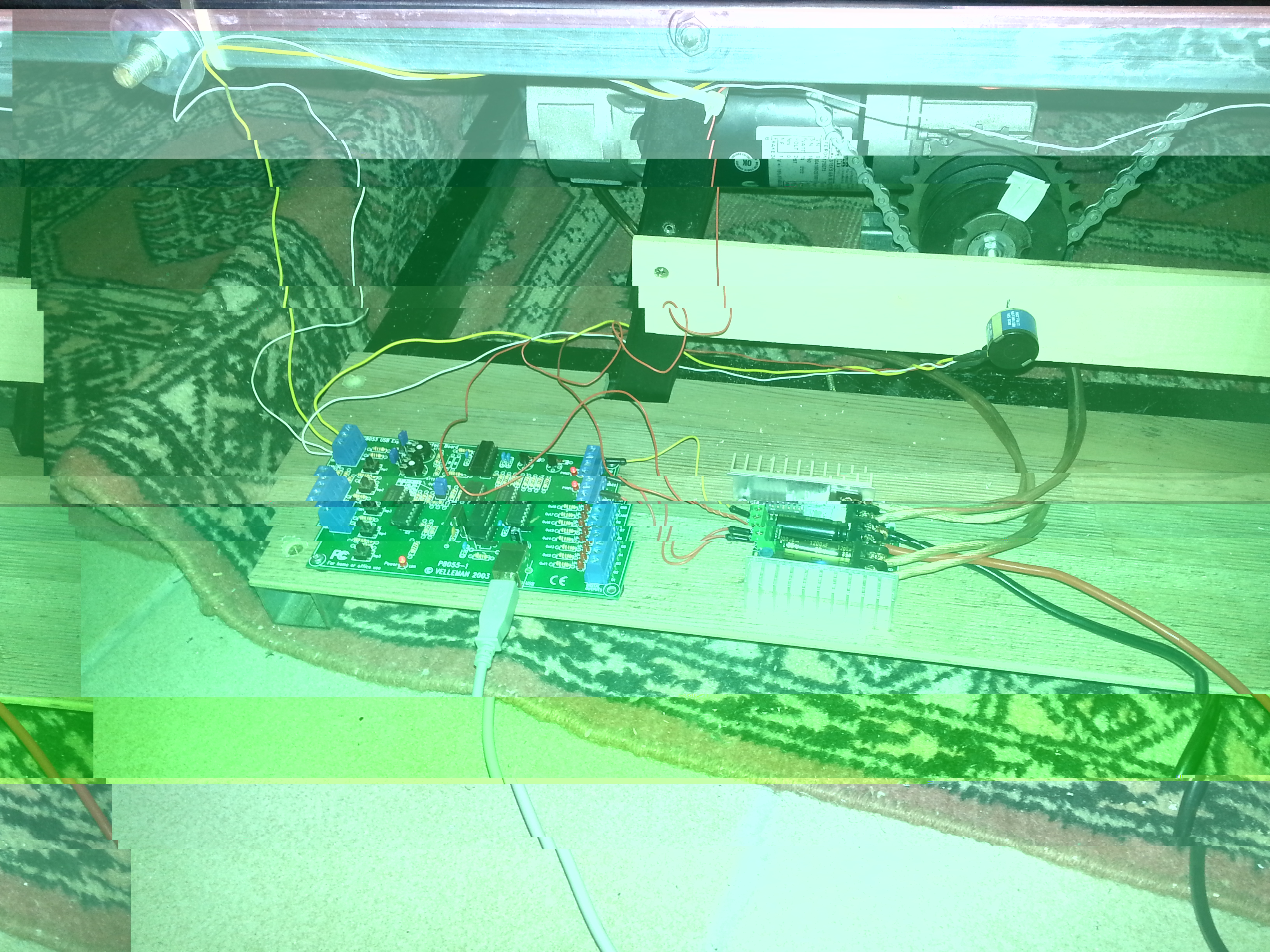

Postby menix » Sun 15. Sep 2013, 07:29
Now i change my Solution instead of Vellemann i will now use a Arduino Board.
I hope i get better results .

Postby menix » Sun 15. Sep 2013, 07:44
ok now
i have this Dual H-Bridge
http://www.ebay.de/itm/330854284636?ru= ... 26_rdc%3D1
My first Problem is, the cables of the PSU Unit and the Motors are to big for the Driver.
What can i do to fit the cables in??
menix
Posts: 36
Joined: Tue 20. Mar 2012, 19:44
Re: My Simulator
Postby telfel » Sun 15. Sep 2013, 10:54
Hi
Answer to your cable problem have you looked at crimp on ferrule,
I had one of those H bridge lasted less than 30 sec before it failed, 24v 375w motor.
I see you have a sabertooth h bridge, can I ask why change?
regards Terry
