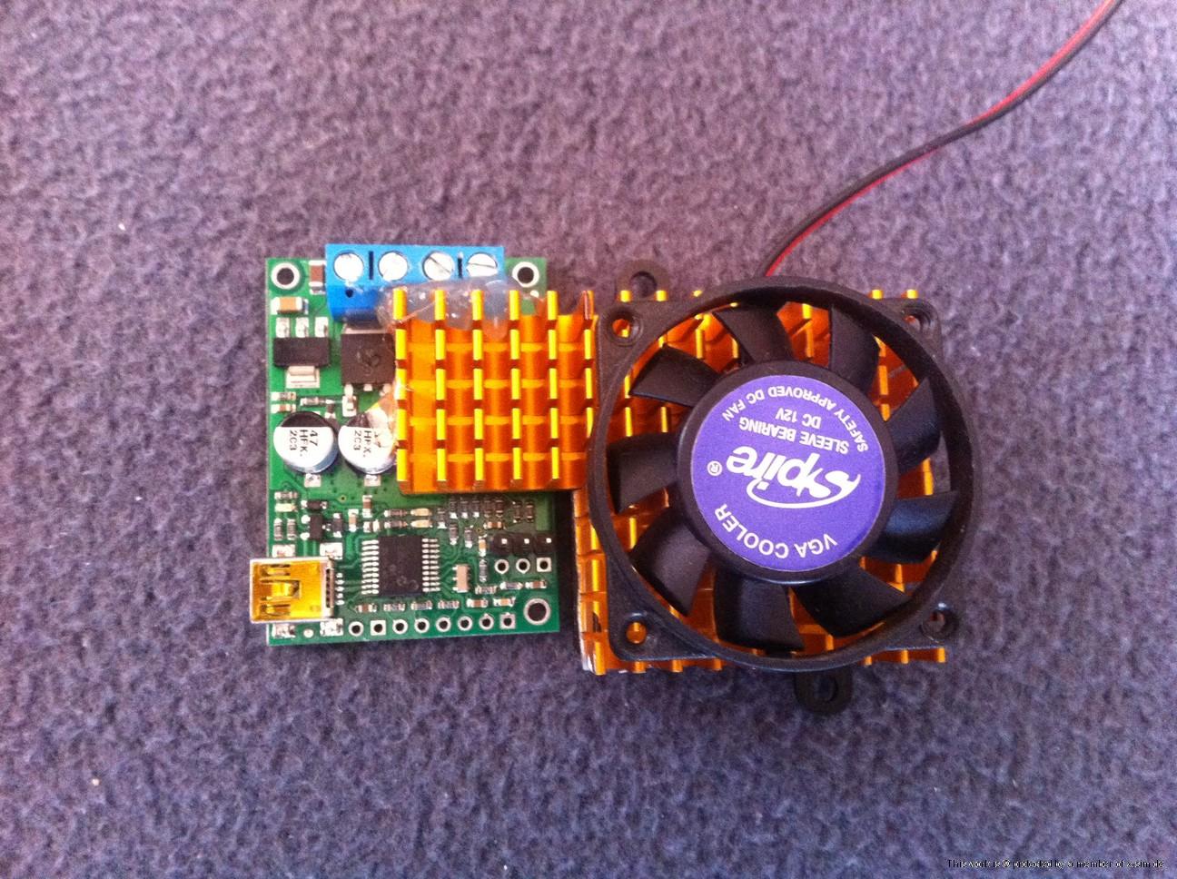

Yesterday I had some time to play with JRK's and cooling system.
1311131213131314
I couldn't find some normal heatsink, everything I've got from old CPU's were too big, so I've needed to cut something I've found from old graphic cards. Finally keeping all that old computer garbage turned out to be helpful :)
I've put some thermal paste on JRK chip, put a heatsink with small fan on it and glued the sink with plastic glue on the blue terminal. The problem is, if the heatsink gets too hot, the plastic glue will melt and heatsink will fall off. I'm gonna see if this would happen again, if it does, I'm gonna take MotionDave's advice and glue it with proper strong glue.

Put a heat sink on the big chip of the jrk and fan cool it.

OK, moving on to JRK's, how do you people apply heatsink on it? I mean, I have an heatsink from old CPU which I will need to cut it, but how to make it tight on the JRK, fixated so it doesn't move?

Postby motiondave » Tue 8. Jan 2013, 14:11
Some people use thermal tape I have seen.
I used heatsink grease, sat the heat sink on and glued the edge to the blue wire terminals. It stays put. Not a firm sit on , but it does still transfer the heat.

Thanks for the glue advice Dave. I've used some thermal paste and glued the heatsink with hot plastic glue on blue terminal. It's pretty tight right now, it did the trick 8-)
