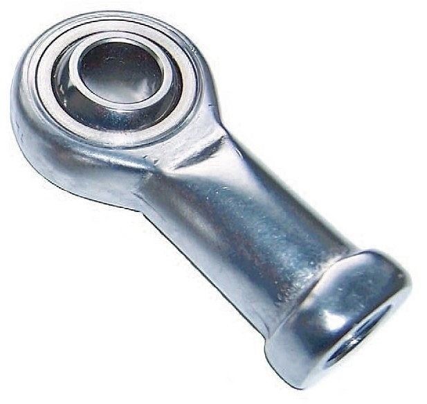

2x wire tensioner M12

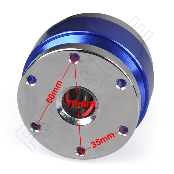

My wheel is an original Logitech G25 electronics. I ordered an EMS steering wheel on Ebay that is dished 75 to 350 cm.
Chilicoke Logitech G25/G27 Steering Wheel Adapter (Homemade) from acrylic glass.
Snap off from ebay
