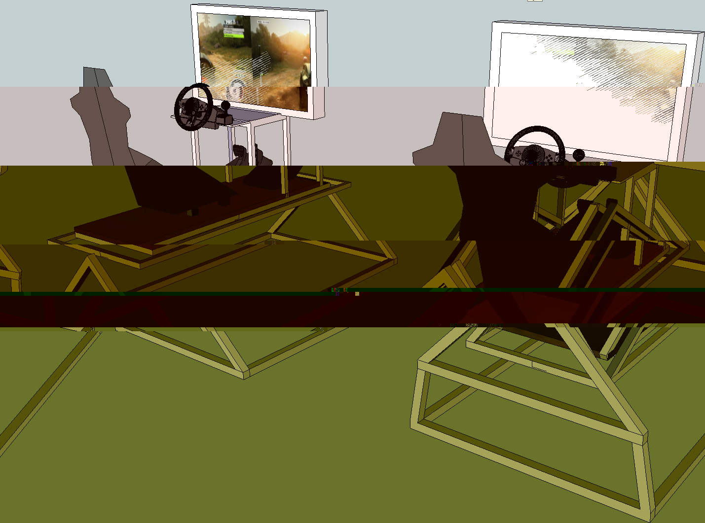

So I've decided to start building my sim too . My setup going to be like this, any comment, suggestion appreciated:
First i need to choose which build to go.
I want to build something like this>>>>:
, but i think i can't use here wiper motors?? I think i need winch motors, but maybe im wrong????
Inspired of http://www.x-sim.de/forum/viewtopic.php?f=37&t=197
IF wiper motors isn't enough for this build, then ill go for one of these builds, any suggestions???
http://www.*.de/forum/sim-racing-project-2dof-k8055-sabertooth-2x12-stage-2-t3898.html
or this
http://www.x-sim.de/forum/viewtopic.php?f=37&t=129 ?????????
Both have different connecting types, first connect rods to the chair, second build connect rods to the platform+springs. Confused which way is better?
I'm thinking about connect rods to that platform+springs...
but maybe these alternatives are better?>>>> even better then joyrider... ??

Ok, I have done a joyrider with screen on with wipers and JRKS
http://www.youtube.com/watch?v=fKAcXtnxHXU. It was a matter of balance and using the best leverage points, not the axis points.
Make sure the pitch frame is low so the centre of gravity is low.
you can see the idea in the photo.
I suggest rod ends and threaded rod to connect the frame.
Springs were only used on mine because it helped stop the soft plastic gears in the wiper motors from being destroyed as it created a constant load on them, be it a light load.
You will NOT NEED springs with big worm gears or winches.
Use the Pololu JRK, easy to set up, 7 wires, no code to sort and we can give you PID suggestions easy. One per motor.
Power supply looks good, never too much power.
The motion dynamics motors are excellent, but yes there is a cheaper equivalent. Check the threads for this and Floriskes thread.
Cheers, David.

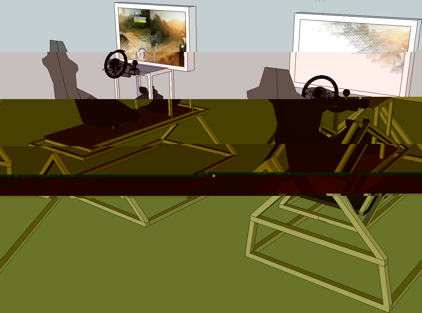

amoras10 wrote:I want to build something like this>>>>:
, but I think I can't use here wiper motors?? I think I need winch motors, but maybe I’m wrong????
Hi amoras10
I started my project with wiper motors and replaced them pretty soon with winches. However as you can see in the project description, I also had to redesign my simulator and lower the axis so that they pass through the centre of gravity. The original design that you are referring to in the picture above needs far stronger motors than wipers or even winches.
New design vs old design
The joyrider design is space-consuming and simulates the low-frequency movements very nicely. Especially driving through curves feels fantastic.
On the other hand the two mentioned Frex-style simulators are much smaller and great for fast and strong pulses, tricking your mind into the game immersion. As I’m slow and have space enough for the simulator I prefer the joyrider ;)
If you balance your simulator nicely (take your time!) you can easily move the simulator with wipers. Tronicgr moved his
simulator with wipers!
