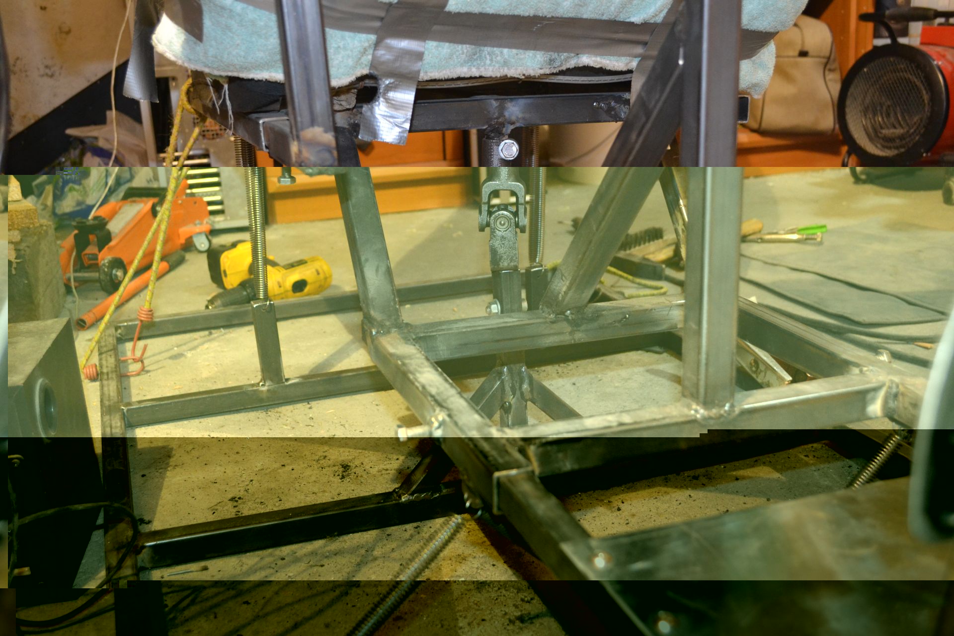

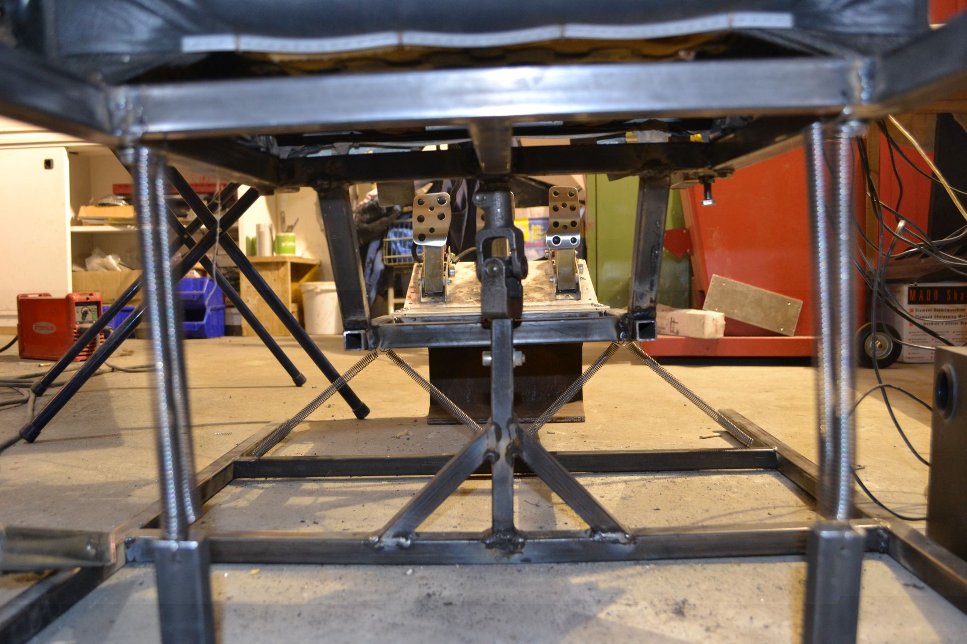

the new motors are inside, new universal joint,
1435

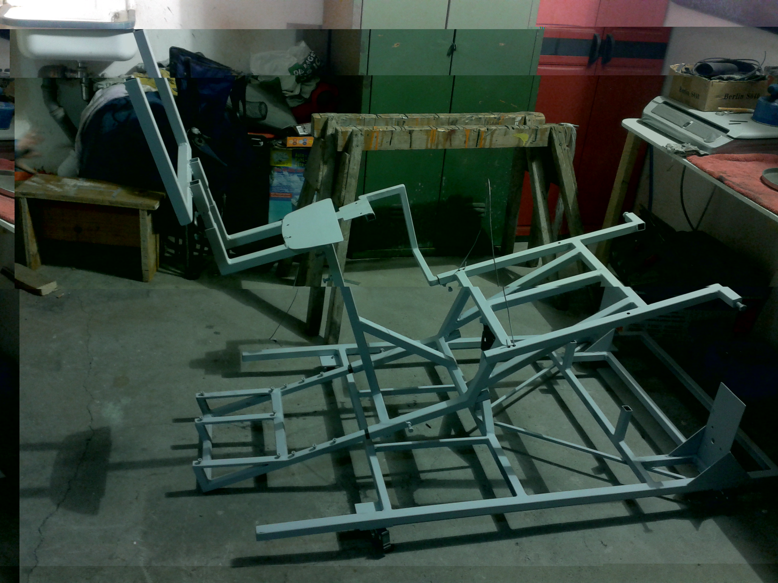

........UPDATE6........08.04.2013........
It´s painted and lighted up now!

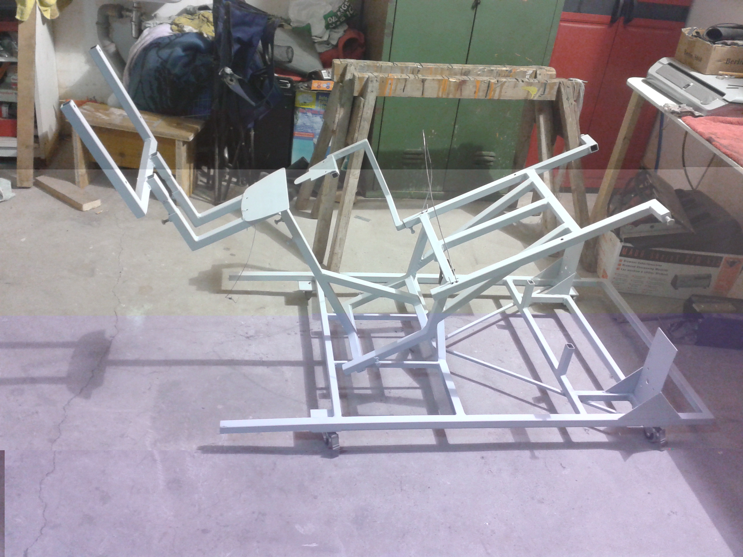

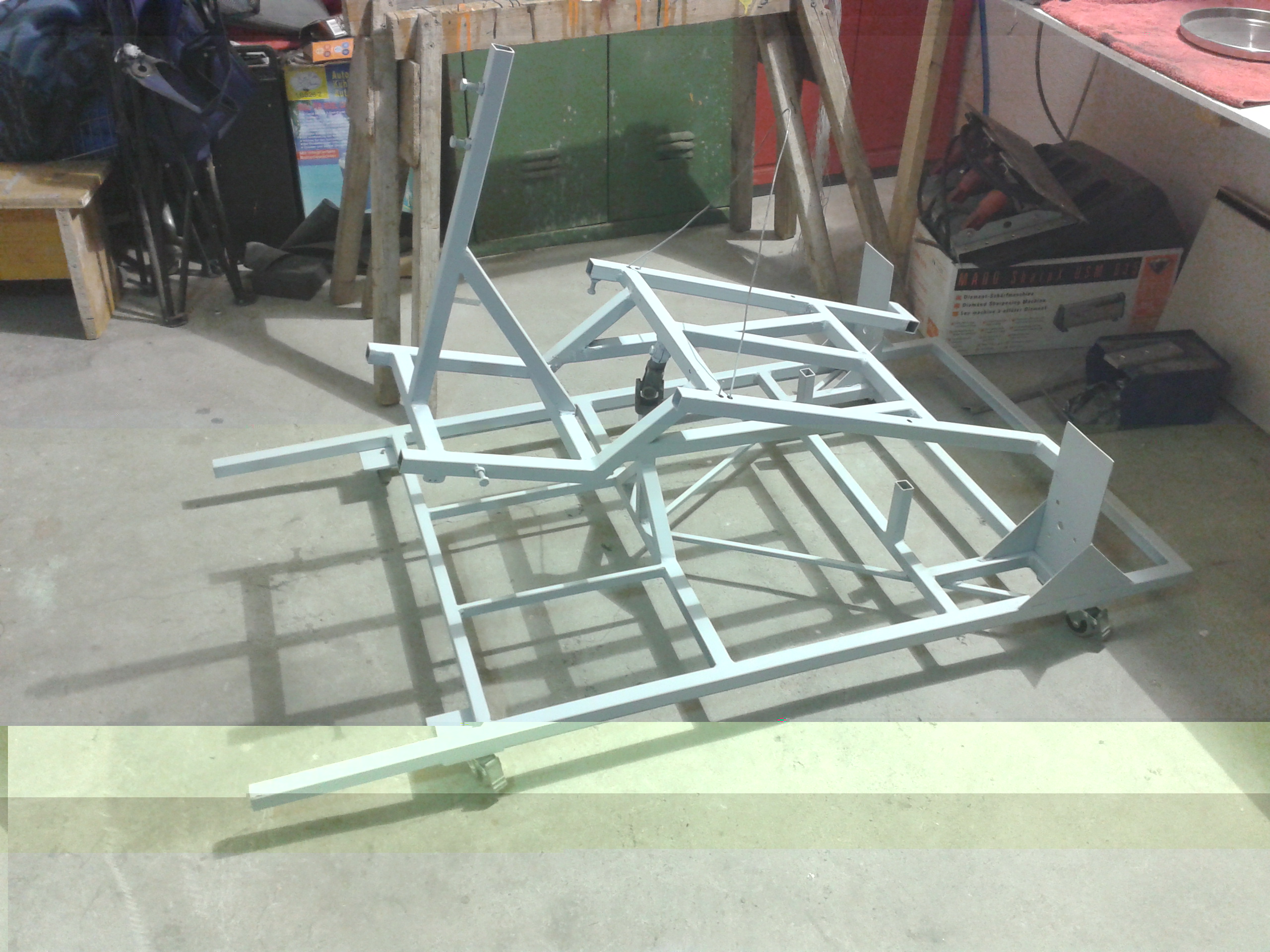

........UPDATE4........31.01.2013........

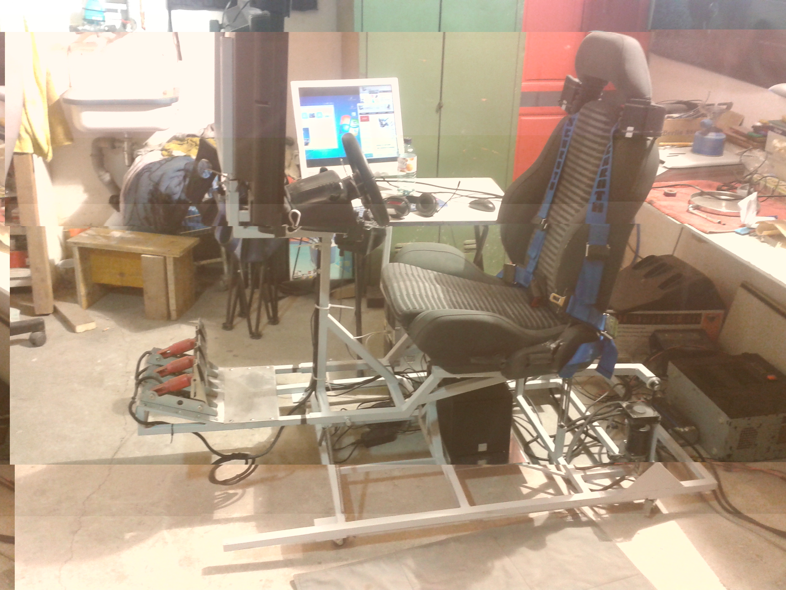

PROTOTYP IS READY!
Now it´s time, to make it beautiful :lol:
* Make wheels on it
* Built a handbreak
* Some work on the balance
* clad in aluminum sheet
* clean weld and paint frame --> half way done, Primer is applied
* electrical cables neatly laid
* mount the PC and the controllerhousing
* mount 3x24" LED Displays
* bass-shakers
Stage2_5
Stage2_1
Stage2_2
Stage2_3
Stage2_4

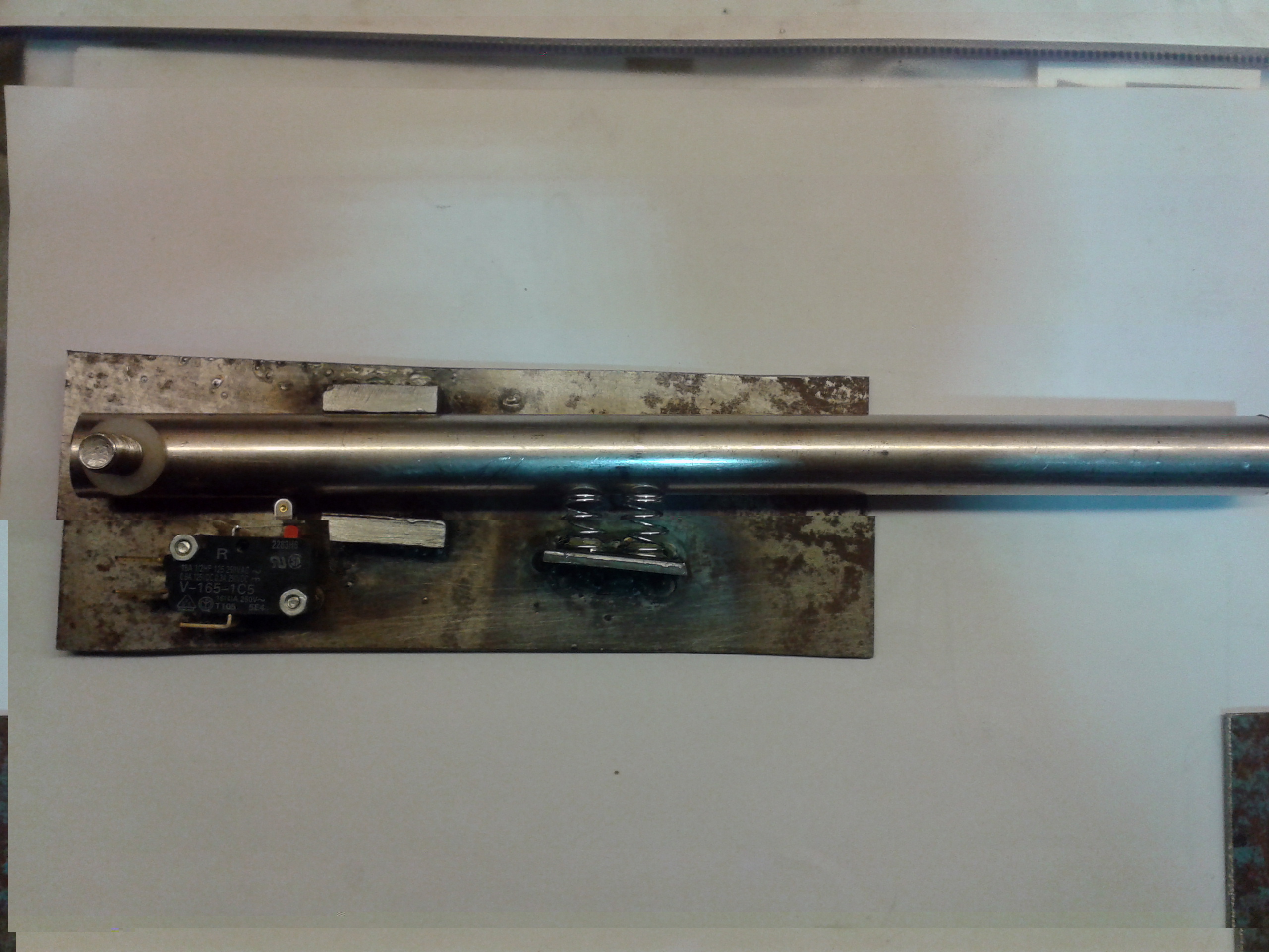

the handbreak (e-break) is a self-construction:
handbreak_1
handbreak_2
Here can u see the finished handbreak:
handbreak_3

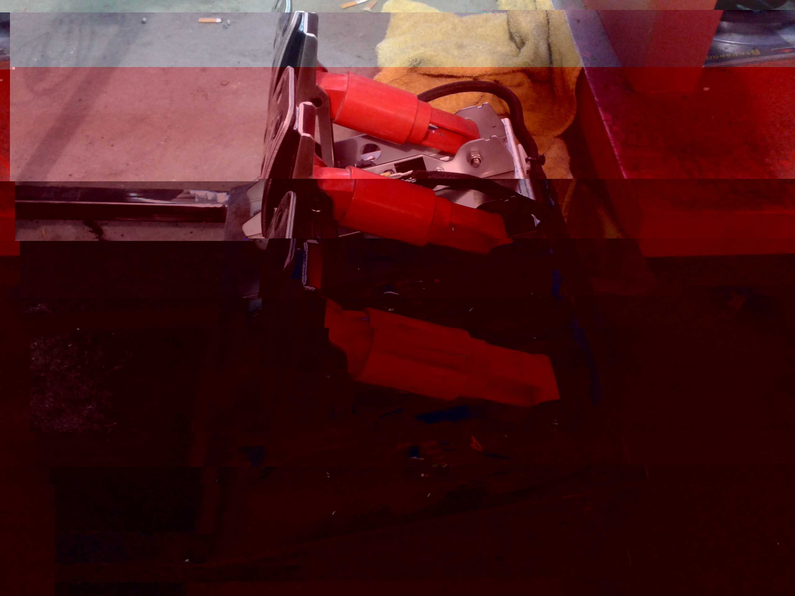

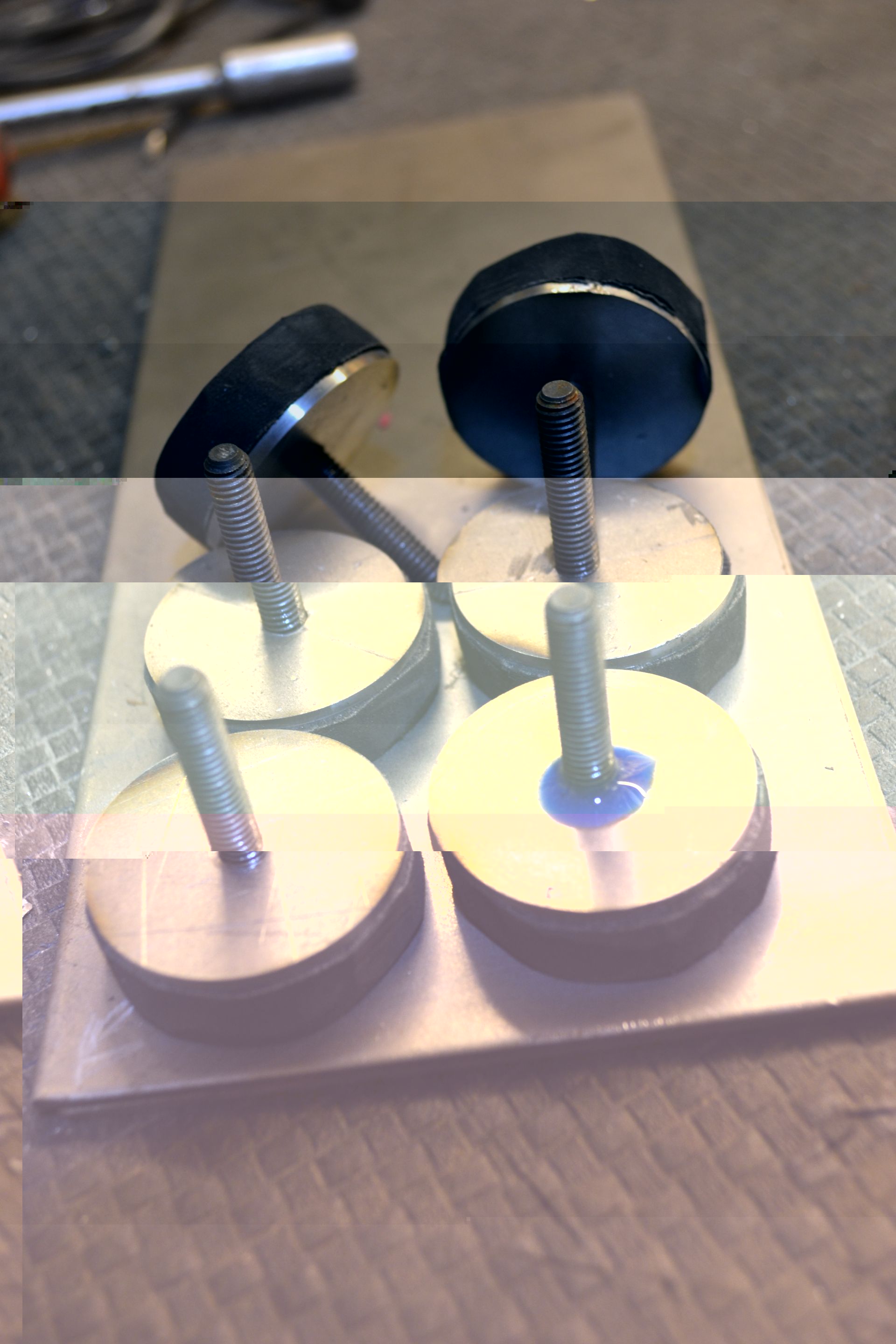

The bassshakers are also came to me. But i´ve to isolate them, because when i gave power to the shakers, my G25 breaks down.
Bassshaker

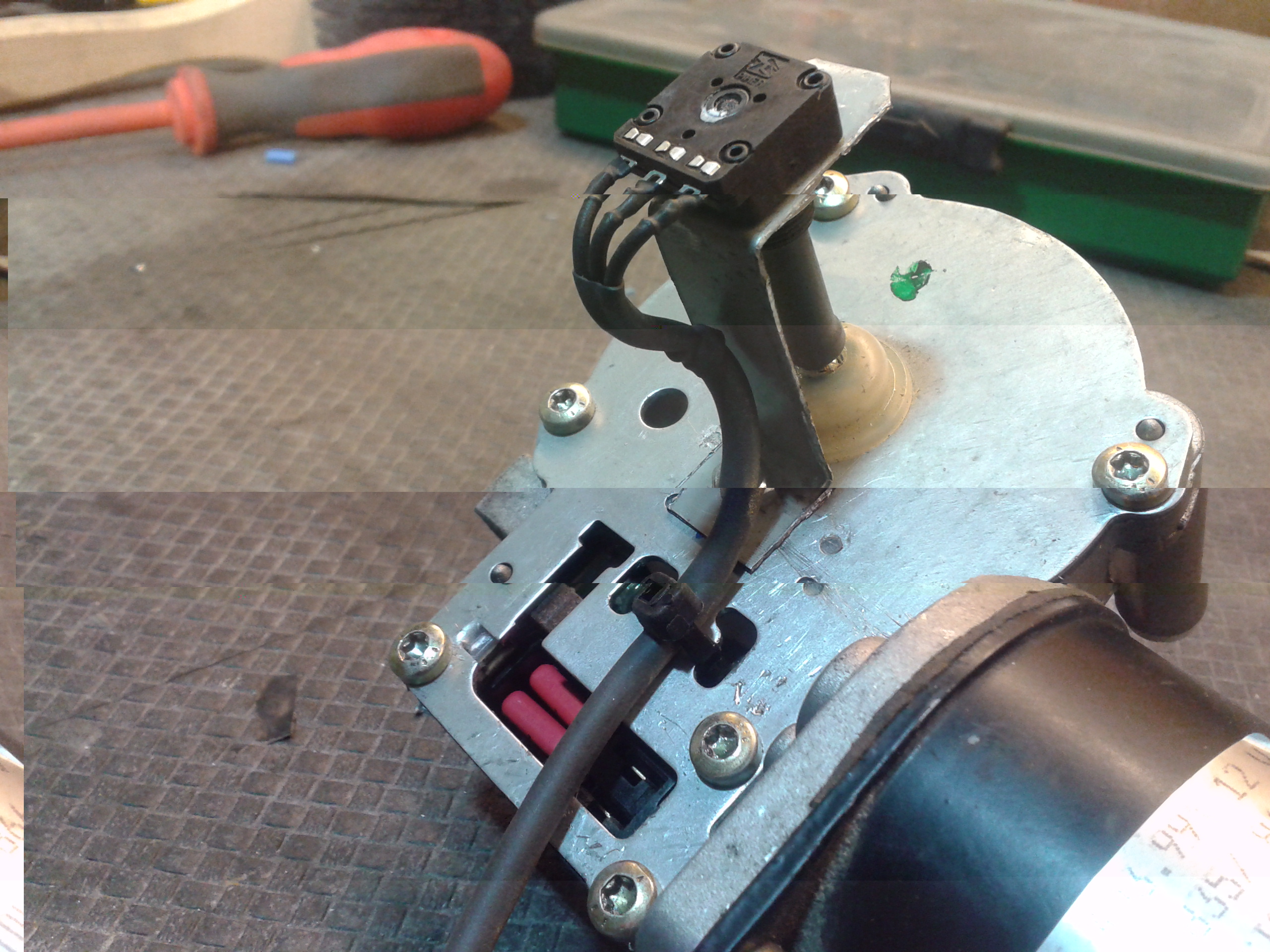

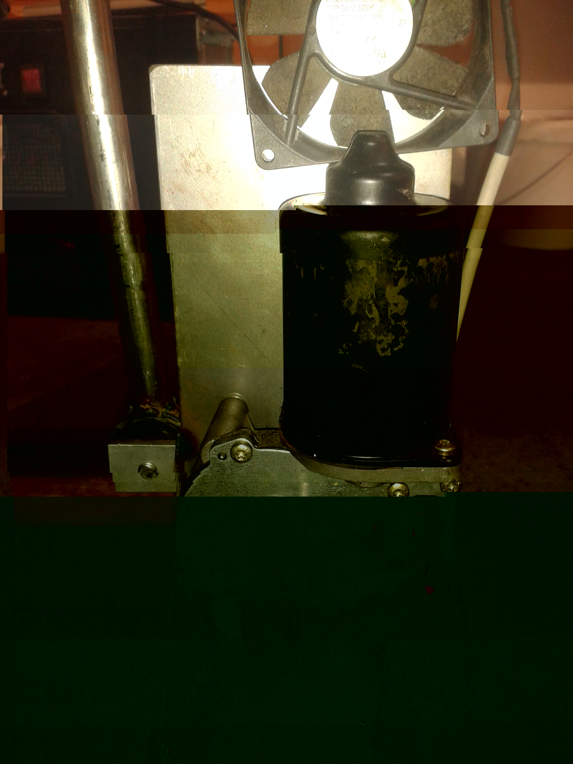

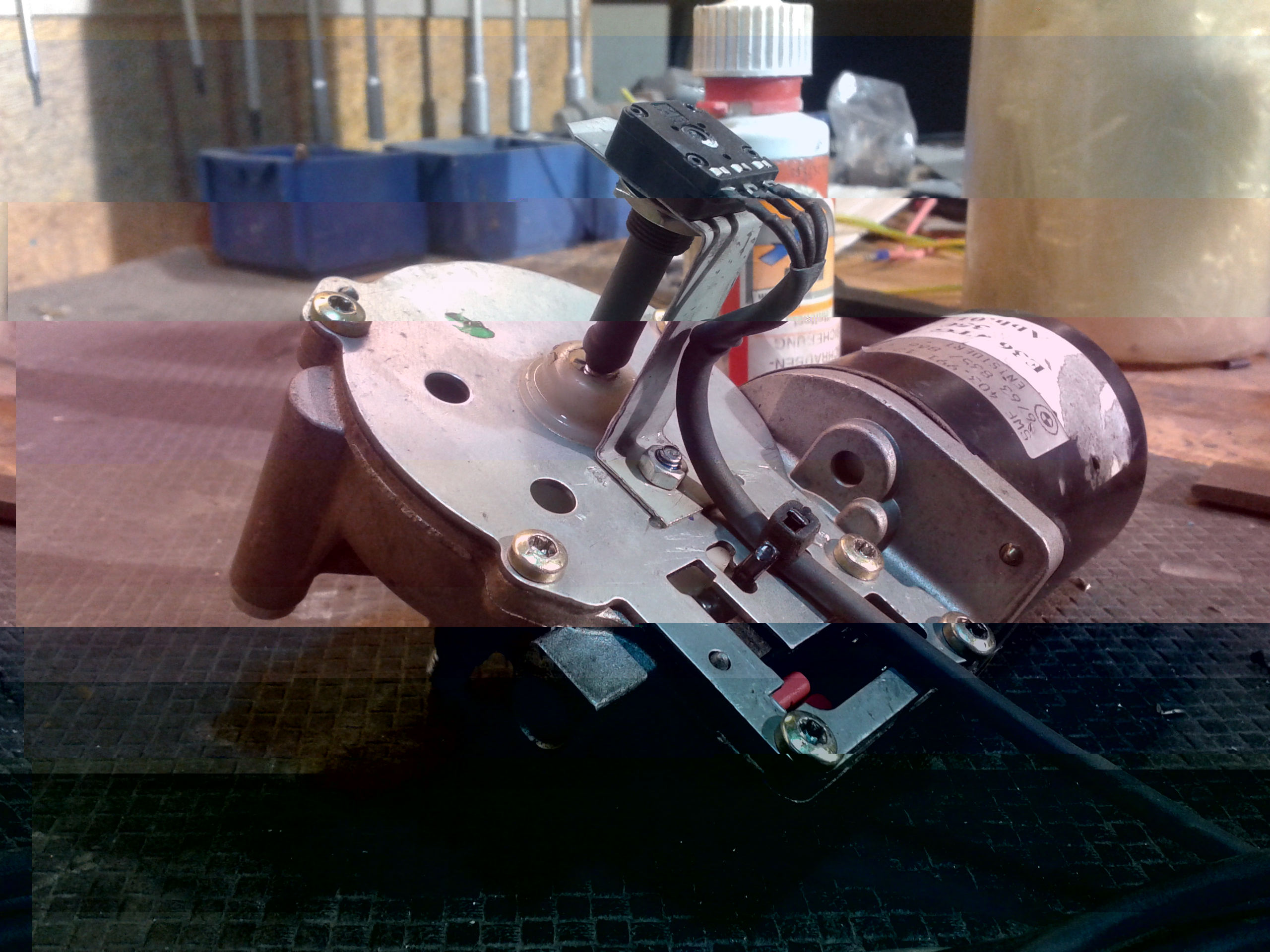

here can you see my special wiper-mod: I´m really, really proud on this Mod.
I removed the shaft and on my lathe i cutted a thread into the back. In this M3 thread, I then glued a screw, which is connected to the potentiometer. So I can now operate the pot without gears in the ratio1:1.
Wiper Mod1
Wiper Mod2
Wiper Mod3

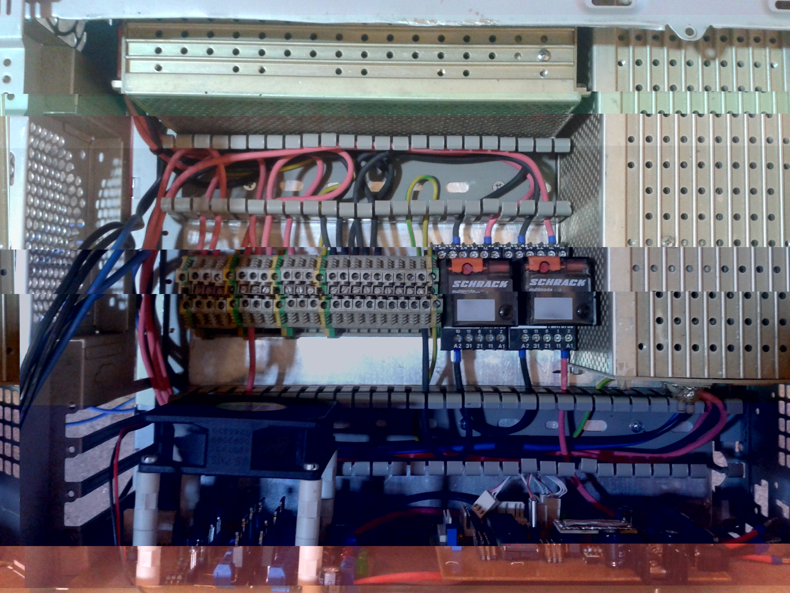

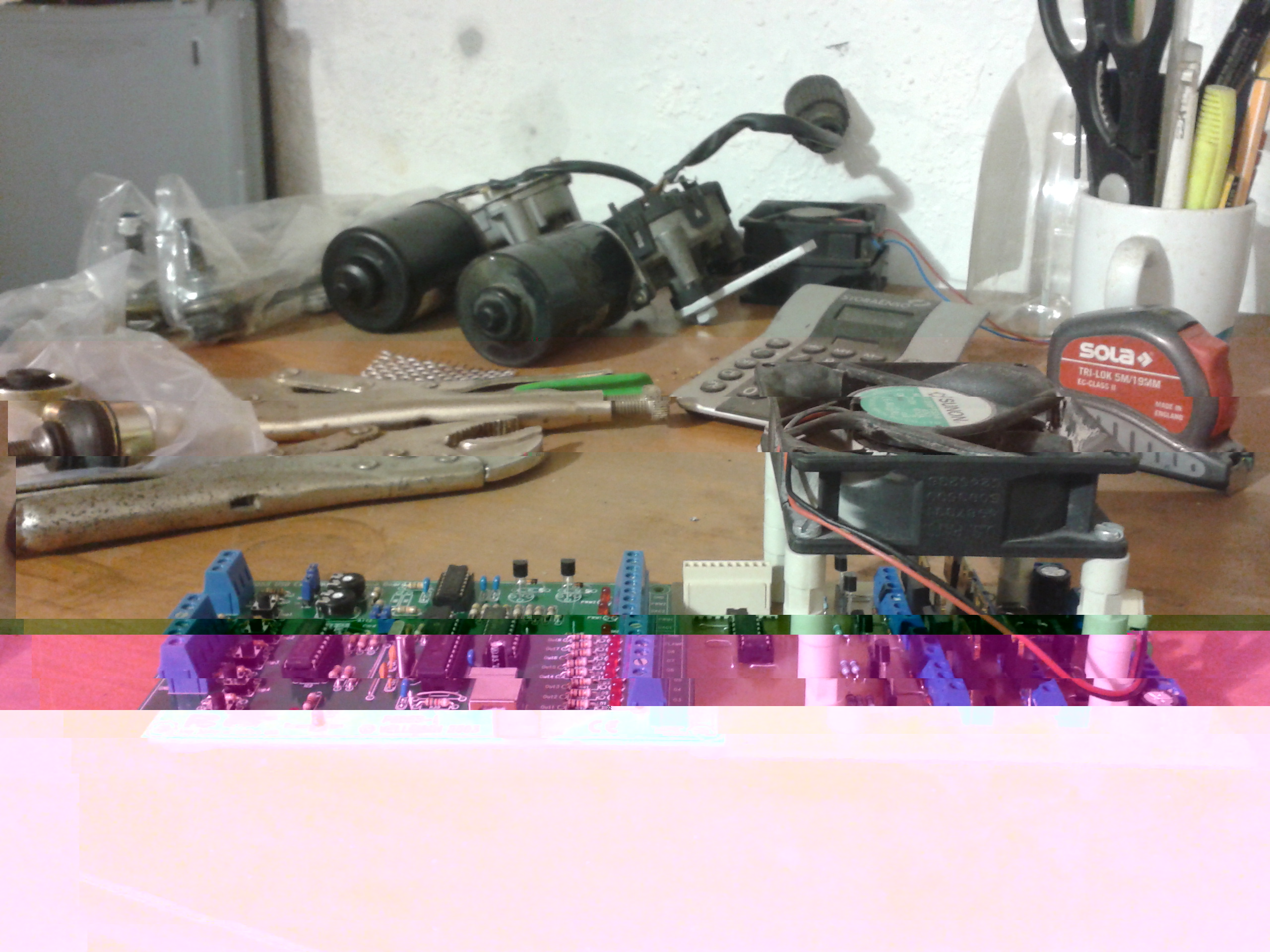

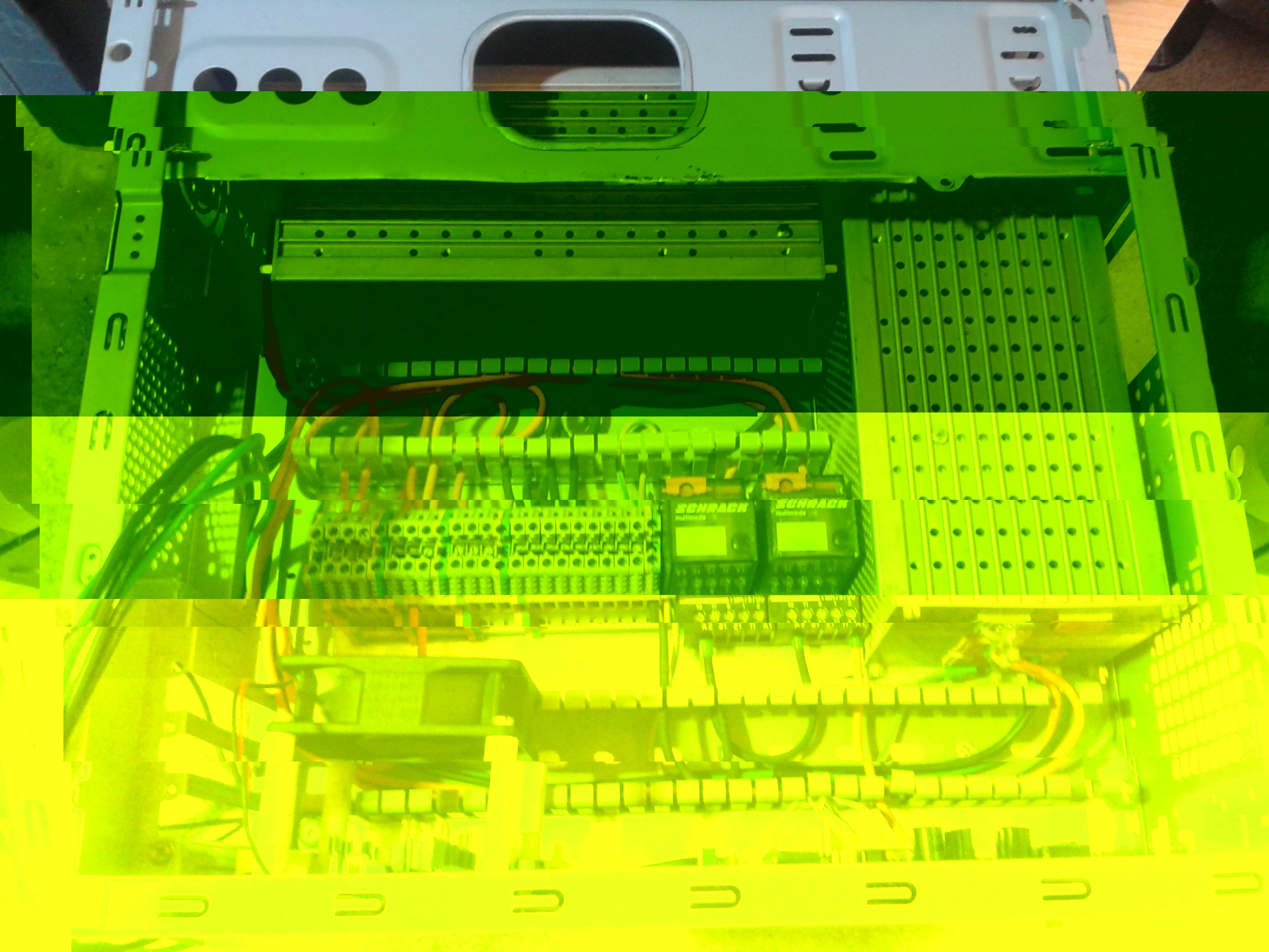

My simulator-control was built in an old PC-Case (not finished), which contains:
2 12V 125W power supplies
2 ralay 12V 10A (for safety switch)
some electrical terminals for 5VDC, 12VDC and 24VDC
1 AMC 1.6 (coming soon)
1 Simple dual h-bridge 1.2b
USB hub (not shown here)
USB creativ 7.1 soundcard (not shown here)
The main-switch and the display for the AMC-controller will be mounted on the cap of the case.
simulator-control 1
simulator-control 2

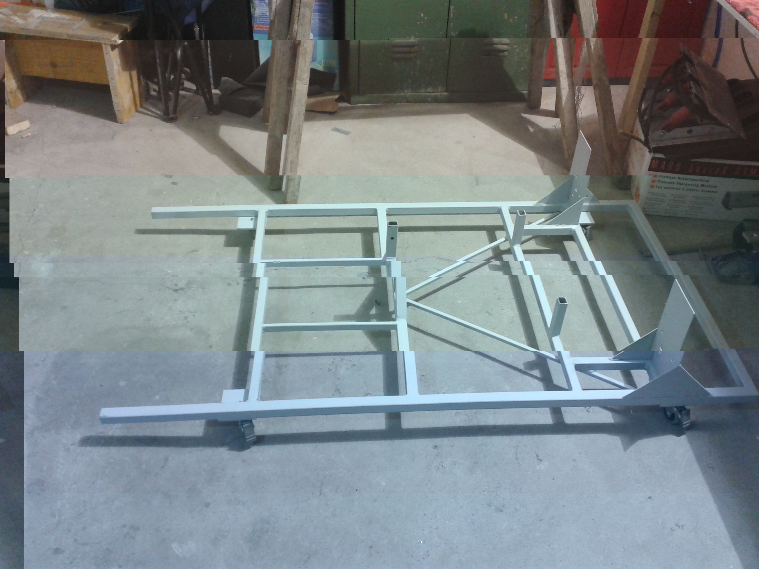

the main pillars are also prepared for montage:
main pillar

the framework is largely built with 25x25 mm pipes.

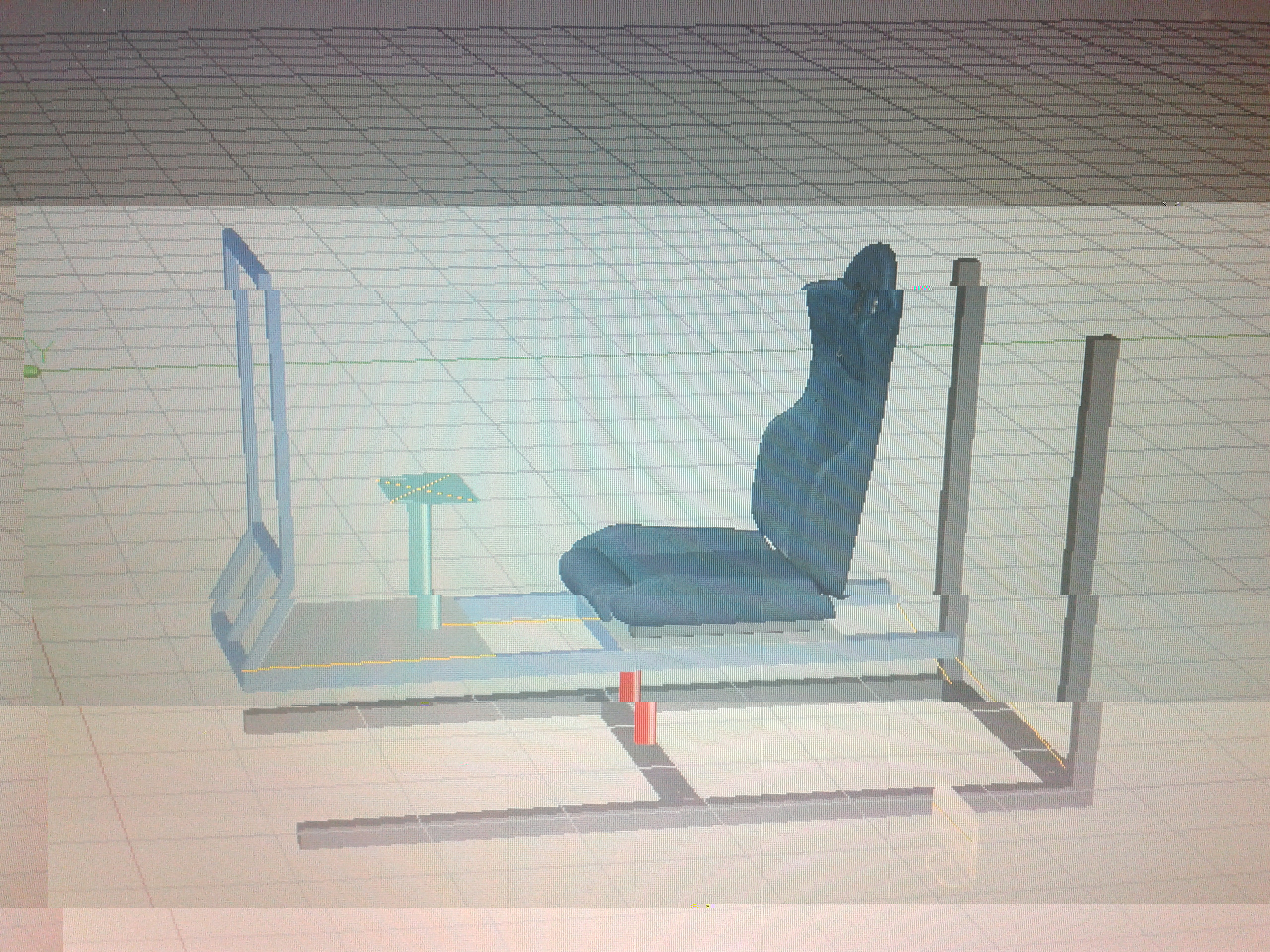

This was a useless sample drawing in ACAD.
then I realized that I should not draw, but build :lol:

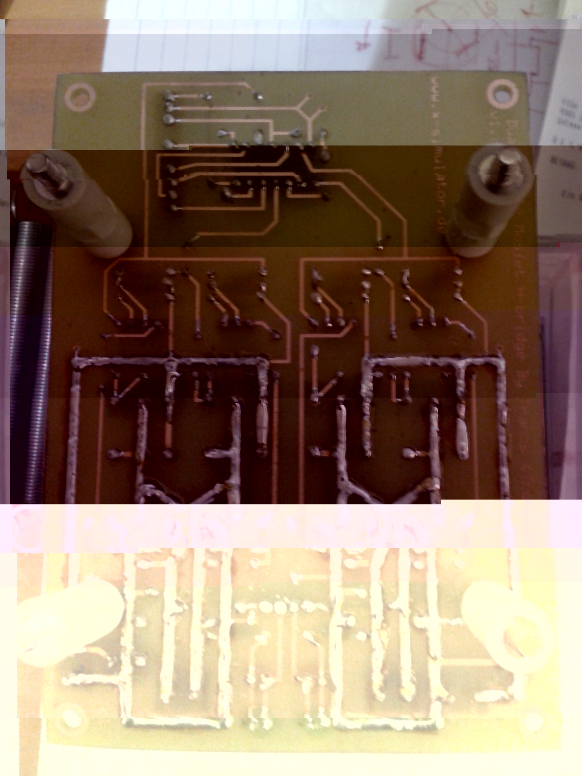

Here you can see, the finished etched H-bridge

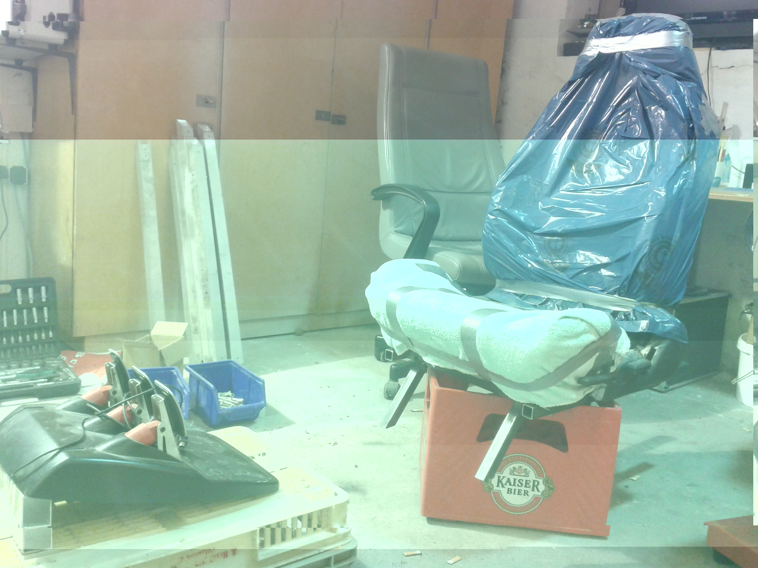

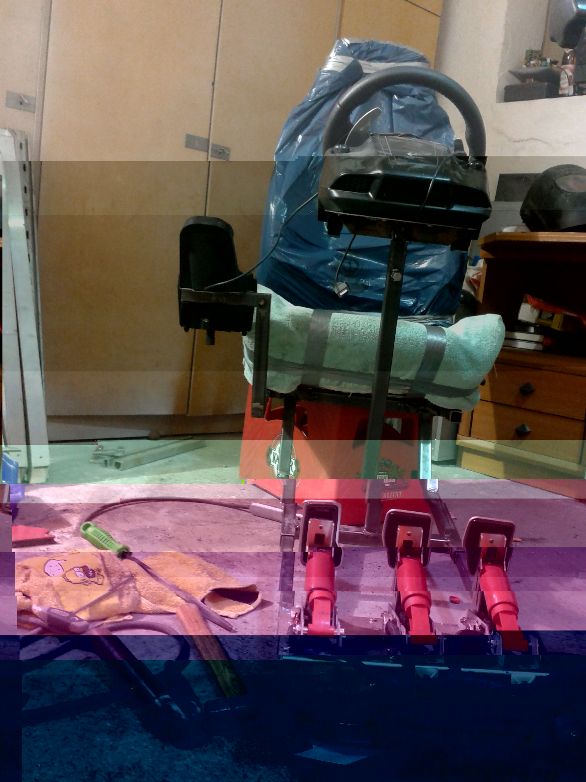

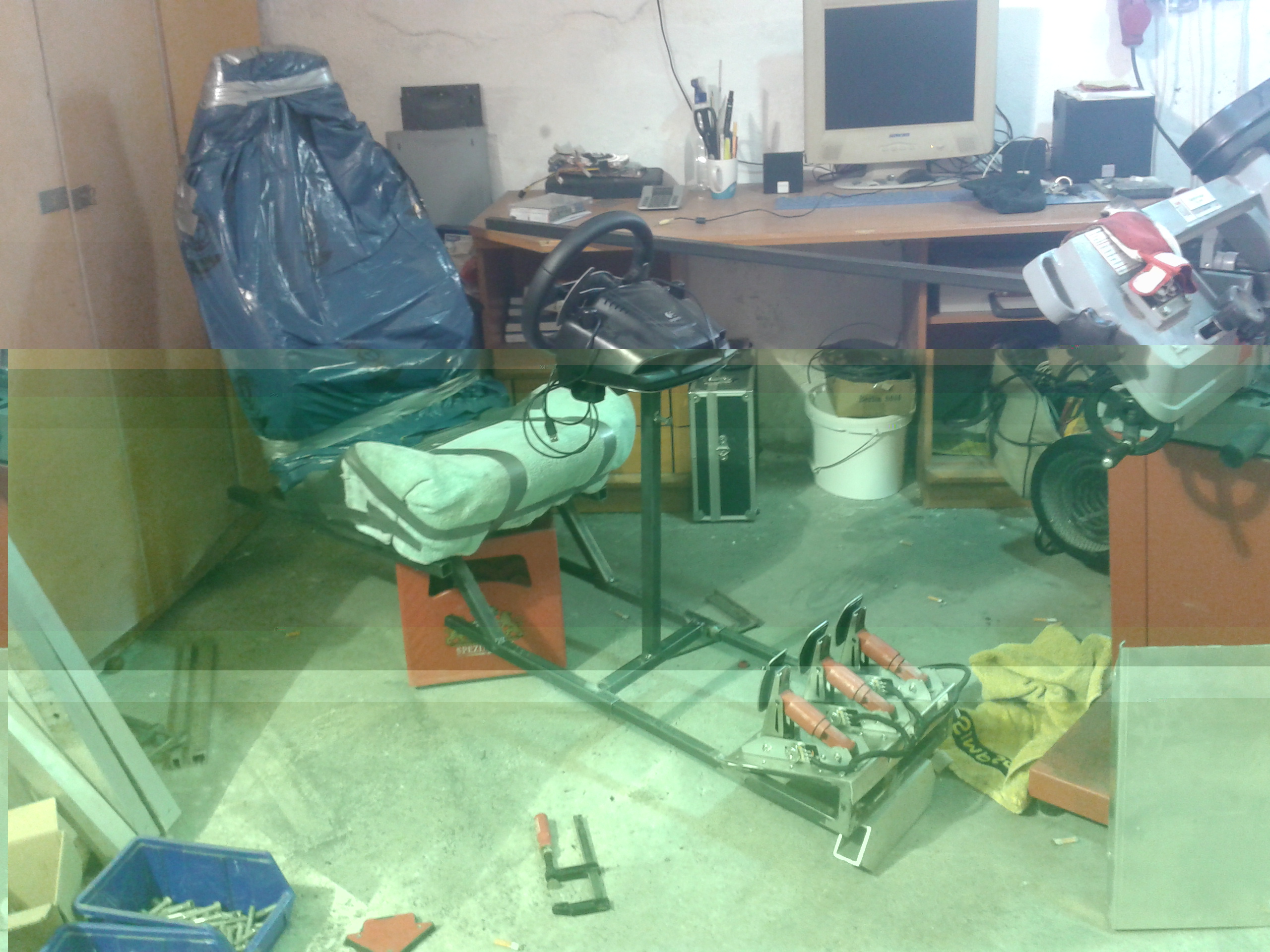

i also began to built the seat as well.

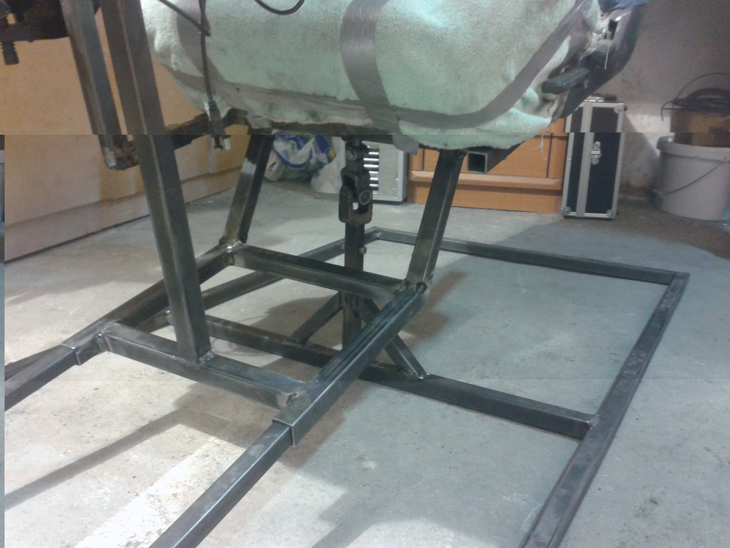

a bit try and measure

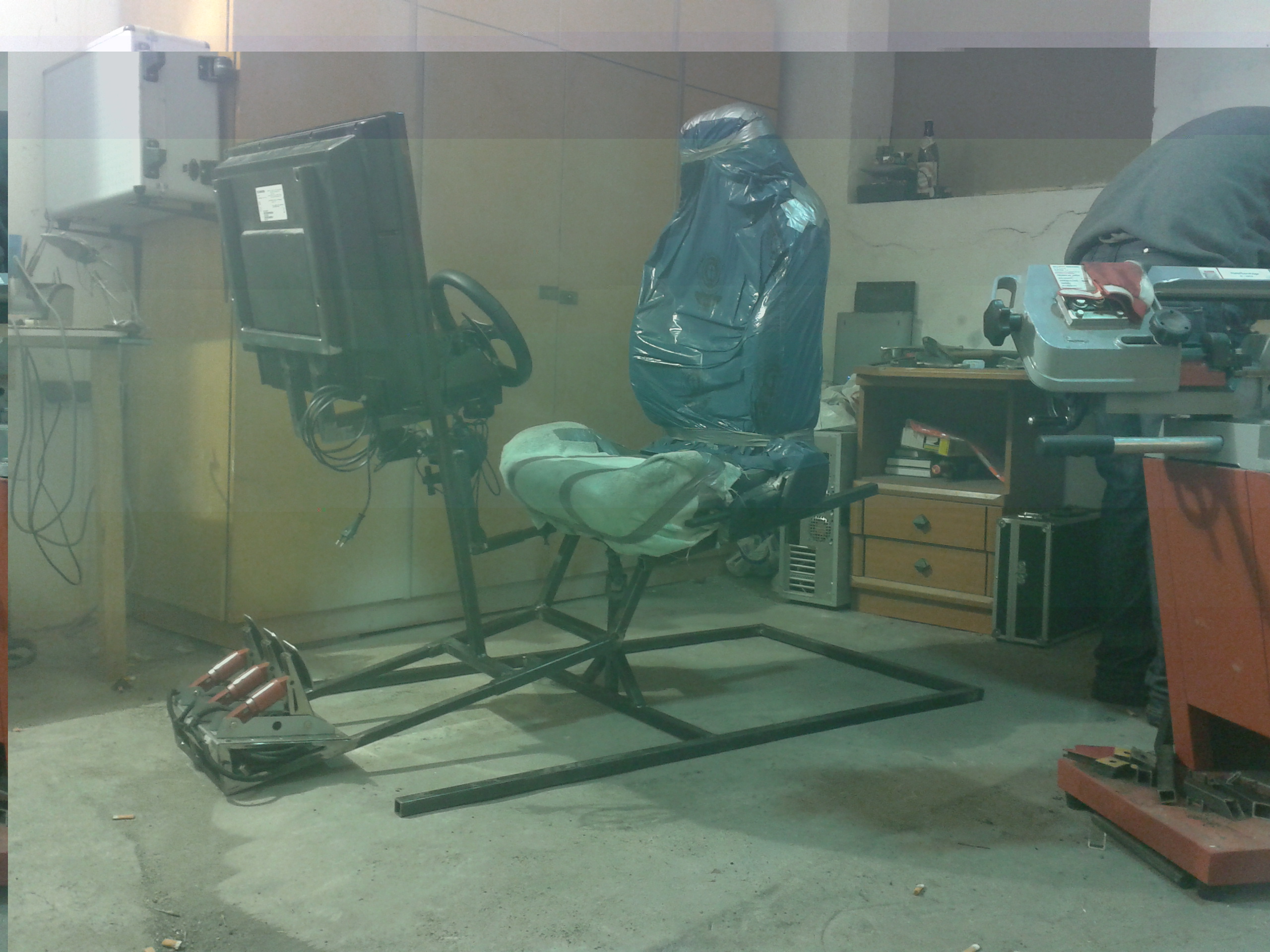

ans so it became slowly a simulator

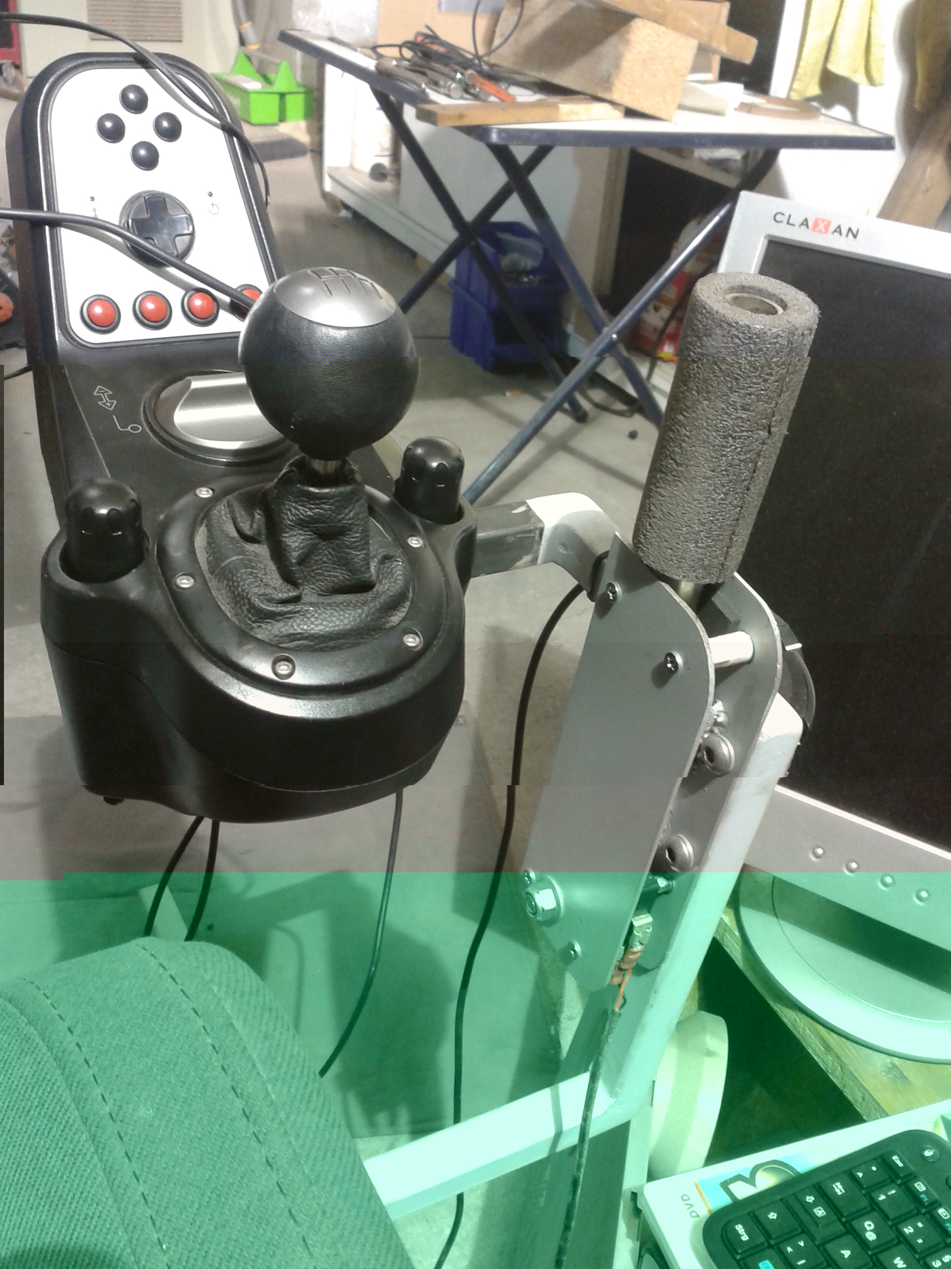

shifter mounted
He stands on his own feet
the hinge

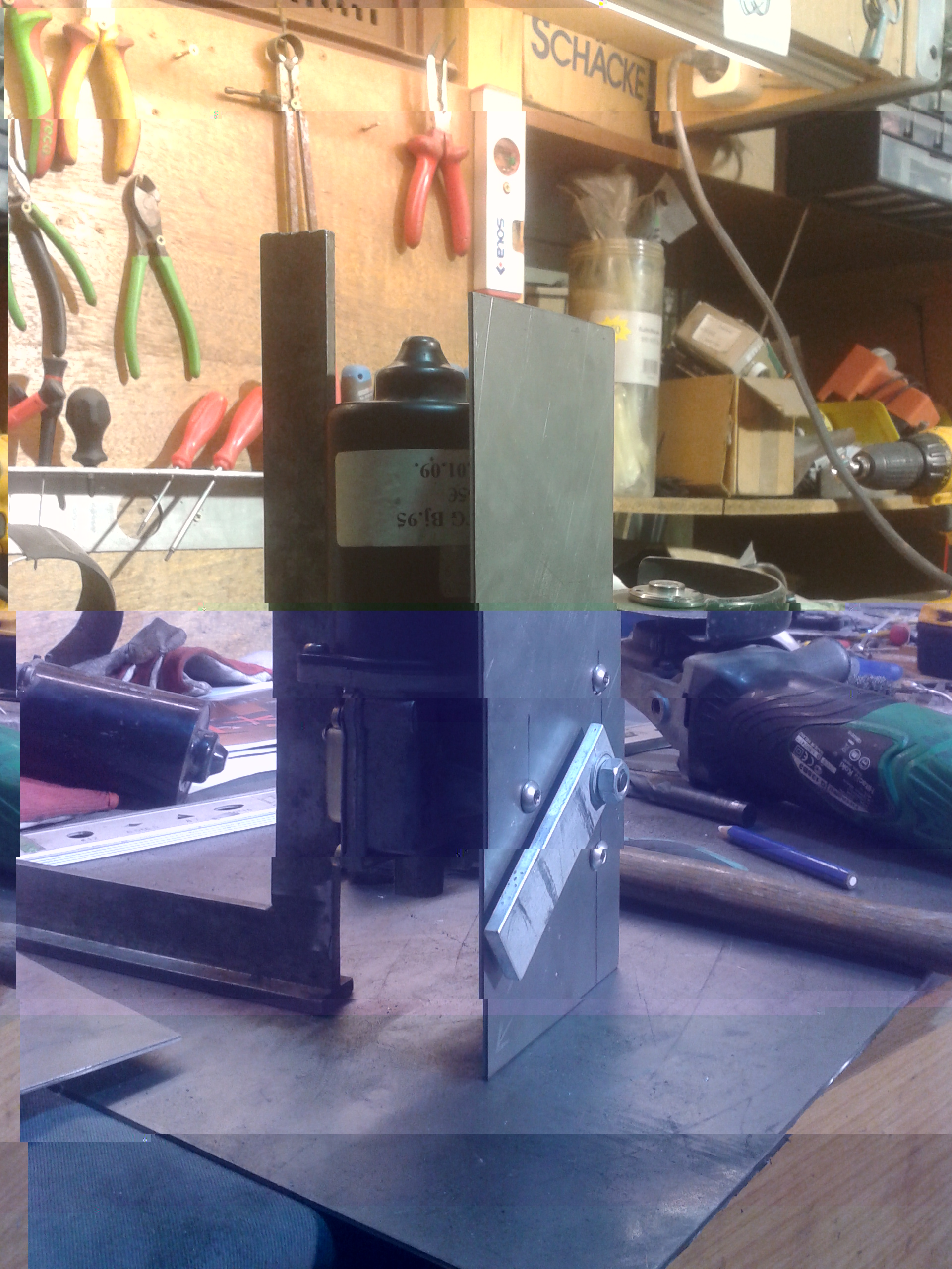

first tests with the wiper-motor

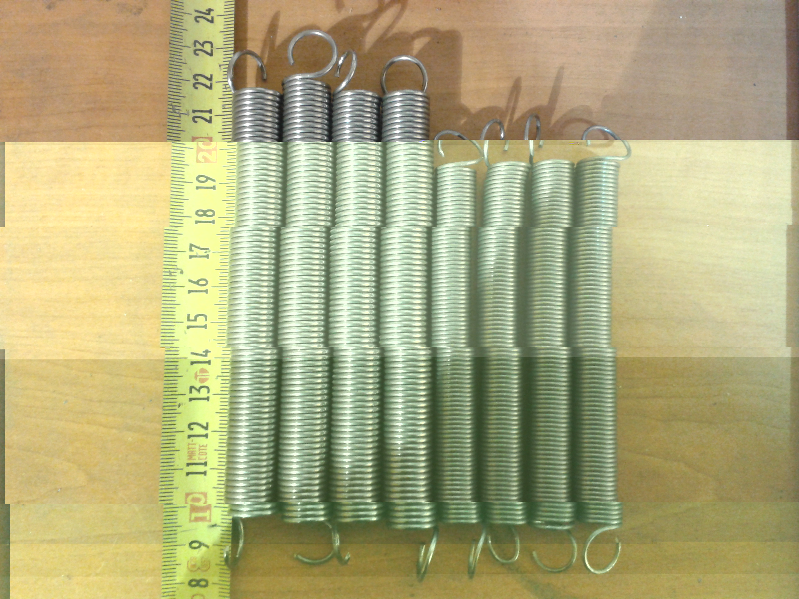

YES, i will need some spings. I hope that these are strong enoth:
Some spings for stabilization
I have it balanced so that the simulator with driver has the focus around in the middle. 8-)

The H-Bridge is also done so far:
K8055 & H-Bridge
solder side
mario318i
