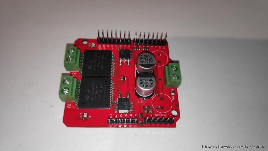

So for starters, I got the basic hardware:
4902

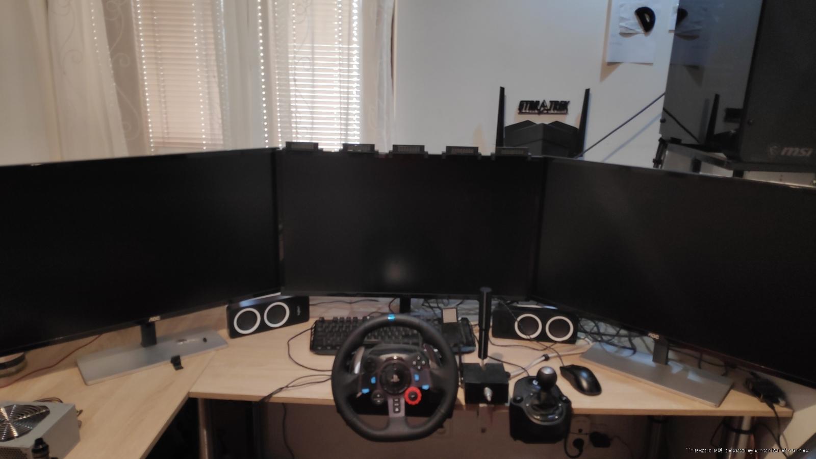

And a demonstration of what I already have at home, I think it deserves to be improved. :)
489949004901

Board mounting
49054906
