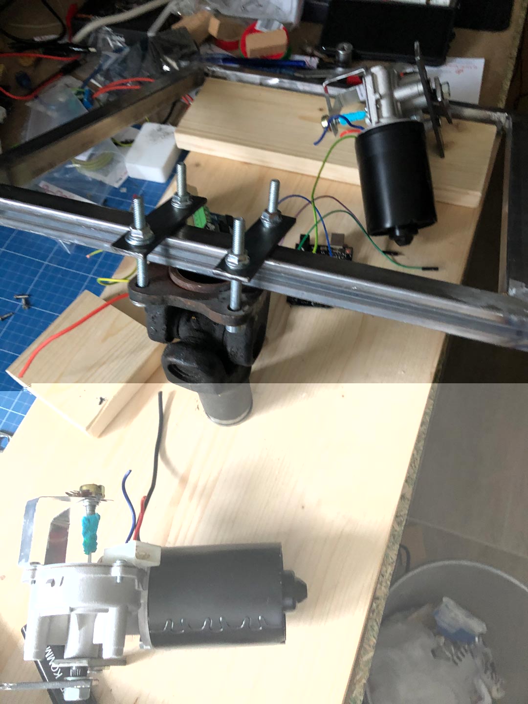

i have started my 2dof project.
Here are my starting parts:
1 x Arduino R3 Uno
2 x IBT - 2
1 x 12v 29 A Output Power Supply
I welded the chair holder and assembled the universal joint on the front.
I was lucky to get 2 of the universal joints for 25 Euro incl. shiping.

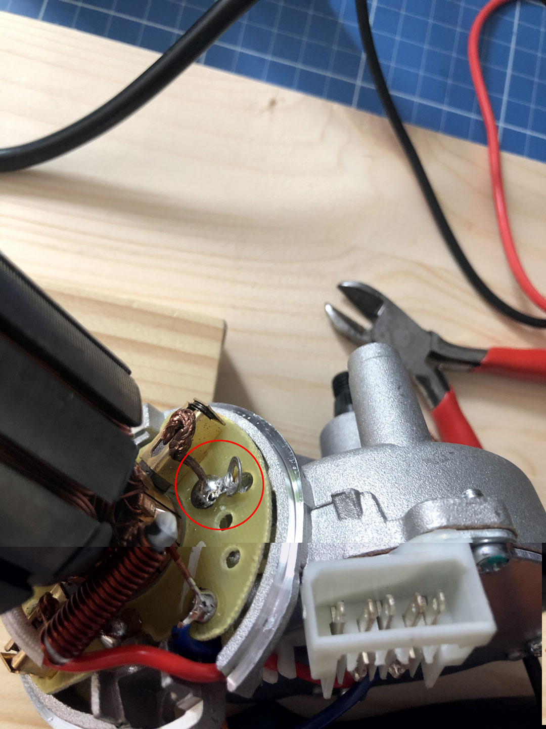

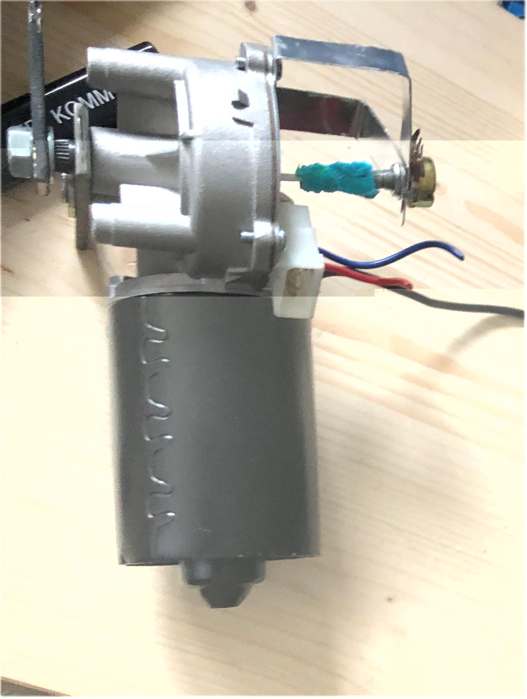

I have 2 wippermotors from ebay for together 40 Euro. Grounded them
already and put a construction on them to connect the potentiometers.
I am now looking for a 3d construction that can be printed to hold the potentiometers
at the wipper motors. But for now this must be enough :)
My next step is to solder the IBT-2´s and the Arduino together with the potentiometers
to see if it is working.
