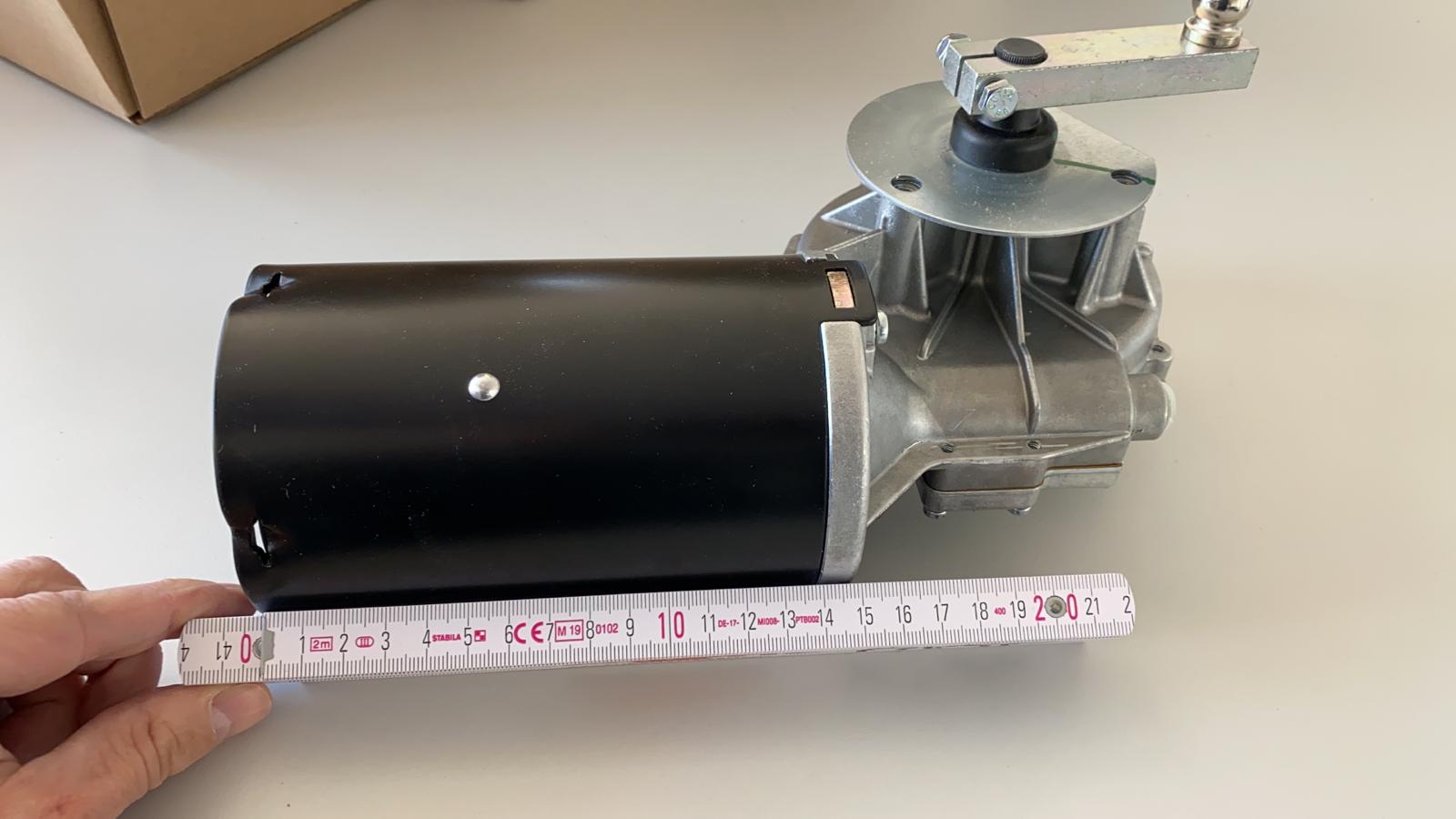

here I will document my project to my 2DOF platform piece by piece.
The platform should be strong enough to move the whole frame.
Therefore my choice was a 24V wiper motor for big buses.
I found it at the company VALEO. (ca. 160€ each)
Valeo Wiper Motor 401.821 24V

what kind of potentiometer do I need and where do I take the speed / angle of rotation.
On the back of the wiper motor is no shaft outlet
