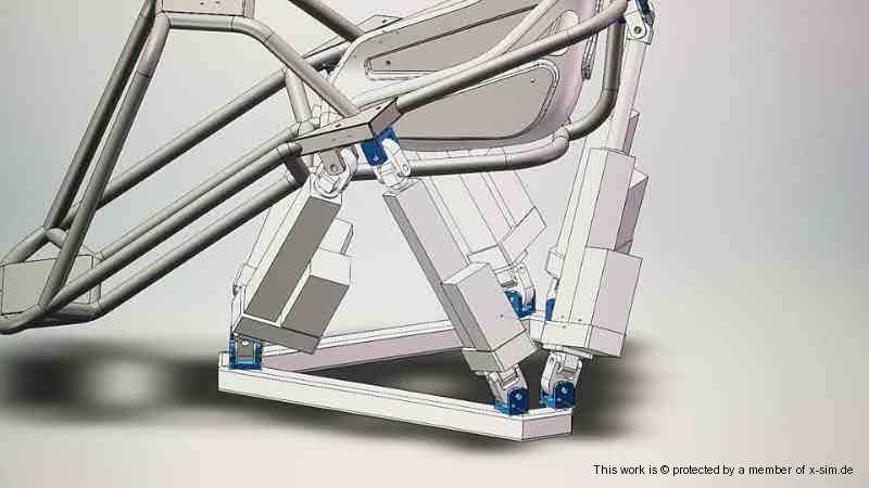

The design process was pretty straight forward, I design a tube chassis with 1.25” seamless tube. It is very strong but also very light weight design. The design was done on Solidworks and it only take few days of drawing and I also run few pass of motion simulation to see if there any interference between components. I intentional design the platform with lower center of gravity, so it will be easier to climb in and out.
4721
My first design was pretty simple..
4723
The final design

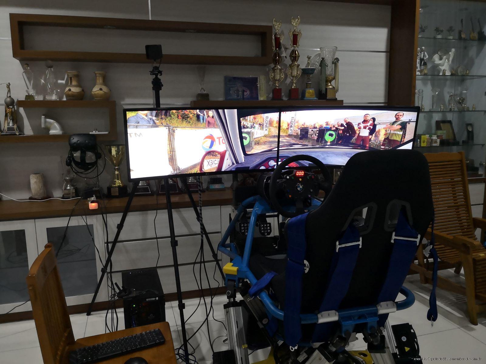

The platform was original designed to run with VR headset only, that’s why there is no monitor rack on it at beginning. Unfortunately, I had terrible motion sickness with VR racing…..try both Oculus rift and HTC vive, but nothing work. On the other hand, my 7 year old son did not experience any uncomfortable with VR racing….I think my body is getting use to have environmental feedback and when I see in the VR does not match with actual body feeling, it made me motion sickness. It also very inconvenient to use VR headset since all setting has be done on the monitor before actual racing.
4731
4732
Logitec racing gear with VR headset
As you can see, I later designed a monitor rack on front top of chassis. The rack was designed to run a single or two LG curve monitor. I use Logitec racing wheel and pedal at beginning but later change all to Fanatec wheel, shifter and inverted pedal.

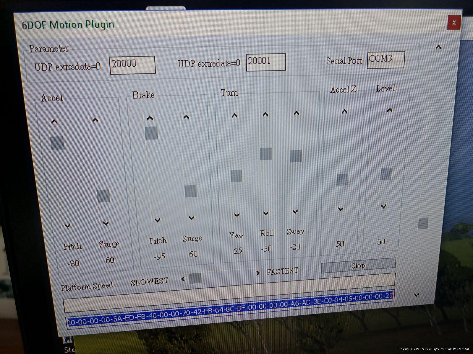

The hardware part was relatively easy and straightforward for me, but the software part was a whole different story…basically a nightmare…. The manufacturer of linear servo use their own controller board for 6 DOF motion control. They sent me game interface file to run with Dirt Rally (which is also the only game I run on my machine). I test it out immediately with Dirt Rally, but the result was really horrible. The motion of platform can’t match up with the game simulation. For some reason, the motion is random without making any sense. After nearly two weeks of trying and their engineer sent me dozen of different version of their interface program for Dirt Rally. I finally realize they can’t get this work out the way I want.
The motion controller board use standard serial port for communication…therefore I download the x-sim software and try to use it but then I can’t solve the issue that their controller board need an error correction byte at end of serial data packet….The error correction byte need to be generated dynamically from the data packet, and I can’t get this work out with x-sim software either. At this point, I was super frustrated…I spend a big money on motion platform and everything seem gone very wrong on all direction.
Finally, I ask manufacturer if they can give me the source code of interface program to review and change it. They refused but did provide me a complete data structure protocol of their controller board. And I also found a really detail UDP telemetry data guide for Dirt Rally on the Internet…Therefore, I decide to write my own motion interface program for Dirt Rally to work with my motion platform. It was a really difficult task for me actually, I didn’t do any programming for more than 10 years. Fortunately, the modern programming tool is earlier to learn, I use Microsoft C#, not only it is free but also there are plenty of tutorial online….After two weeks battle of programming, I finally come out something that is more or less usable.
4739

The controller board has built in math to interpret all six axis (yaw, roll, pitch, heave, surge, sway) range value into each linear motion of servo. This save me some time in term of programming since I don’t have to work on that complex geometric math. I can also input value speed and brake to control the platform speed and amount of smooth and end of motion…this is a good feature because I can then program the platform to speed up or down base on the amount in game g-force value or speed of yaw.
For unknown reason, the telemetry data from Dirt Rally has a lot of data spike. It happen almost every few second and randomly……I knew I could log their data and filter out their spike, but I was later on too busy with actual racing and other work…There was about a year time I run the program as it is or just run the game without using motion platform.
After Dirt Rally 2.0 come out, I bought the game and decided to give it another try. First I found out that although both DR1 and DR2 share the same telemetry data structure, but the reading value and some axis polar is reverse. The telemetry data output from DR2 also much smoother and without data spike. After few program adjustment and coding, I finally got a motion interface program that run well and feel more or less like real race car on DR2. My 6DOF platform now can roll and pitch according to the terrain. The yaw will change according the amount turning and the pitch and surge will change according to the acceleration and brake. In the stage of USA in DR2, there are many up and down terrain and fly over with heavy landing, this motion platform can truly translate that into the heave up and down motion. In some corner if the vehicle’s rear tire slip and cause uncontrolled drift, the yaw will change and gave me motion feedback to correct it. Overall, with DR2 and update interface software, I am now very happy and satisfy the performance of my 6DOF platform.
