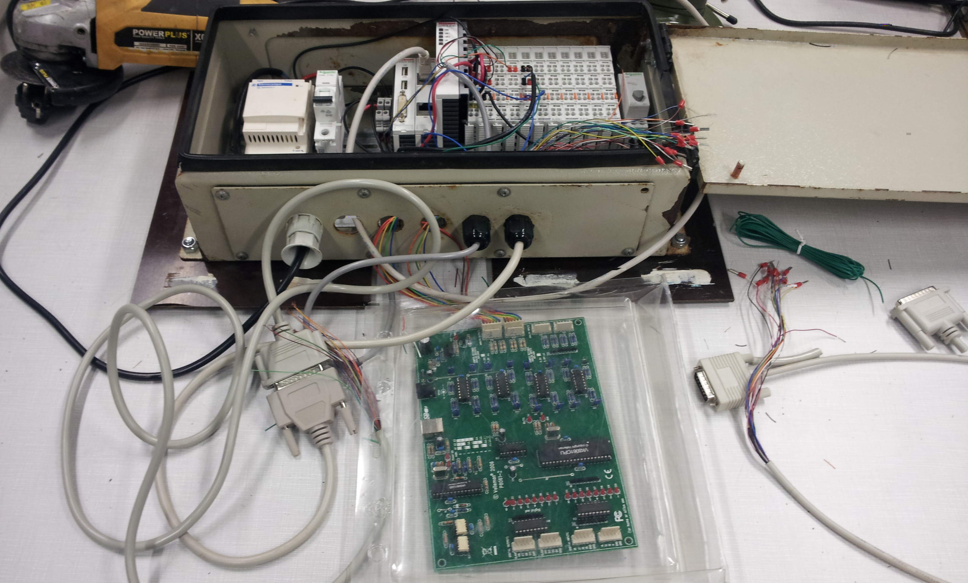

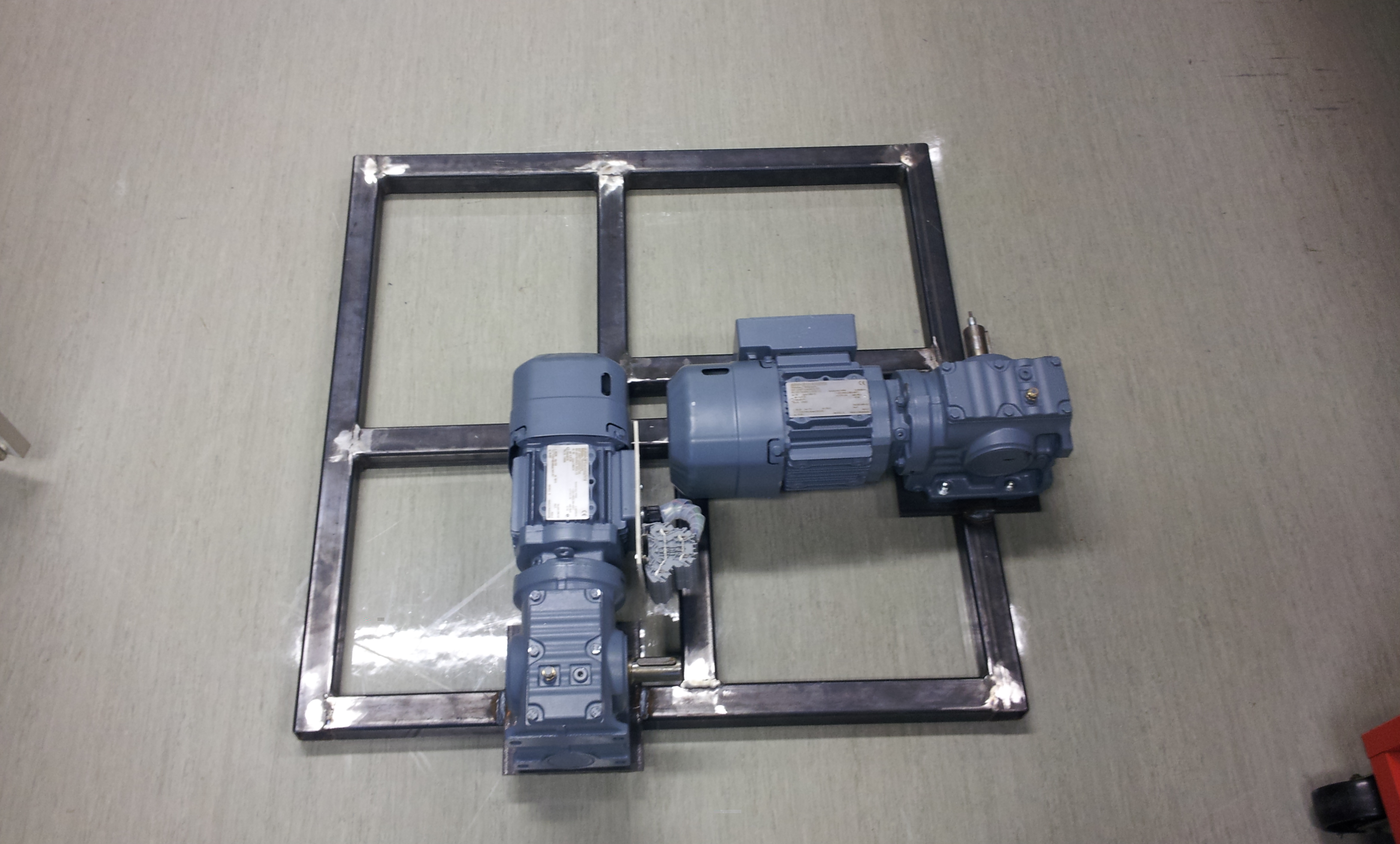

Here are the first pictures where you can see the setup of the motors, the invertors (for the moment older ones) and the PLC.
Next up: connecting the encoders to the motors.

Postby dearn » Tue 2. Oct 2012, 22:03
Nice to see some pictures! Good work, this is something different and more difficult then my JRK's haha! :D

Postby vicpopo » Tue 2. Oct 2012, 22:04
Hi Bart,
Very good choice for the gearmotors :D !

Postby Mertensbart20 » Tue 2. Oct 2012, 22:16
Hi dearn,
About the difficulty, you would think that. But our first project (see the first post) was actually more difficult. The principles are the same. But with this simulator there are fewer mechanical problems that can occur. And ofcourse it is far more accurate and faster.
The only major electric difference is the use of the frequency invertor compared to the H-bridge. But if we can configure the invertors a smart hobbyist should also be able do it.

Re: 2DOF simulator based on CKAS Thruxim
Postby Mertensbart20 » Wed 3. Oct 2012, 11:20
The VM140 is used to transform the game-signals of X-sim (pitch, roll, ...) to analogue voltages from 0 to 10V. For us these type of voltages are interesting since we use a PLC to control the simulator.
I think most x-sim users would also use the VM140 to drive their simulator by connecting a motorcontroller to the VM140. But than you might get the problem that the VM140 is to slow for the calculations. In our project al the calculations are done with the PLC. So the VM140 only has to transform the signals.
