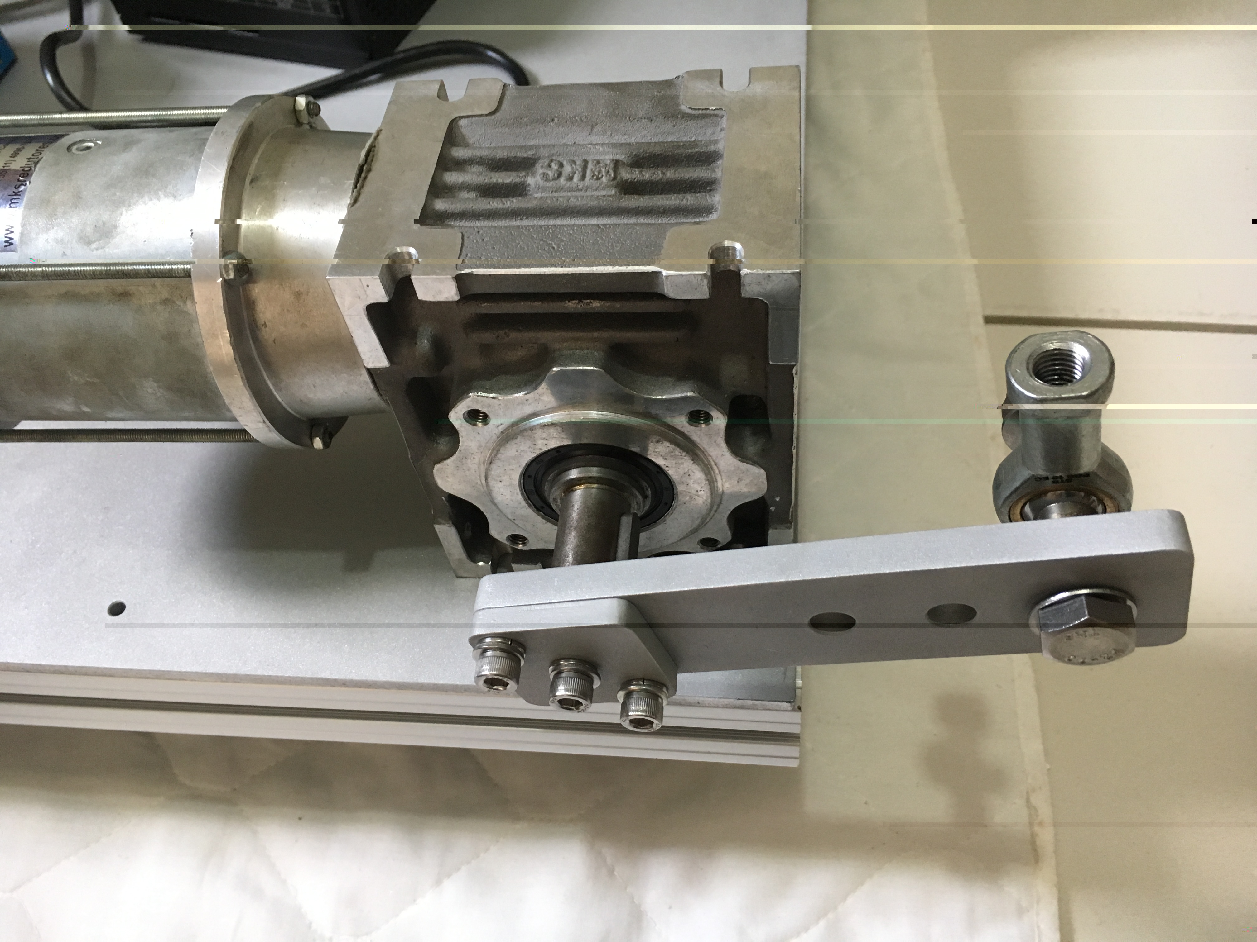

Hi guys, i´m new here.
I'm setting up a 2 DOF simulator for car games, F1, etc.
40 x 40 reinforced structural aluminum frame
2 Bosch Motors 24 VDC
24 VDC source
Arduino Board ONE
IBT-2 Driver
Playseat Cockpit
Thrustmaster TX steering wheel with Add onn F1
I placed my pictures in my album

I will measure the motor shaft on one side so that both are the same on the platform. I will make the coupling for the potentiometers.
After, i'll post the photos.

Postby haraguchi » Thu 29. Mar 2018, 01:29
The structure is ready:

Postby haraguchi » Mon 2. Apr 2018, 00:32
Finished my project:

Postby andywong » Thu 26. Apr 2018, 14:13
Congrads Haraguchi, What a huge drive motors you have for your 2DOF! Would you mind sharing the source of these motors?

Postby haraguchi » Thu 26. Apr 2018, 15:48
andywong wrote:Congrads Haraguchi, What a huge drive motors you have for your 2DOF! Would you mind sharing the source of these motors?
Yes sir:
https://www.casaferreira.com.br/index.p ... 00rpm.html
http://catalogo.mksredutores.com.br/adv ... h-12-24vcc
