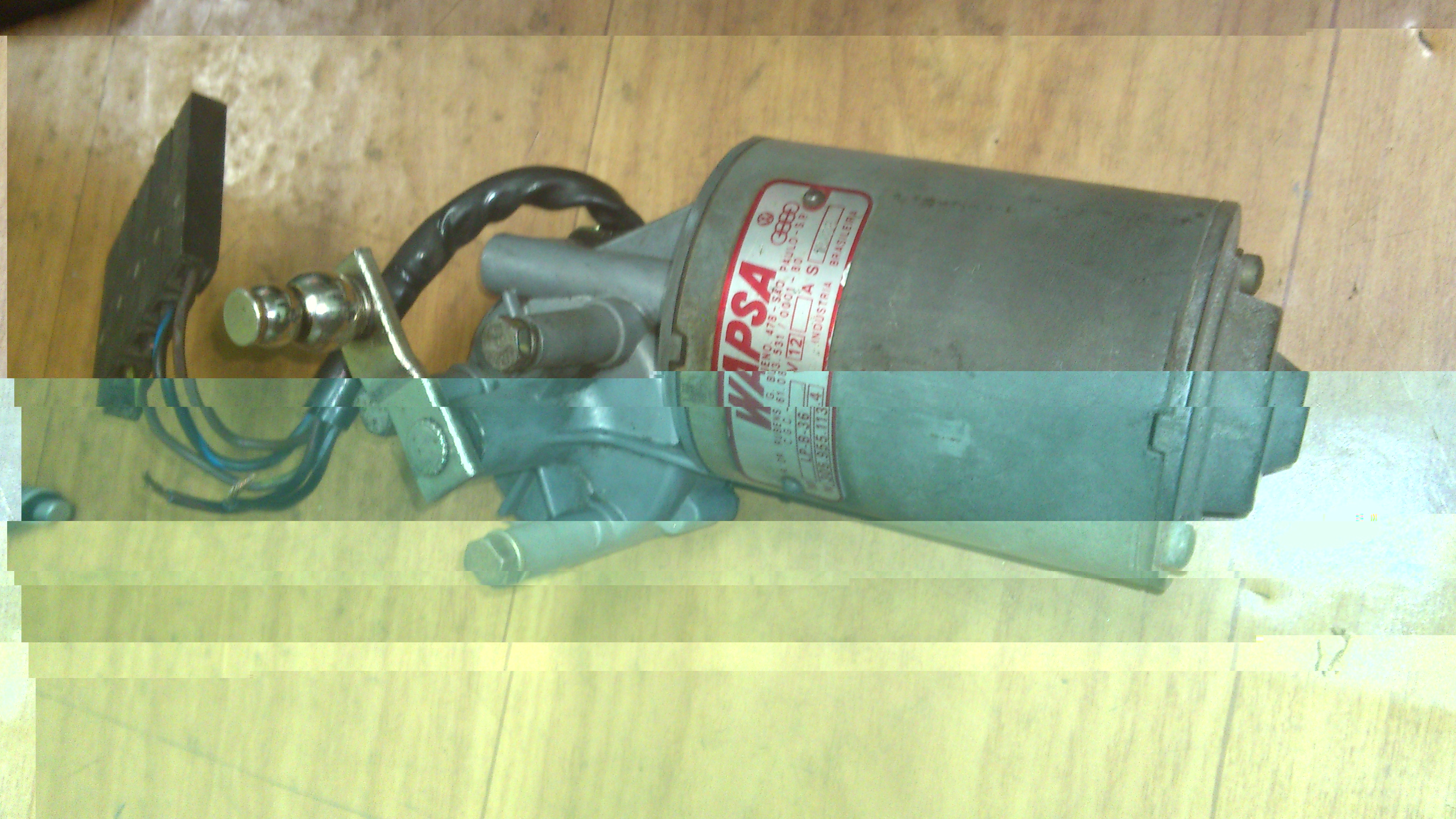

My friends and I are developing a motion simulator of 2DOF.
To do that, we are using the following mechanical structure:
The motion will be done for 2 wiper motors from VW Fox.

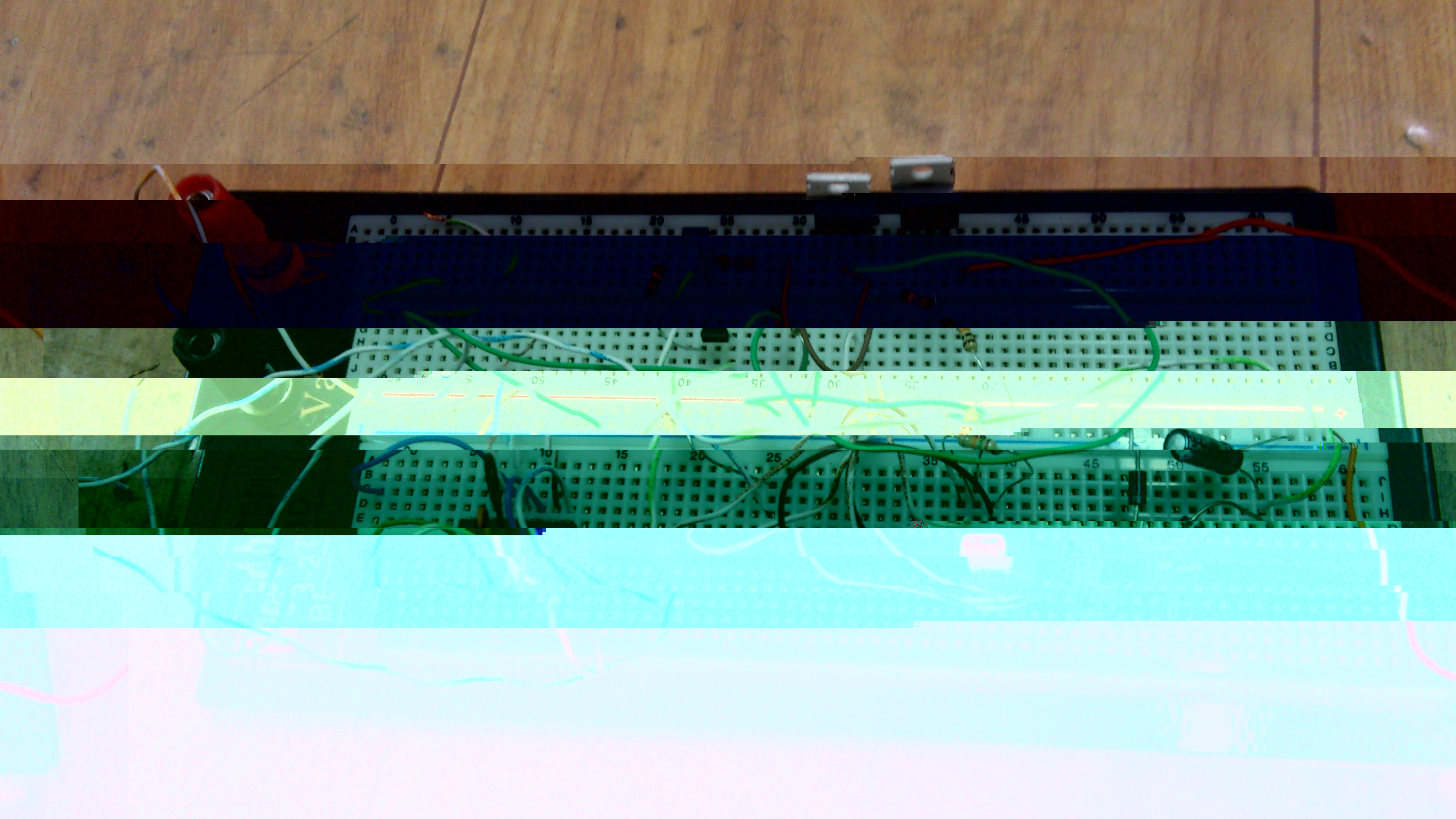

The motors will be controled by an H Bridge that we've built with Power Mosfets IRF3205.
See below the schematic.
Half of the H Bridge mounted
To send a signal to the h bridge, we'll use a microcontroller 16F877A.

Re: Our First simulator project
Postby motiondave » Sat 29. Sep 2012, 01:15
Hi there, nice job there. I reminds me of an old rock and ride set up.
Ok, with controller and h-bridge, may I suggest the Pololu JRK 12v12 http://www.pololu.com/catalog/product/1393 , one each per motor. Controller and h-bridge in one.
Easy to setup, 7 wires, one usb cable and it will handle 14v at 30 amps continuous with heat sink and fan cooling.
As for x-sim software, not sure what difficulties you are expecting. If its programming your controller and h-bridge to x-sim, send an email to sirnoname .
Here are a few instructional videos I have done, there is also documentation as well here on the site
http://www.youtube.com/watch?v=PQaKTaKEvCo
http://www.youtube.com/watch?v=r4nSg0VVgP8
http://www.youtube.com/watch?v=rb5tK4oMQy8
any other questions, just holler.
Postby Marcossouza » Tue 2. Oct 2012, 23:06
motiondave wrote:Hi there, nice job there. I reminds me of an old rock and ride set up.
Hello Motiondave,
Thank you for the advices that you sent for us.
About h-bridge, unfortunately we're doing a university work and we had to develop it from our own way.
About X-sim, we're just starting to work with that, so we're finding out a new world, but it doesn't really seem so hard.
Any other question or advices, feel free to send.
Marcossouza
Postby Marcossouza » Tue 2. Oct 2012, 23:20
floriske wrote:Good looking project!
But won't there be a fears amount of load on the rear pivot point. Should be some sturdy construction.
Hi floriske,
That was a fear that we've had, but through analysis on the software named Catia V5 from Dasoul Systems, we get a service factor = 2 to 100kg of weight.
We've seen your project, and it really looks be very good.
Thank you for your post.
Postby ferslash » Fri 8. Mar 2013, 18:32
guy dont give up! this project looks grate... finish it :D i almost shure that you made the hardest part... i you got stocked with electronics, try some tested easy solutions, like jrk12v12 for instance
best regards
fer
Postby prodigy » Sat 9. Mar 2013, 18:34
The construction looks pretty massive for wipers, would they handle it? :roll:
prodigy
Posts: 274
Images: 42
Location: Pula, Croatia
Has thanked: 20 times
Been thanked: 22 times
