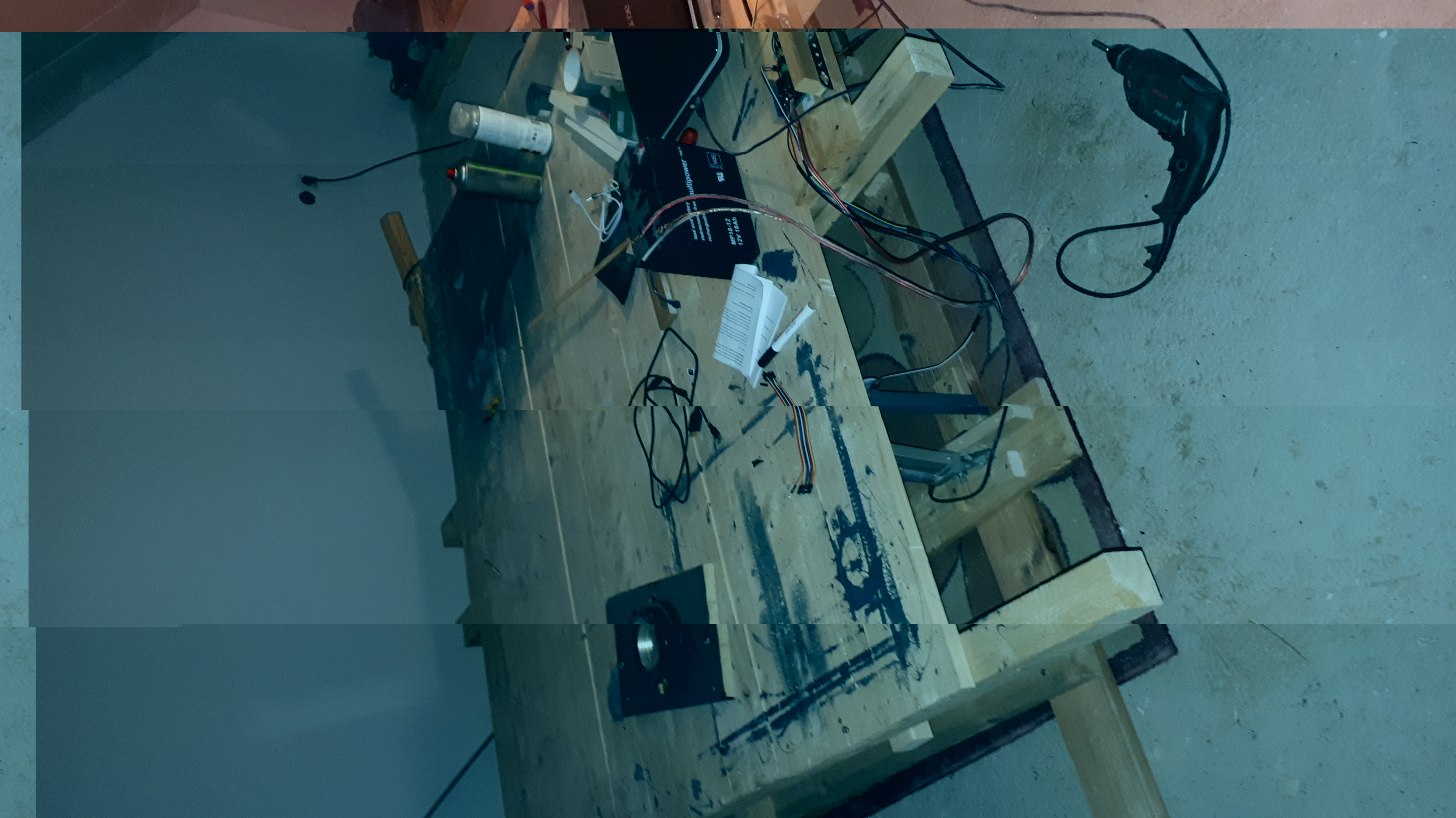

Hello everbody,
I would like to introduce my motion project. It is basically based on a sabertooth 2x25A motor controller and a kangaroo V2 by Dimension Engineering.
I managed to tune the controller combination successfully, so it seems to be a closed servo system by *
The motion platform is build on wood, but stable enough to move and carry the full payload of a Flightsimulator.

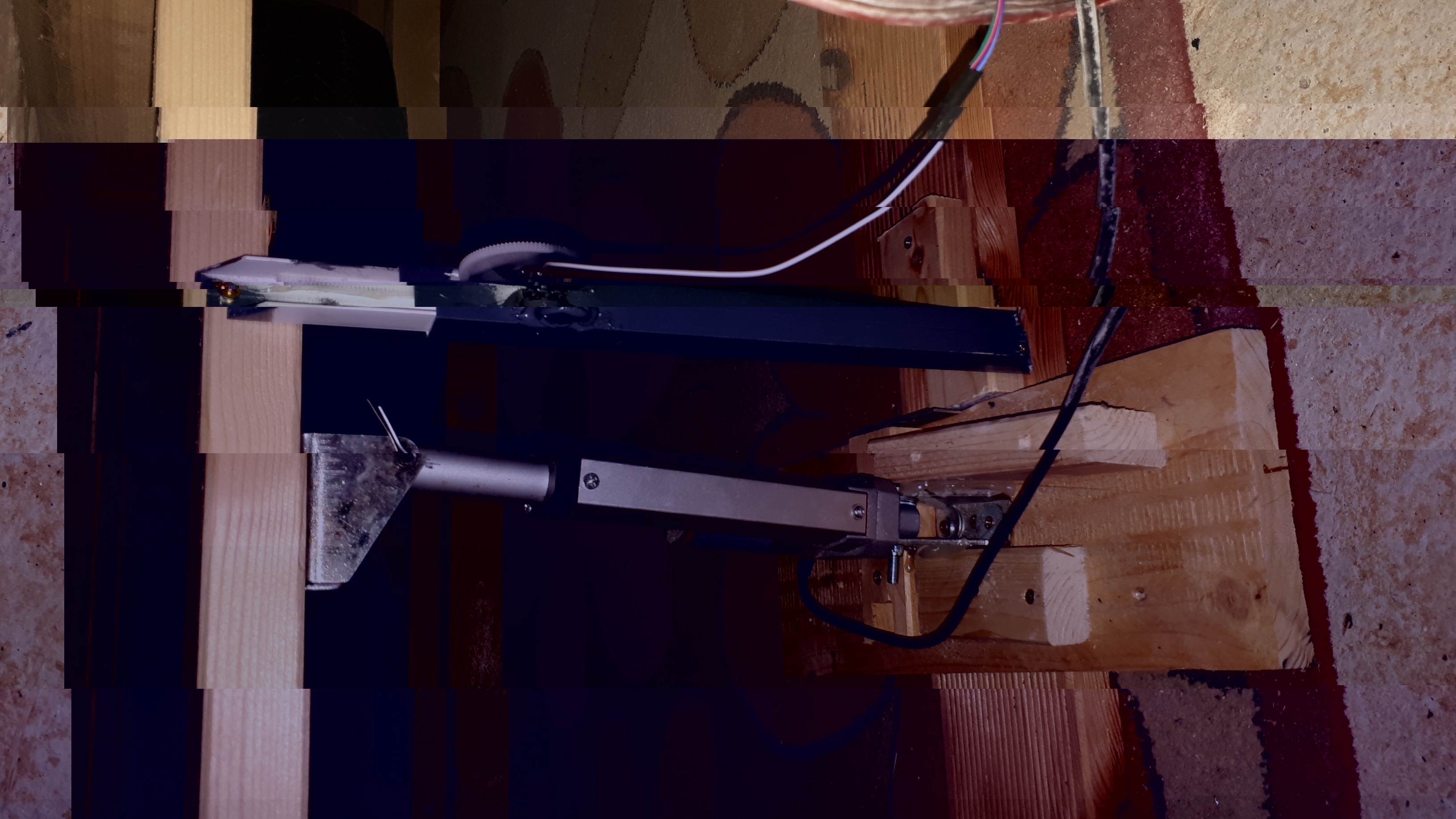

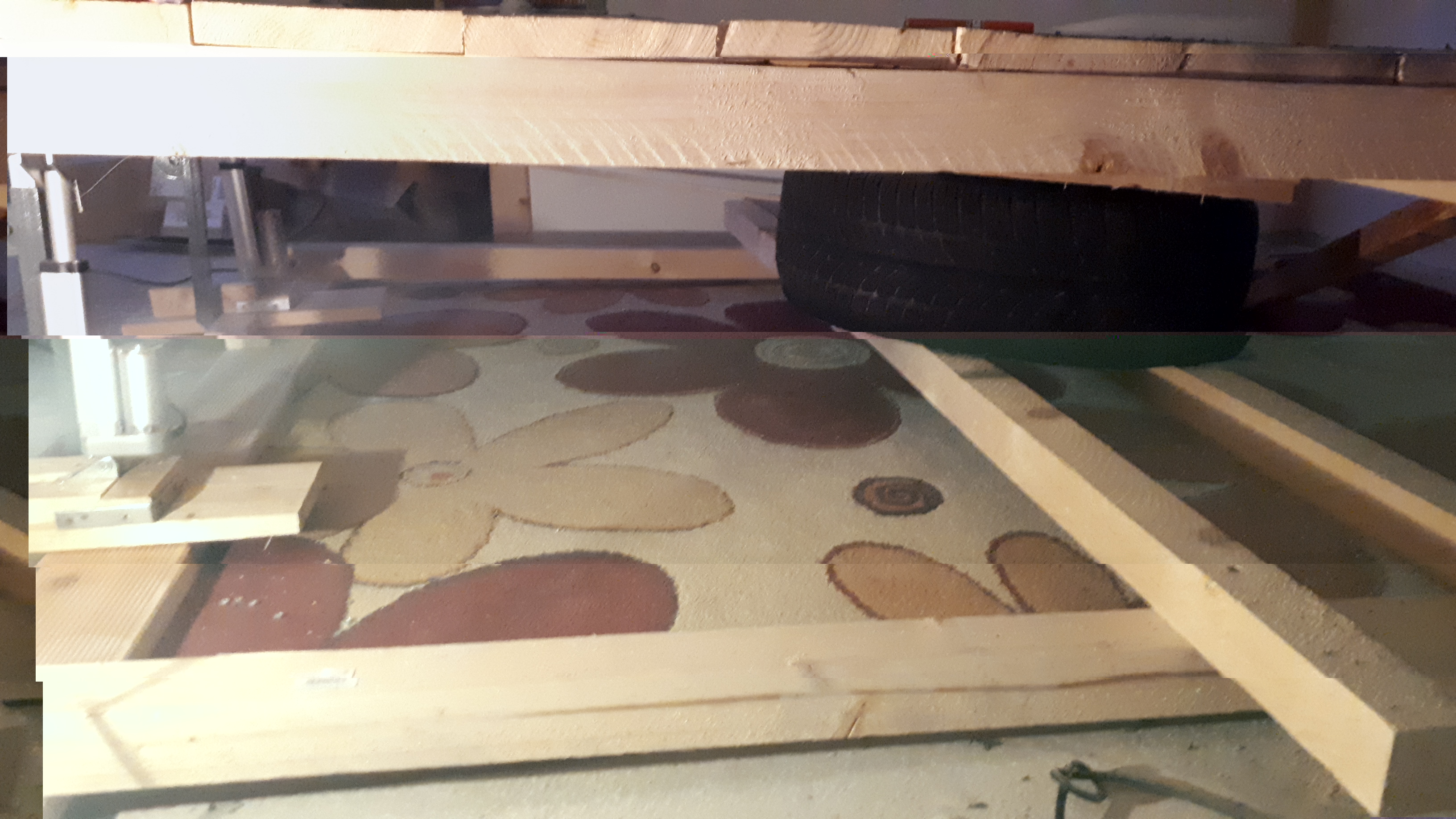

On the bottom I used a tyre to carry the most payload. In the front there are two electronic actuators which can handle the movement without no problems.
A bit slow, but enough speed for an airliner.
The position feedback is solved by a diy linear range potentiometer, in order to give feedback of the full travel range of the actuators.

Great idea of position sensing! Hope you could share the result effectiveness of your design.
