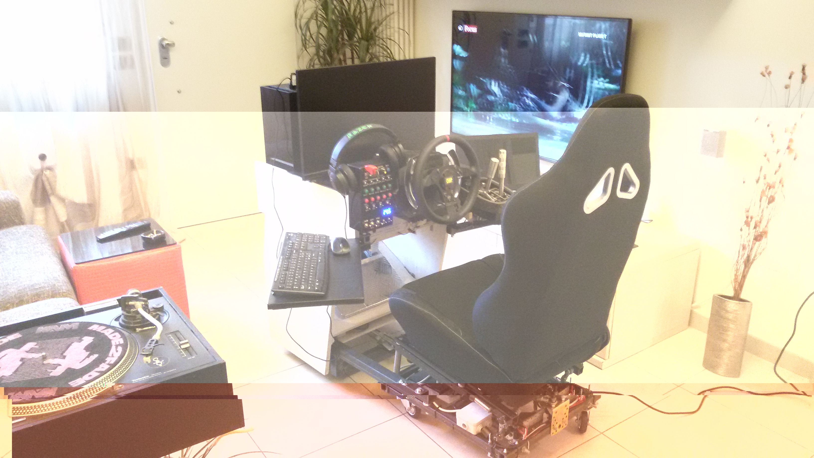

Postby Tiromancino1 » Wed 1. Nov 2017, 08:31
in this photo the simulator is all closed and its footprint and 1 meter

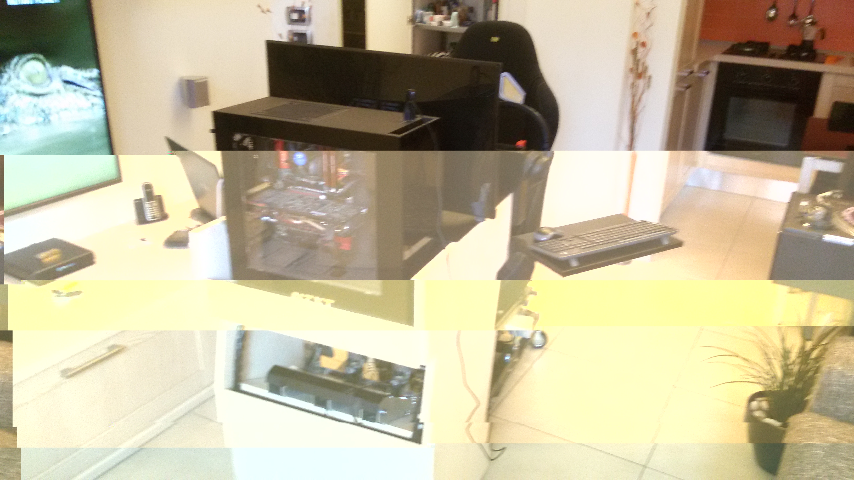

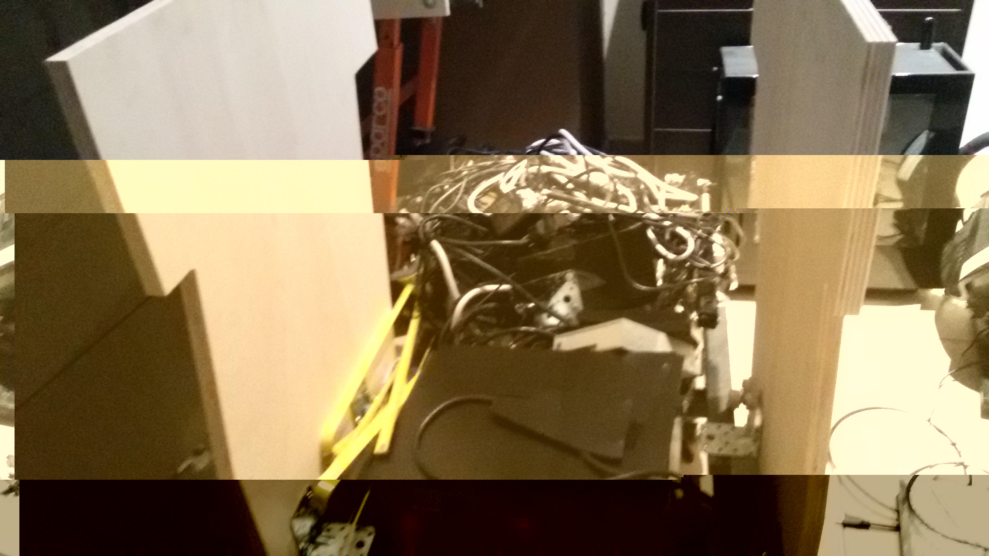

Postby Tiromancino1 » Wed 1. Nov 2017, 08:54
in this photo you see the power supply located at the bottom and a stabilized linear power supply 0v 24v 30a and I send all the motors and very useful nothing to do with switching Power supply

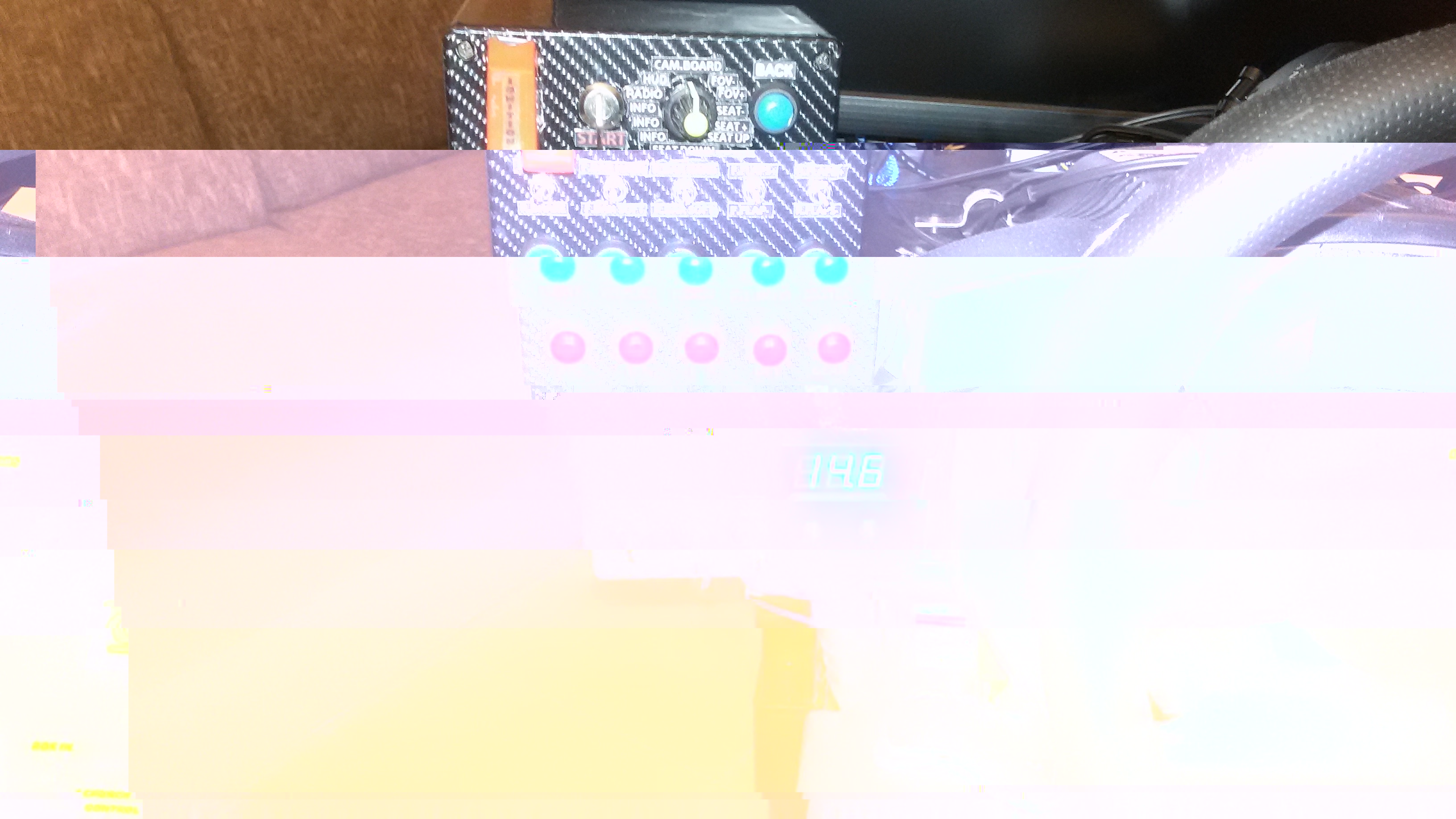

Postby Tiromancino1 » Wed 1. Nov 2017, 09:09
this picture shows the button box made with the keyboard board and then remapped. The screen shows the number of voltages that are sent to the motors while with the lower lever levers the led actuator led lights for traction loss and actuator to narrow the simulator

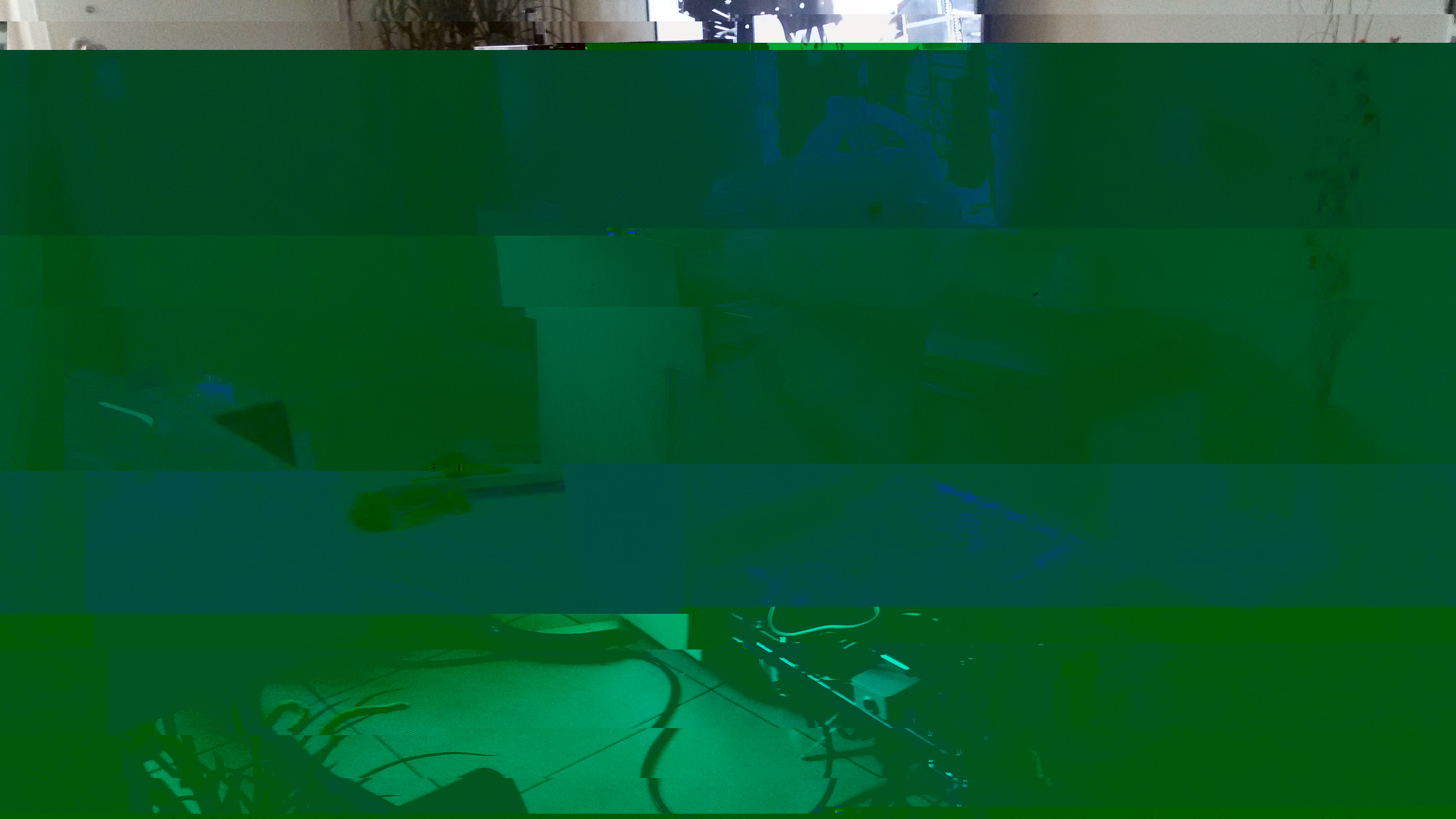

Postby Tiromancino1 » Wed 1. Nov 2017, 09:44
in this photo you also see the bass shaker that gives me the vibration for the rpm game.
I added 4 vibrator engines, 2 for seat vibration when changing, 1 for traction loss pedal, 1 brake pedal when locking wheels.
everything is piloted with an Arduino card.
adding all these effects I have reached a truly realistic level. I am satisfied but there is always something to improve also because to build for me is the most beautiful moment ...
