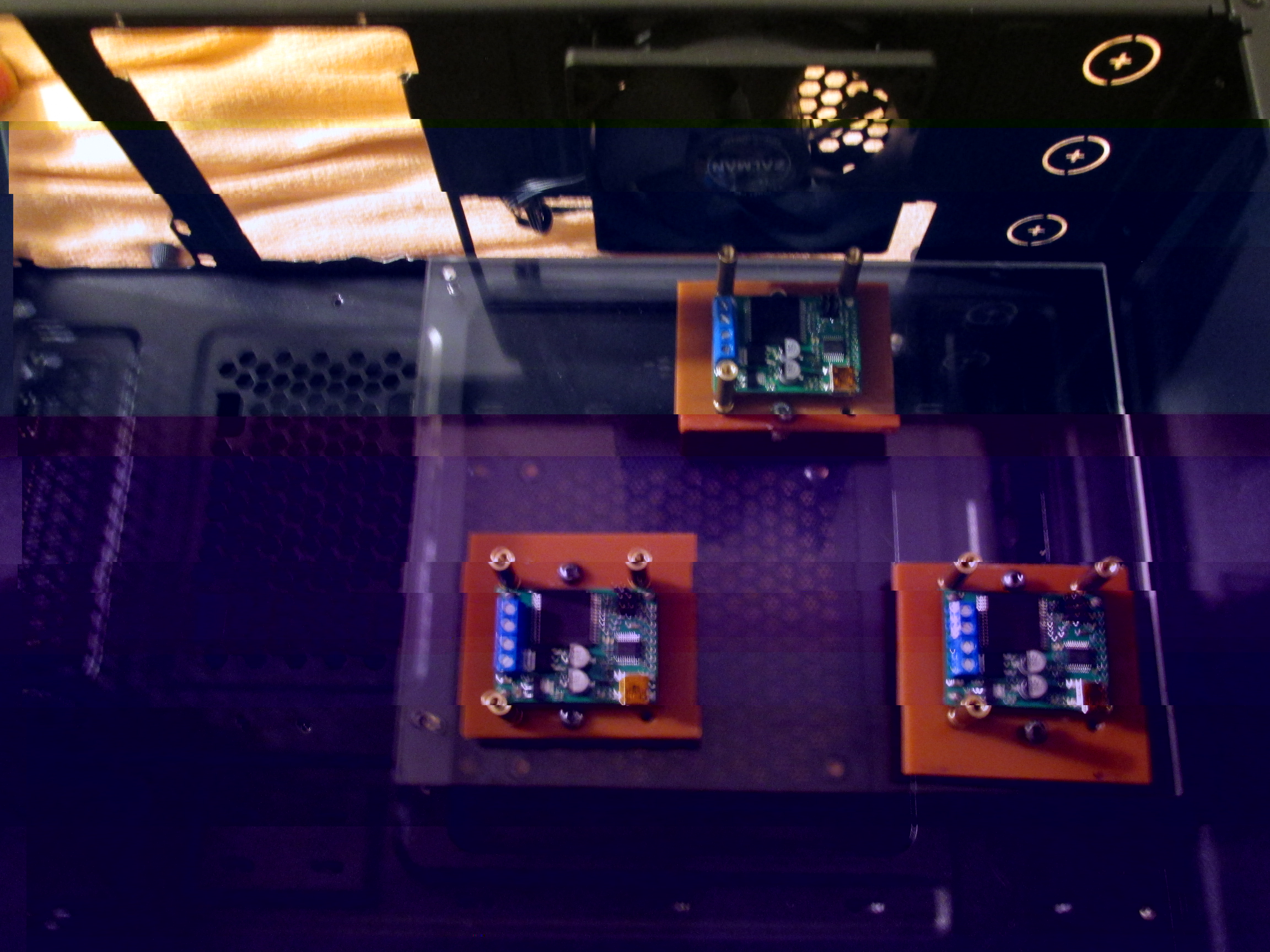

Hello all simracers!! First,i want to apologize for my English,it's not my motherly language.As the name of topic says,i decided to built my first 2dof with traction loose.From the beggining i though about just to make 2dof,but planes have changed.I want to use this project my 2 12v wiper motors,and one big 12v worm DC motor from Motion controls product.For boards i have choosen Pololu jrk 12v12 for each motor,and whell known PSU HP-DPS-600PB,too one piece for each motor.I have done electronical part yet,i just have to test motors with xsim.When it will work properly with xsim,i will start to make construction.There are some photos of my progress.

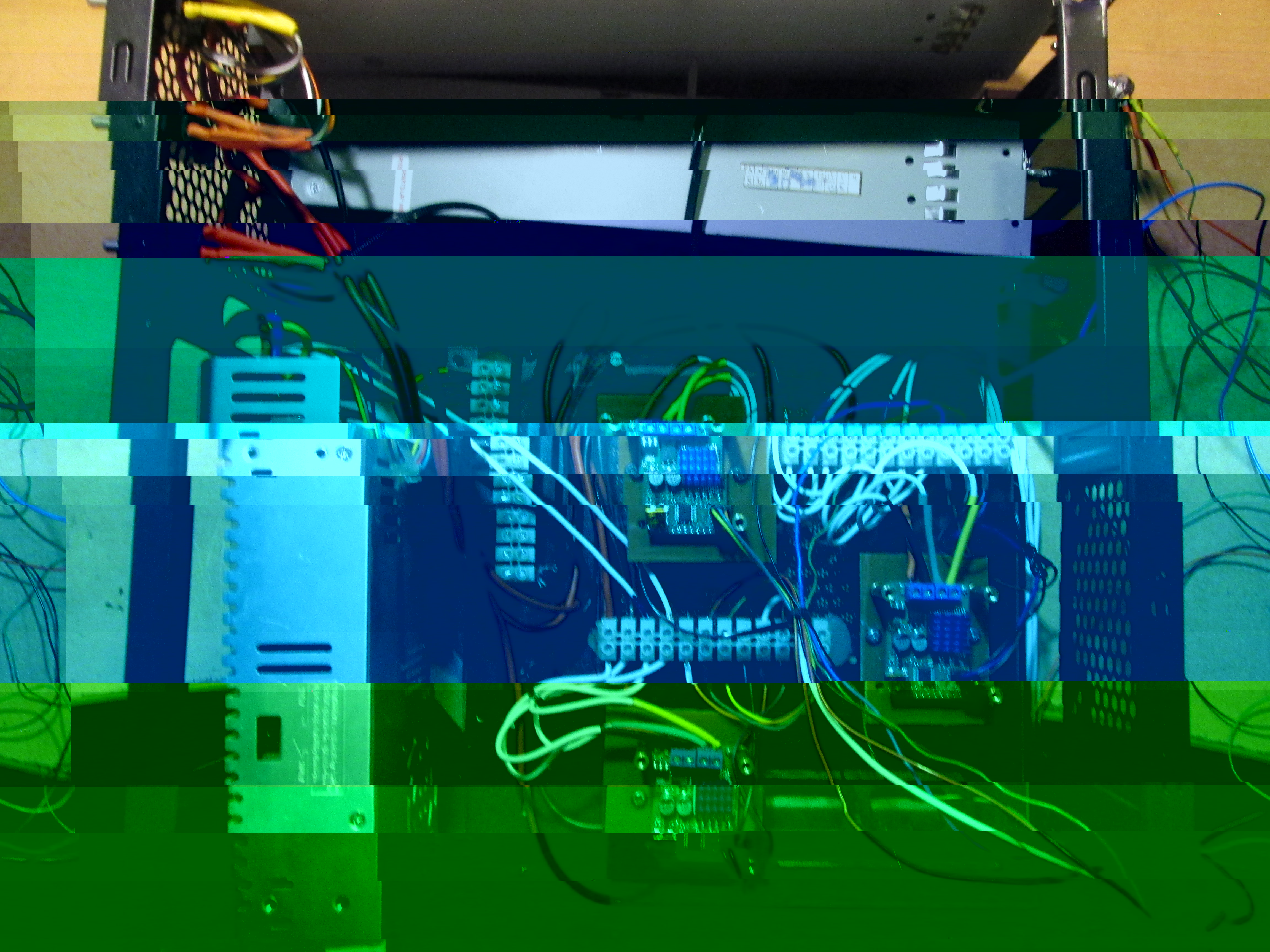

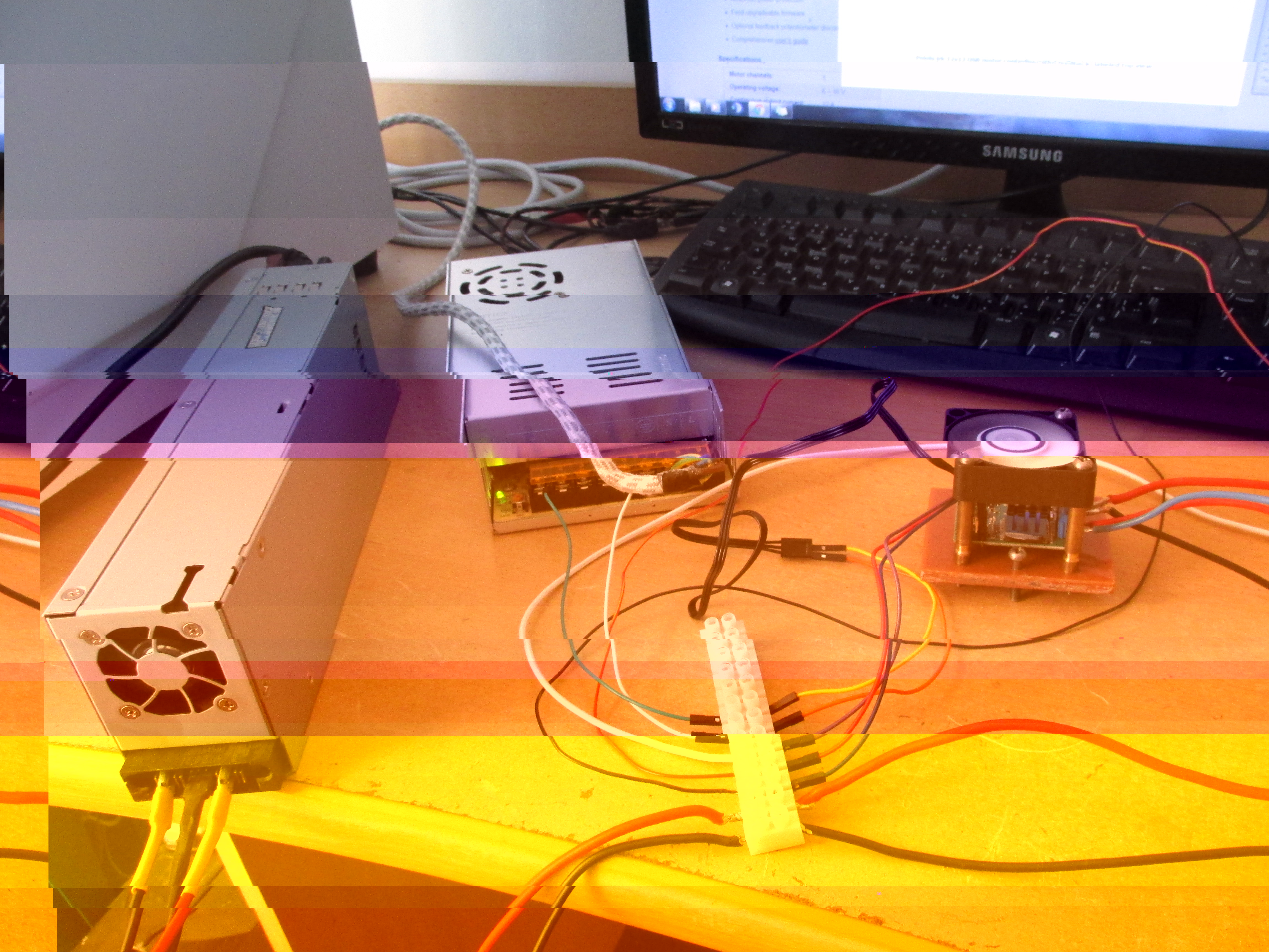

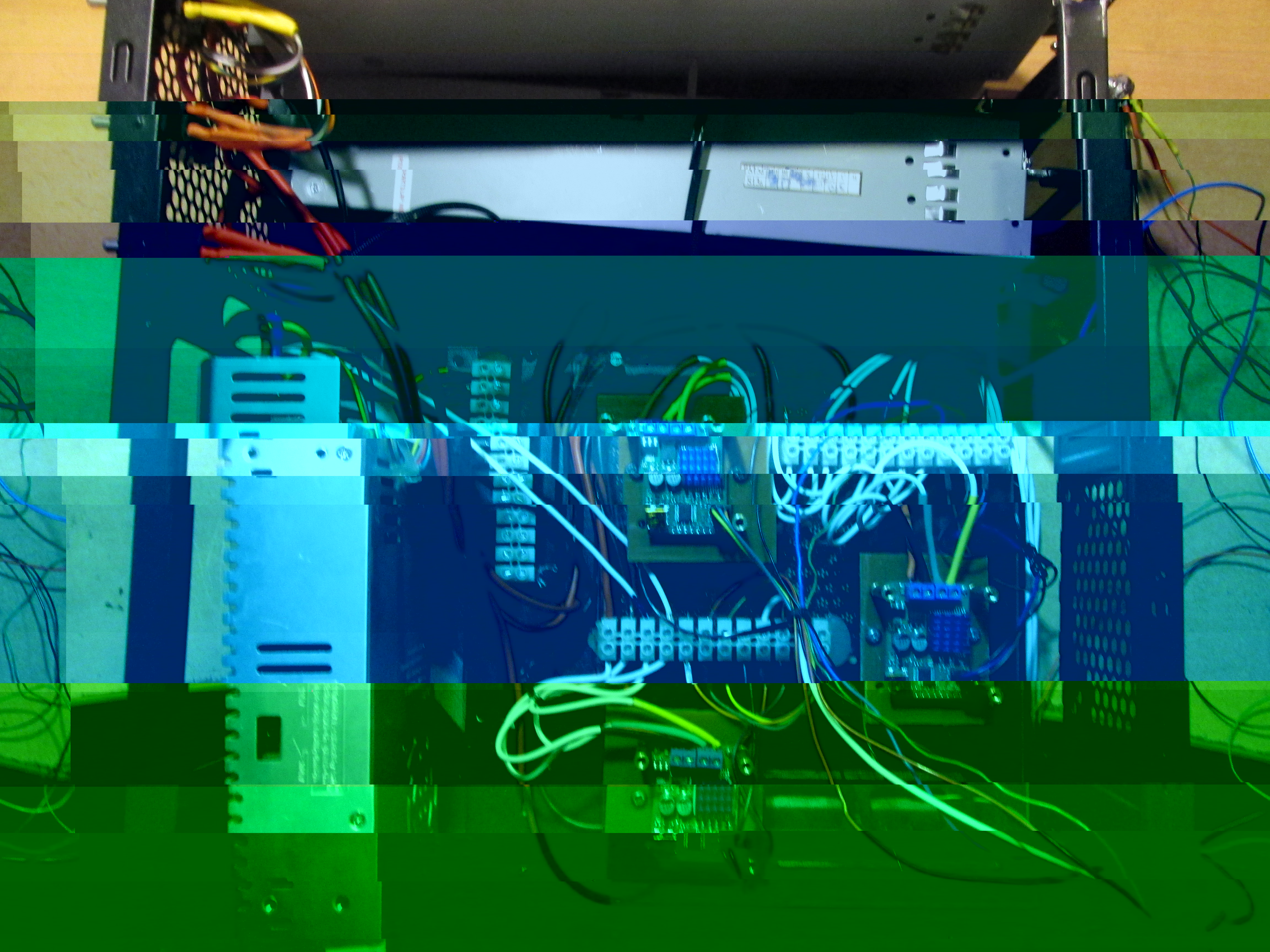

- full montage on my chassie

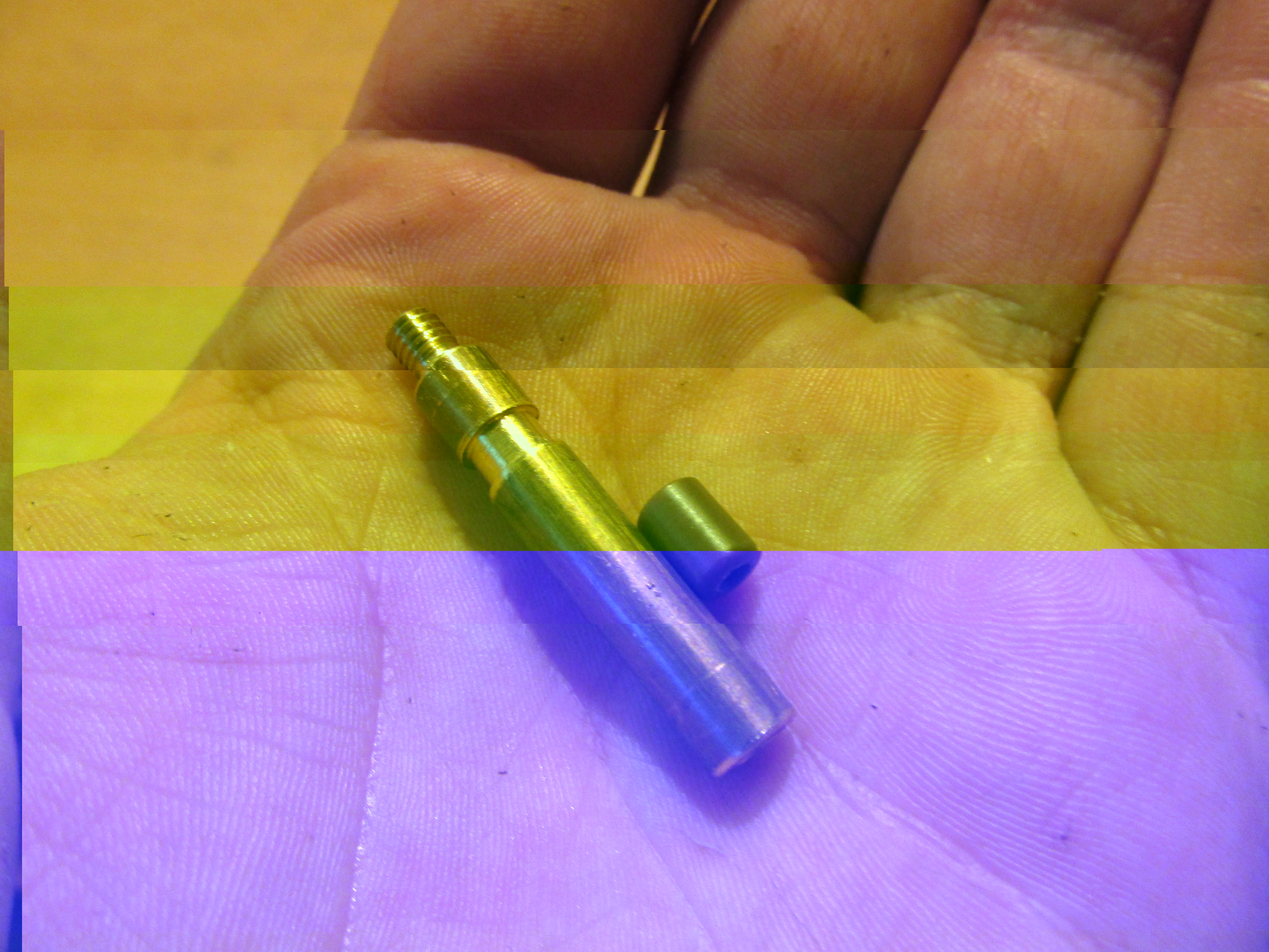

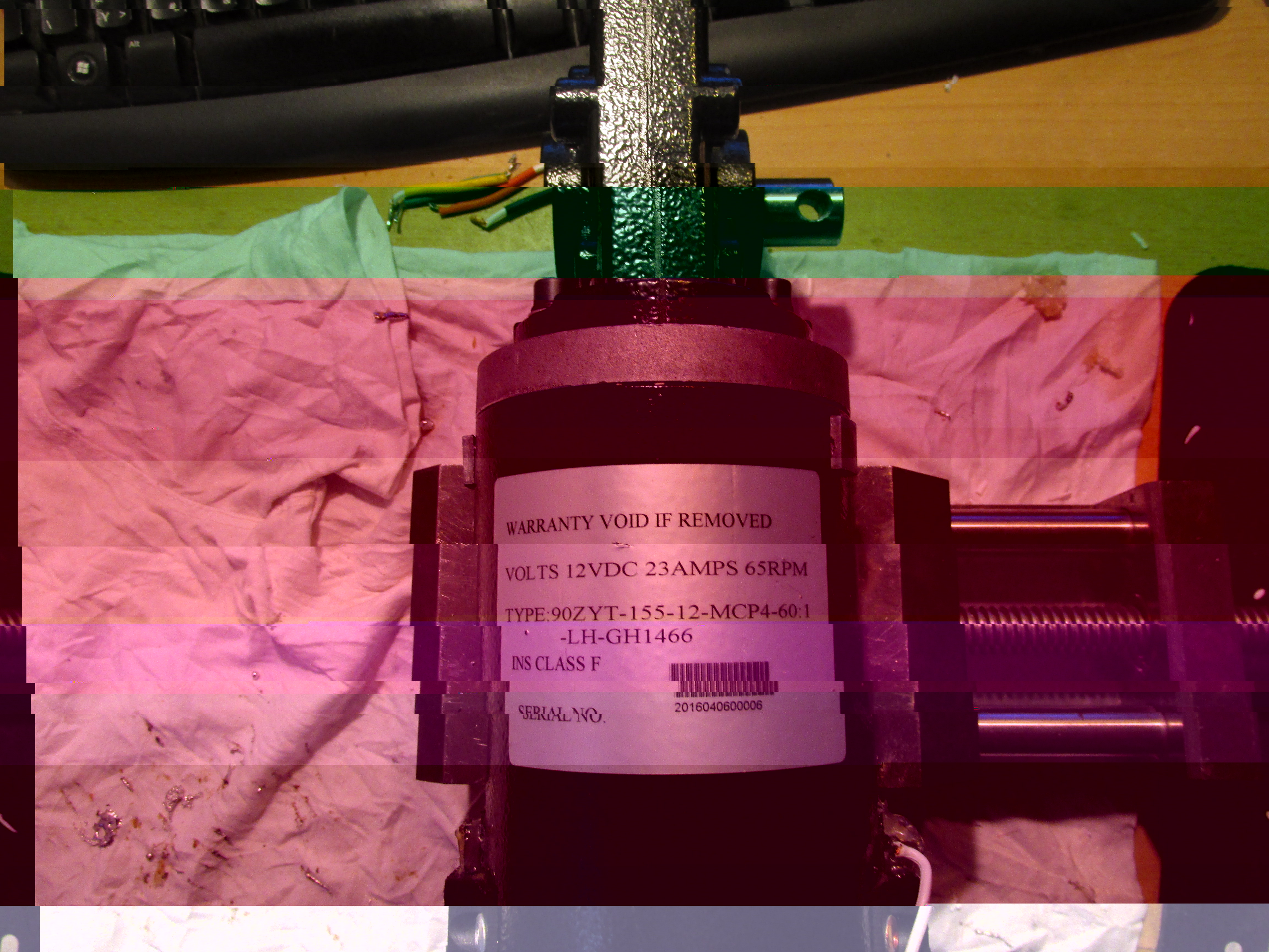

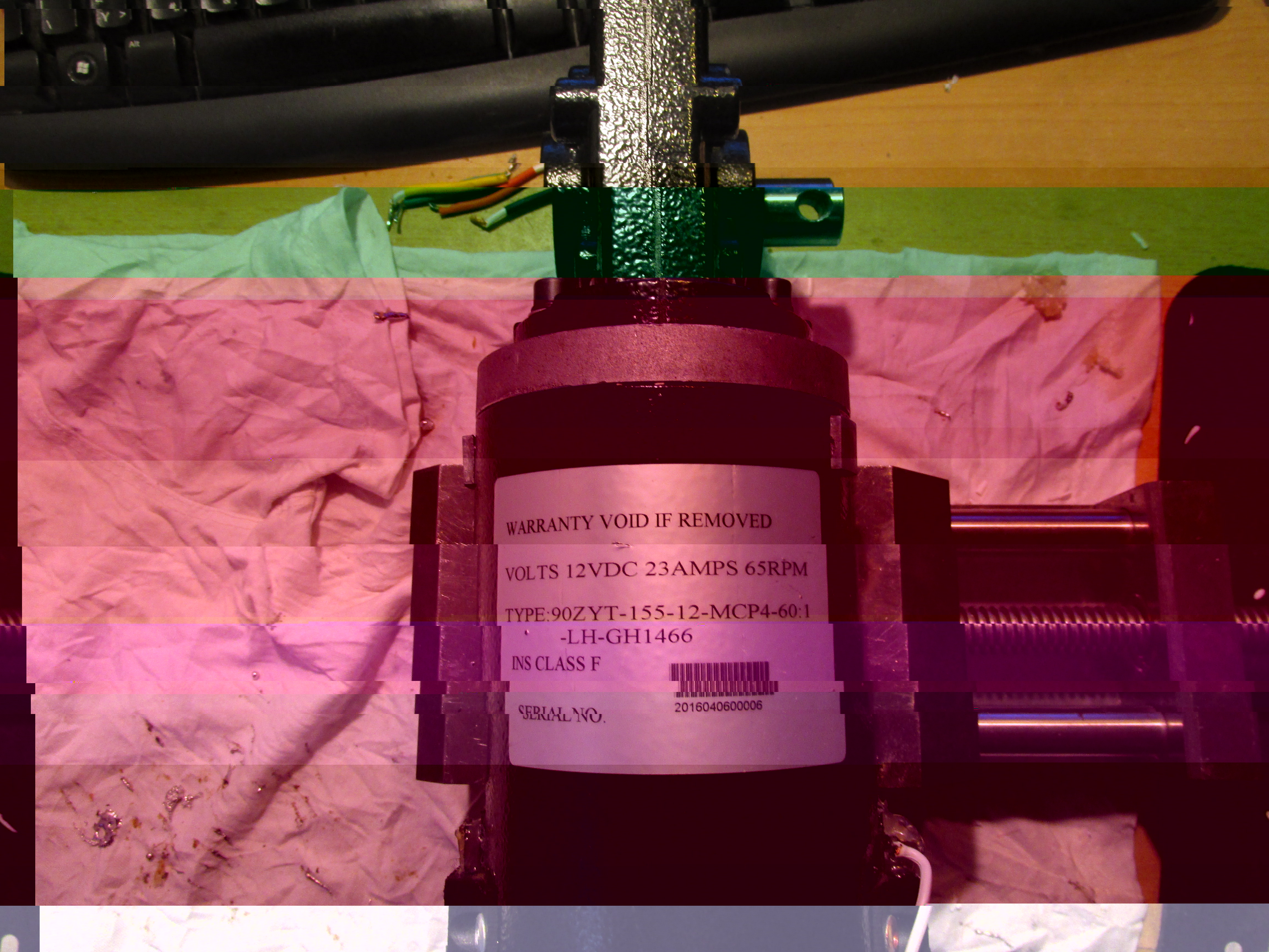

- My dc motor 90 ZYT(photos of wiper will be soon)

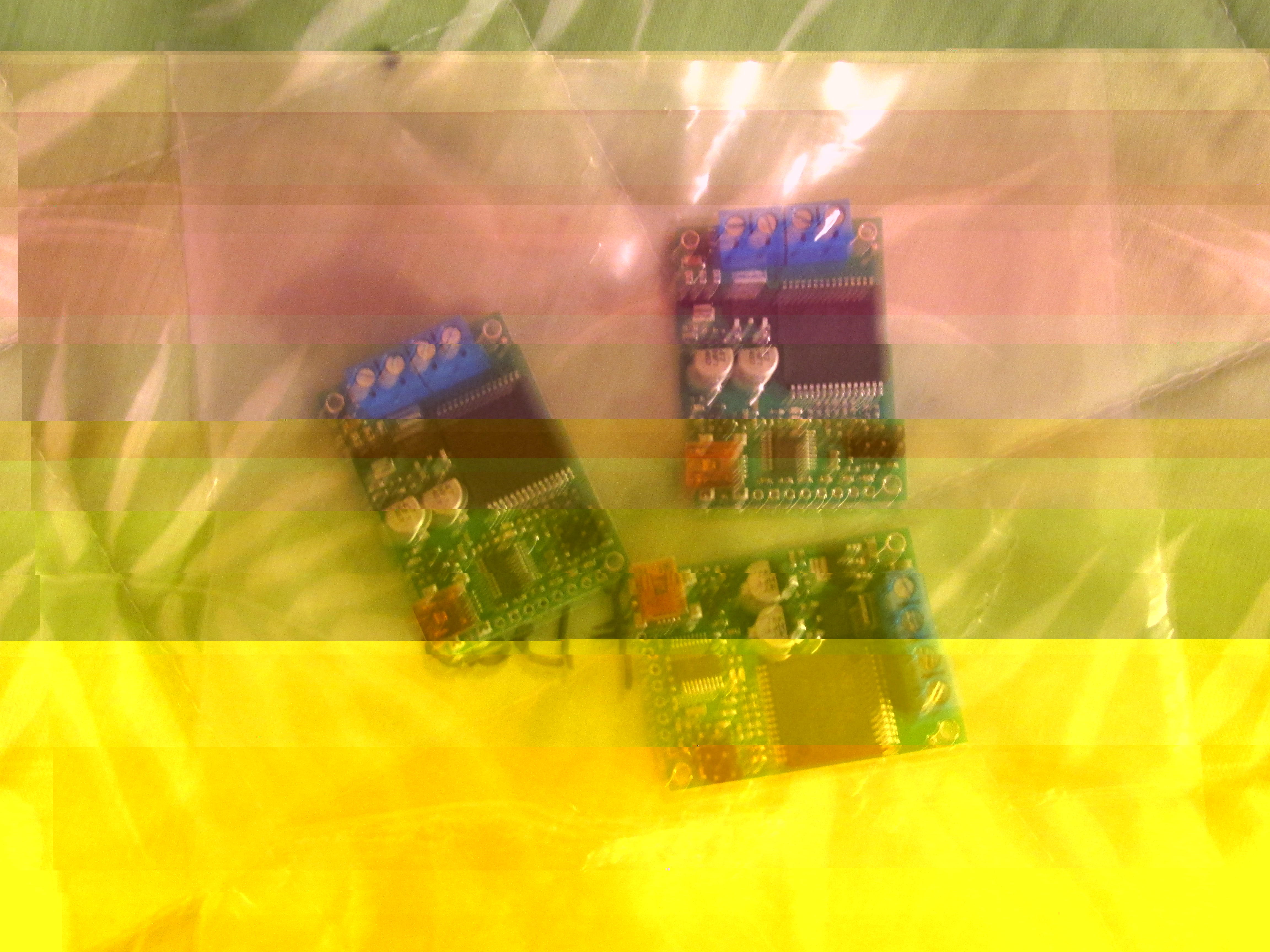

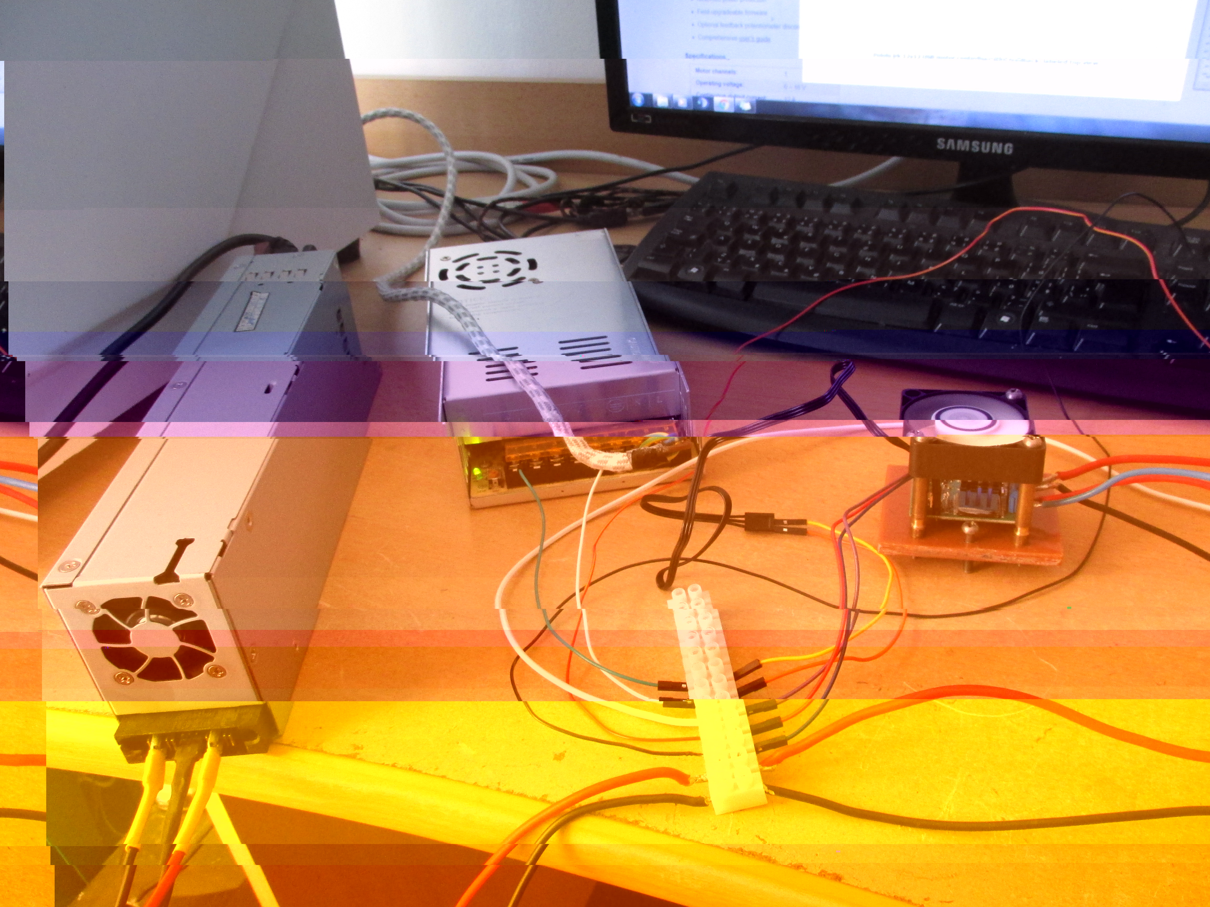

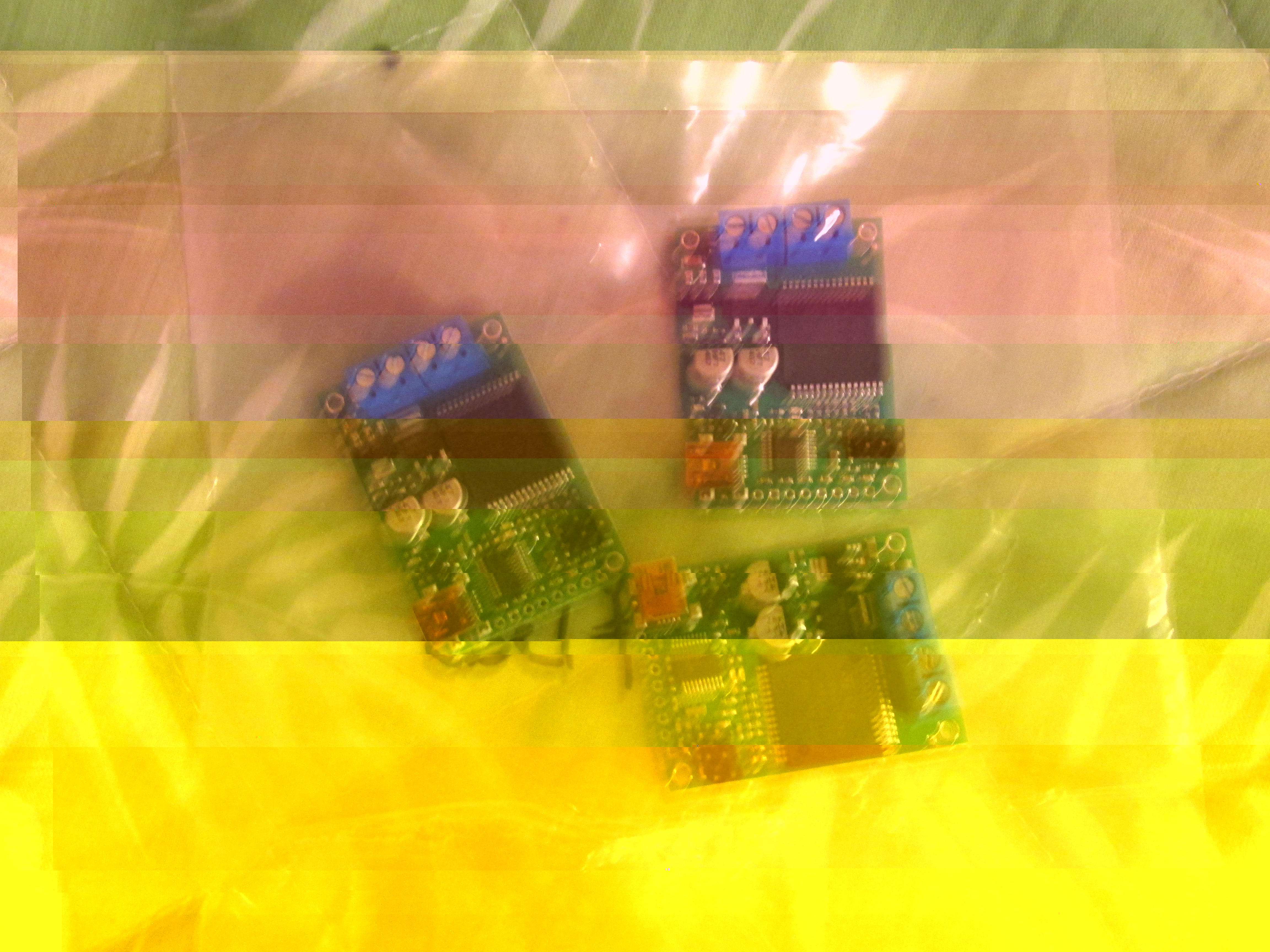

- first connecting via pololu configuration ulity

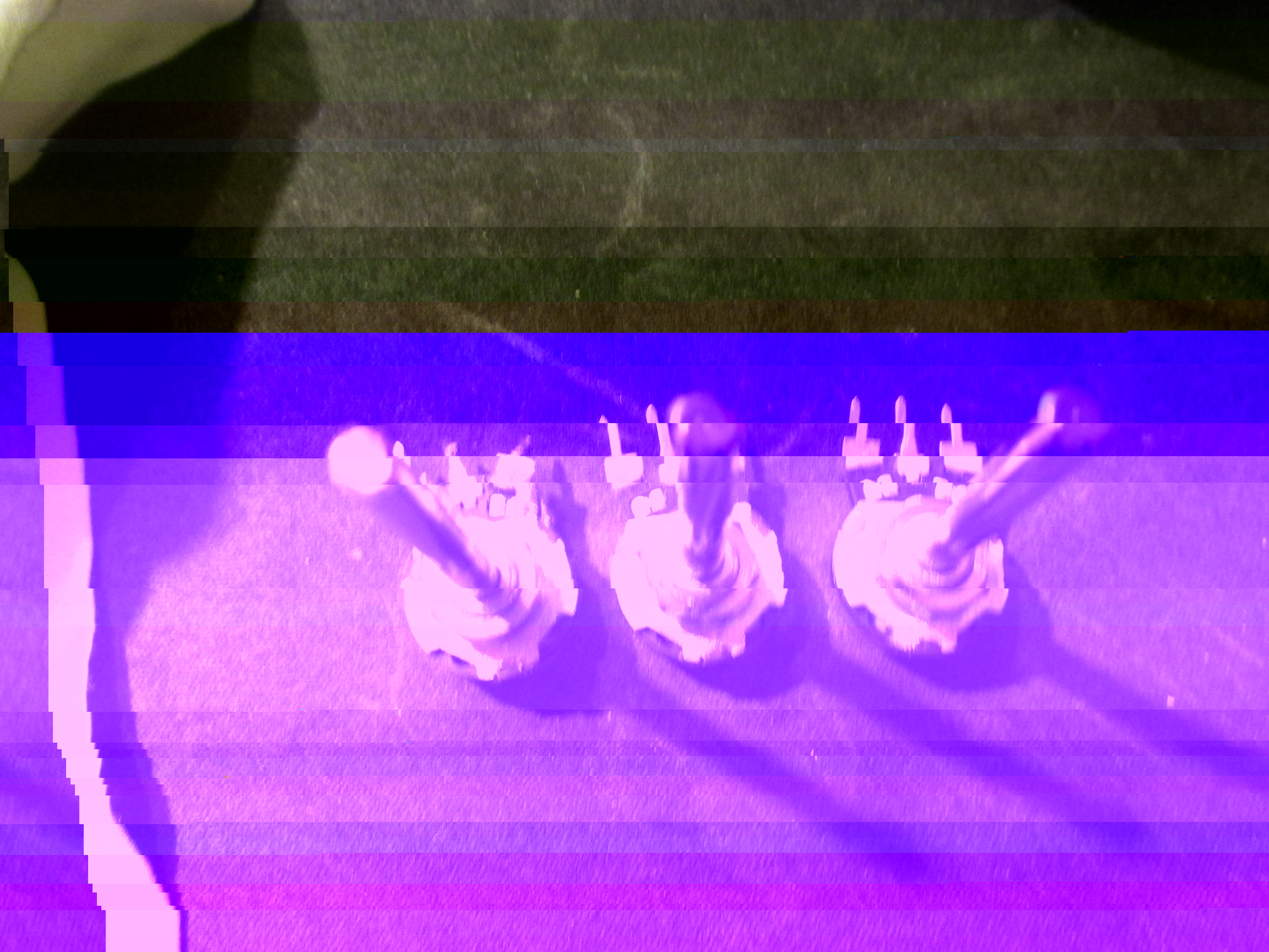

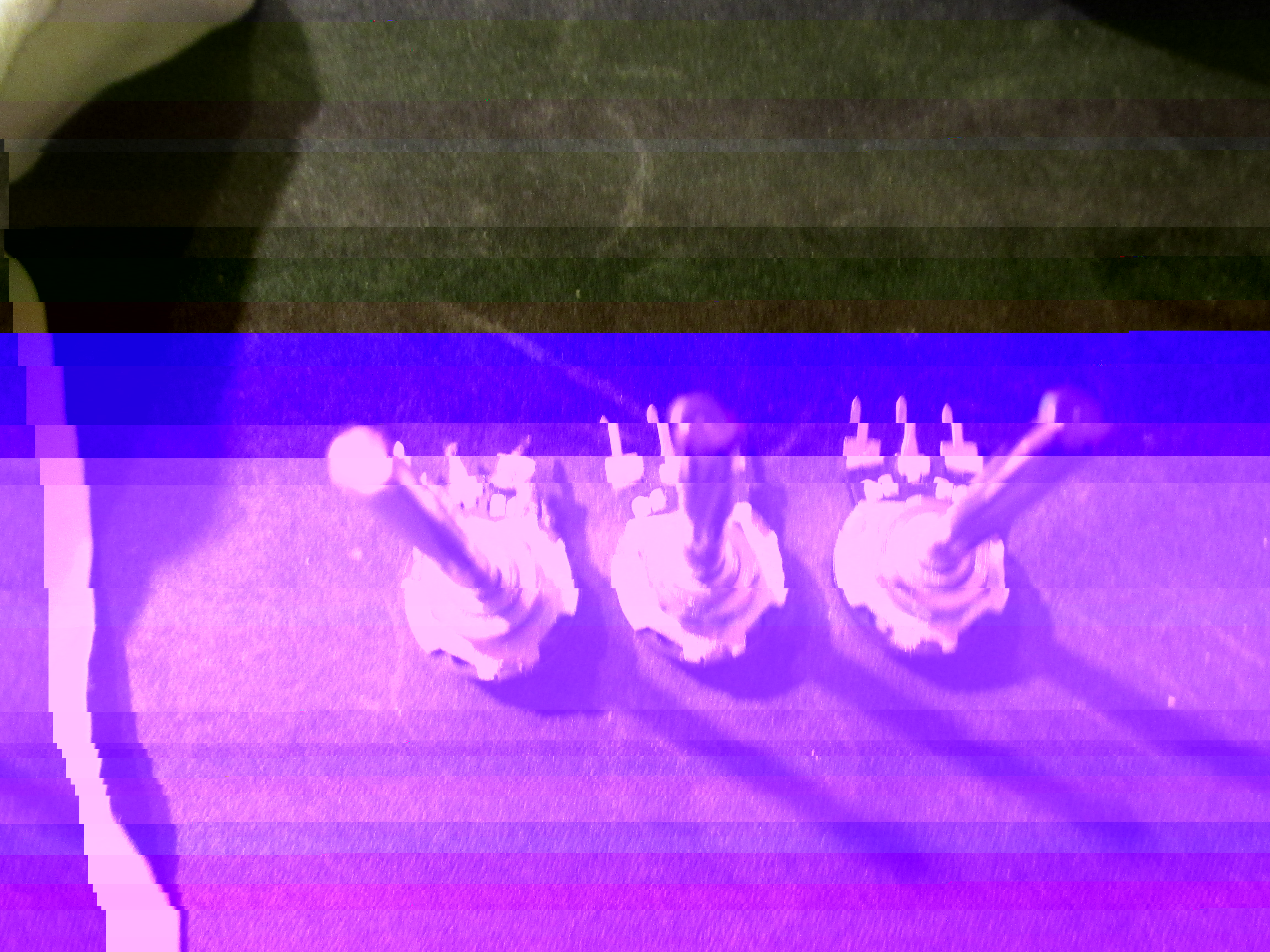

- 10Khm pots

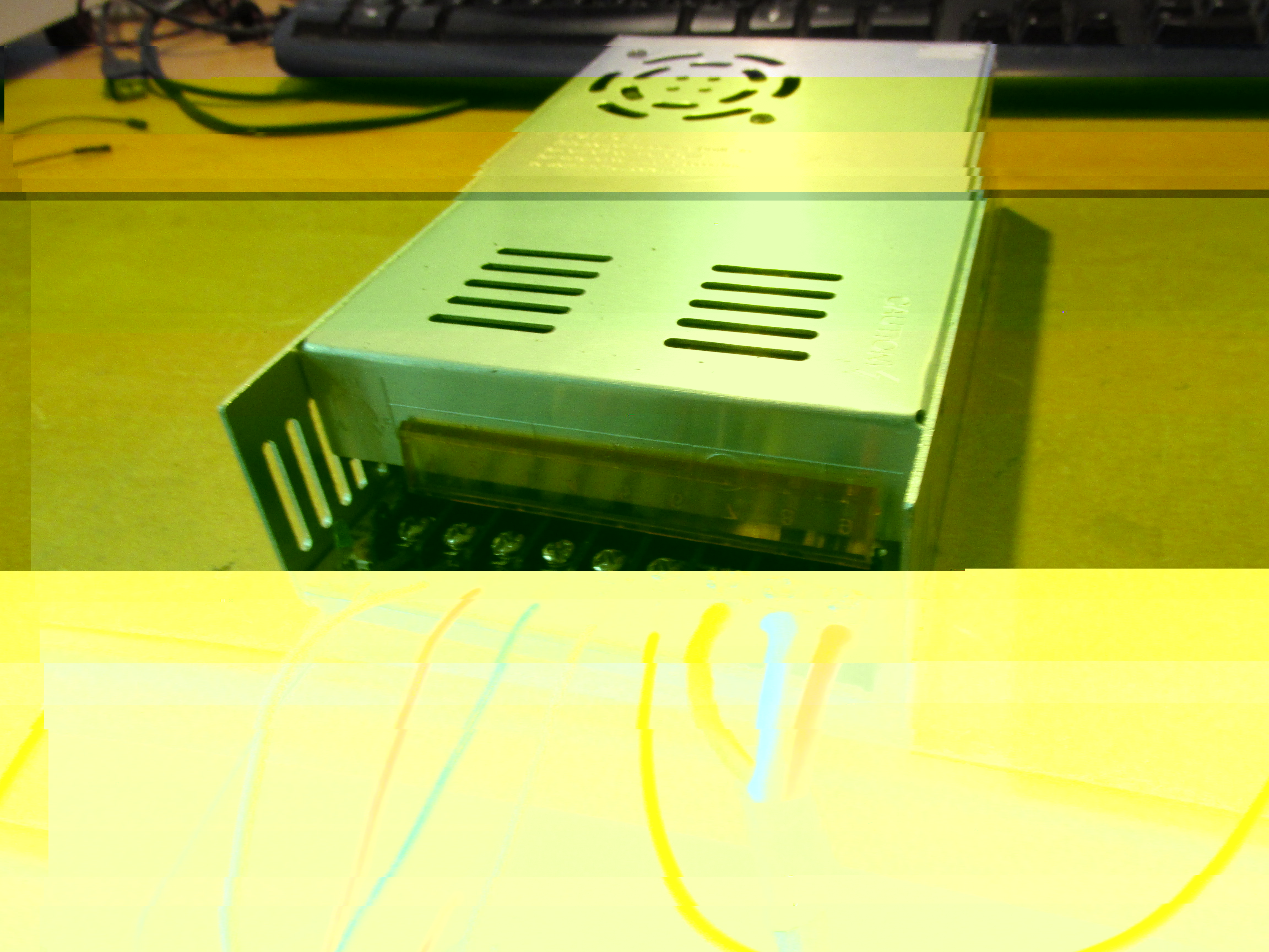

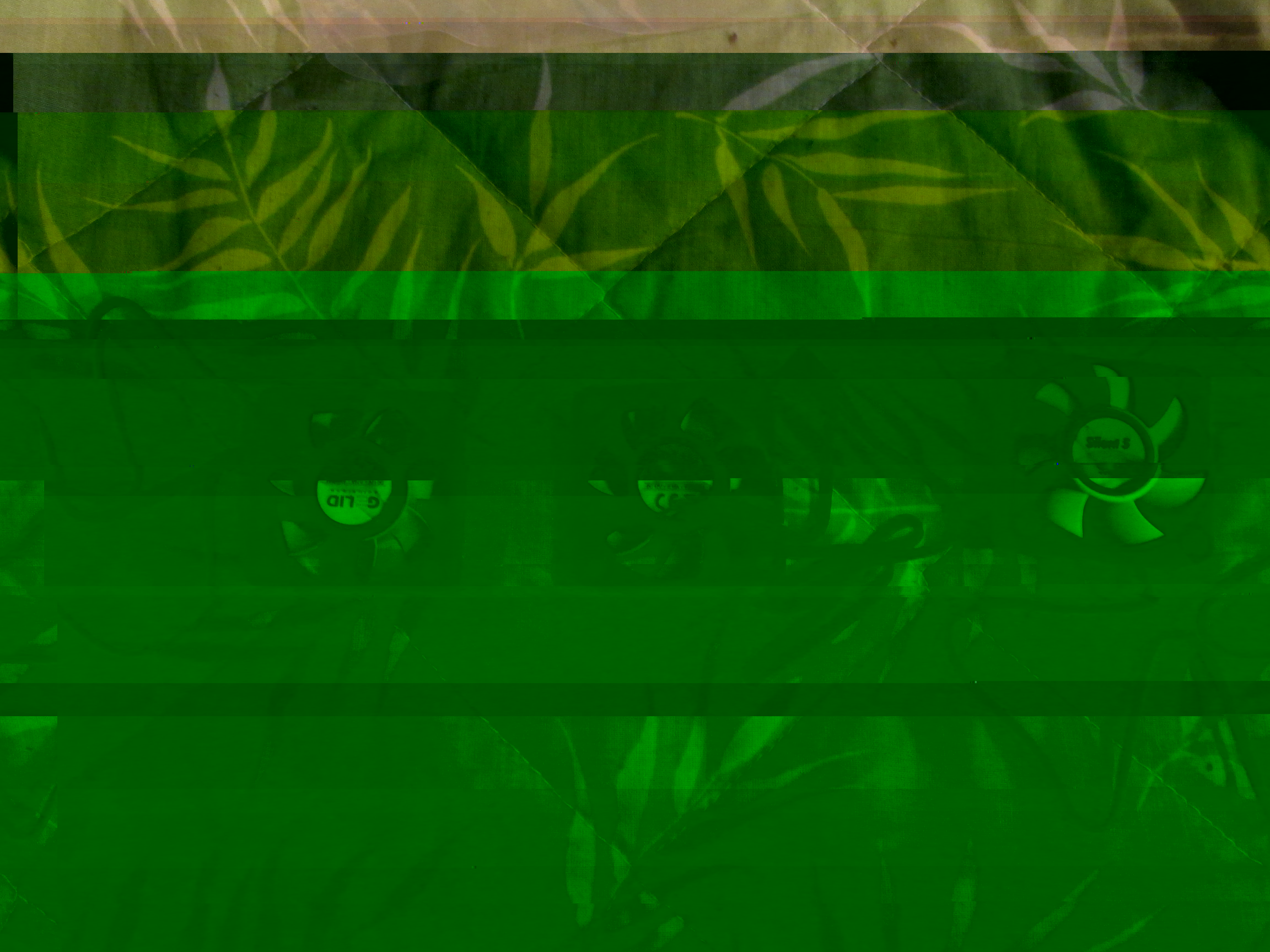

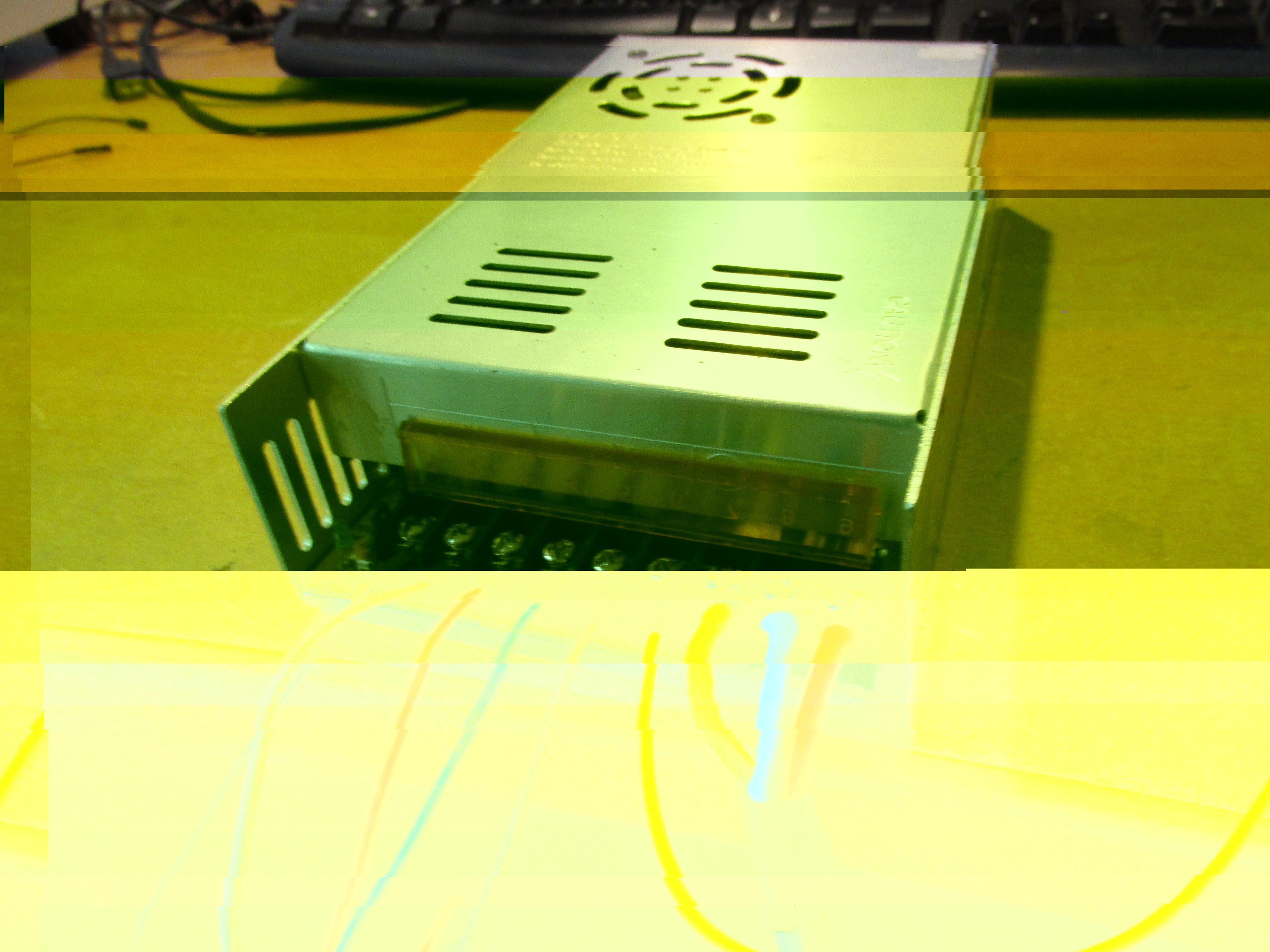

- PSu for coolers
- placing mainboard to chassie
- main board,which will be in chassis

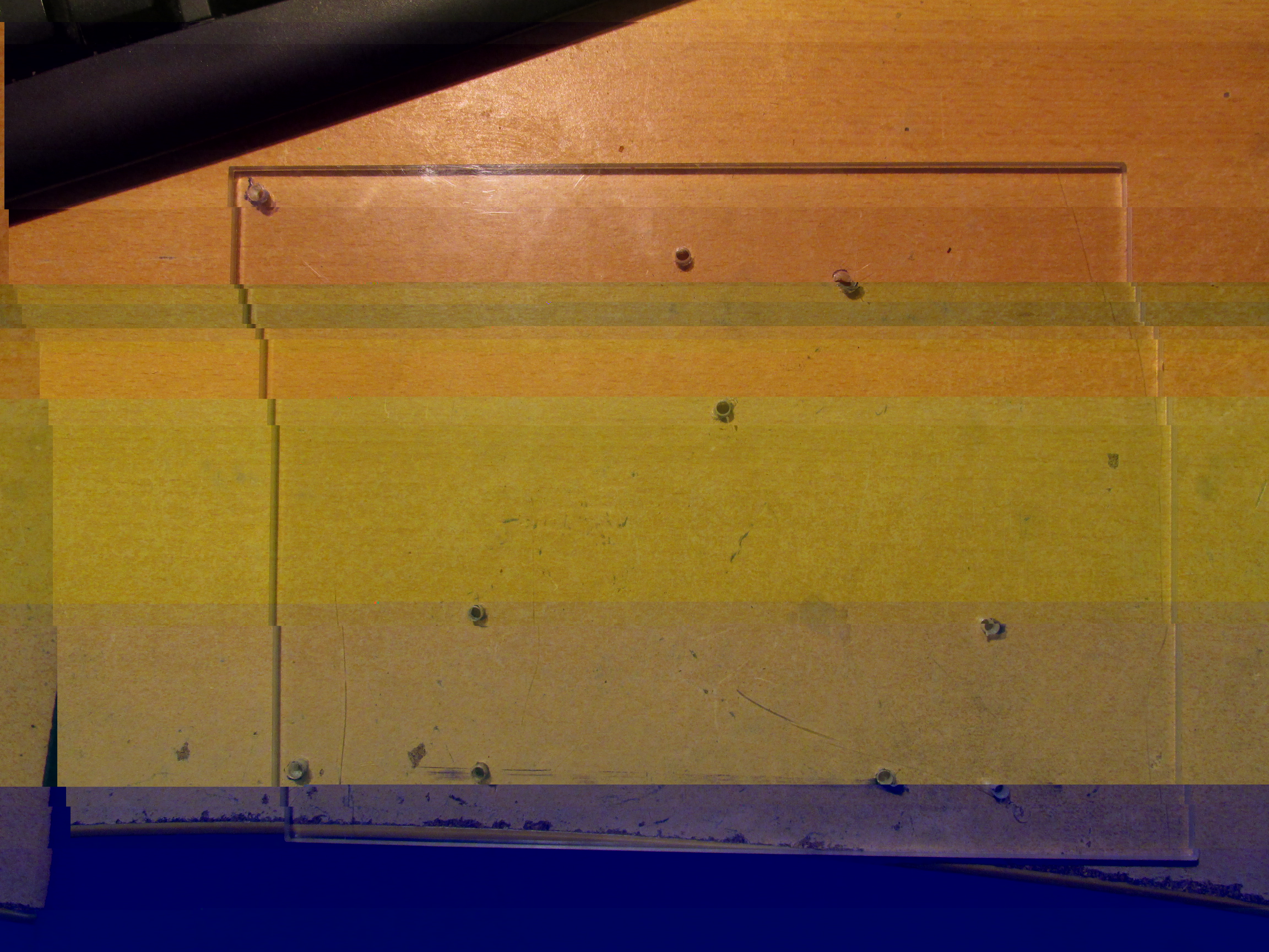

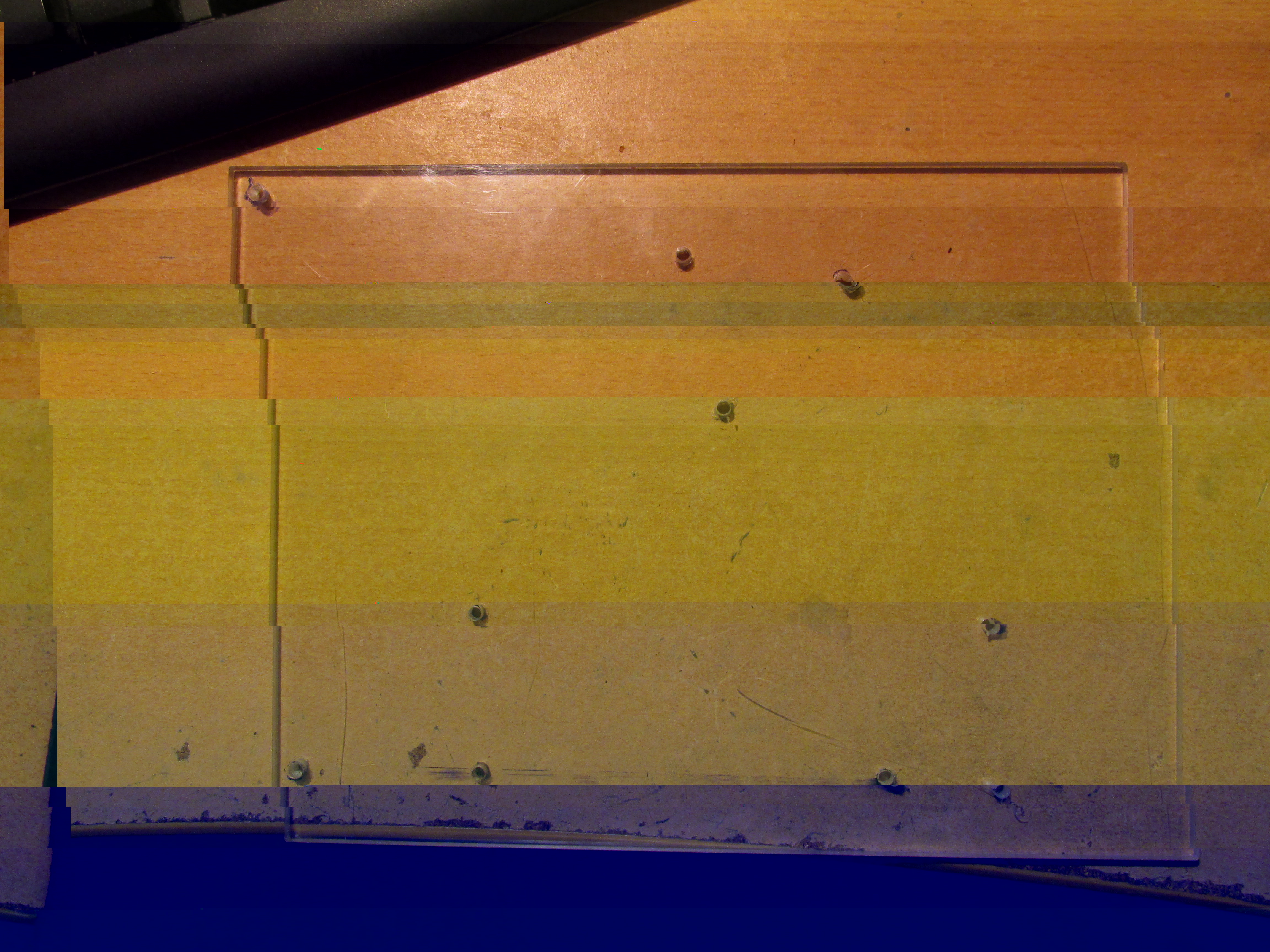

- I had to cut them off,because,there wasn't place on my chassis

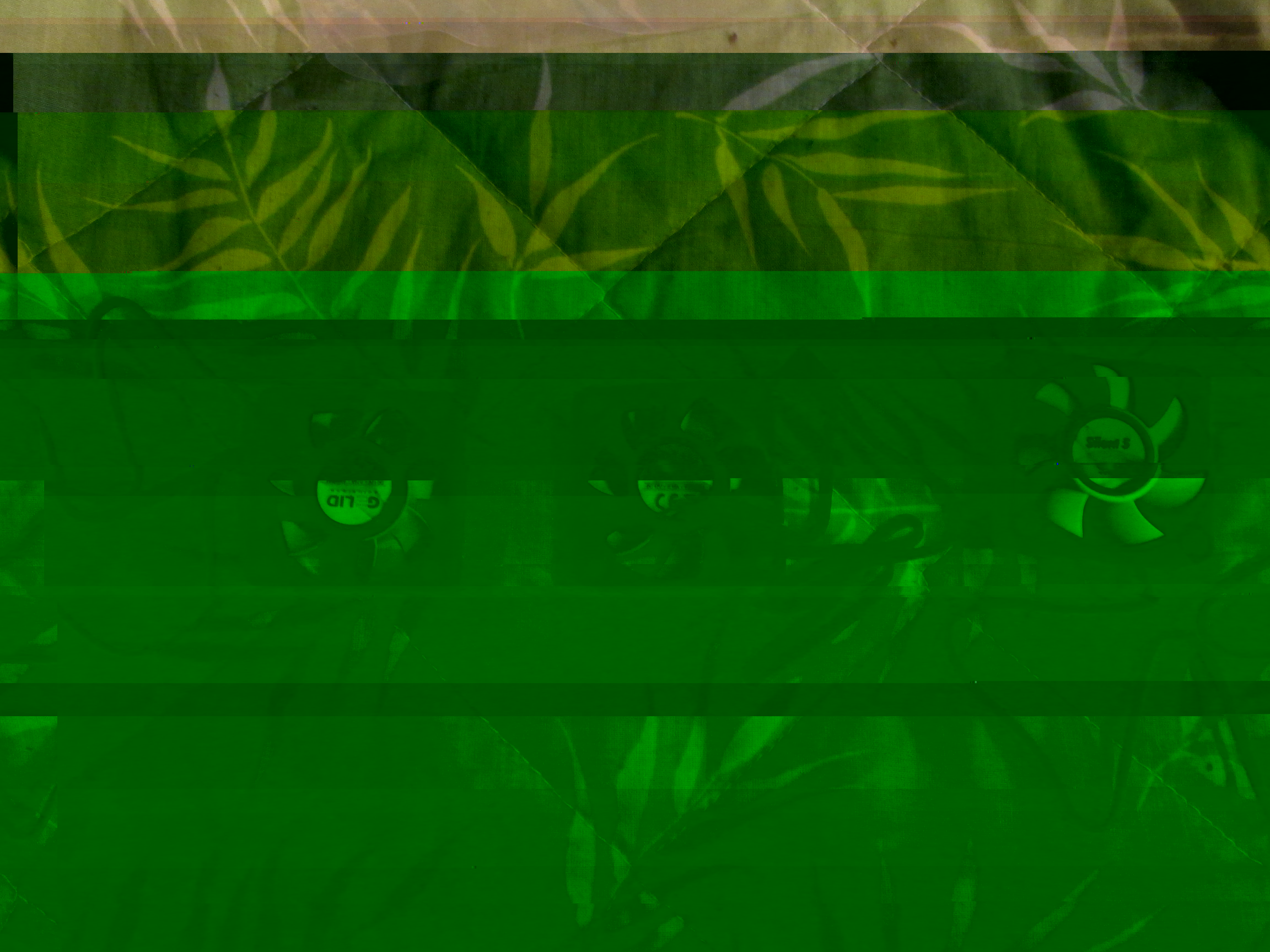

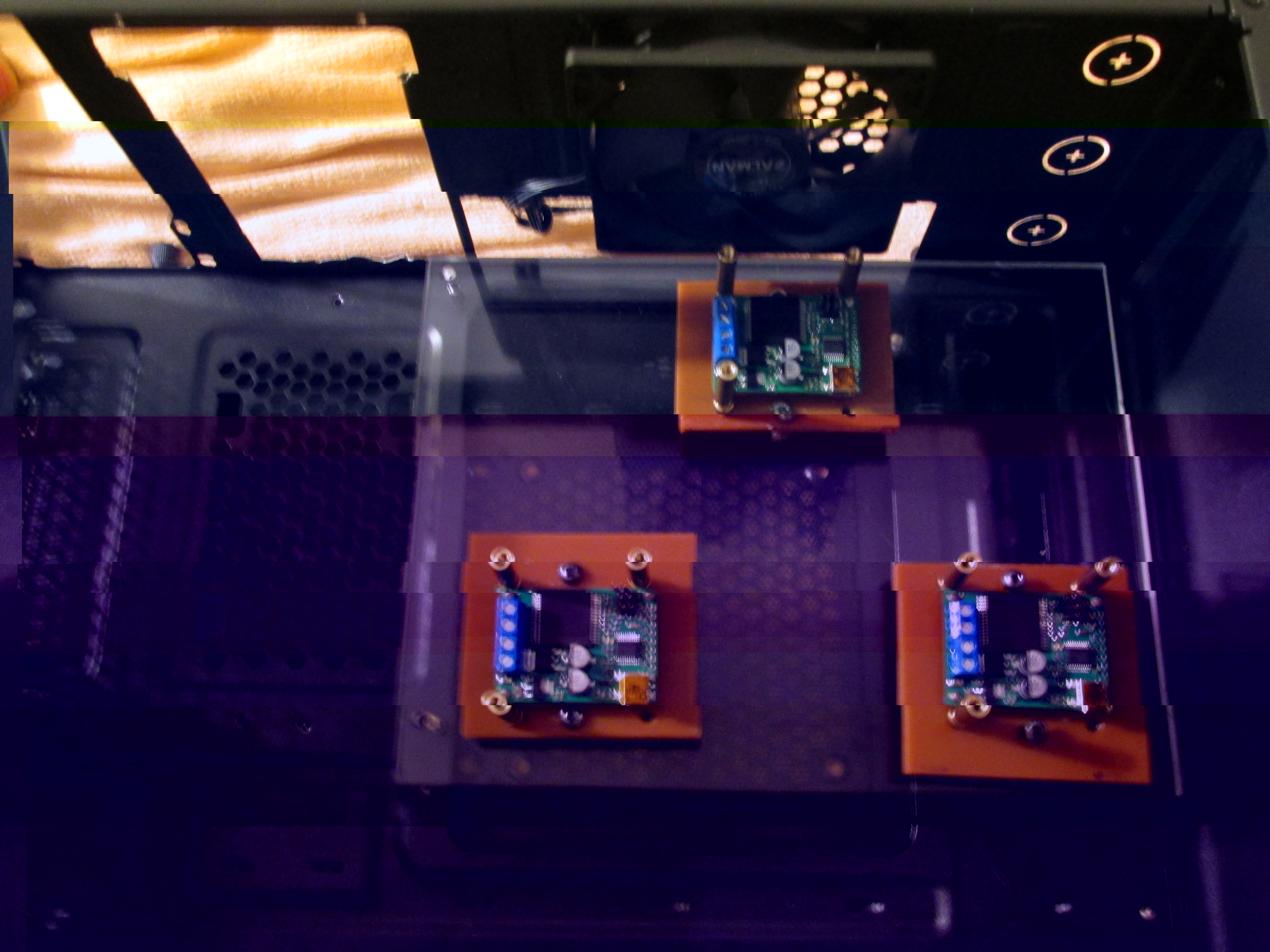

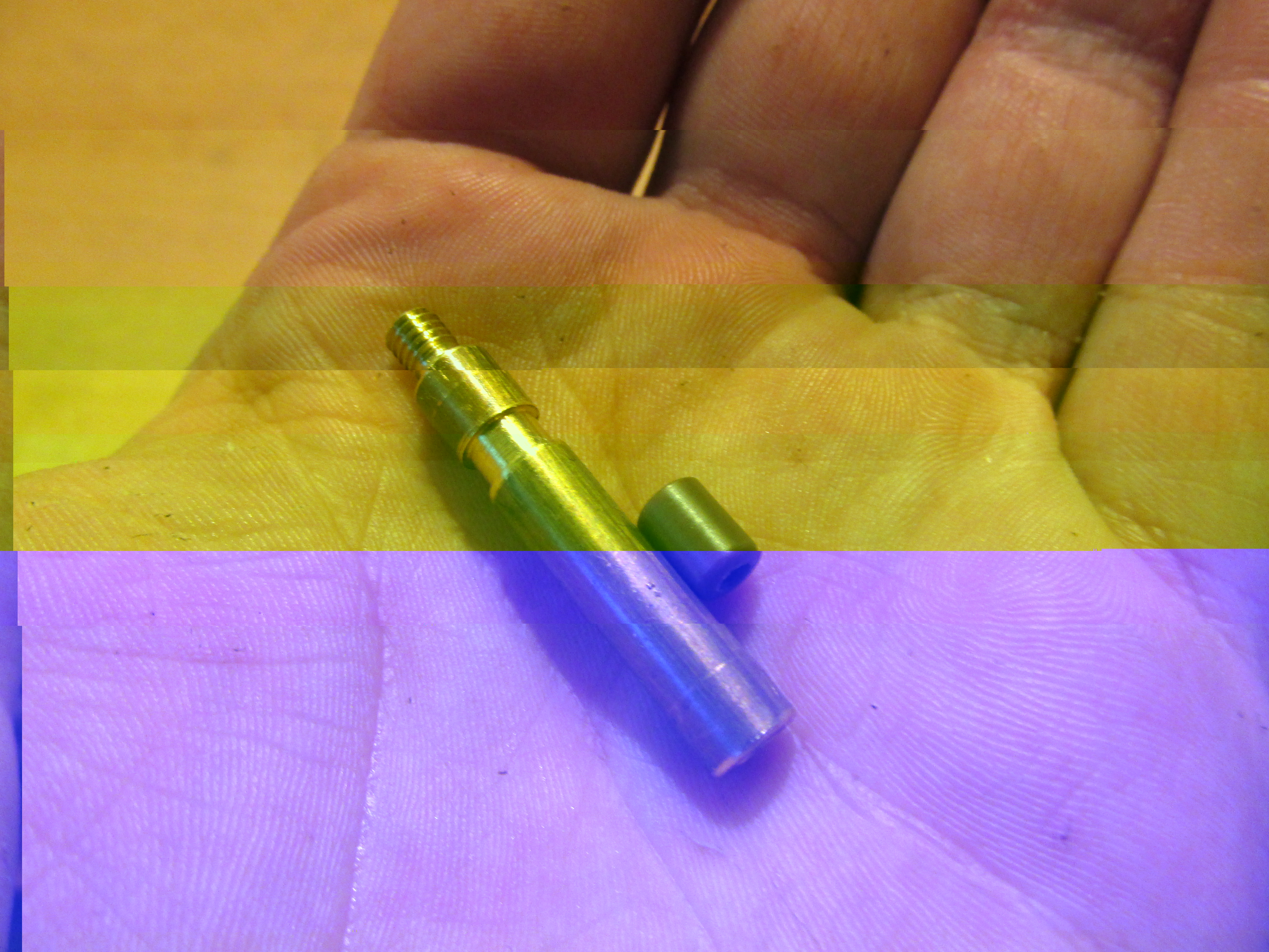

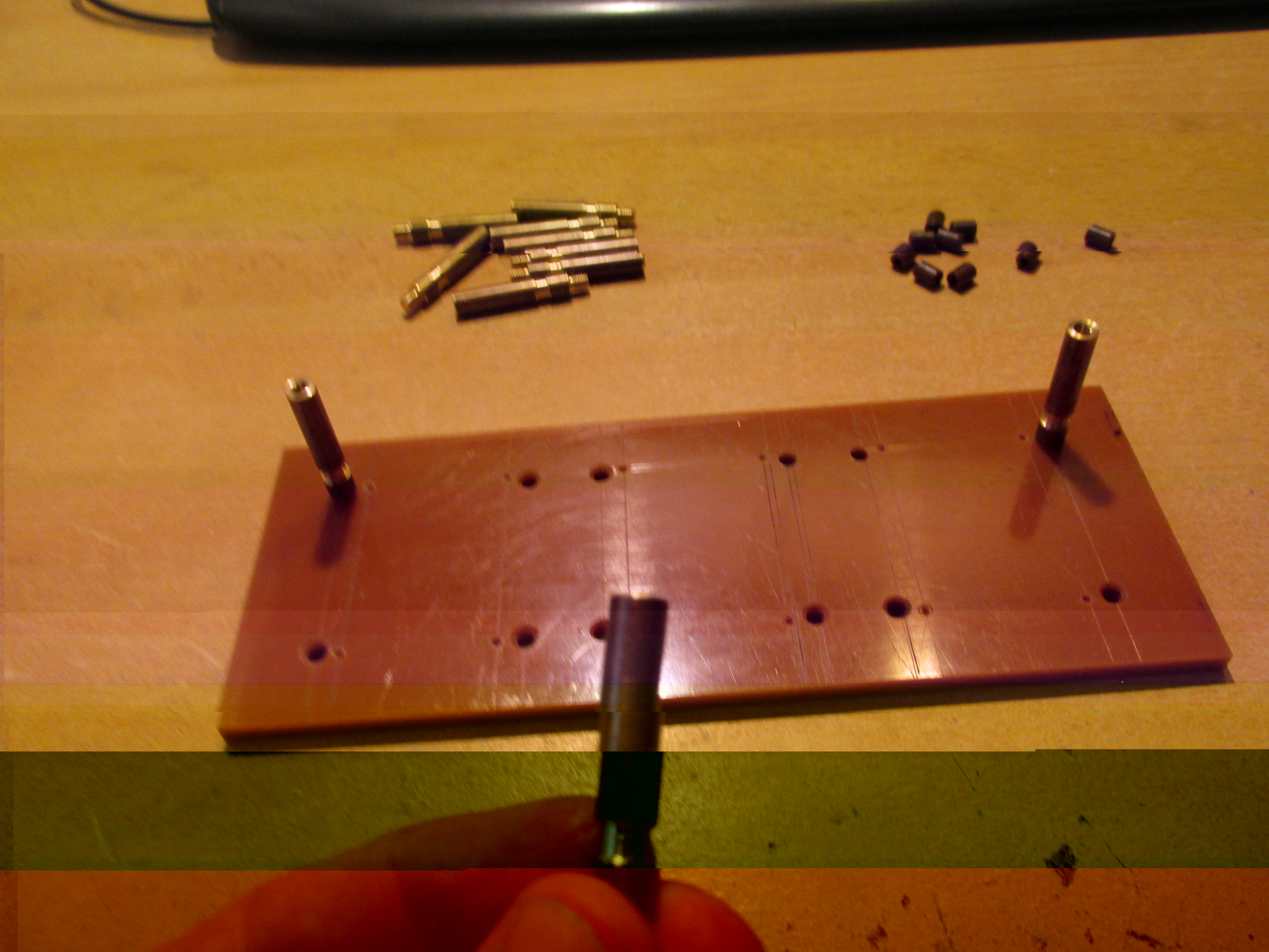

- Colums for coolers and washers for boards

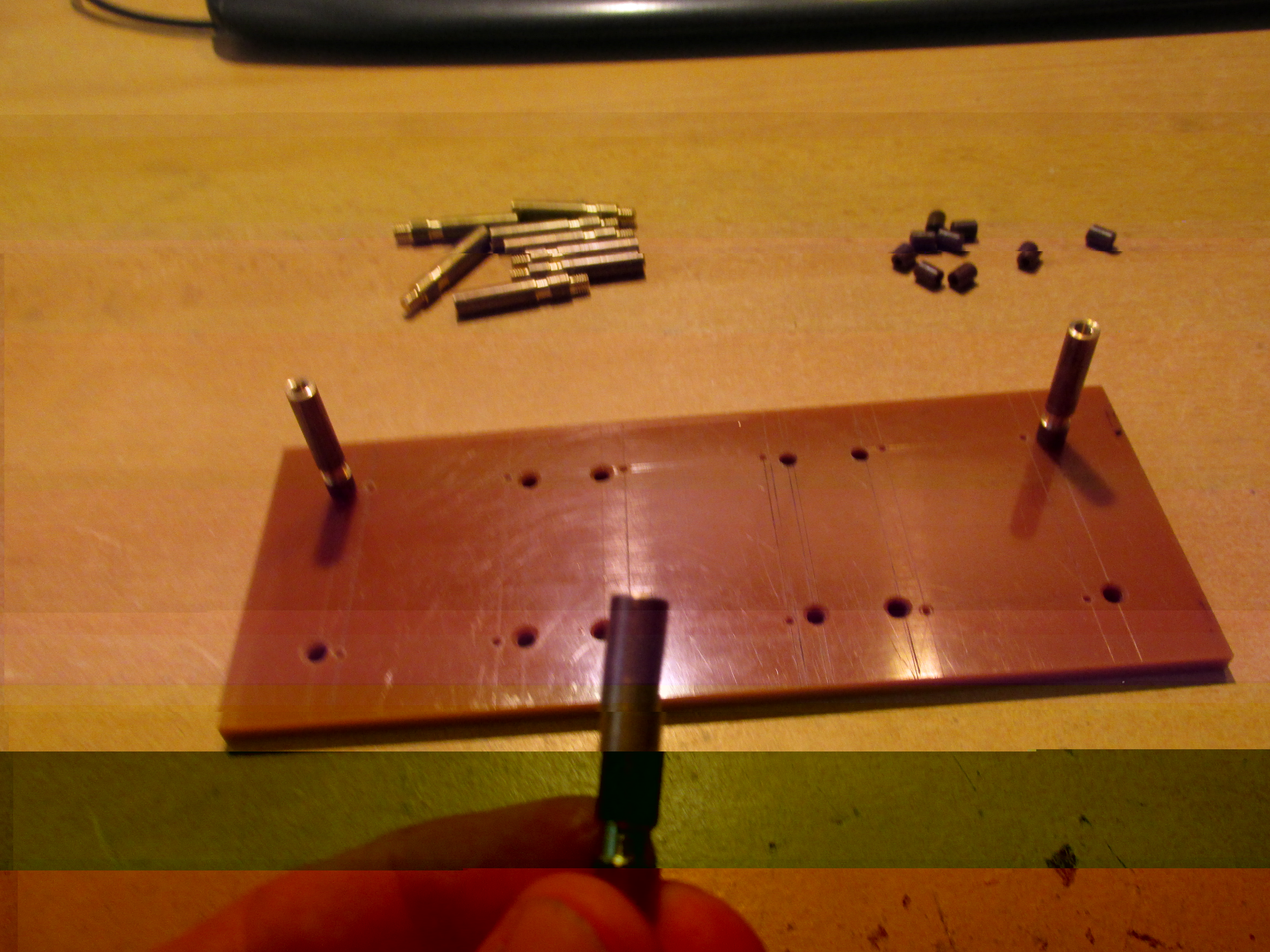

- Board for pololu with threads for collums

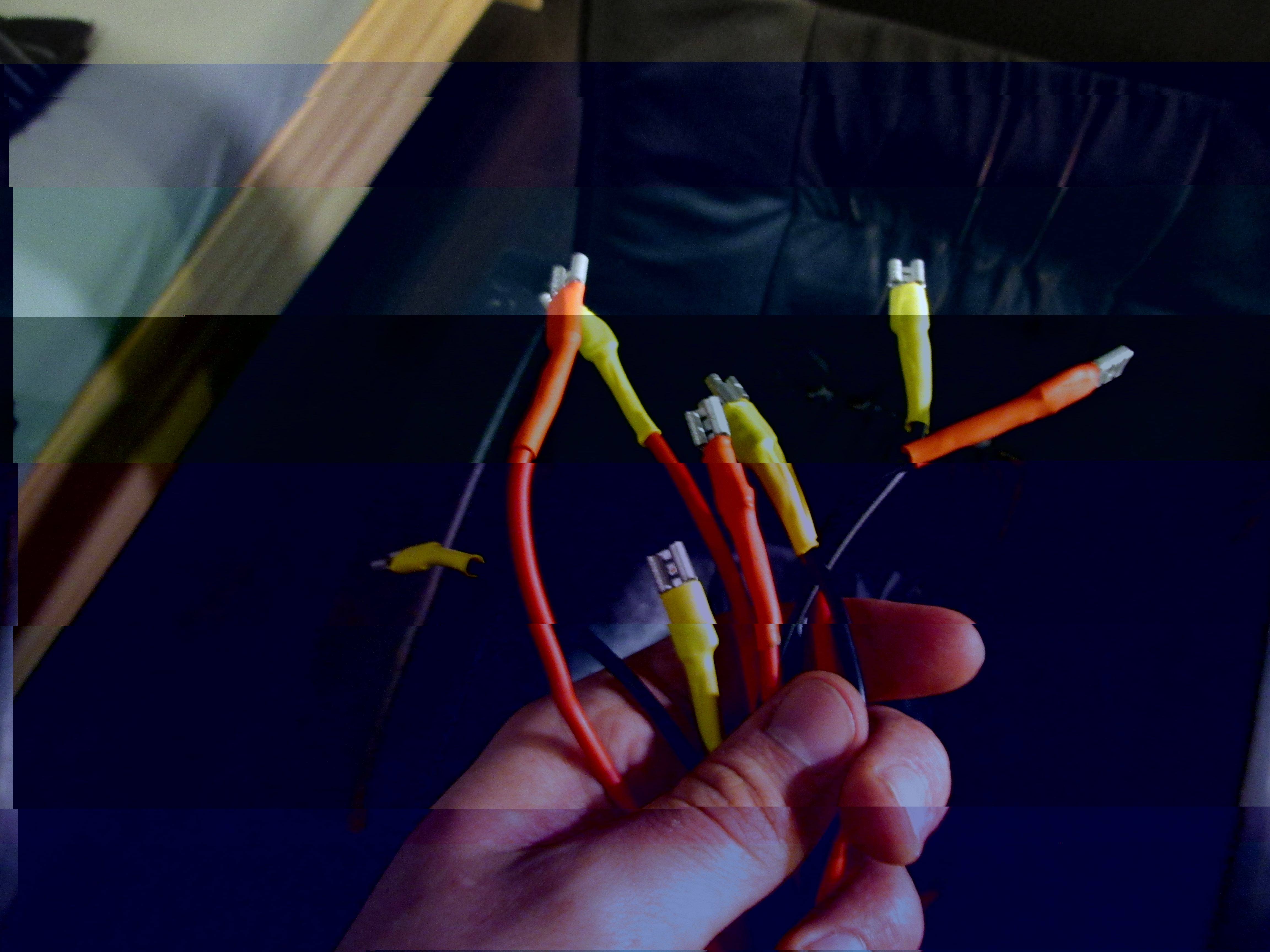

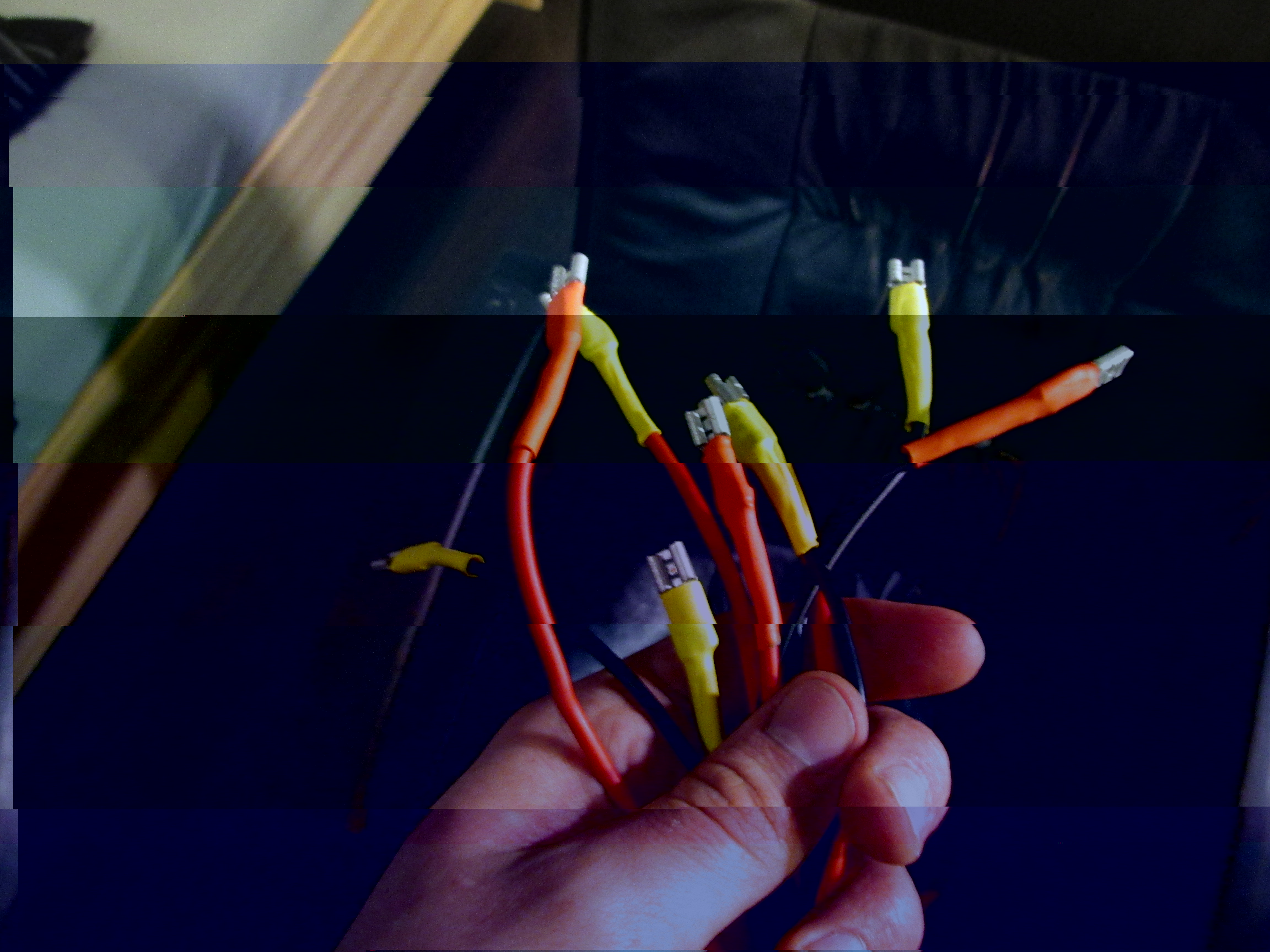

- cables for connecting psu prepared

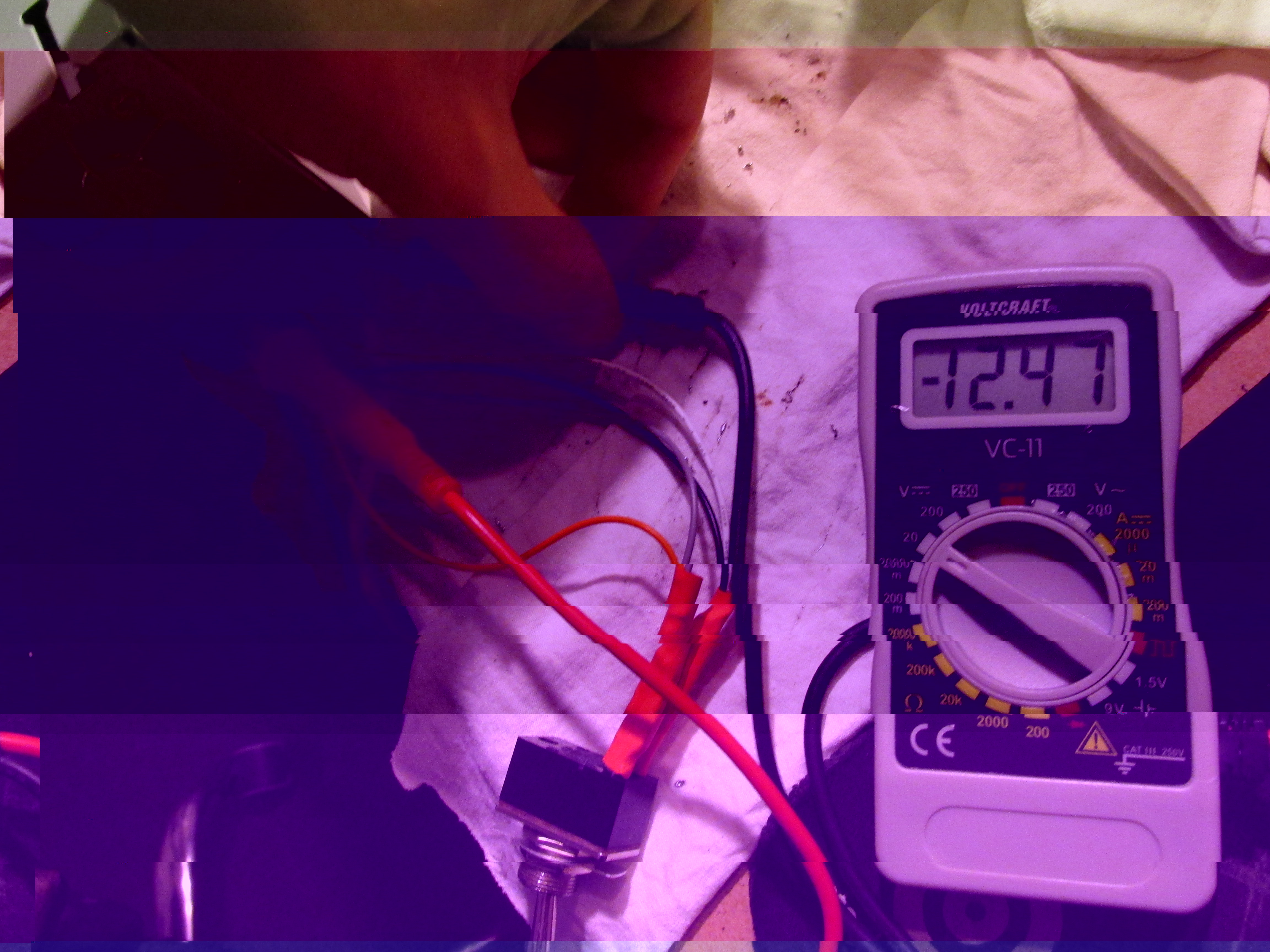

- voltage is good

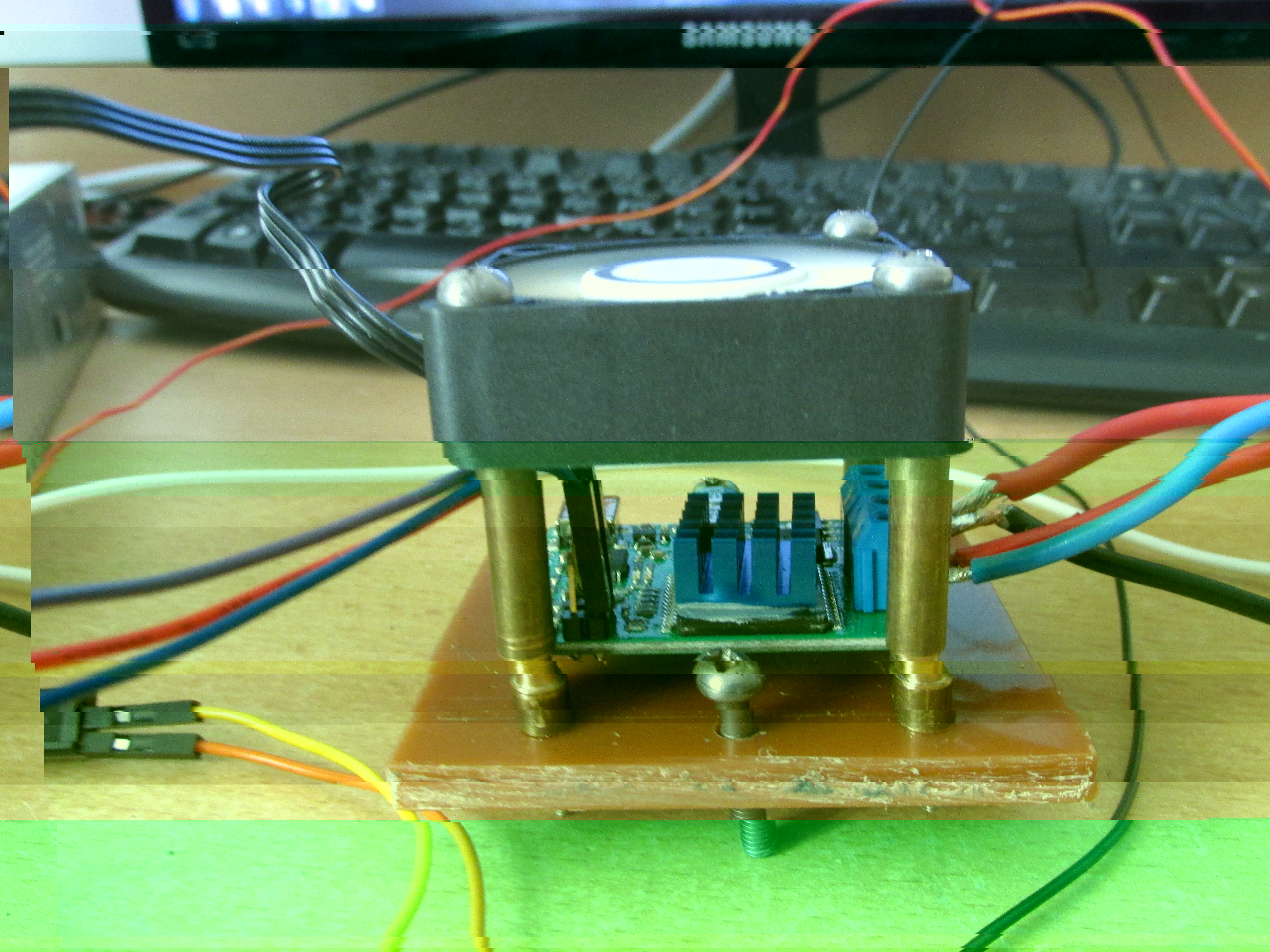

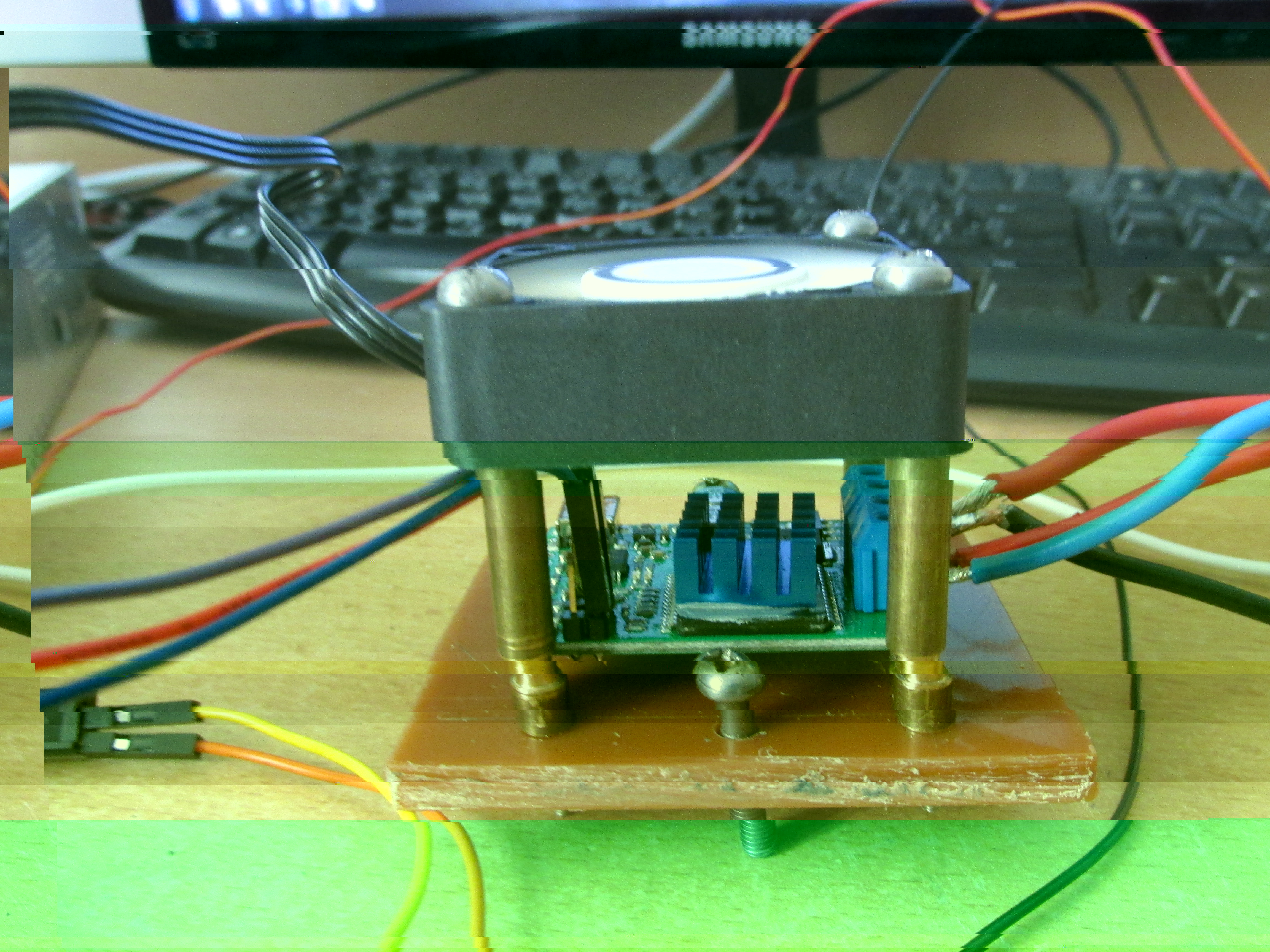

- coolers for pololu
- good friend heatshrink

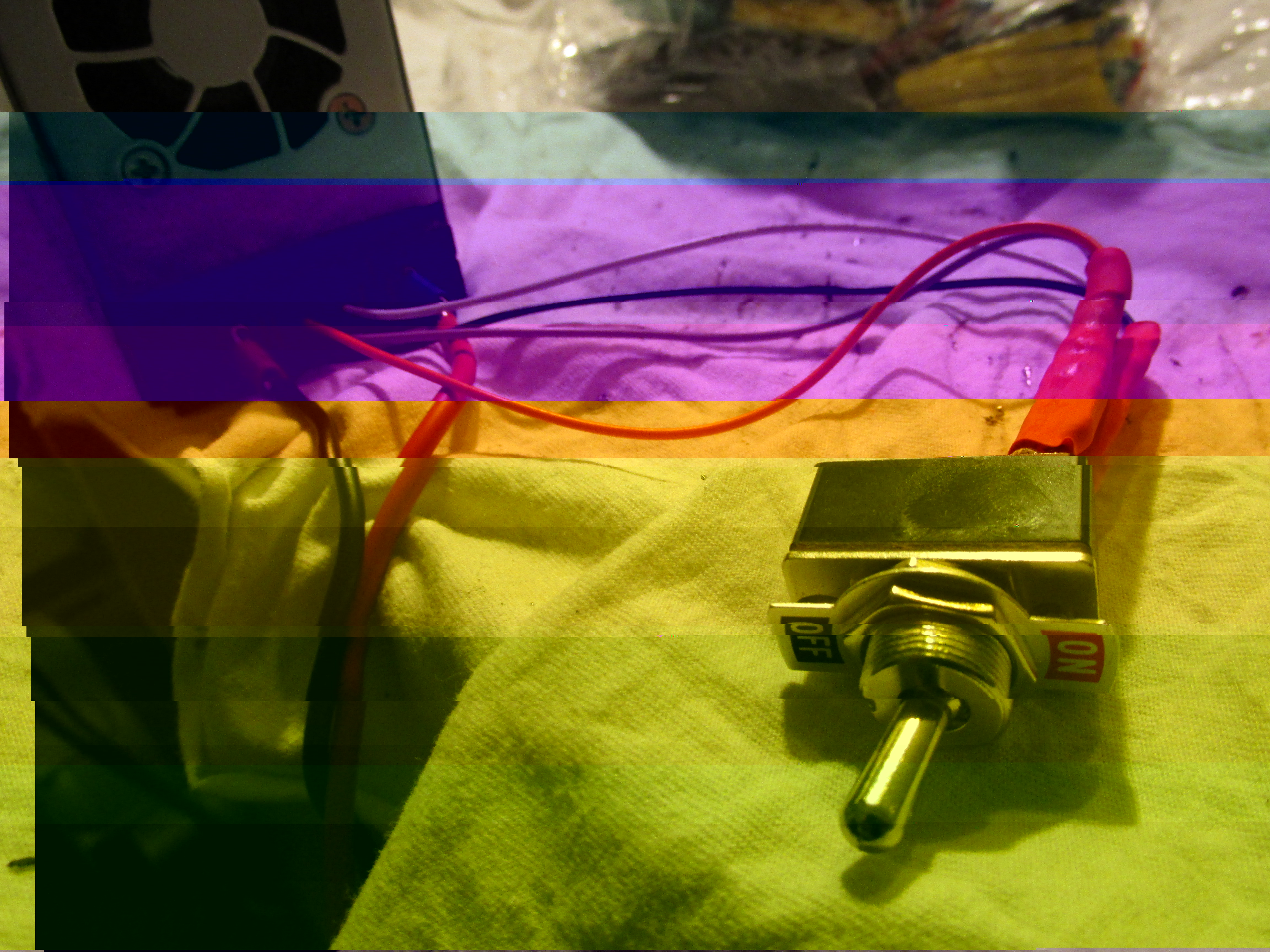

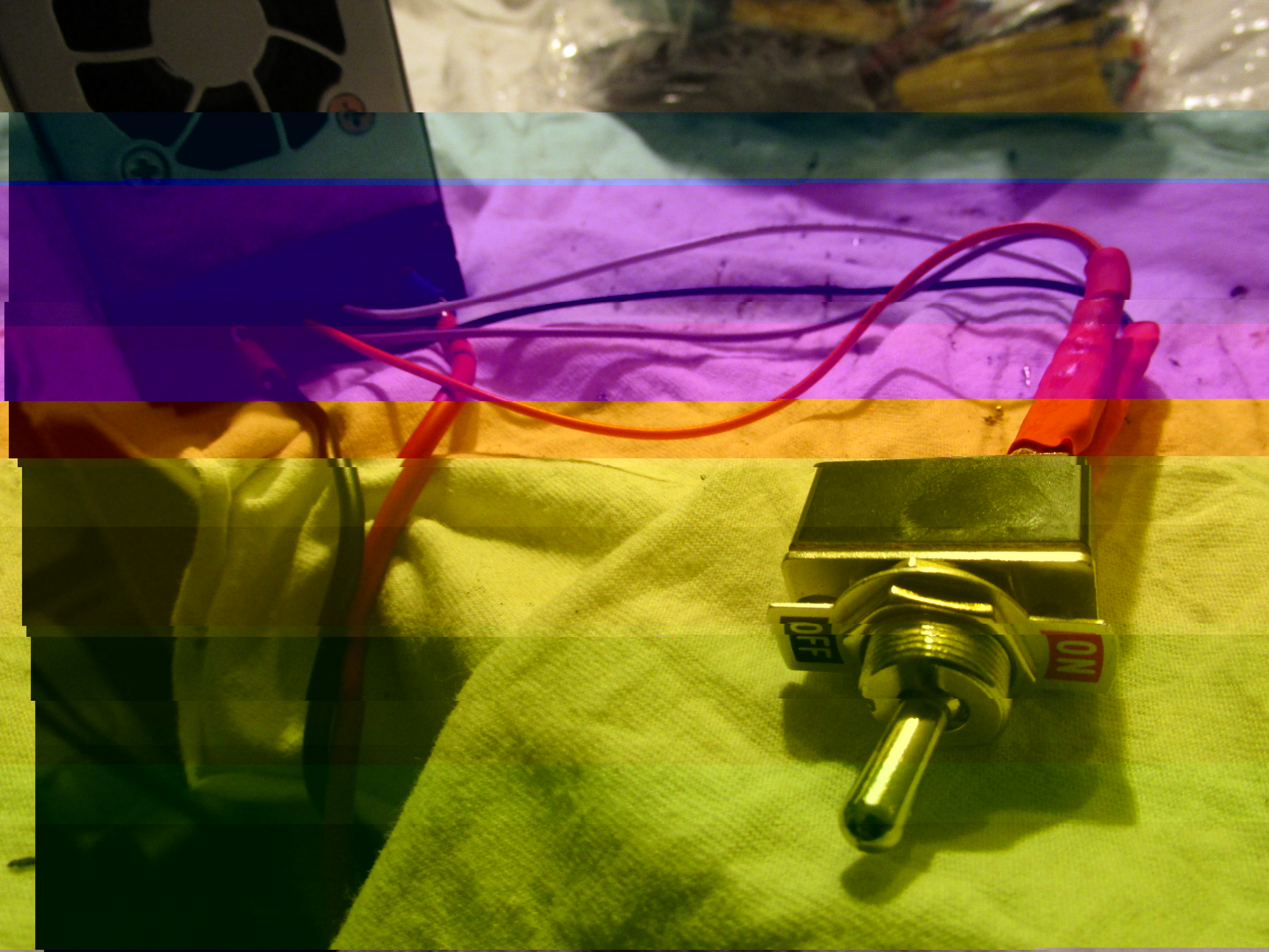

- connection PSU to switch
