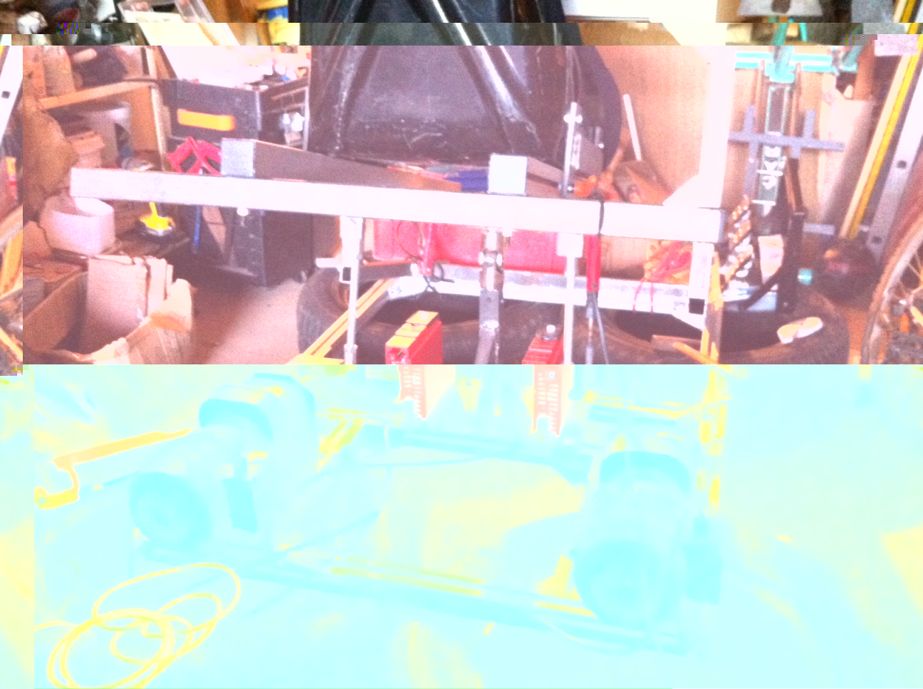

Hello,
THis is the actual status of my simulator, mechanical side finished after 3 months work.
My friend has a lot of job on electrical side... good luck !!! :D

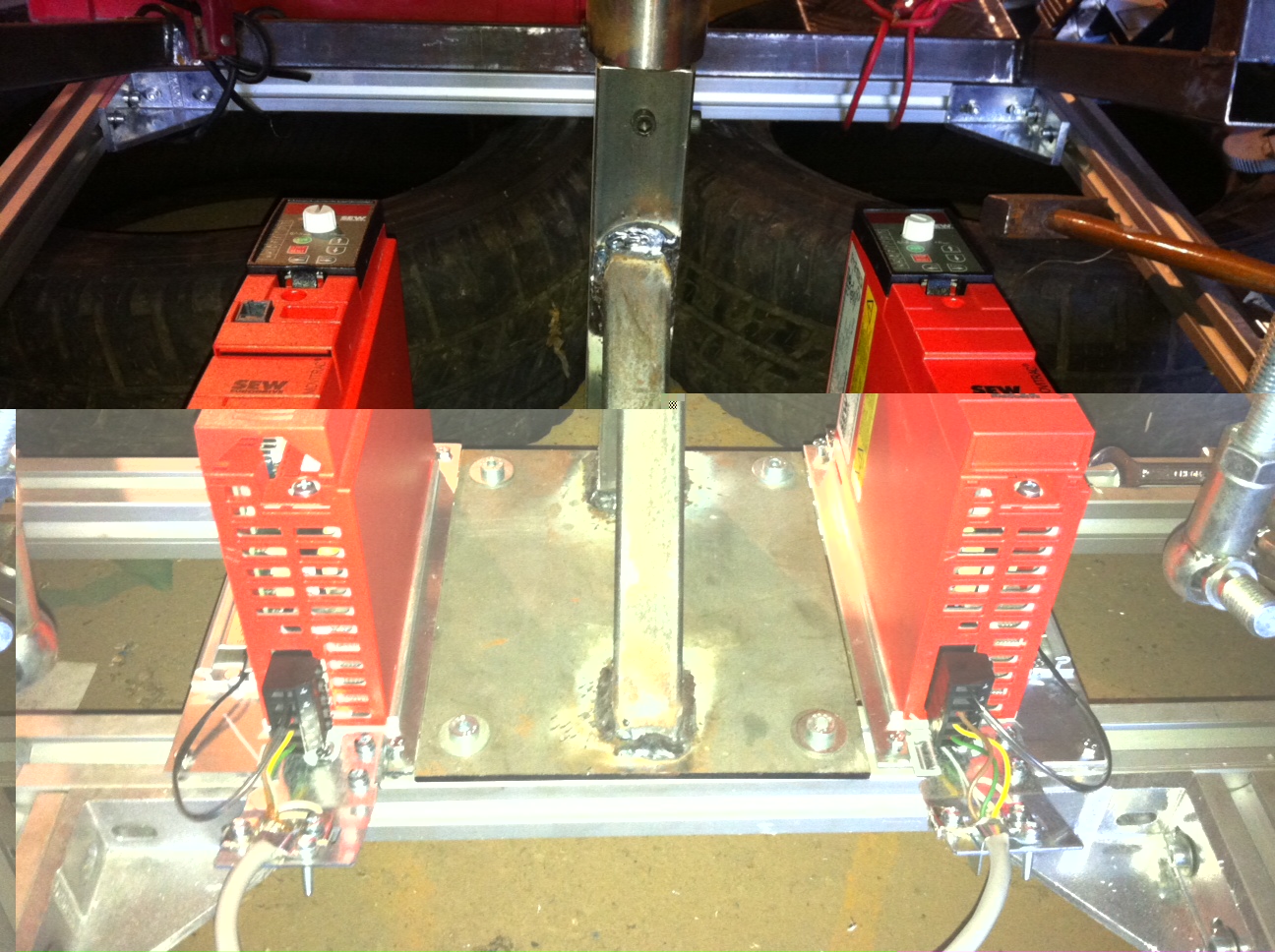

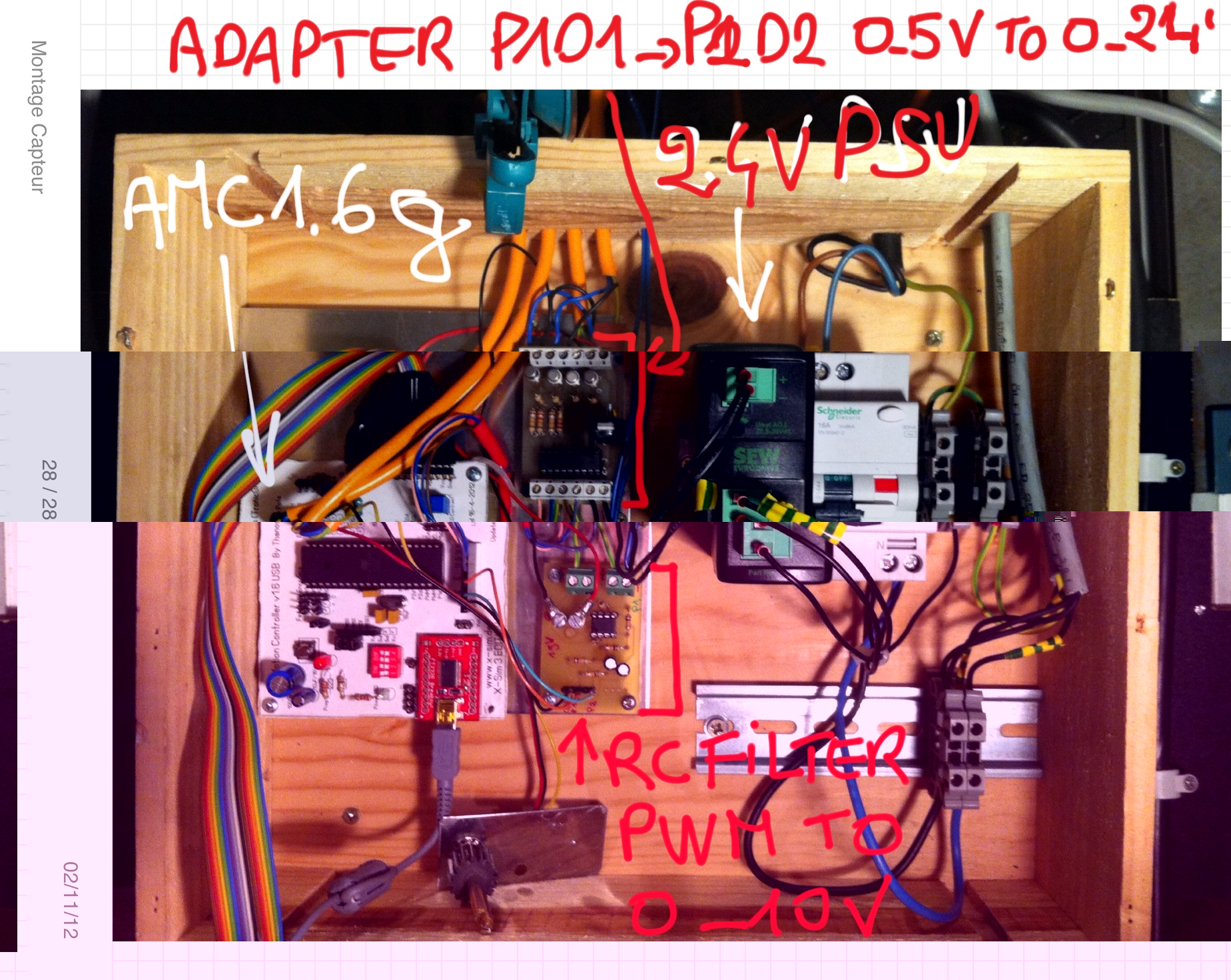

We will use the configuration as follow:
- sew inverter type Movitrac B ( to power the motor with 3 current phase and for the frequency motor driving)
- amc1.6
- RC filter for converting the pwm signal to 0-10 Volt
- a board made by us for driving the rotation sens (p1d1 p1d2 etc) from 0 5 Volt to 0 24 volt.
-xsim 3 for the game interface.

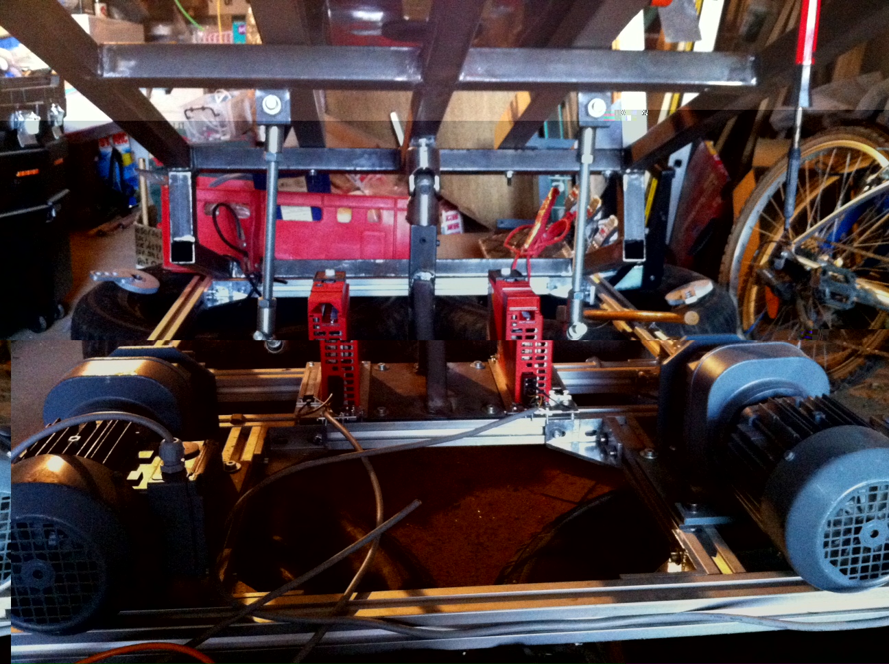

Geard motor specifications:
0,37 kW 4 poles - gearbox output rpm : 48 ( a little bit high but we will see)

First of all the pictures :
simuarrière
backsimiu

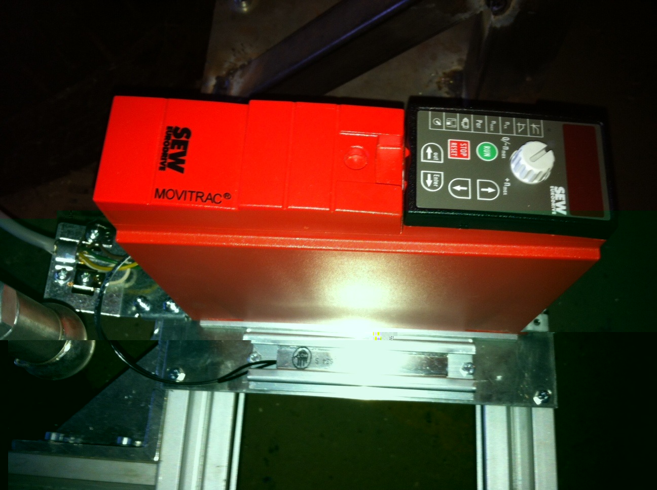

Inverters :
inverter

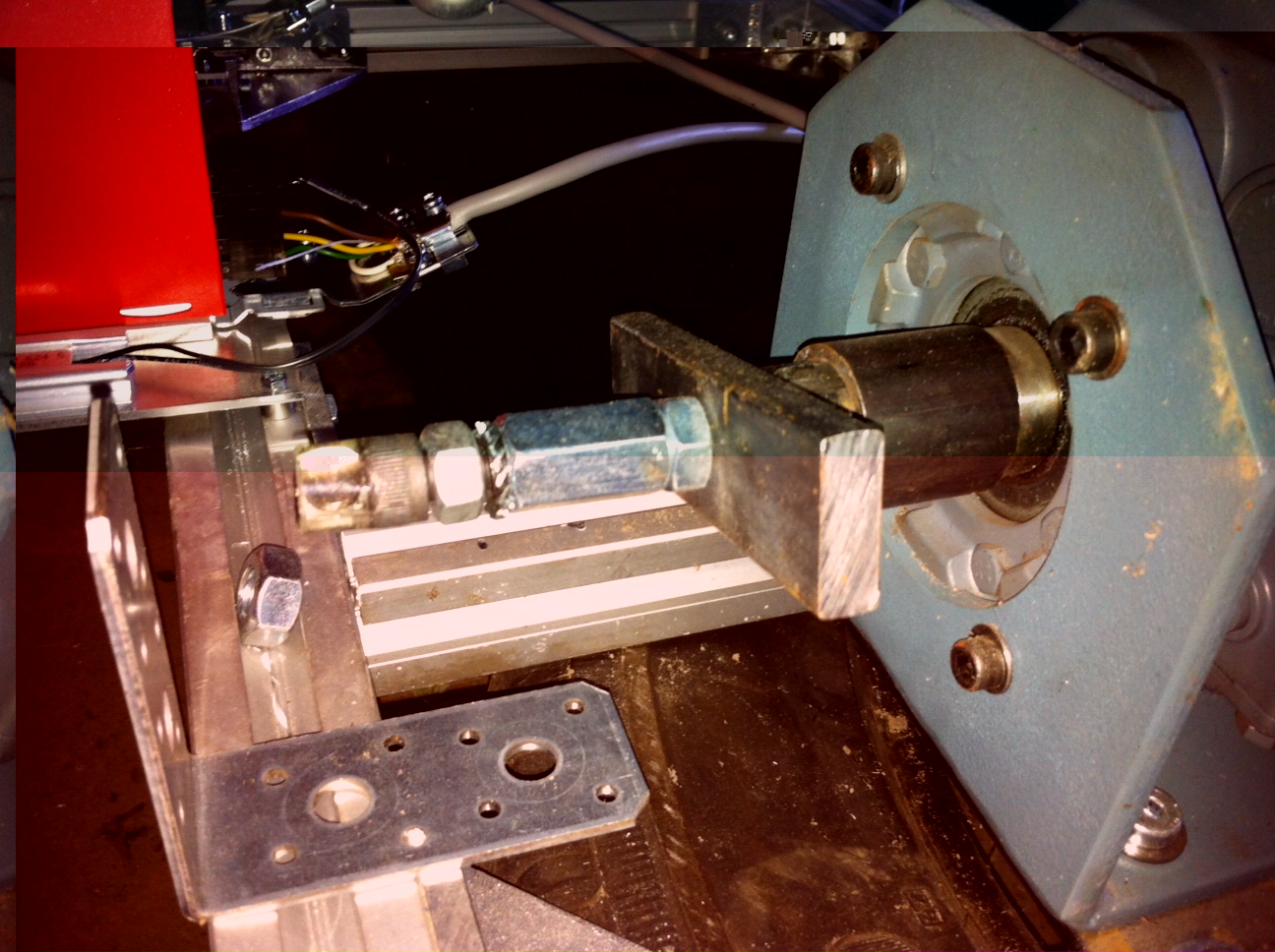

Output shaft :
output shaft
I not finished to wire all the material .I have to finish the sensors positioning , the box where I will put the amc1.6 and all stuff for connecting the current net.

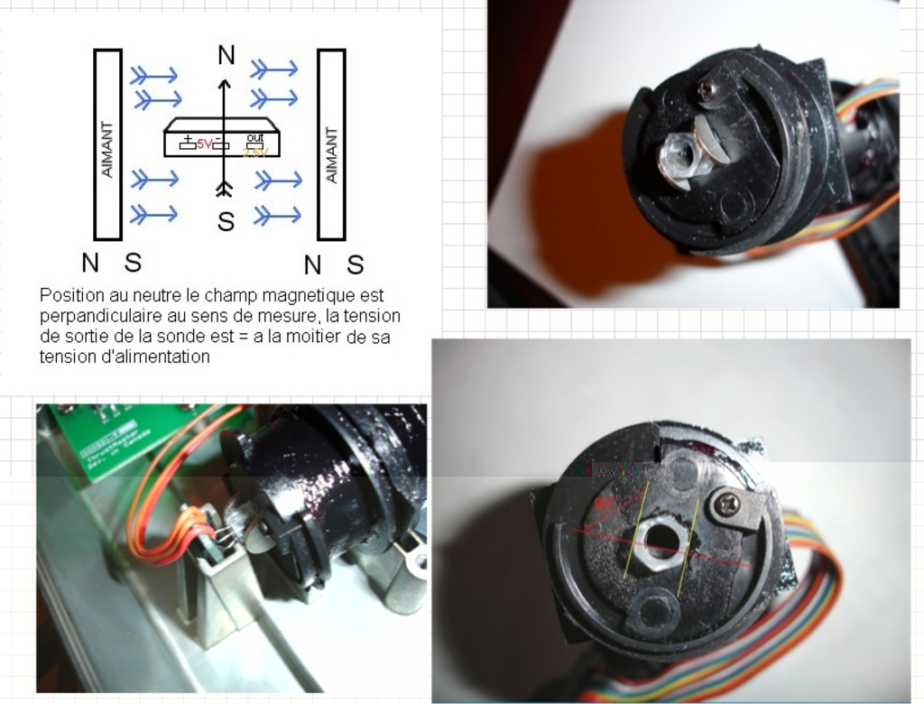

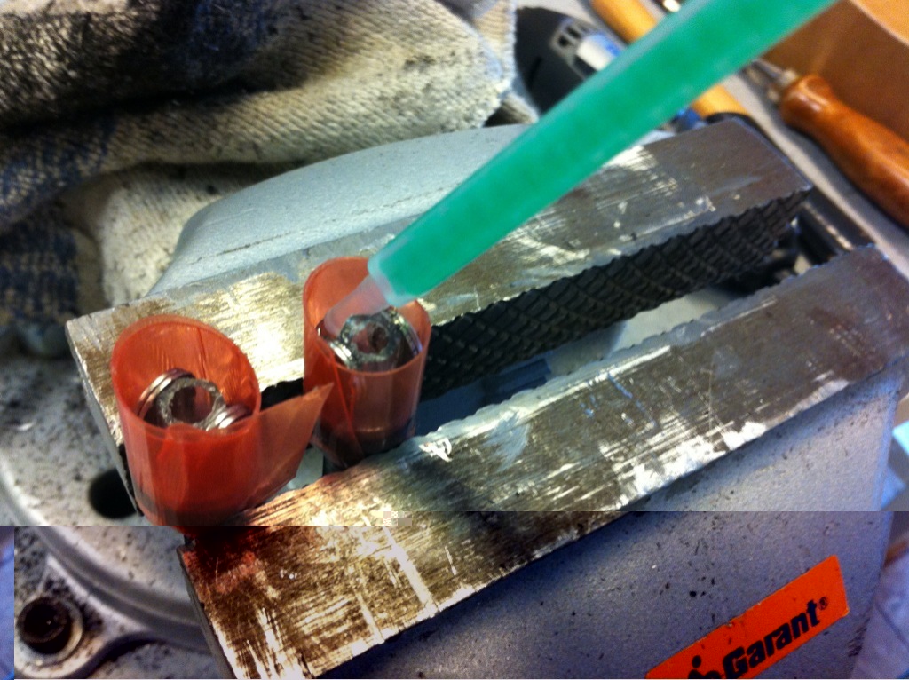

I just want to share how I build the magnets for using the hall effect sensor ss495.
I found this idea on a french topic for a flight simulator joystick.
Below the pictures from the french topic.
Magnet

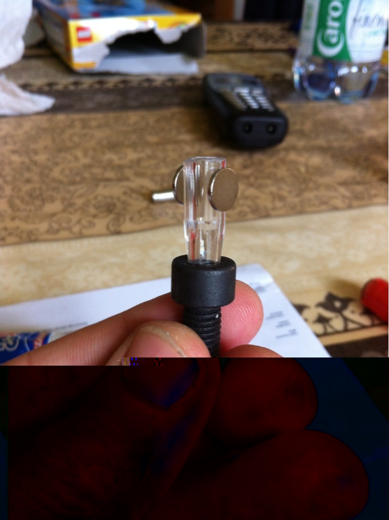

So I used this idea taking a pen wiich has an hexagonal form to glue the magnets parallel !I confirm that I used magnet with 2 mm thickness and external diameter from 4 to 8 mm. I bought some magnets which have just one millimeter thickness, I puted
2 parallel for,each side.
As I mount the magnets at the end of the output shaft which is taped,I glue the magnets to the pen and the pen into a screw.
Look at the basic mounting for this.
Pen glued into the screw

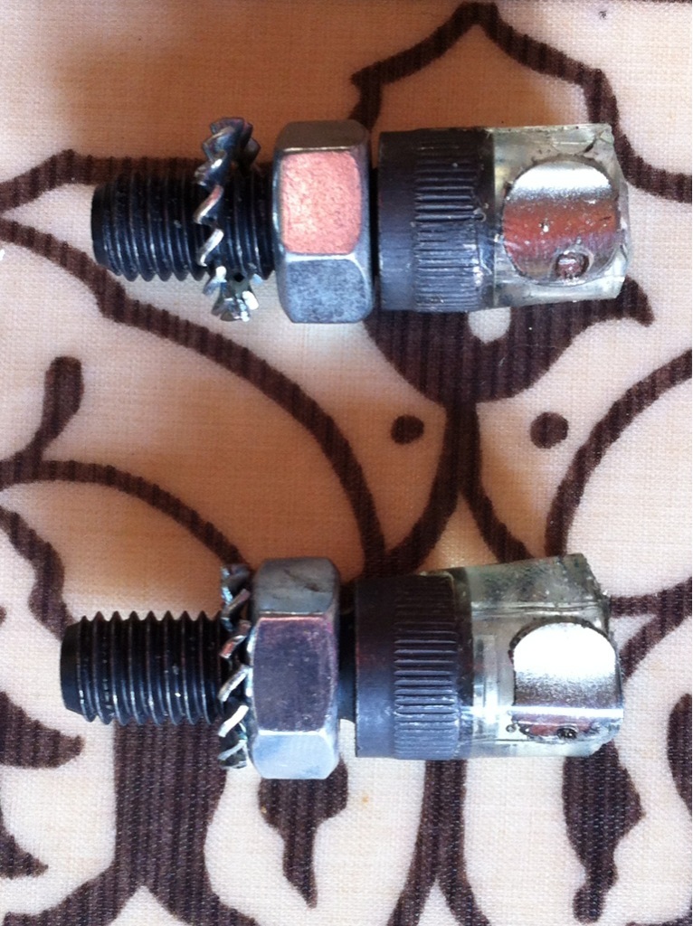

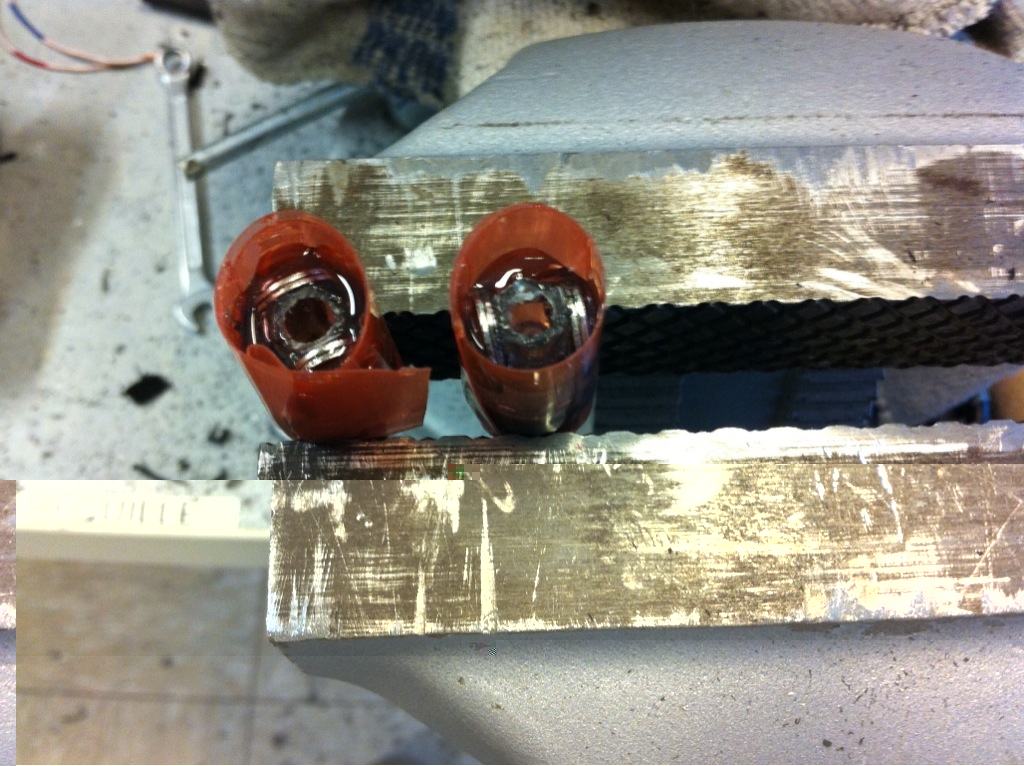

To have a good finishing I make some more operations.I wrap around the magnet a epoxy glue.To maintain the epoxy I wrap before around the screw a double face skotch(it's like molding).After I glue into it the epoxy taking care not to full up the pen complitely with epoxy.
Epoxy glue
The final result with epoxy
Screws with epoxy glue

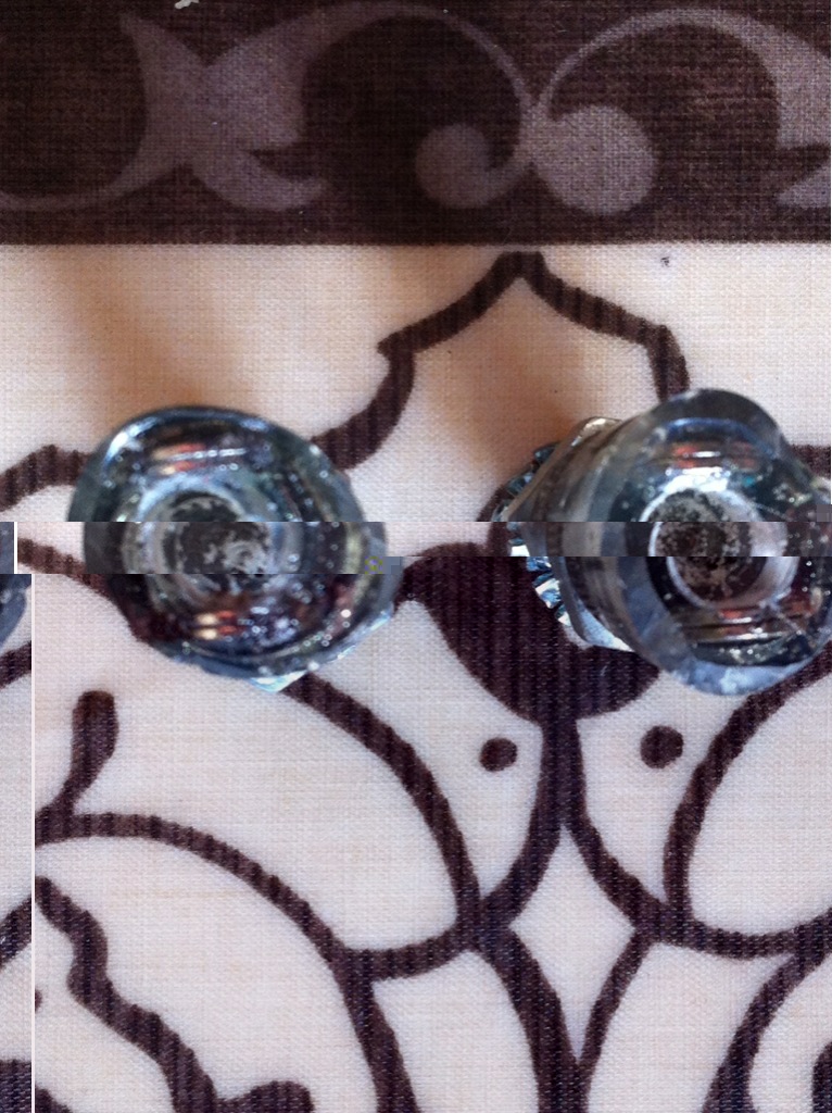

The last work is to drill into the pen to have more space between the hall sensor and the magnets.I use a 7,5mm dril to rework the inside diameter.
The final result.
Final result
Finished

After several weeks trying to make a suitable h-bridge for bigworm dc motors I found the time to finish all electrical stuff for my friend's the simulator.
First a picture from the electrical box ( I promise to make a good finishing in an another life :lol: )
It's a wine wood box ... Hope that it will be a very good vintage wine ...Bordeaux I believe!
Box
