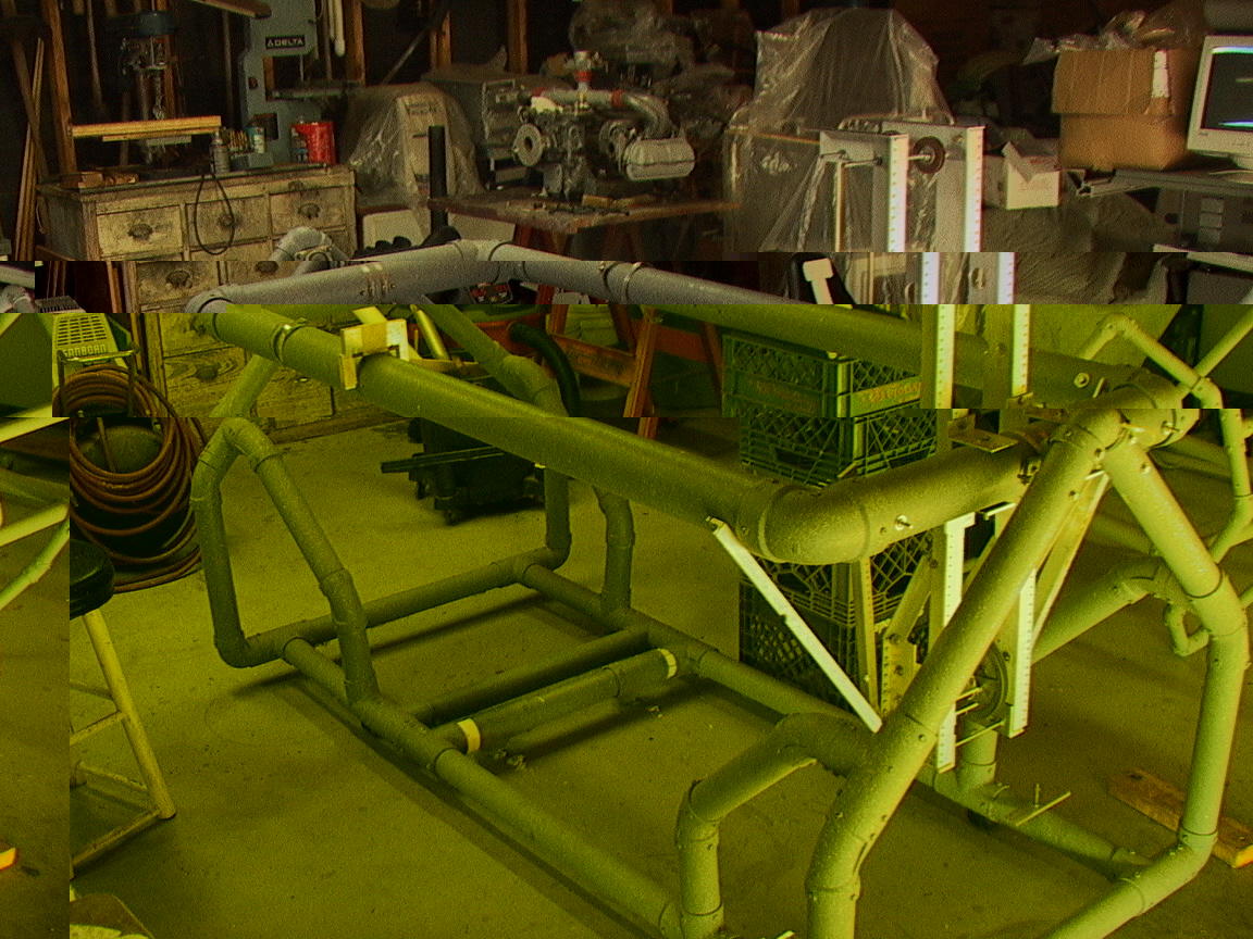

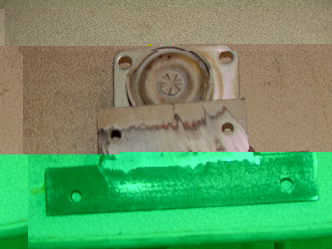

A little bit of information on my JOYRIDER. I built the original out of plans from JOYRIDER website for around $15.00. PVC schedule 40 was purchased for around $100.00 and used to make the whole apparatus. Berings and other welded parts were done by Bulletproof Fabrication, a first rate welding house here in Corpus Christi, Texas. That part of the project took about a month to complete.

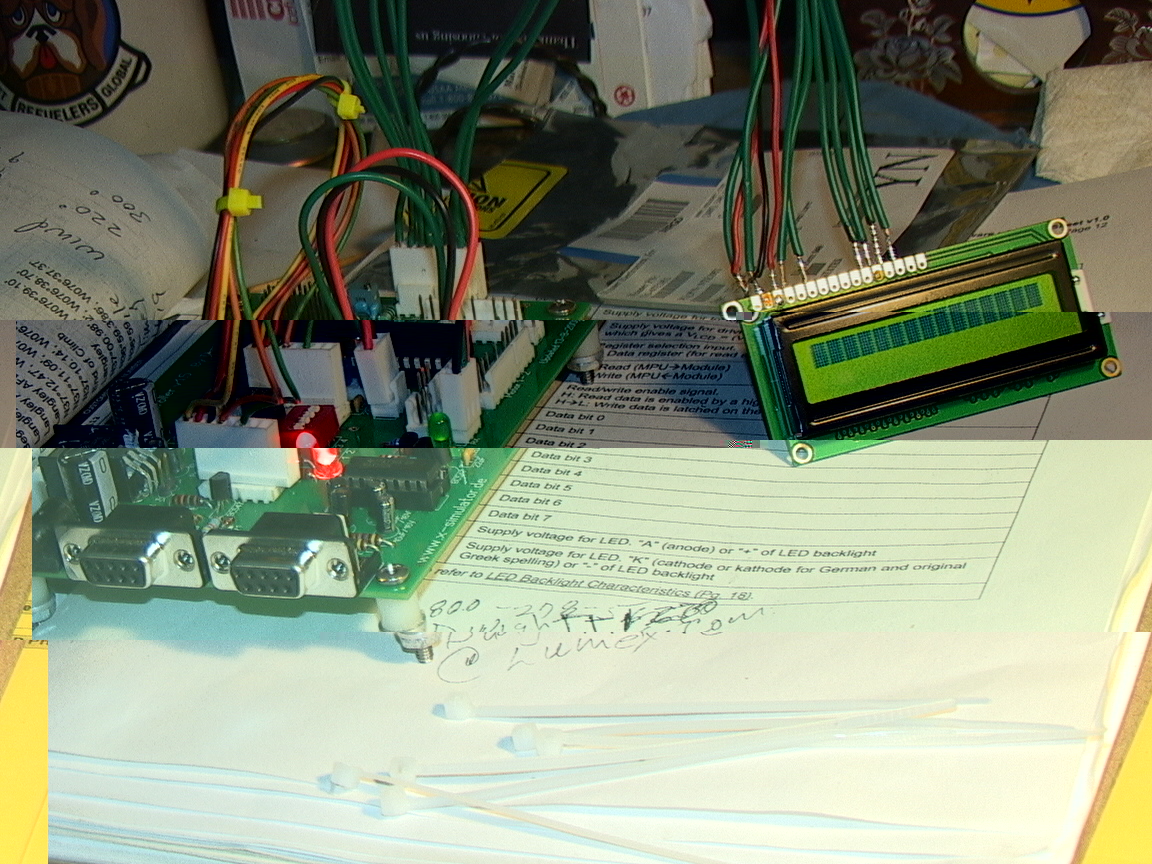

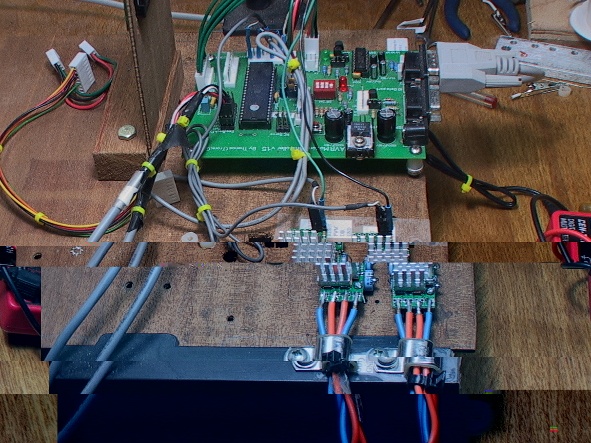

The next part of the project called for a AVR 1.5. I had to decide on whether to etch out a PCB or purchase one. I opted for a Sunstone PCB for about $65.00. Two weeks later the PCB arrived. Mouser Electronics supplied the electronics to place on the PCB, minus redos around $100.00.

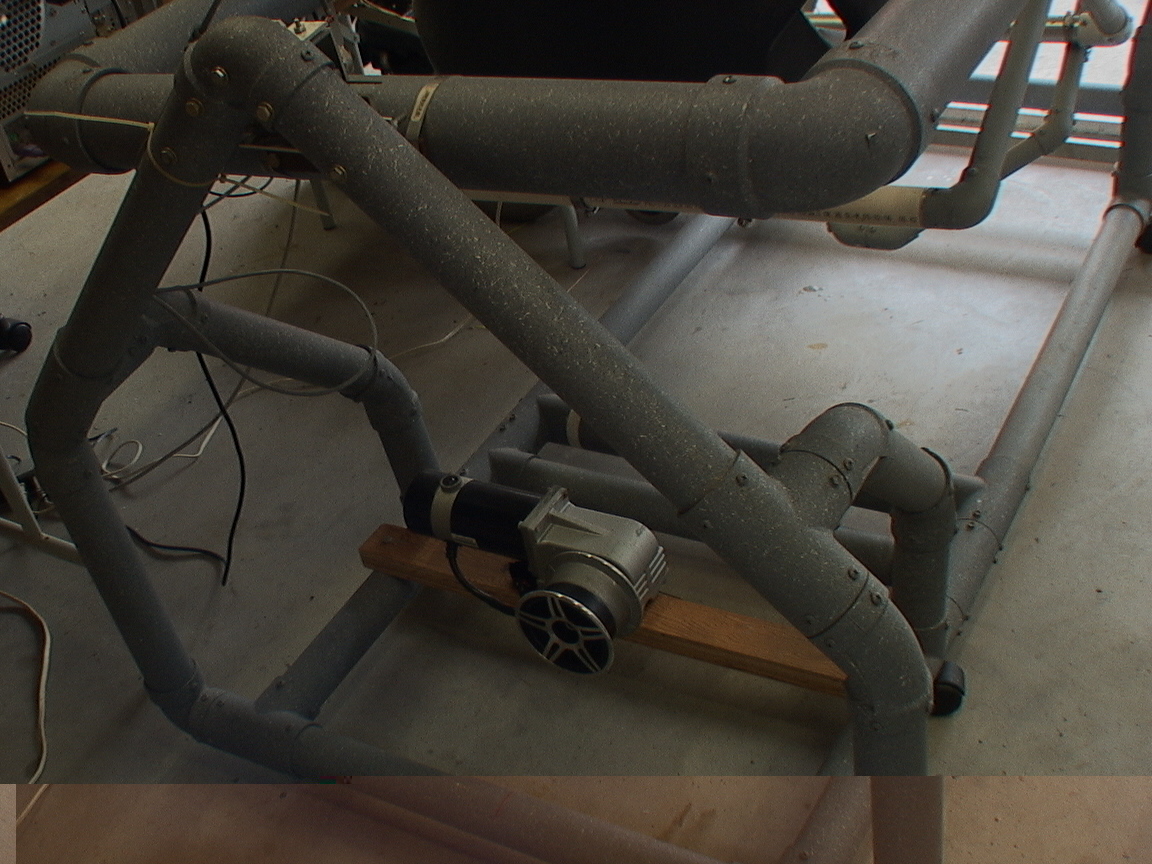

Next I had to figure out what type of actuator or motor I would use. After much effort I decided on wheelchair motors off of a Jazzy Wheelchair. I had to remove the electronic brake mechanisms and I was good to go! Following that, I had to make a decision on drivers based on the fact that I was using 24 volt motors and how to drive the big behemoths. Pololu Corporation had a HIGH-POWER Motor Driver 24Volt 20 amp that would do the trick for about $112.85 together. Power is supplied by two wheelchair batteries linked together to yield 24 volts.

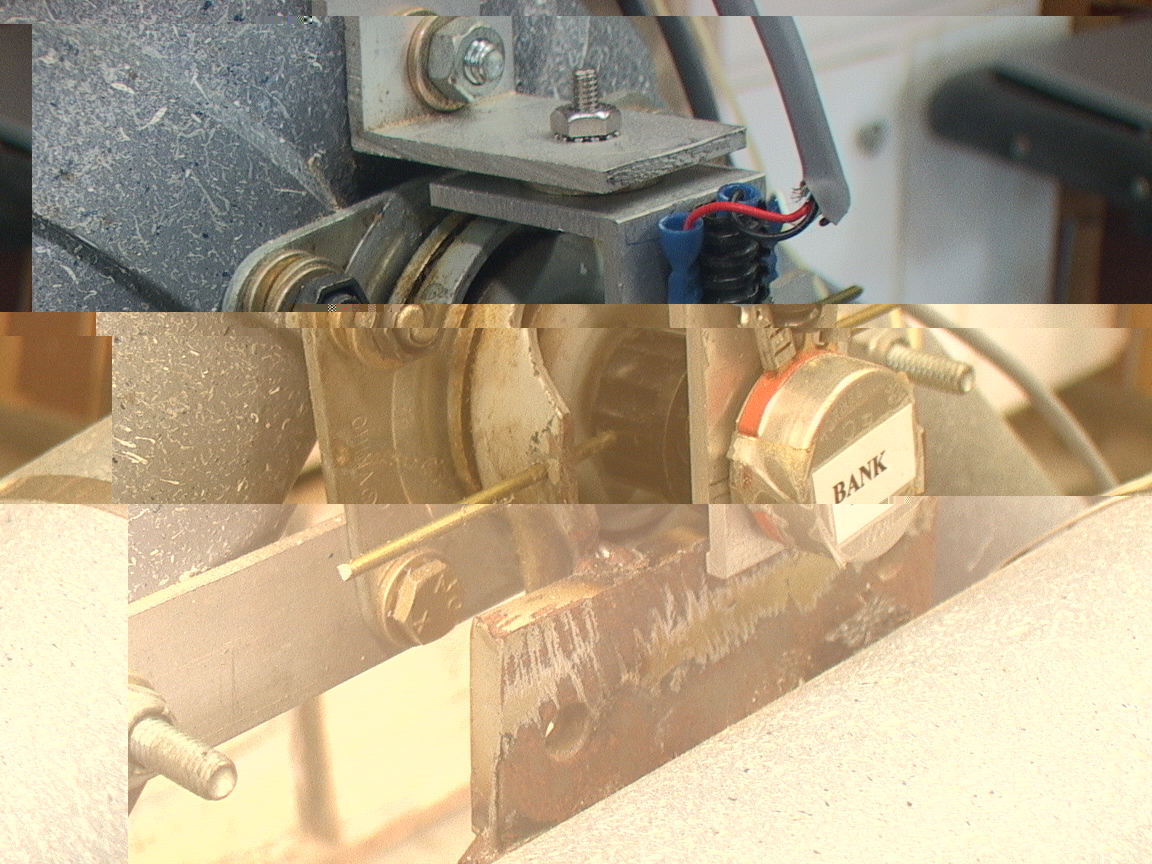

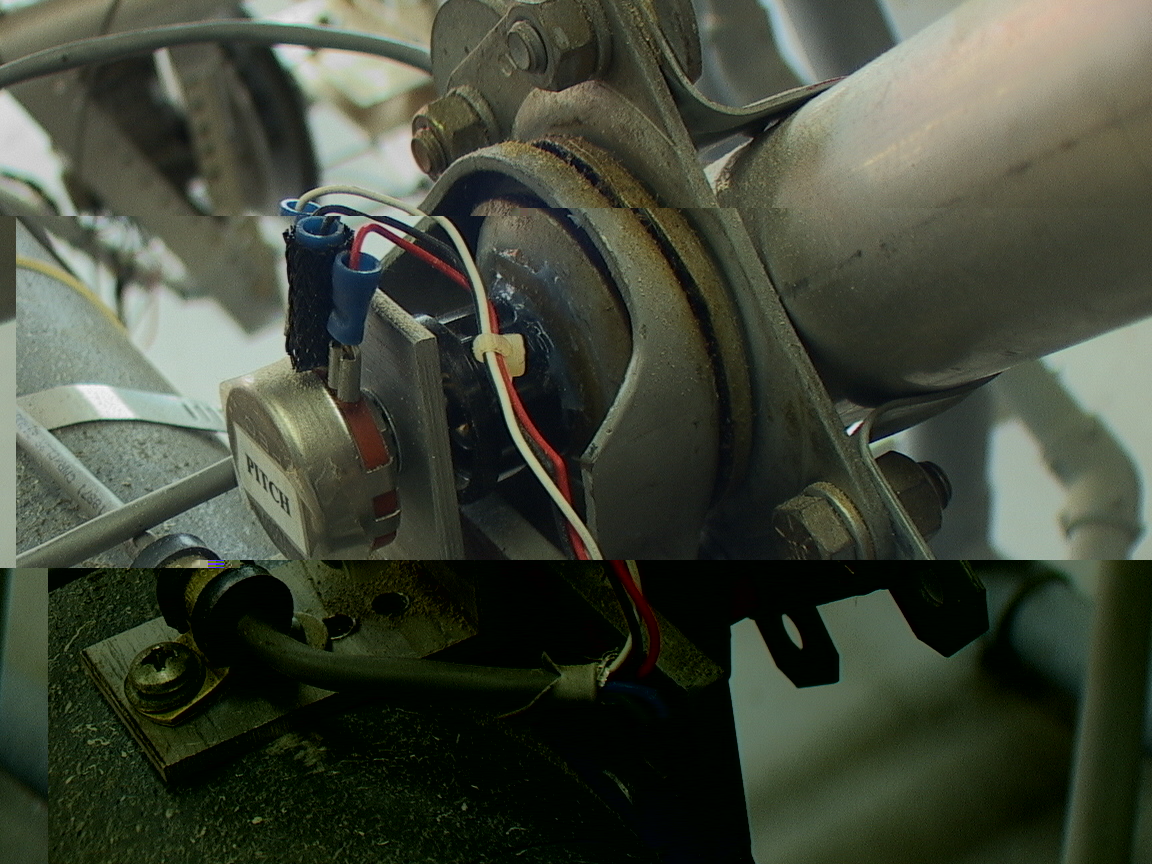

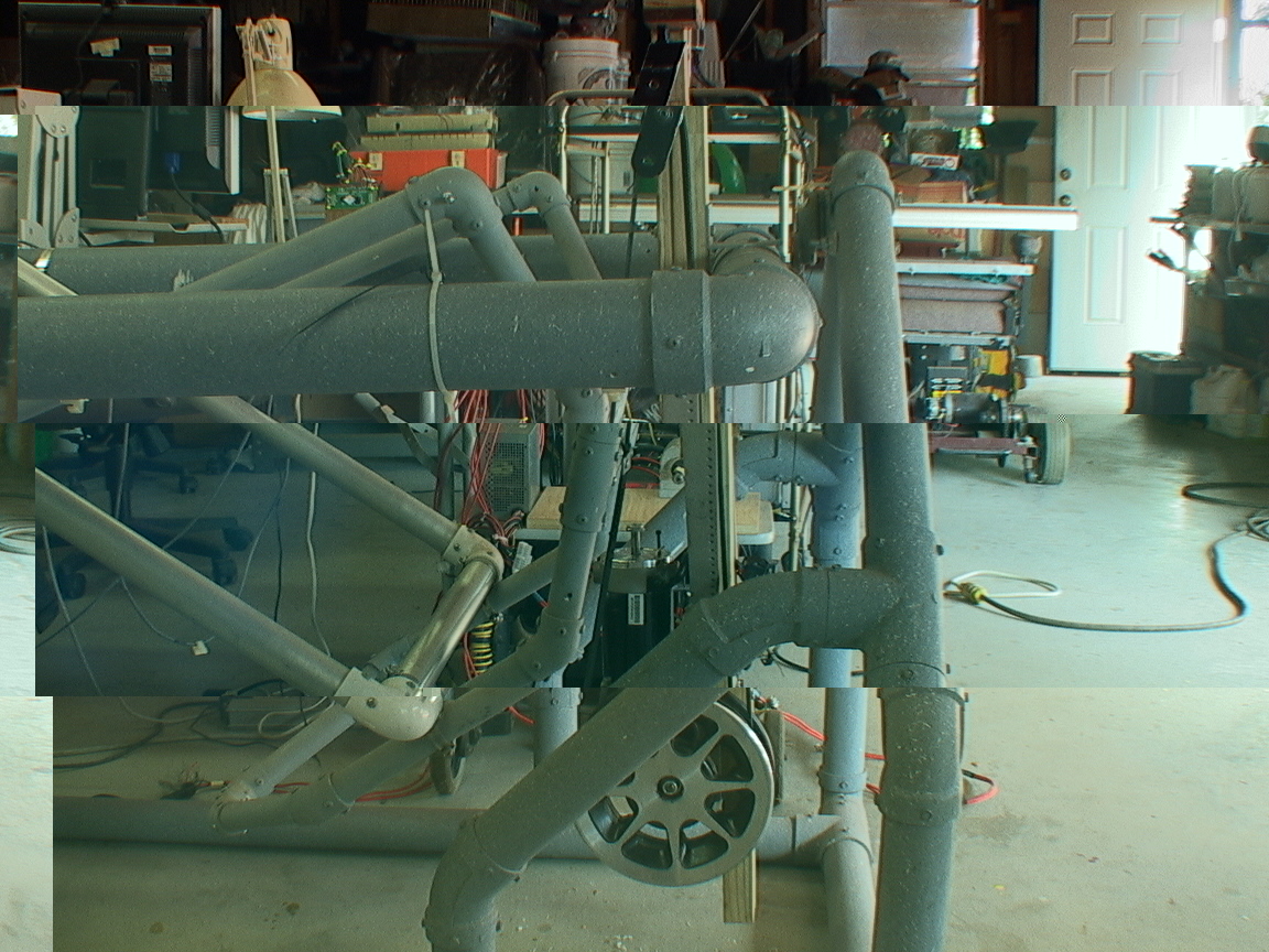

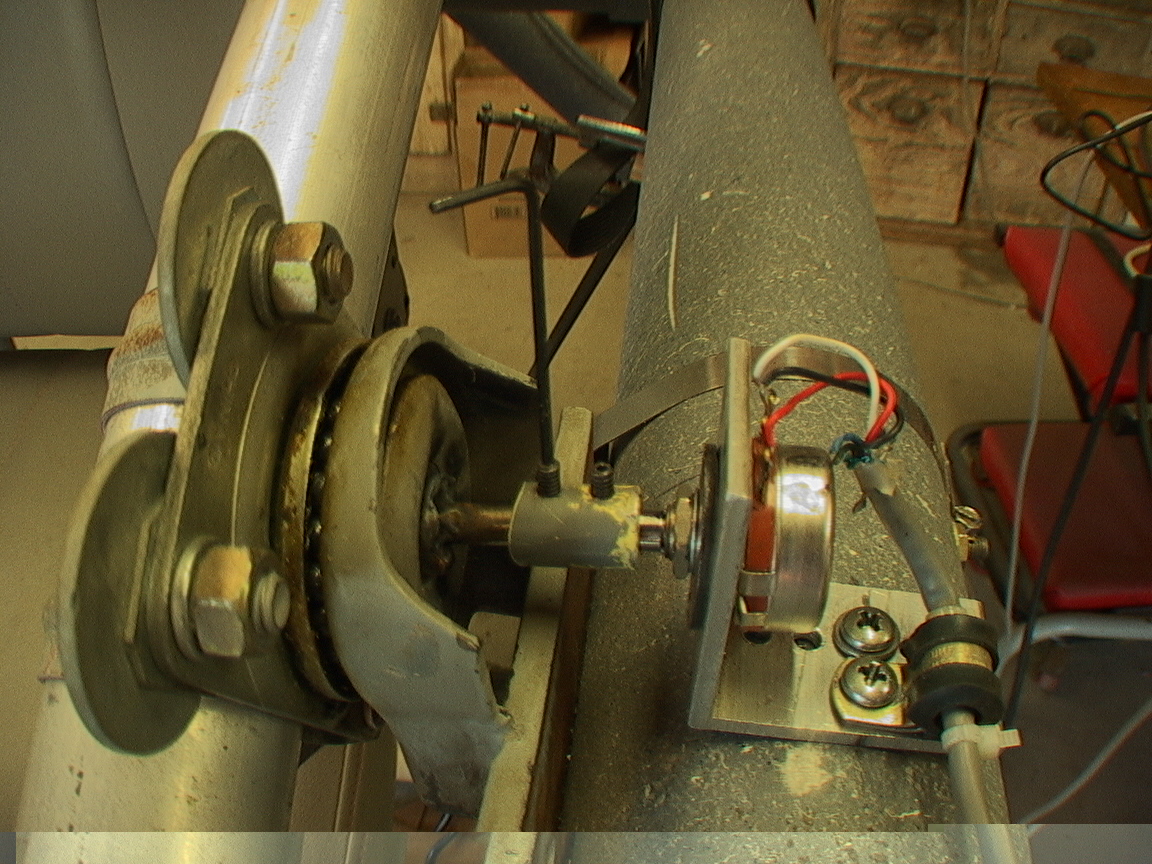

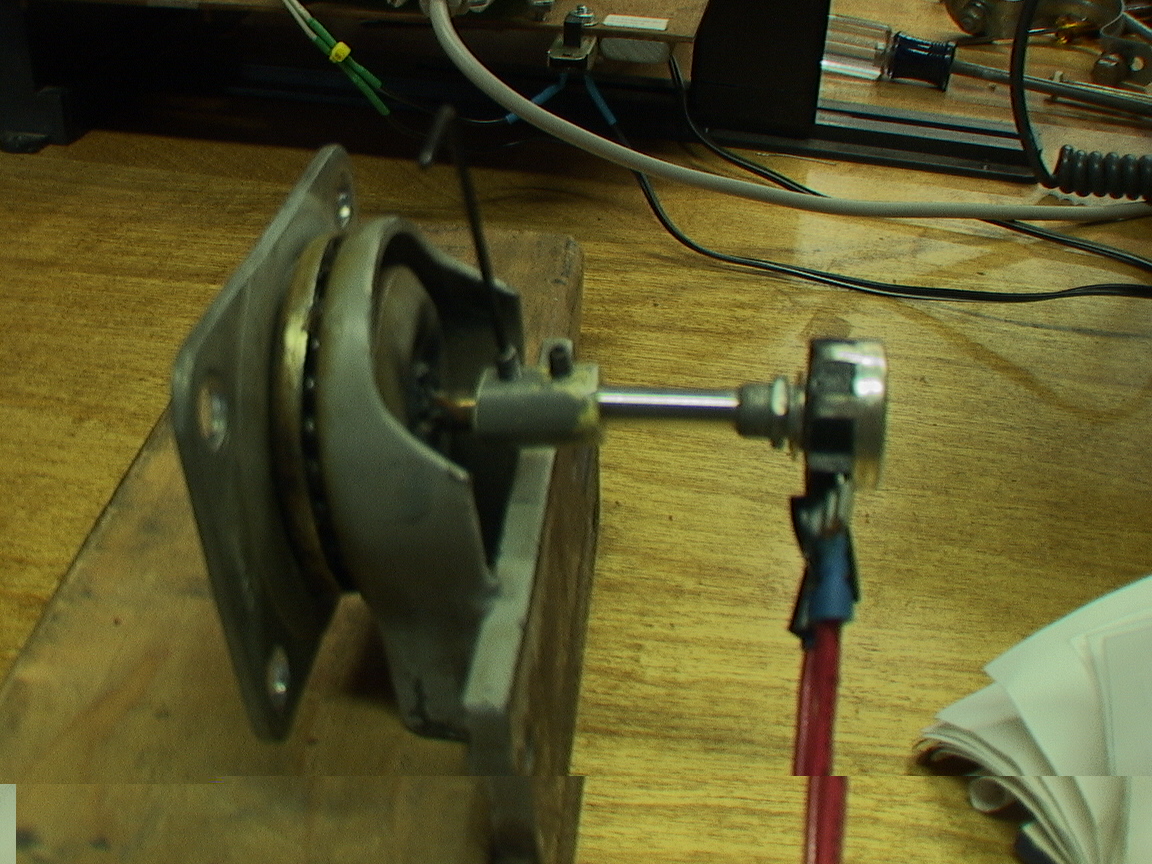

Pic of PITCH pot hooked up to the simulator

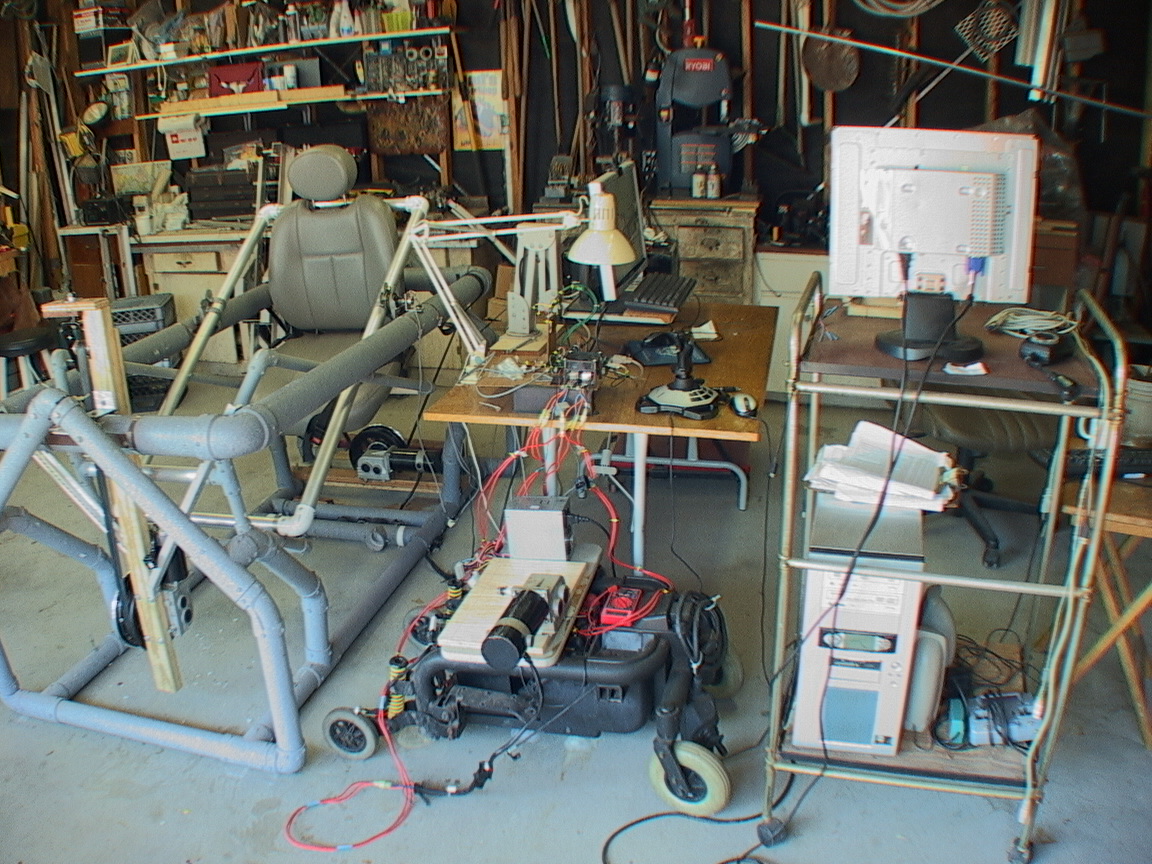

My rig... computers, joystick.etc., notice upholstered seat from wheelchair. Third motor on power pac is for testing.

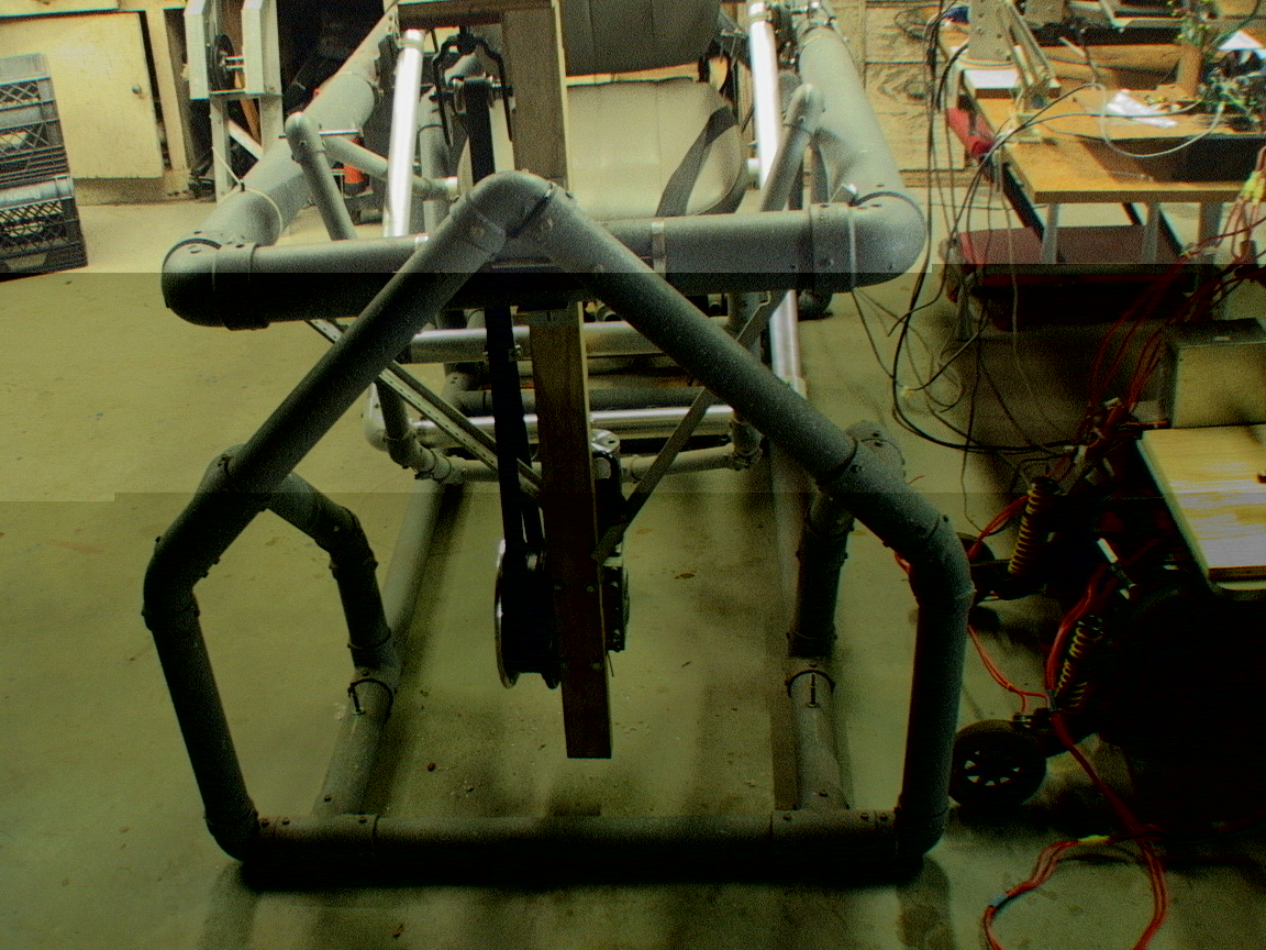

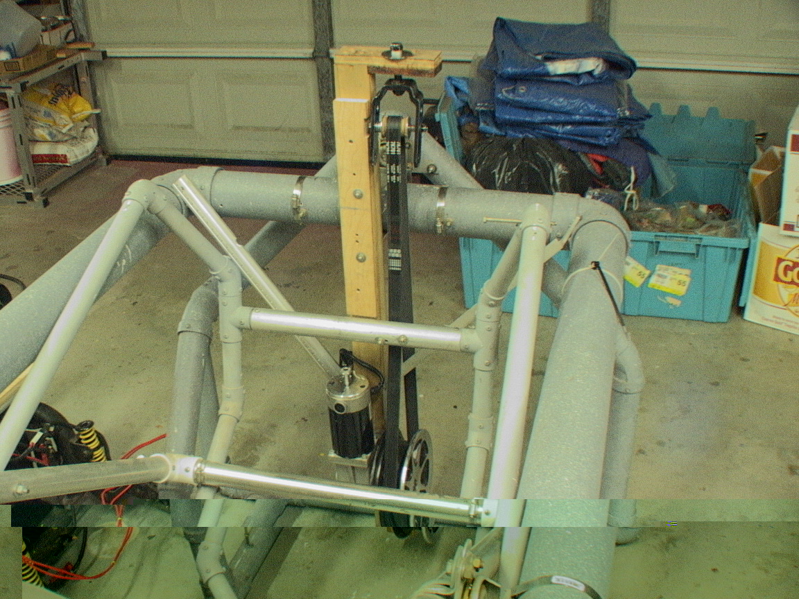

Rebuild of the Pitch actuator.

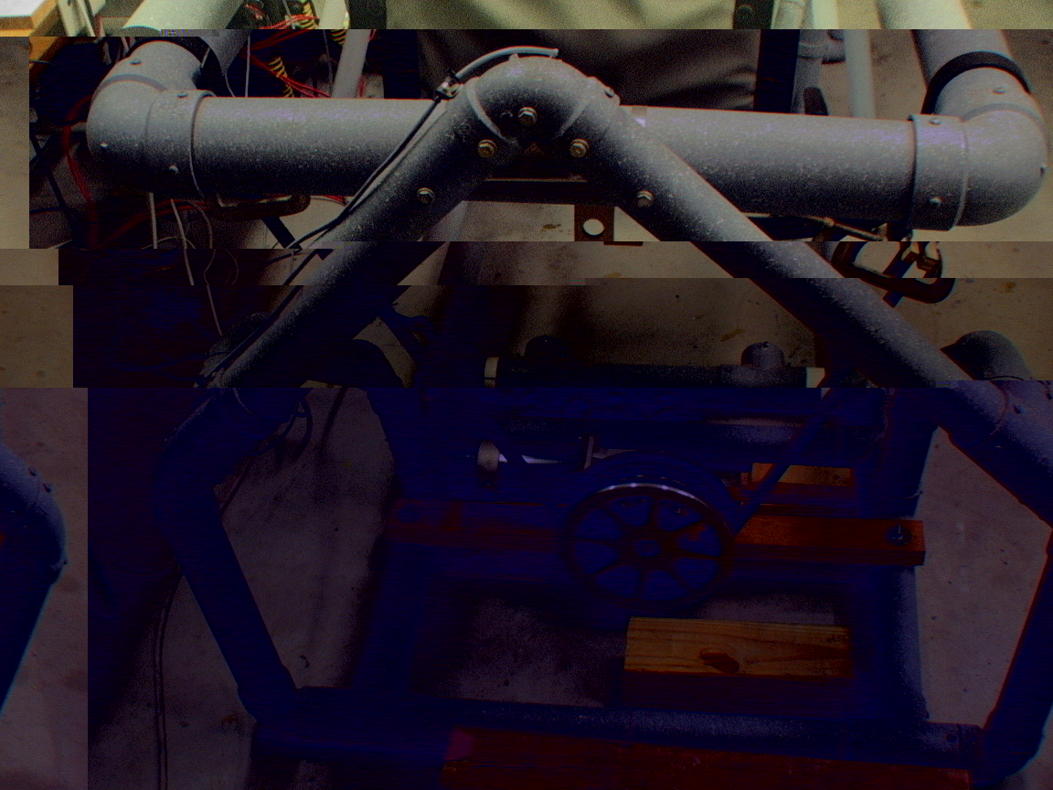

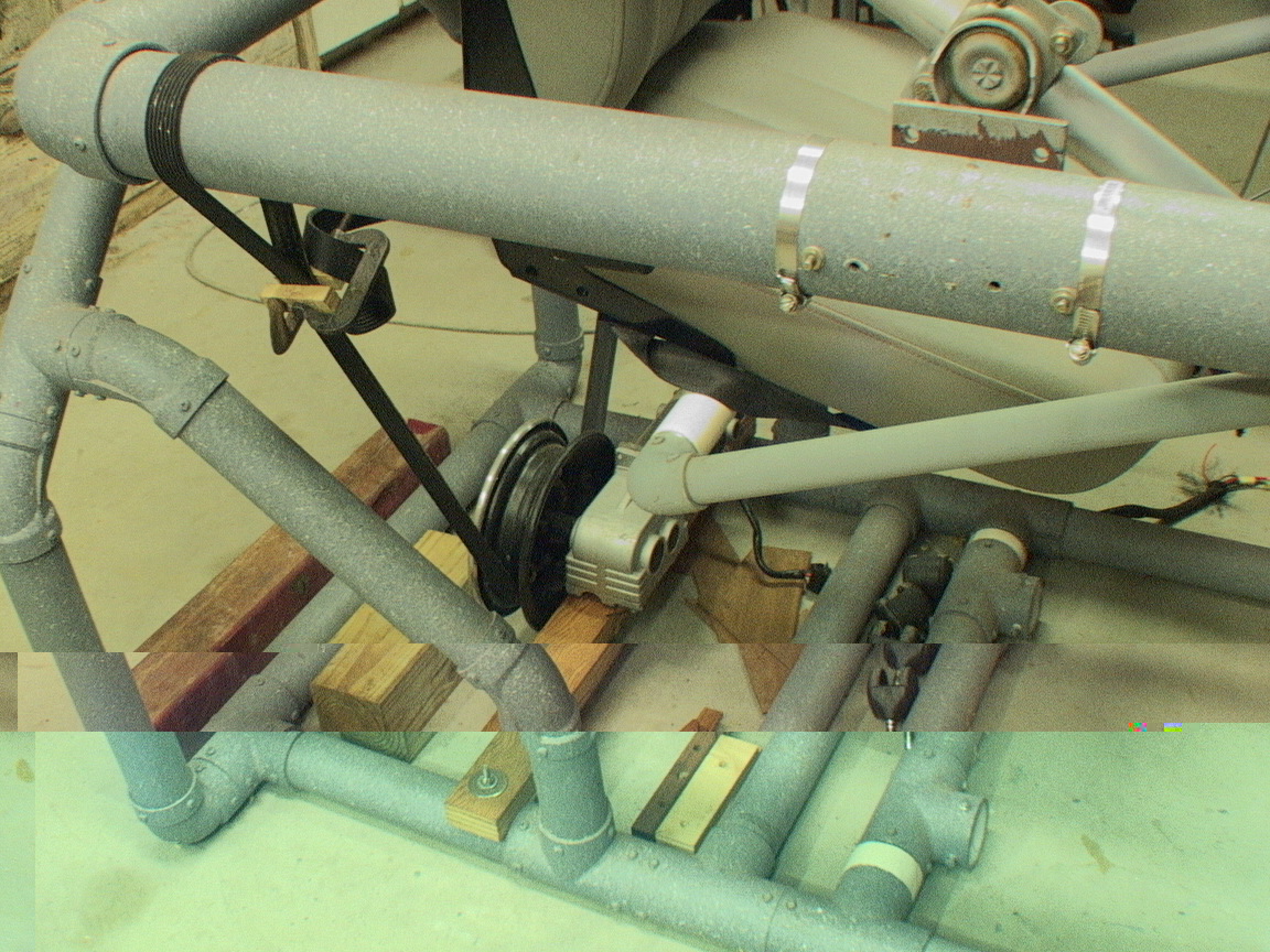

Bank actuator, notice belt from a Ford 250, clamped for size!
Rebuild of the bank actuator (motor), a replacement of the liner actuator.
Rebuild of pitch actuator, notice the belt from auto shop.
Another view of the pitch actuator.
A rework of the PITCH bering and pot., notice the sleeve used.
AVR 1.5 and two Pololu High Power Motor Drivers 24Volt 20 Amp with heat sinks.
Bank actuator, work in progress.
Pitch pot wired.
Bank pot wired.

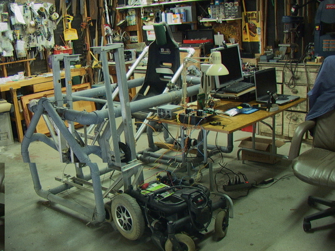

Old pic before rebuild of pitch & bank actuators, notice hard seat!
24 volts Power Pack is old wheelchair for moving around...HEAVY!
AVR 1.5 ..., it works!
Bering one of the two welded by Bulletproof Fabrication.
Early building of JOYRIDER.

Thank you, for responding. Question, when does one use the mini-potentiometer on the AVR 1.5 board, in the racing or flight program or out? How is it reflected i.e. can I see it in Profler2 or X-Sim Converter? Sorry for the elementary questions!

Postby tronicgr » Wed 22. Aug 2012, 19:05
I would suggest turning the mini blue multiturn potentiometer all the way clockwise and leaving it alone for the moment. It reduces the range of the ADC reading or, as otherwise called, reduces range of motor position feedback potentiometer turns in degrees. The issue here is that reducing this range too much you will also reduce the KP proportionality in a matter that the motor will act as fully on or fully off without smooth acceleration.
I'll pm you a version of firmware 1.1e that is fitted for the old AMC1.5 boards. I assume you have this old one still, and you recently added a FT232RL board for the communications. Anyway you can give this a try as it corrects lots of bugs compared to the original AMC1.5 firmware 1.0. It implements reduced range in software so you don't have to mess with the hardware range anymore.

Thanks for the good info! I'll turn it down and see if it works. Meanwhile I will attempt to resurrect the little ole FT232R. I still have all the stuff to make a 1.6 but still haven't found the time, between making the 1.5 work and the simulator! Once again, thanks.

I'm using wheelchair motors and transmisions off a JAZZY motorized wheelchair, To make the pully, I just removed the rubber from the wheel...simple! No problems with diameter of the axil & pully. Also, I had to remove the braking system so that a person in a stopped on a hill could do so safely, and not fly down the hill! The belt is a serpentine, from a Ford 250 pick-up truck.
