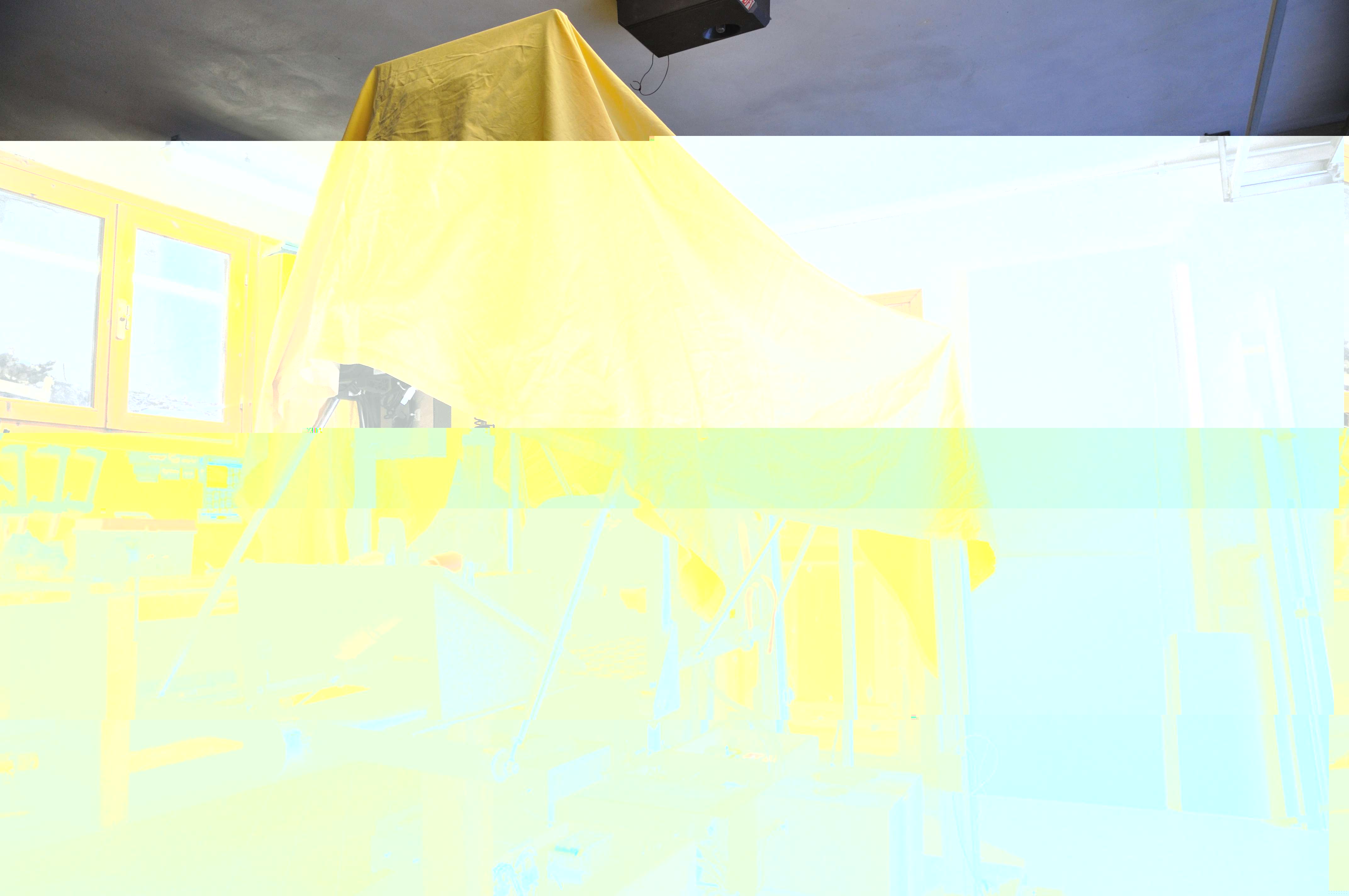

Hello guys,
Me and my friend the cure we are putting together a project that has been ongoing for many years, since before it came out xsim. :D
discover this site was a breath of fresh air for our minds, because we were stuck. :oops:
First photo
Now we managed to put together the forces due to electronic discovery right here.
We still have some "small" problem with the motor controller of the rotation because of electrical noise that brings us to the K8055 and sent in error. :evil:
begins with posting the video link of the beta test: http://youtu.be/Edsc_NUHLcQ
from here with the time, I will explain the entire procedure. If successful ;)
sorry for bad english but it is easier to write fast with google :ugeek:
for the moment is everything .... a greeting Basthard

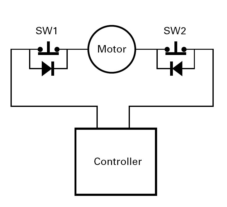

For linear actuators, depending on the amount of turns they perform to fully extend/retract, you may use a industrial grade 10k 10-turns or 25-turns potentiometer. Connected on the screw of the linear part more likely.
For DC motors, its very easy to attach some heavy duty limit switches with reversible action using large diodes.
Adding_Safety_Limit_Switches.pdf
(23.39 KiB) Downloaded 2276 times
And since I know its hard to find high ampere diodes, here is a way to place in parallel many small ones (6A diodes for example).
How to add many small diodes for End_Switches.pdf
(7.31 KiB) Downloaded 2191 times
