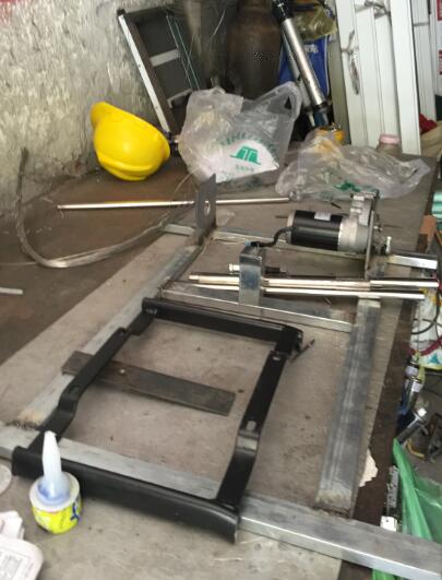

Seat base:
Seat base structure
Two wiper motors monted on the base:
Two wiper motors

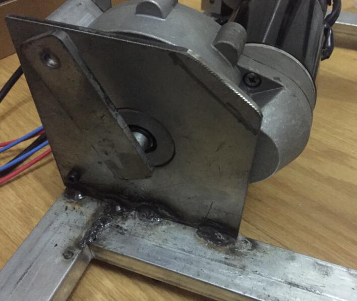

Motor mont:
The mont steel thickness is 6mm, this will make sure the motors are rigid stand.
Also a connecting arm (center distance 50 mm , 5 mm thick) is monted on the motor rod.
Motor mont

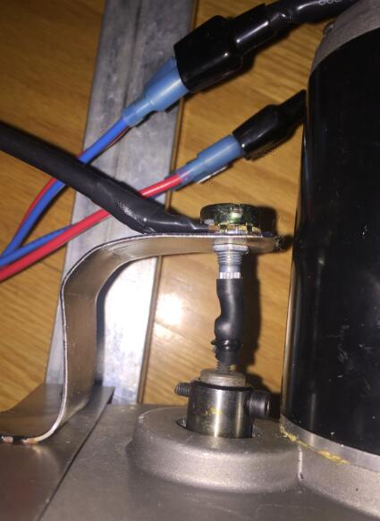

Poteniometer:
The pot can generates the feedback signal of the motor ratation angle.
The bracket which hold the pot is wobbly as you can see, this need to be replaced by a strongger one for future upgrade.
The pot rod is connected to the motor shaft using a rubber tube, this can bear some disalignment between them.
Potentiometer

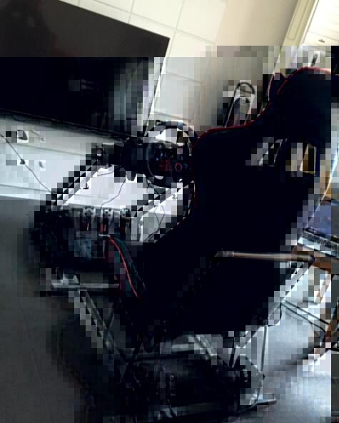

Finished seat:
Finished seat 1
